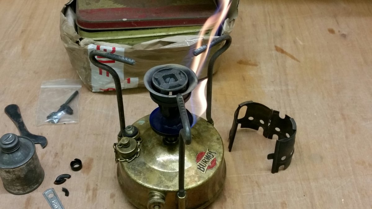

    Oh dear, just bought one off of ebay and it arrived this morning. It was very very cheap and I was the only bidder.
    The filler and travel cap washers were hardened like bakelite, so swapped them. NRV pip leaking so whipped it out without much bother, just a little bit tight. Crumbly cork pip swapped with a viton version. Pump cup washer (some sort of plastic?) split, so fished out a suitable leather version from my oil jar and swapped it.
    No suitable burner washers in my fettlebox (I'll have to order some more) so left burner as received. Did use the supplied Burmos pricker to check the jet was clear though.
    Nothing left to do but prime...
    ... and get my RM picnic stove out for comparison ...
    My RM stove normally has the purest blue flame out of all my stoves, with no yellow bits whatsoever. Also has nice even petals.
    ... well the Burmos seems to be running great too! Mainly blue flame with little bits of yellow from time to time. Four even flame petals.
    Hot! The RM is warm to the touch, but the Burmos is like a hot domestic radiator! Self pressurising maybe? There was a slight vapour leak from the fount to riser tube joint, but that was because I'd only done it hand tight. I read about the taper thread, so nipped up the connection with the spanner which sorted it.
    Well mine seems to be a good one, although that opinion is based upon less than 24 hours ownership.
