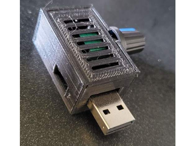

    I will also be ordering a USB fan controller as advised within this thread and as I have a 3D printer will print a box to house it, I see that thingiverse already has a design on their site.

    Managed to print off the couple of designs I found for the controllers, hopefully the controllers themselves will arrive tomorrow so I can see how they fit. IMG_1493.JPG

    I received my Stove Kit (stove + battery / Solar + Grill) today. I bought some USB power controllers as recommended earlier in the thread + made up some 3d printed cases for them (it made more sense to buy 5 controllers for near enough the same price as 2 on Amzn, just need to find a use for the spare ones).

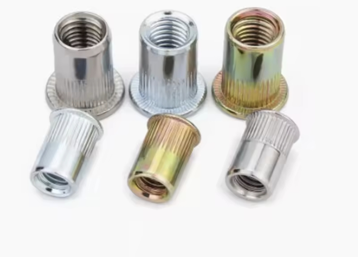

    I never liked those three tiny pegs for the feet, never used them either, so I slipped into full AliExpress mode, ordered a pile of bits and fitted M5 stainless threaded rivets. Into those I screwed M5 x 25 mm thumb bolts, topped off with M5 thumb nuts at the bottom, and fixed them with either Loctite or nail polish (can’t remember which; same result anyway). It actually helps level the stove on uneven ground, which is great for my steak pan, if only it wasn't warped.

    You see a stainless steel M5 rivet, a M5 25mm thumbbolt and a M5 thumbnut. Looks like this on AliExpress:
    In case someone in the future wants to Google Lens these images and find the same stuff on Ali.
