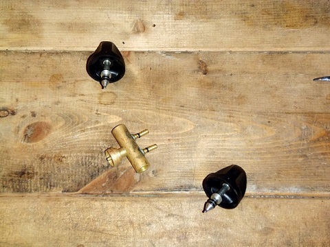

    Here is a picture of the bare valve. I broke the coupling off when heated it up with a propane torch and tried to remove it. It exposes a 1/4 inch circular recessed area. I tried soldering the brass coupling in the lower part of the photo, but the joint was not strong enough.
    Here is the same valve with a 1/8 nipple brazed onto it. I actually used a short piece of 1/4 copper line sandwiched between the valve and the nipple part. I also sawed off some of the thread on the nipple part as they were not needed.
    Here is a preliminary test I did this morning, and it seemed to work well. I'm still waiting for the 7-9mm ear clamps to permanently attach the main fuel line and I still have to shrink the heat shrink tubing. I have not tested white gas with it yet, maybe this weekend.

    I was inspired this afternoon, and dug through my kits, Since Coleman has discontinued the old adapter I think with minor fettering one can adapt my canister adapter from my Firestorm 9770 stove to work with the Xponent stove.
    Looking at the Coleman page - http://www.coleman.com/Parts/Part/9770-5181/adapter-valve-assembly-with-caps
    Coleman says they still sell this adapter and for $27.00 USD.
    Also with the use of another Hose assembly with cap 9770-5151 (Coleman page..) http://www.coleman.com/Parts/Part/9770-5151/hose-assy-wcap This hose could be adapted to fit.

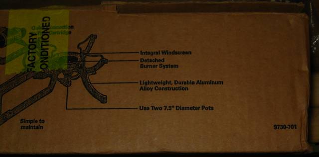

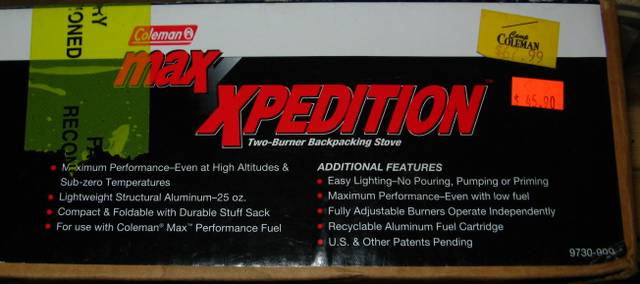

    Here are 2 photos of my box containing my Xpedition stove.
    In the upper image, you can see the 9730-900 in the lower right corner of the stick-on label. I cannot find anything about that dash number when searching the internet. But, it adds to my questioning the validity of the need for the "-701" in the title.
    The bottom photo does show the 9730-701 on the cardboard, lower right corner, of the back of the same box.
    Conclusion:
    At the expense of seeming nit-picky, I only suggest that the title be changed again to remove the "-701" as it may or may not be correct for the model of the 2 burner Coleman Powermax Xpedition stove.
    I hope that we can get more information to clarify this minor detail.
