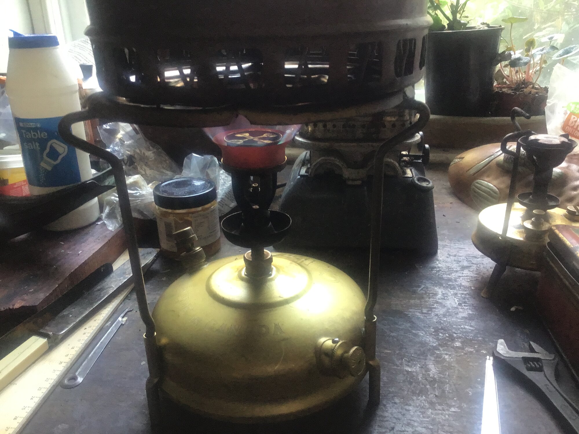

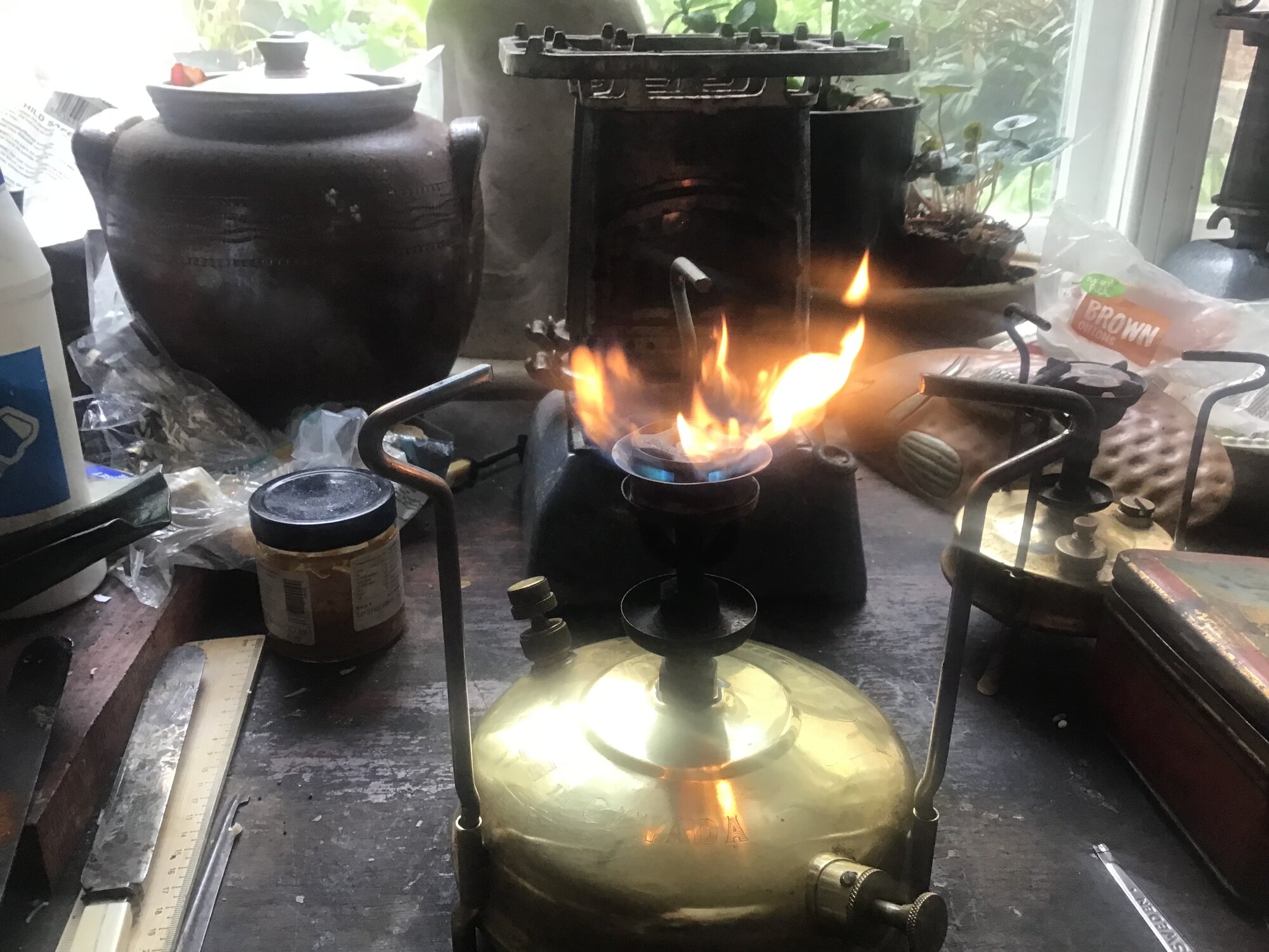

    I would like to refer a Solus problem to Tony and other expert owners as follows. I have a Canadian Solus 518 cleaned up from a rough state when it was discovered in a shed, just the tank. A burner
    from a Valor stove has been fitted but so far no new seals or pips etc
    The pump works perfectly and the stove fired up in a lively way but the strong flames were about 50% yellow. My question is, does the yellow flaming indicate an air leak somewhere? What were the seals etc that you fitted Tony on your Solus and where did you fit them?
    Would welcome any suggestions.

    First, is your Solus fitted with the Coleman pump and check valve at the bottom of the pump tube?
    Second, the yellow flame could be either burning off crud, or an enlarged jet in the nipple.
    Third, you should replace any rubber seals and washers with Viton ones; ensure your leather pump cup is up to scratch or replace it; change the fibre washer(s) on the burner, and make sure any lead washer is working properly or replace it.

  9. Tony Press
    10,819
    Running rich means too much fuel, relative to air. An enlarged jet is one cause.
    It’s best to run your stove for a few boils to make sure it’s not just burning off crud, or you’ve got a loose part.
    I always test by putting a cleaned pot on the stove and see, after a boil, whether there is soot that can be removed by wiping a finger across the bottom of the pot.
