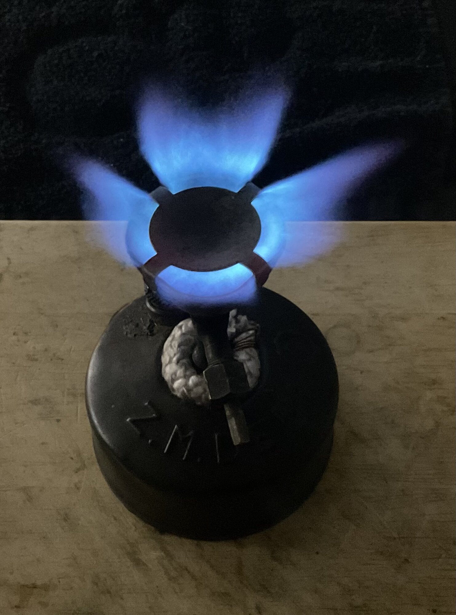

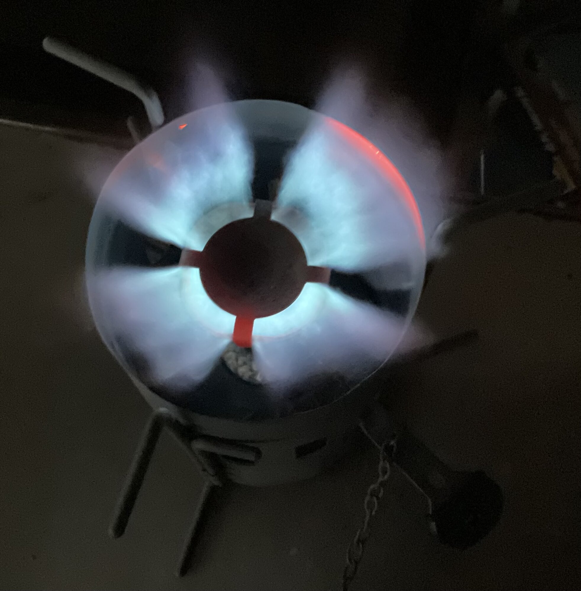

    Firing up the DĘBA…
    Using an 8mm glass fibre wick meant only a single preheat was required for this DĘBA to spring into life. A strong blue quadrant flame ensued which assured me no additional fuel jet restoration work was required.

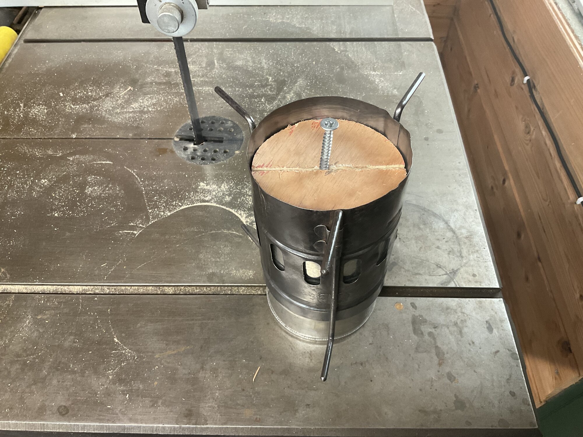

    The next step was to remove as many of the inward dents as possible which had occurred to the windshield. This clever trick was provided to me by @Remus1956 (much appreciated - thank you!). A circular piece of wood (finger thickness) is cut to the inner diameter of the windshield, then cut in half. The two halves are then carefully positioned inside the windshield where the dent(s) is located. A large wood screw is then slowly and carefully screwed into the centre of the two halves of wood which then equally and progressively separates them outwards against the inside of the windshield, pushing out the dent(s). A suitably sized can sits underneath and inside the windshield to provide initial support to the wood.

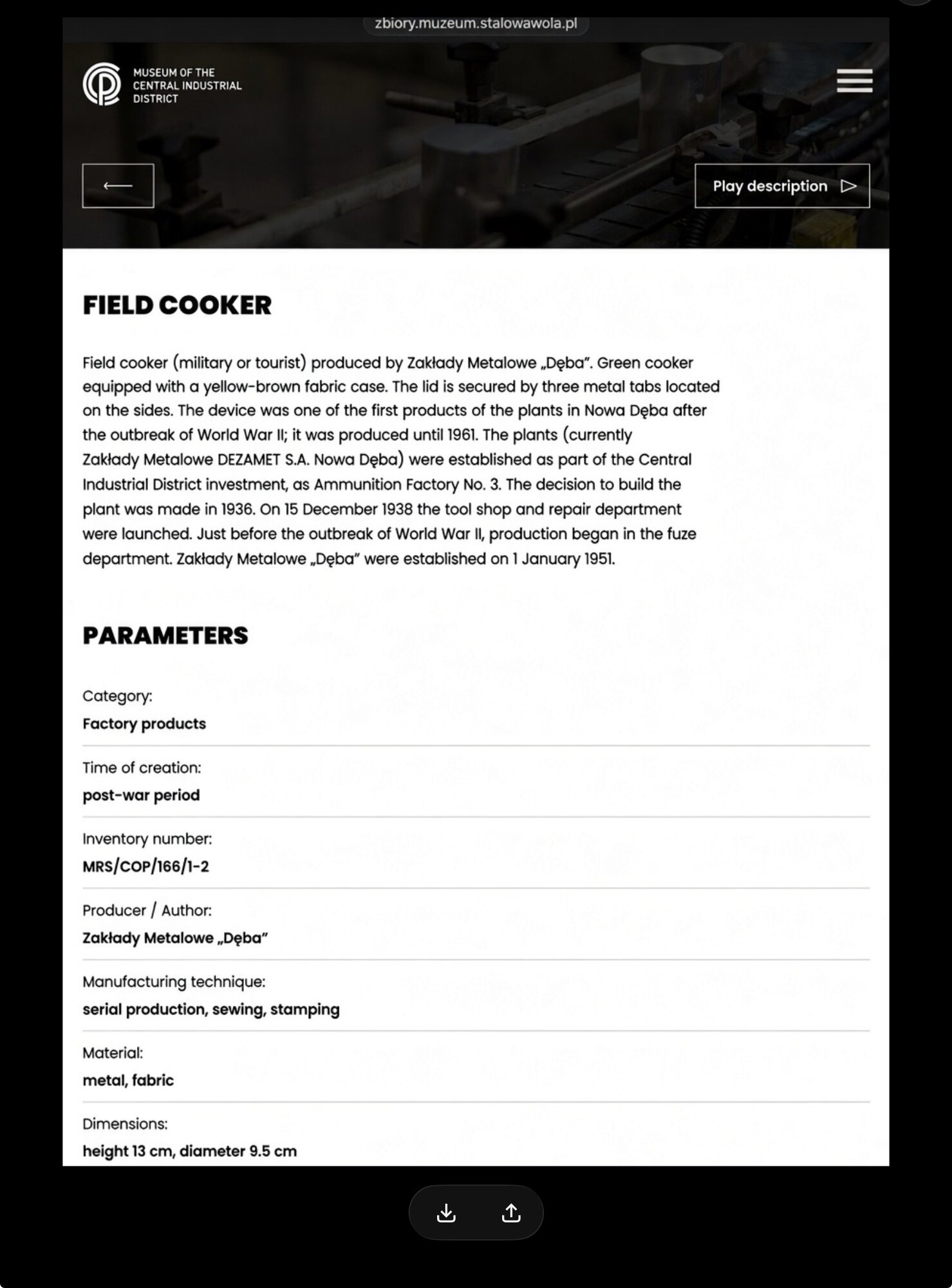

    Following research into the DĘBA, I came across this interesting article from the Polish museum which is located in the same area as the factory which manufactured this stove.
    This is the translated version taken from the original museum post, which is linked to here
    There has been some debate in the past as to whether the DĘBA was used by the Polish military. This document would therefore appear to confirm it was, as well as being manufactured for civilian use as well.
    It is confirmed the manufacture of the DĘBA began in 1951 following the formation of Zakłady Metalowe „Dęba” (the manufacturer) on 1st January 1951, with production of the stove ending ten years later, in 1961.
    What did surprise me is the fact that the DĘBA was originally painted green! @Remus1956 confirmed that with the DĘBA he has with original paintwork, the windshield is a very dark green which can only be seen as such in a certain light, outdoors. However, neither his DĘBA’s tank nor the lid appear to be painted in this dark green.

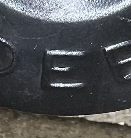

    Another interesting debate has centred on the Polish ‘Ę’ in DĘBA whereby there are also stoves which appear to be stamped with ‘E’ and thus ‘DEBA’.
    The two prevailing views are:
    1) The ‘Ę’ was changed to ‘E’ by the manufacturer for those DEBA’s which for the export market.
    2) The ‘Ę’ gradually became an ‘E’ due to wear occurring to the tank stamping die.

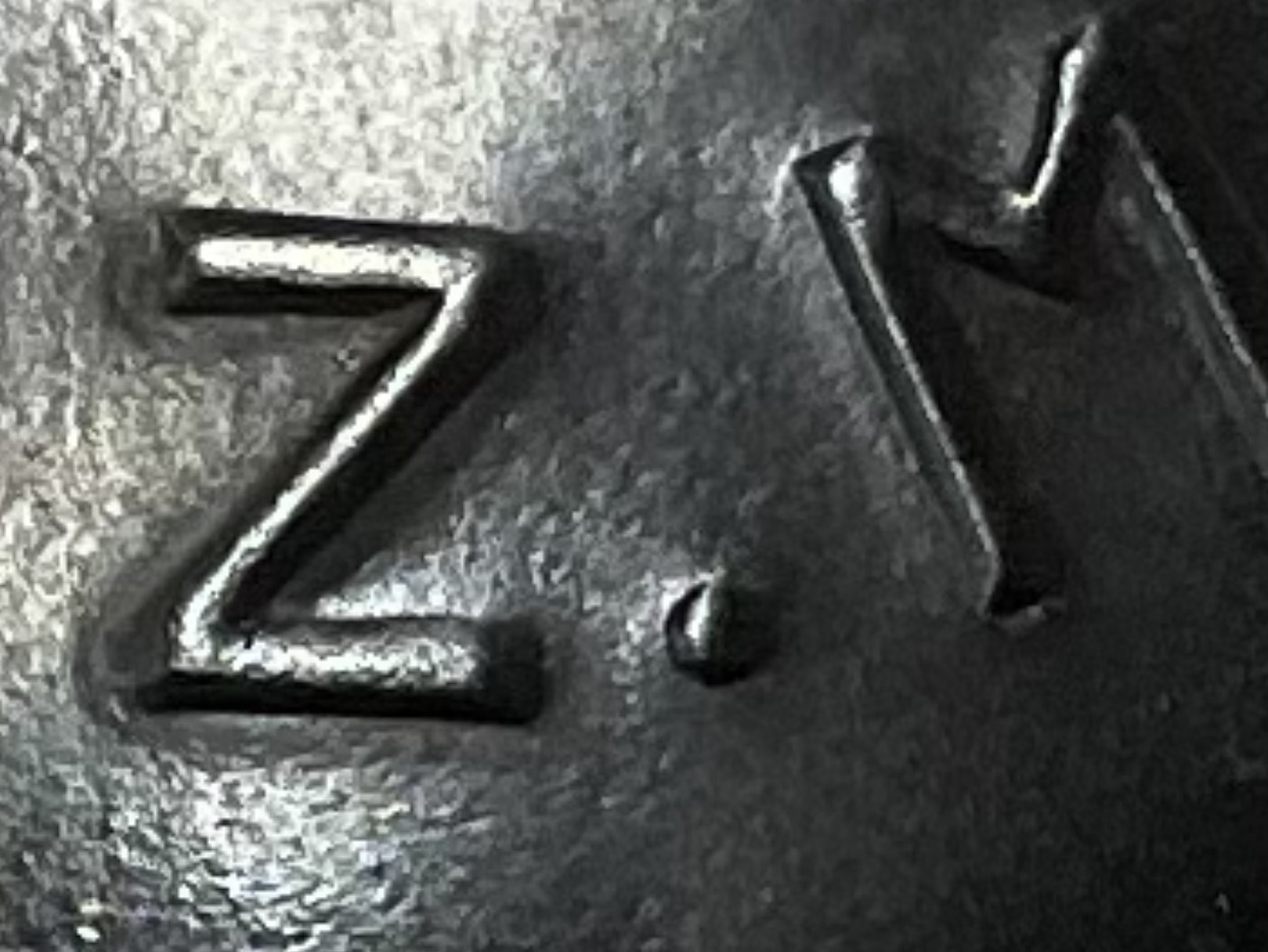

    To my way of thinking, if view No.1 was correct, then those bound for the export market should theoretically always have an ‘E’ where the bottom line of the ‘E’ has a similar sharpness of stamping as for example, the bottom line of the ‘Z’ in ‘Z.M.DEBA’.
    This is a picture of my DĘBA prior to painting…showing what appears to be an ‘E’.
    However, it is in fact an ‘Ę’ because on very close inspection which unfortunately can’t be seen in this photo, there remains a very small portion of the Polish ‘ogonek’ (hook). In my opinion, this can only happen due to a worn tank stamping die. With this being the case, I would contend that my DĘBA was therefore likely manufactured somewhere towards the end of the 1950’s.
    Whilst tank stamping die wear does not of course wholly rule out the ‘Ę’ being dropped in favour of an ‘E’ for export markets by the manufacturer, to my way of thinking, the former is a more plausible possibility.

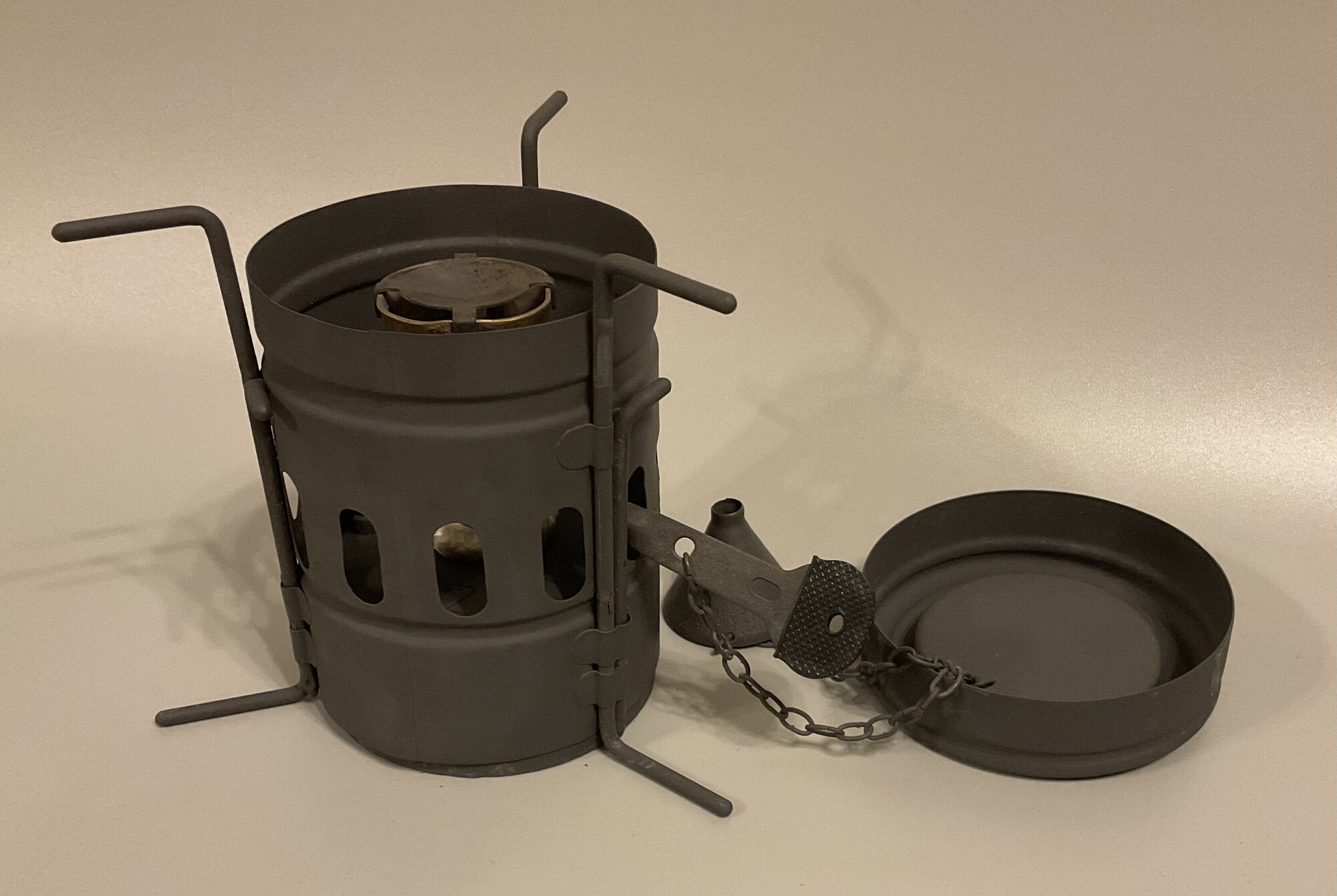

    In the picture above, the DĘBA is in its ‘packed-away’ condition with the pot-support section of the legs each swivelled inward to lock the lid in place…
    …whereby the lower section of the legs then secure the bottom of the DĘBA’s tank.

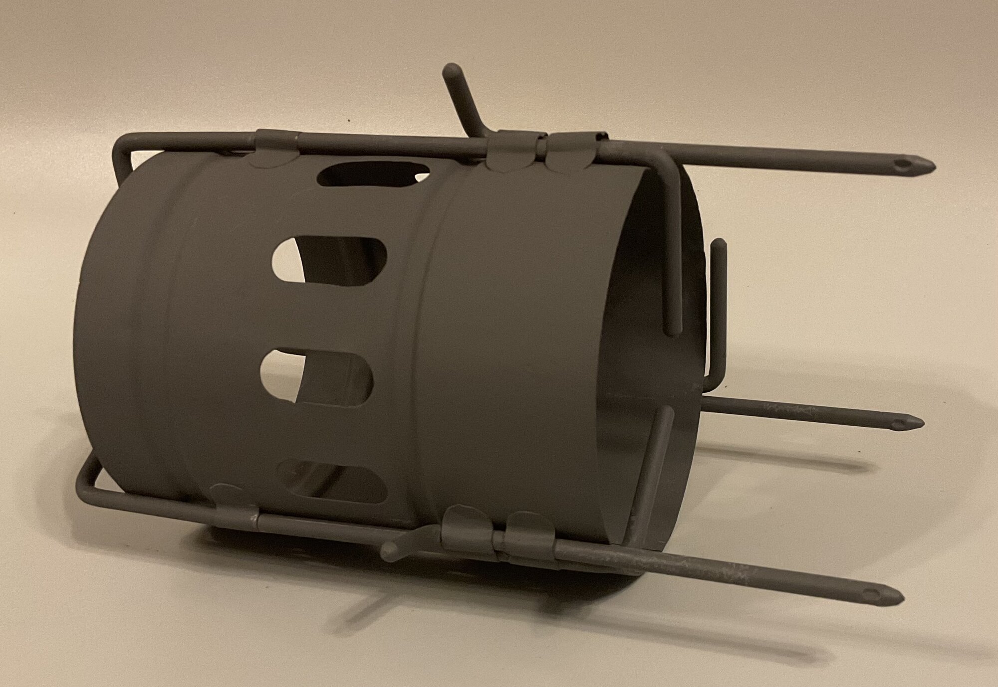

    This photo shows what I call the three ‘leg stakes’ having been extended from the windshield. These are designed to push into the ground to hold the DĘBA firmly in place. They are also highly effective in being able to locate and use the DĘBA on sloping ground if flat ground is not available. Something the Polish military would no doubt have found a very useful feature.
    The lid houses a ‘hinged’ inner container for keeping spare stove parts in. Both the operating key/wrench and funnel are connected to the inner lid by their own individual chains, therefore, preventing either from going ‘AWOL’ :)
    When opened, the spare stove parts are kept in place by a fabric ’pull-out’ cover’.
    In my case, a replacement wick and string to make a graphite seal for the spindle, were the remaining spare parts which came with my DĘBA.

    Tank stamping…
    The ‘Acorn’ logo of the manufacturer, Zakłady Metalowe „Dęba”
