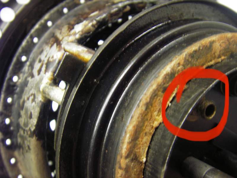

    This burner feeds itself. That is it should do so.
