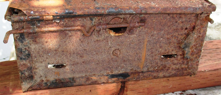

    1000007994.jpg OK, CL, it's a Clayton and Lambert. I couldn't find an exact match in the patent records, but found a very close model in a 1925 patent. During the patent research I found that the date on the base isn't the patent date for the device but just for the protective band around the bottom of the fount. It's a steel strap that rings the bottom of the fount and is fastened to itself with a slot and tab.
    PXL_20260614_151649756.jpg C&L used this on most of their fire-pots and plumber's furnaces. Fire-pot was the term C&L used in their catalogs and advertising.
