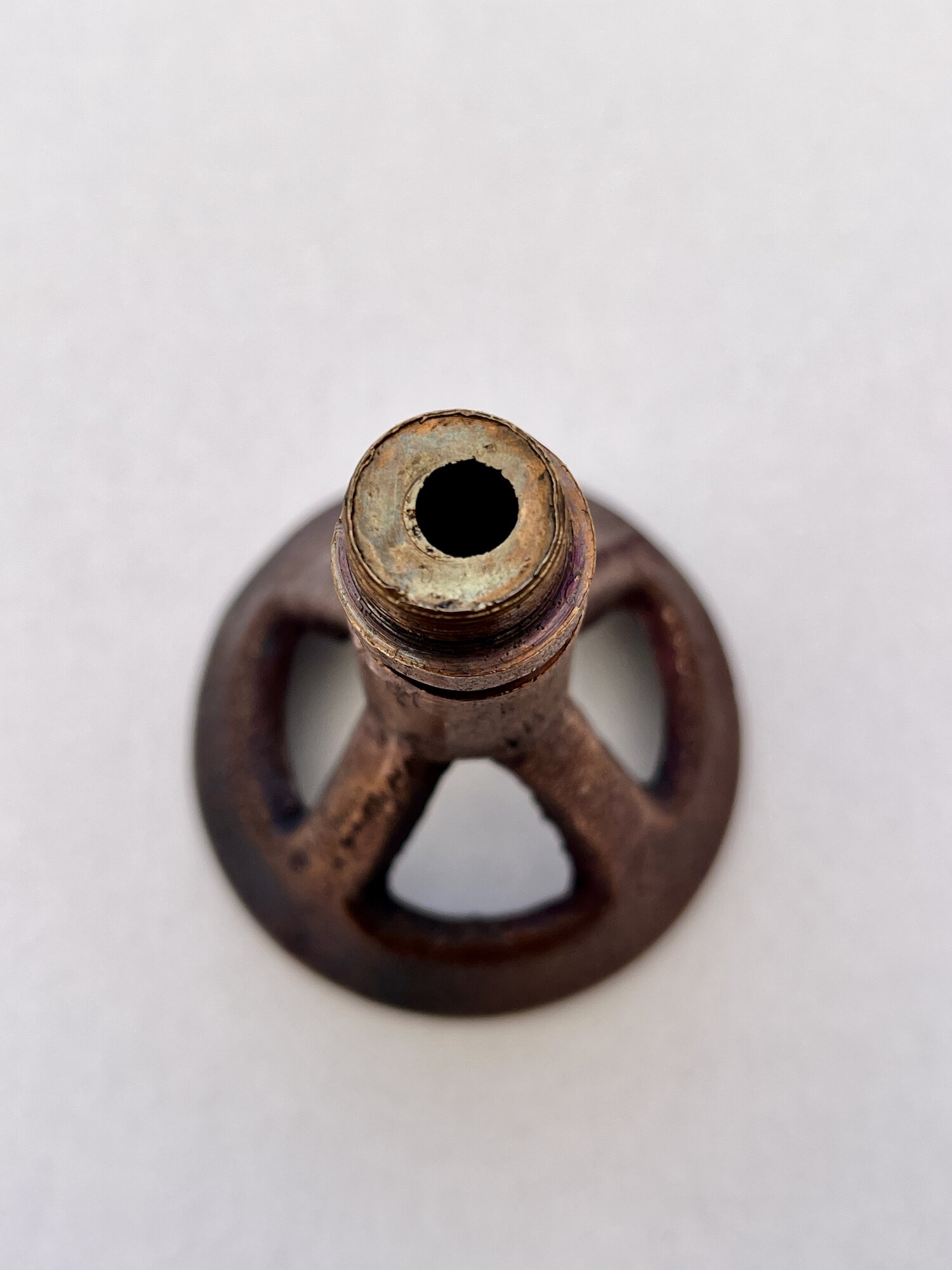

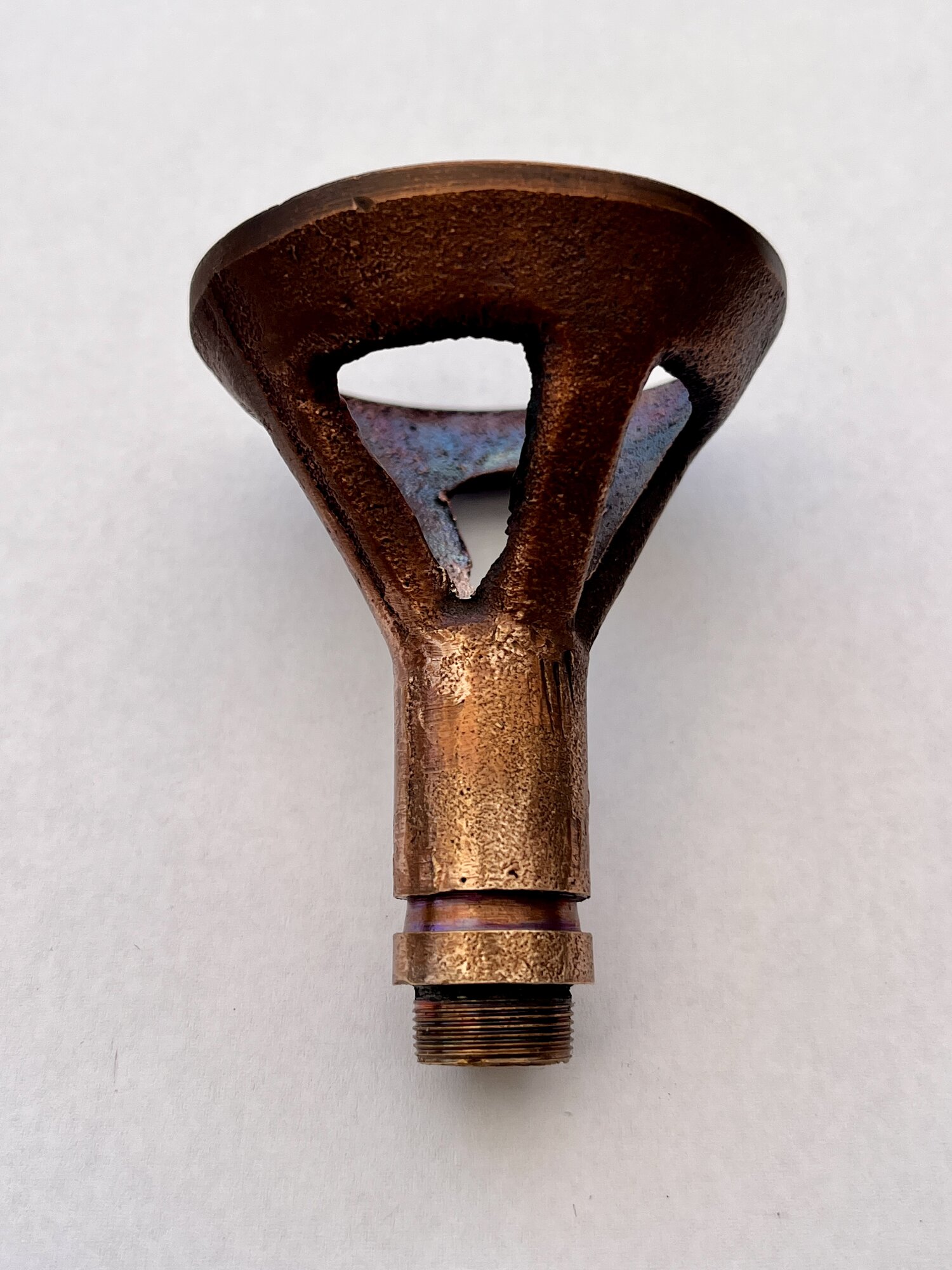

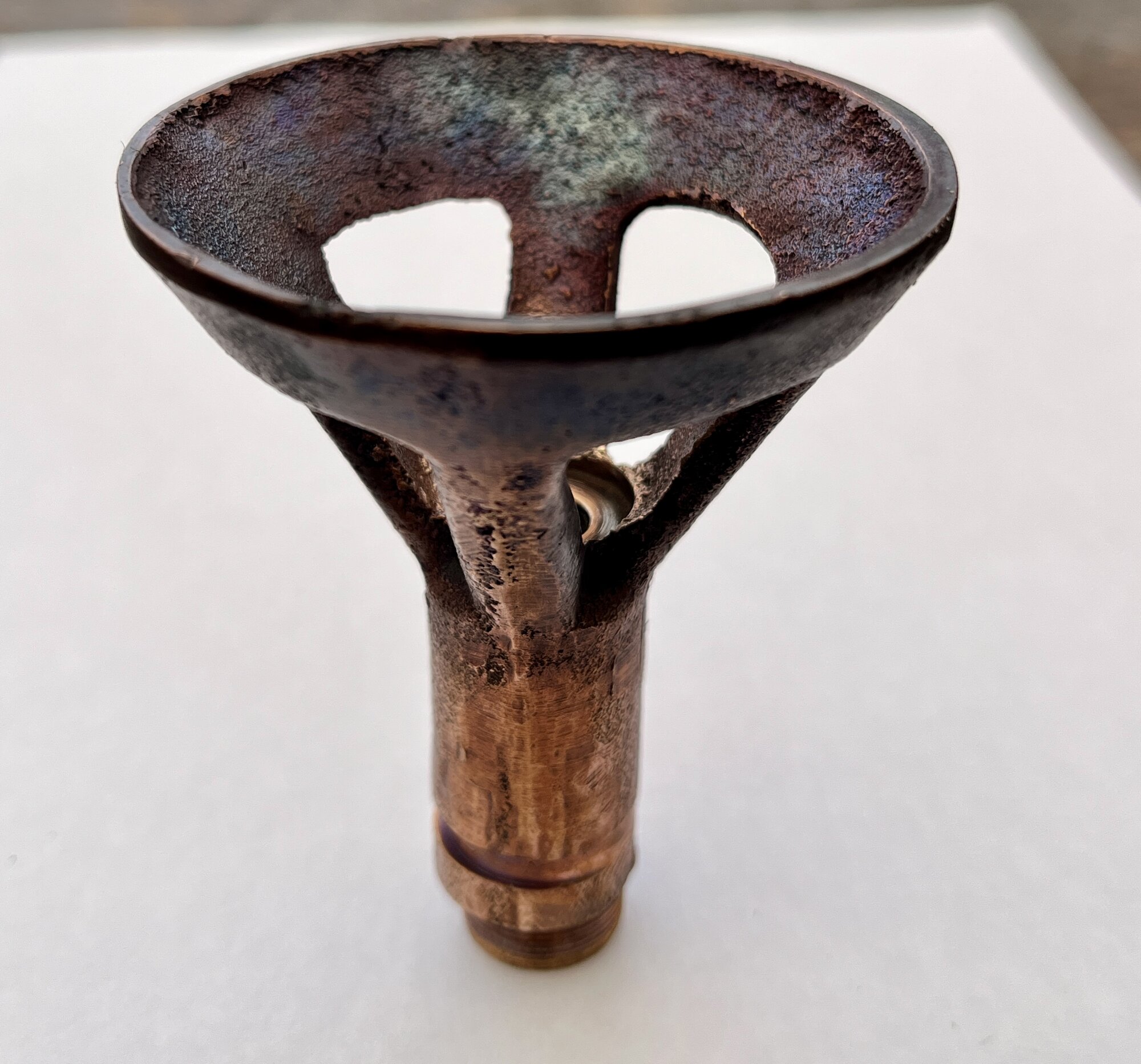

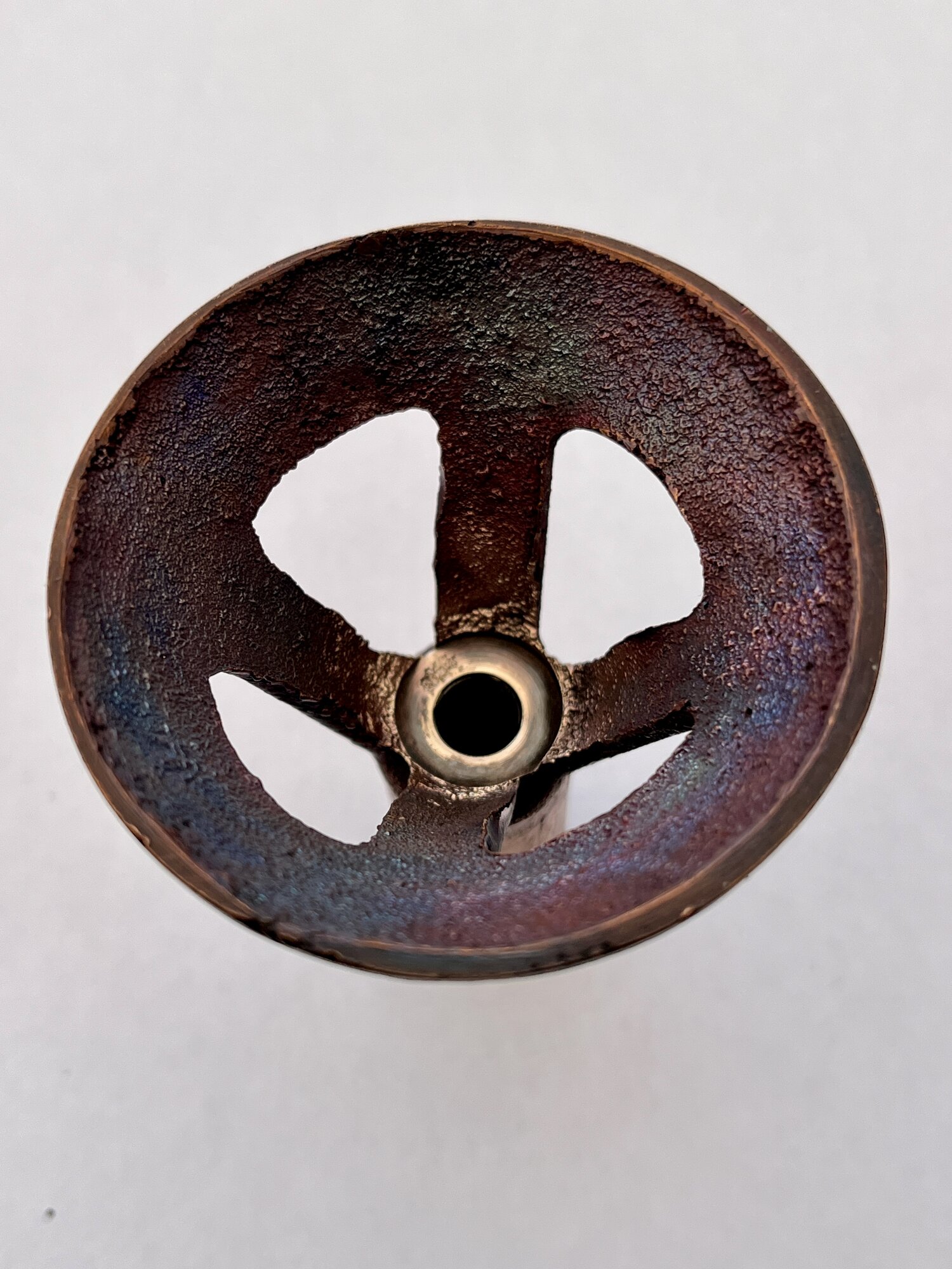

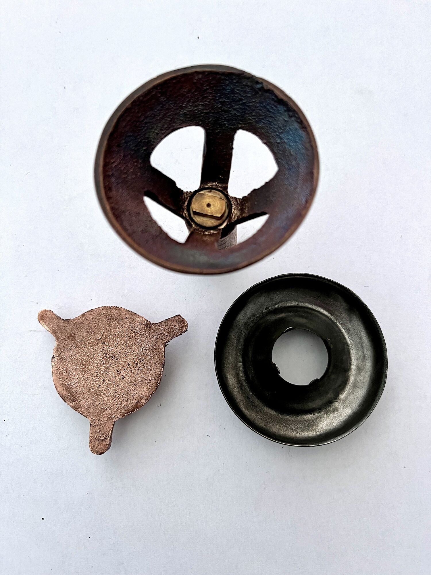

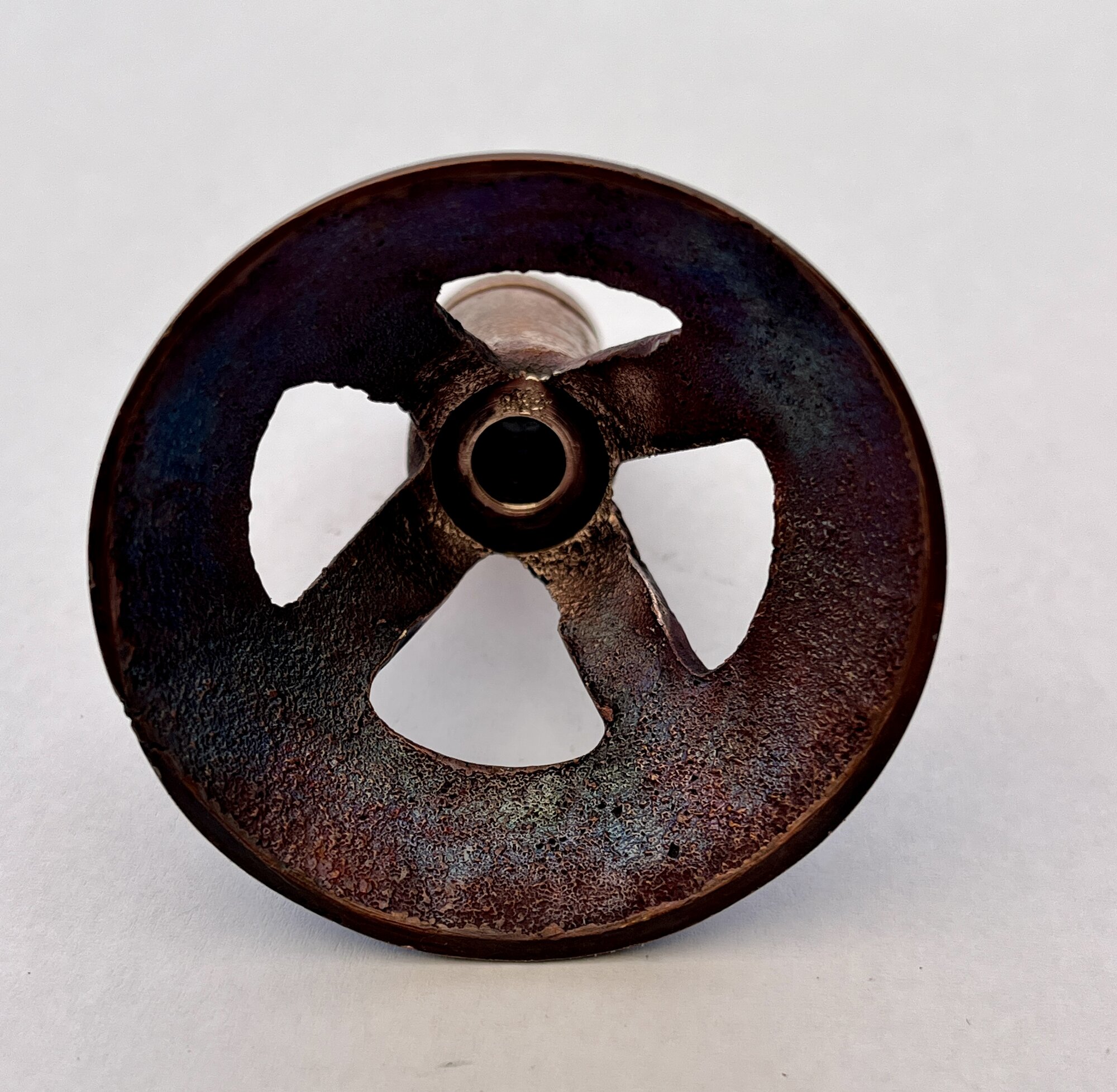

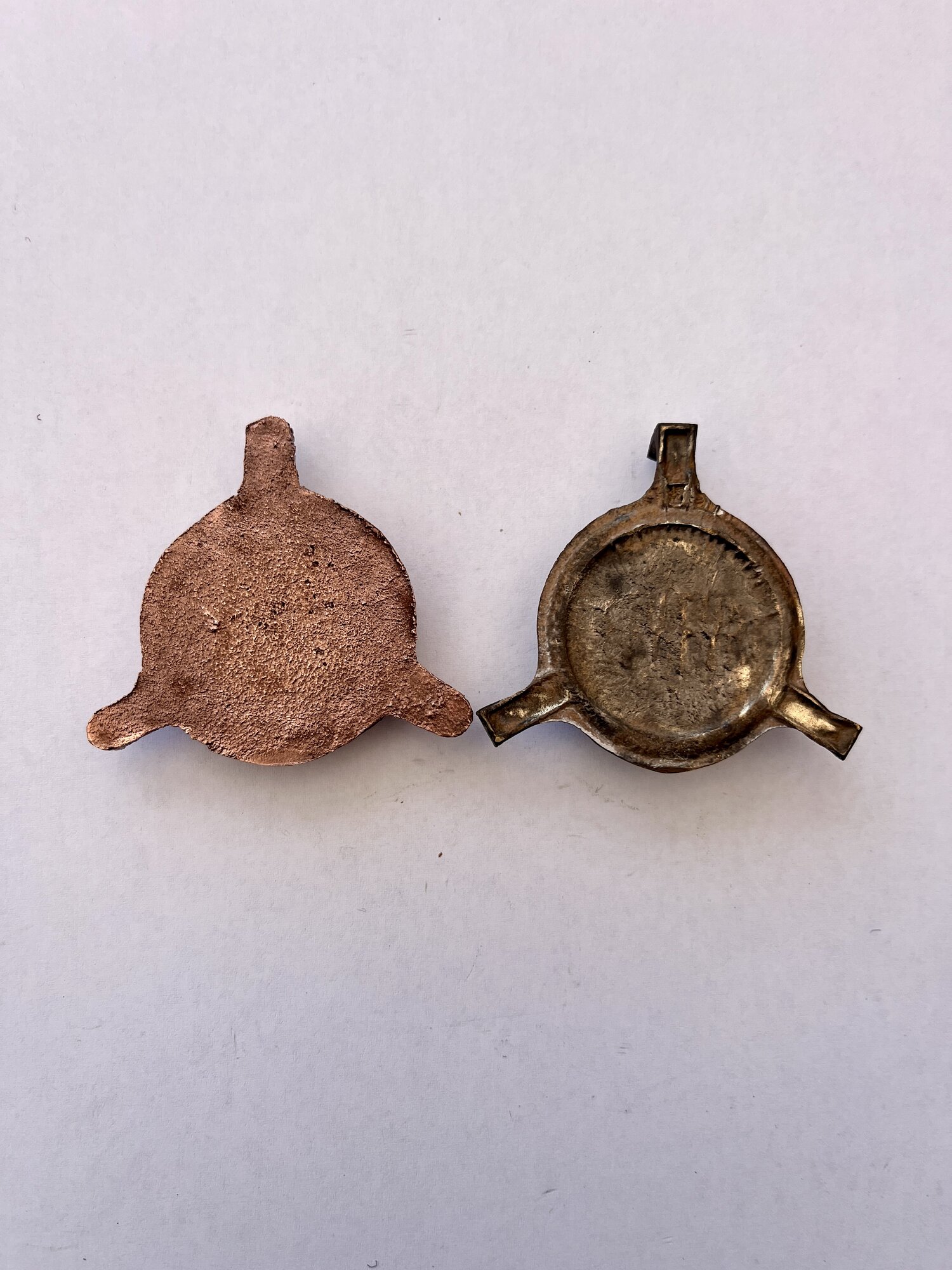

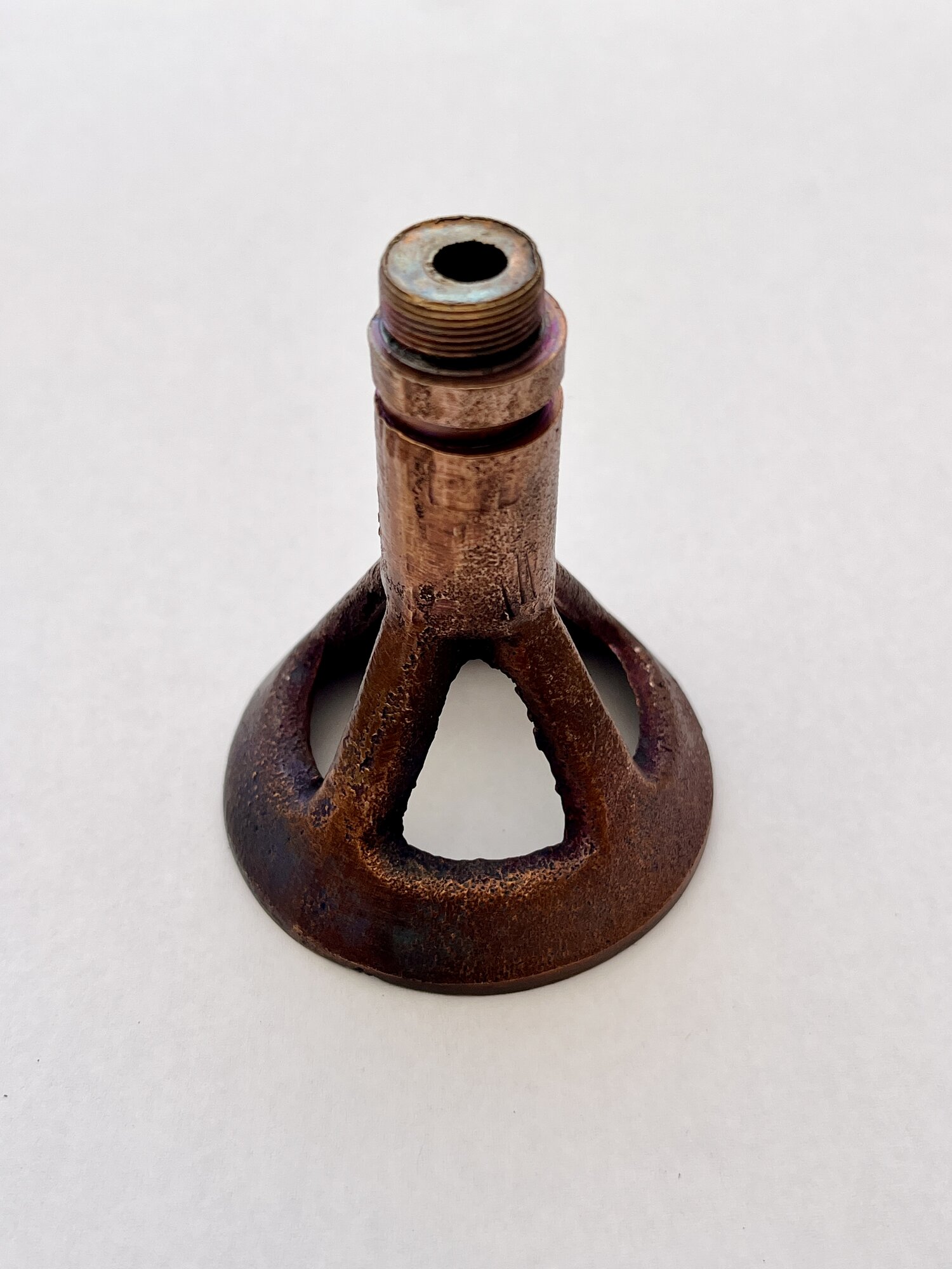

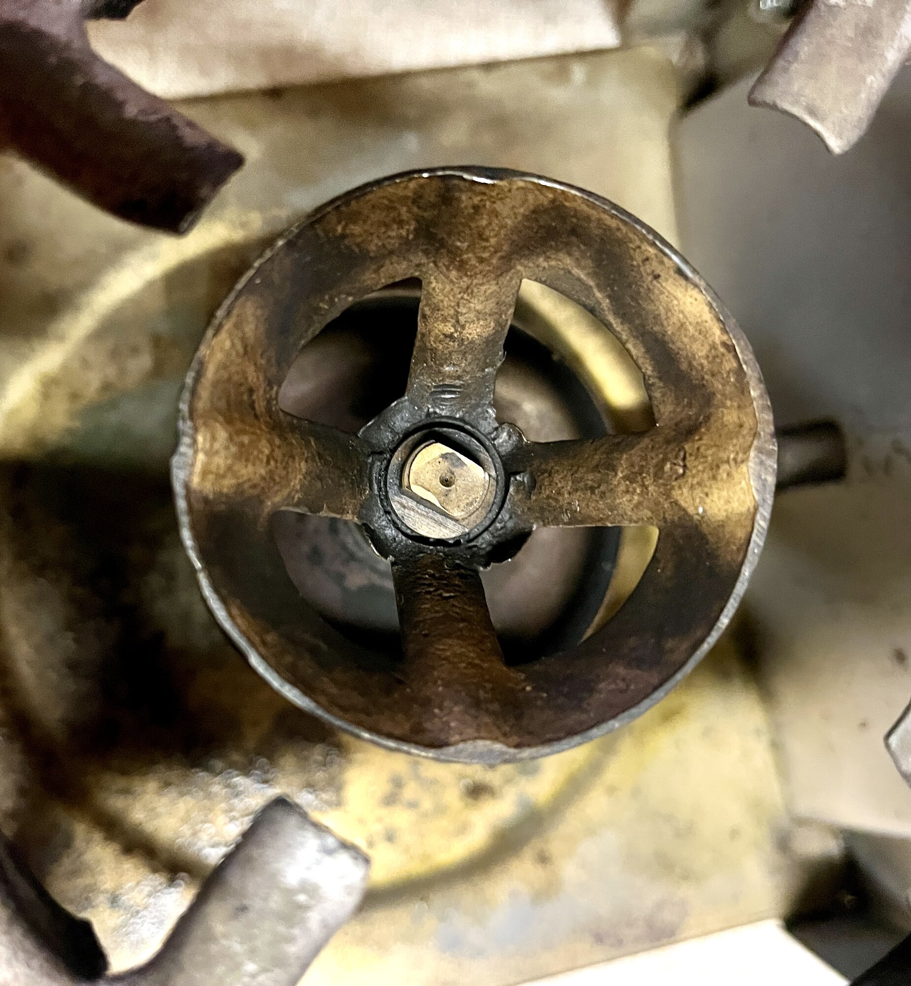

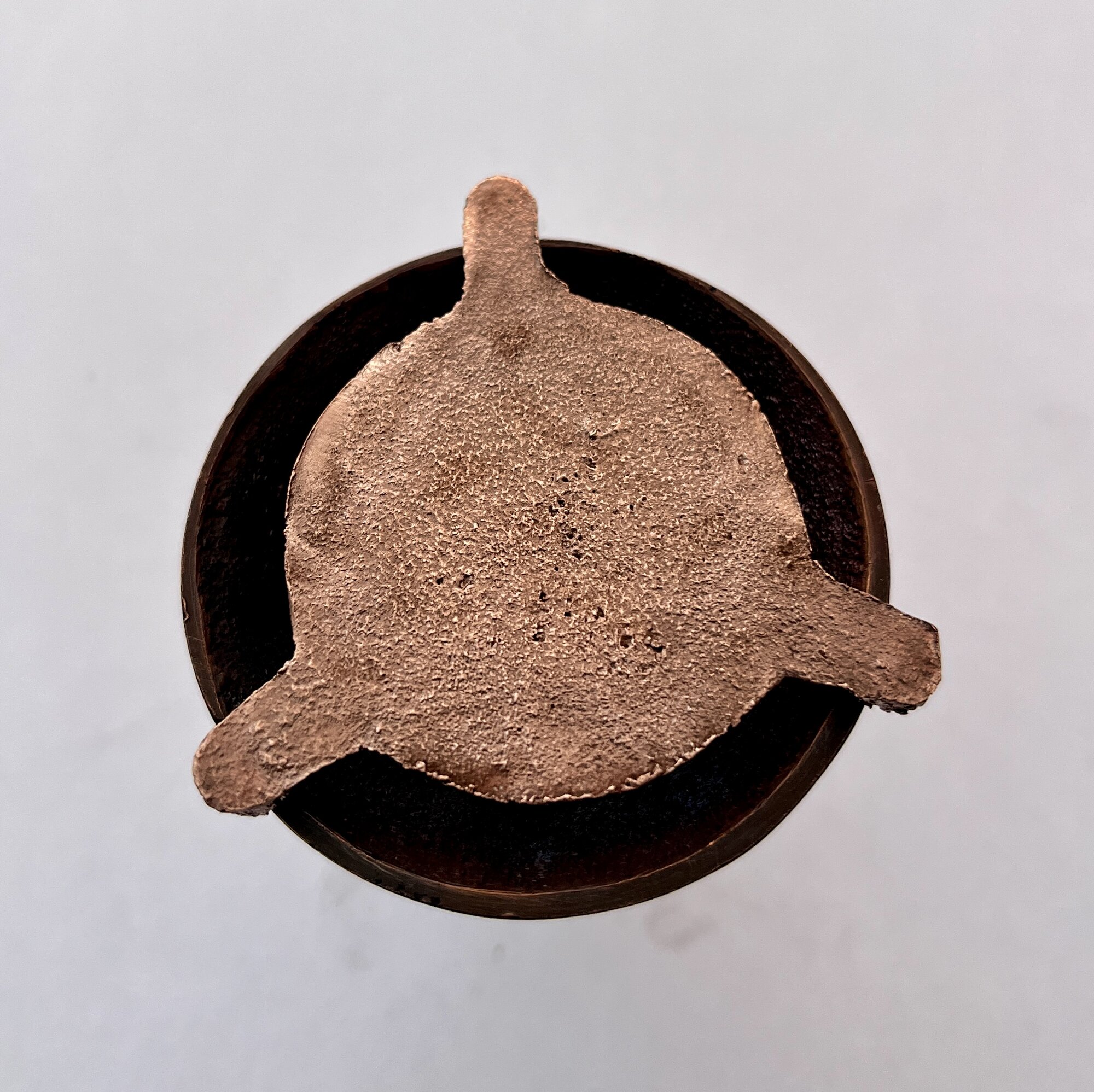

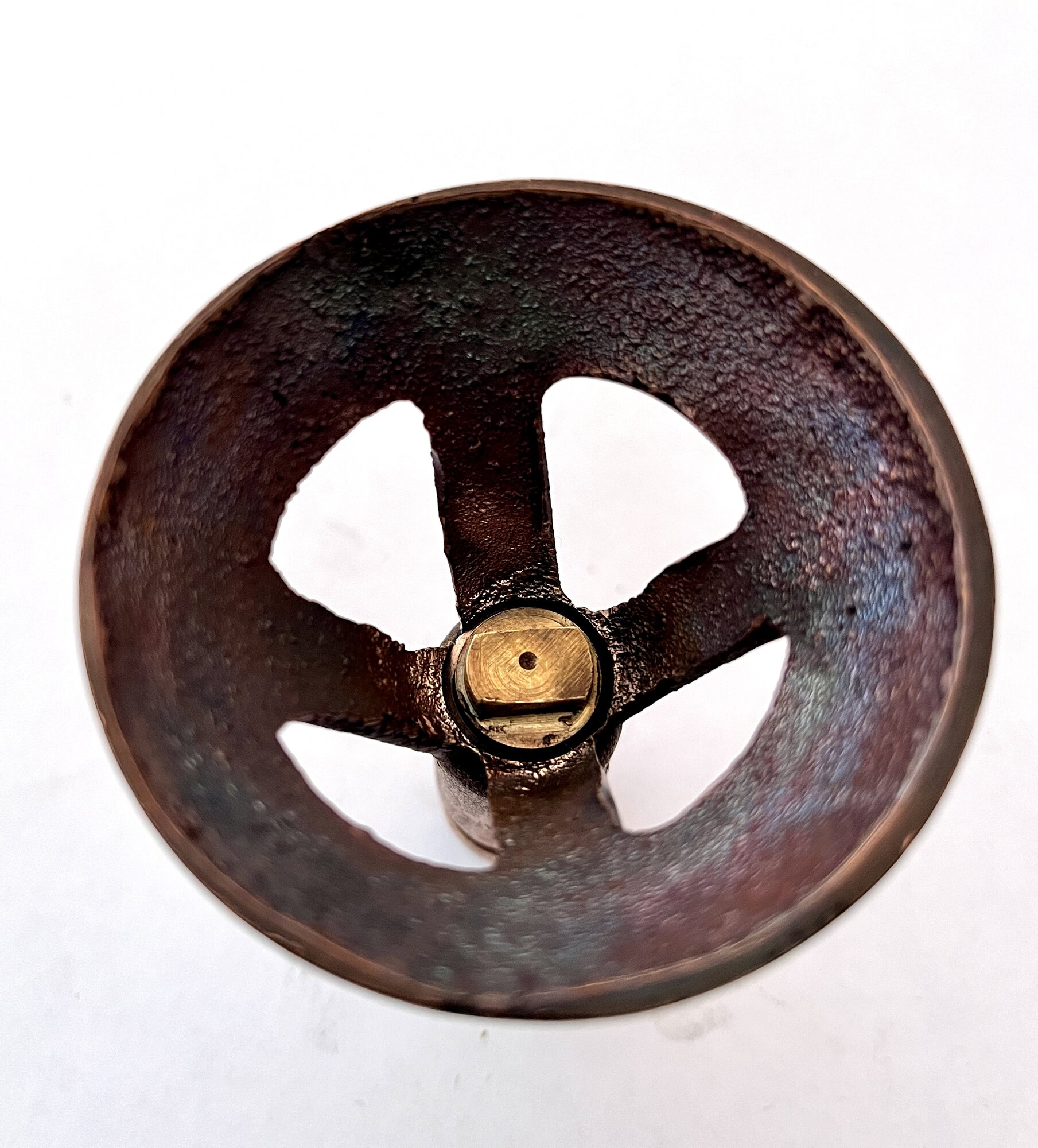

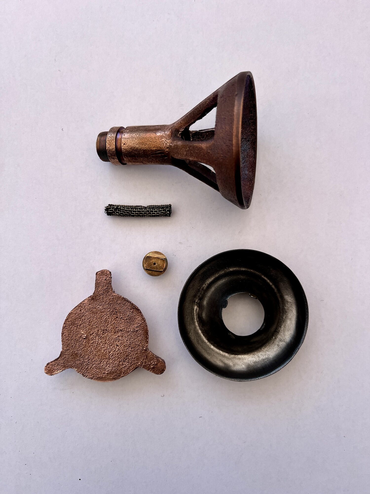

This is an Eezy-Fyre burner with an unbranded flame plate. I’ve posted it here as I wanted to show the make-up of one variant of the produced burner. It came on its own without a stove. One of the reasons Eezy-Fyre stoves require considerable priming is the mass of the cast brass burner and plate. The other reason is that it is a “straight through” vapourisation route to the flame plate: fuel goes straight up the riser to the nipple, filtered by a role of brass gauze. Therefore it requires the burner to be hot enough to sustain vapourisation of the fuel (kerosene). The burner without flame plate is 133g. The flame plate that came with this burner is 94g. The jet in the nipple is 0.32mm. Burner; brass gauze; cast flame plate, nipple, and steel spirit dish. Plain cast flame plate (94g) next to Eezy-Fyre branded cast flame plate (83g). This is the burner the branded flame plate came from. It is also a more “refined” cast. [Eezy-Fyre Stove] Cheers Tony
