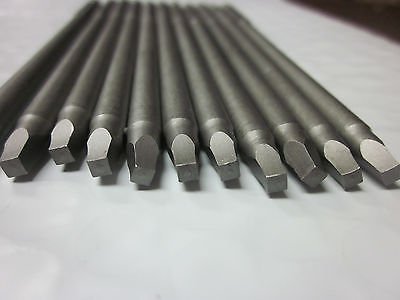

    Some alternatives from this thread https://classiccampstoves.com/threa...the-center-of-the-tank-cap.33108/#post-338265 if 'The Master SRV Tool' is not available:
    Square one is Roberts/Robertson #2 if I am not totally wrong:
