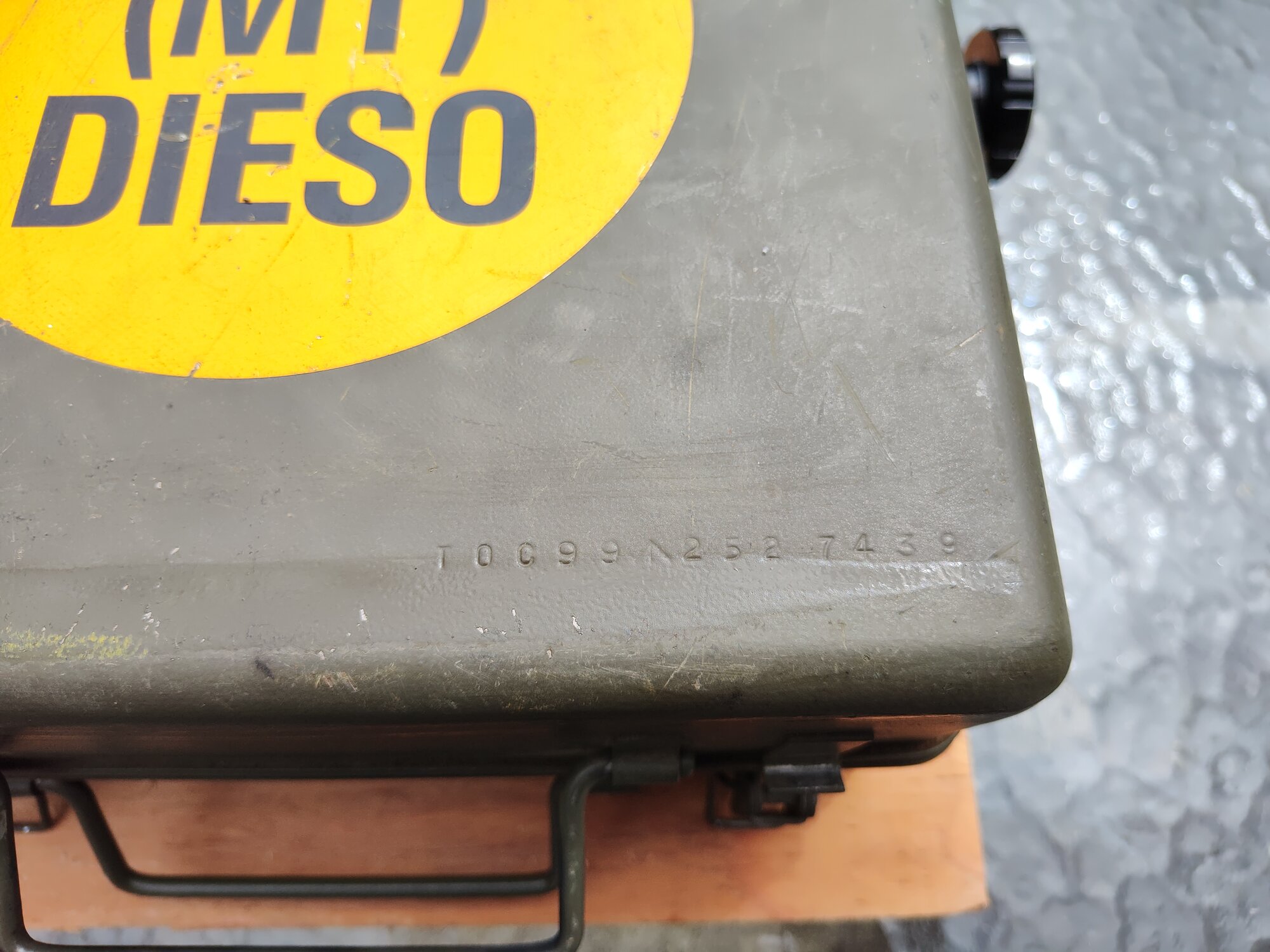

    1999 date code.

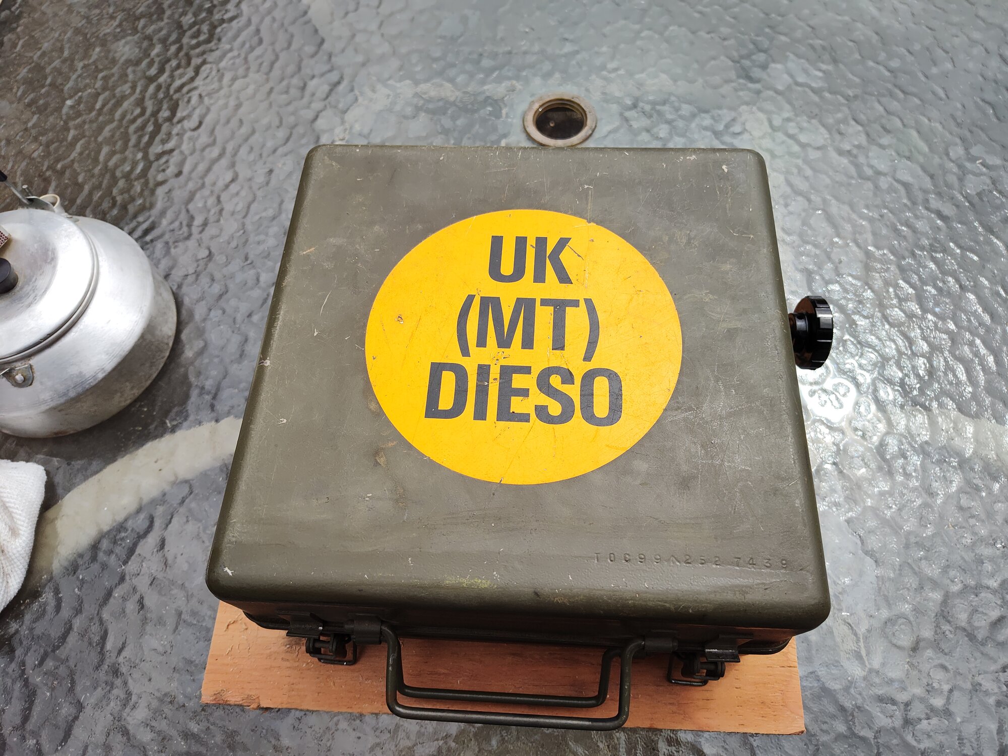

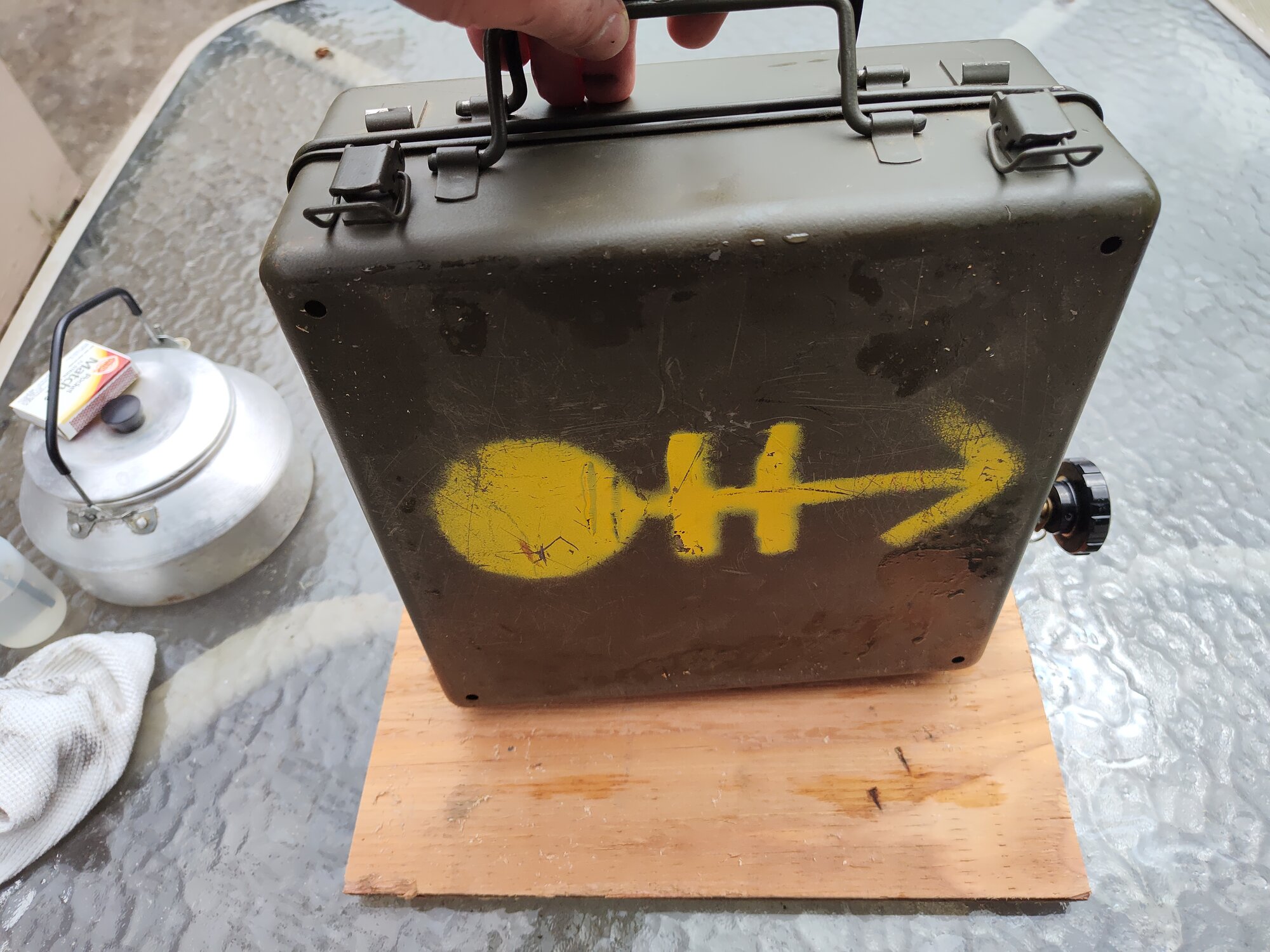

    Interesting markings on the outside. Spent some time googling meanings but came up with nothing. If anyone knows what the symbol and label mean, I'd welcome any help.

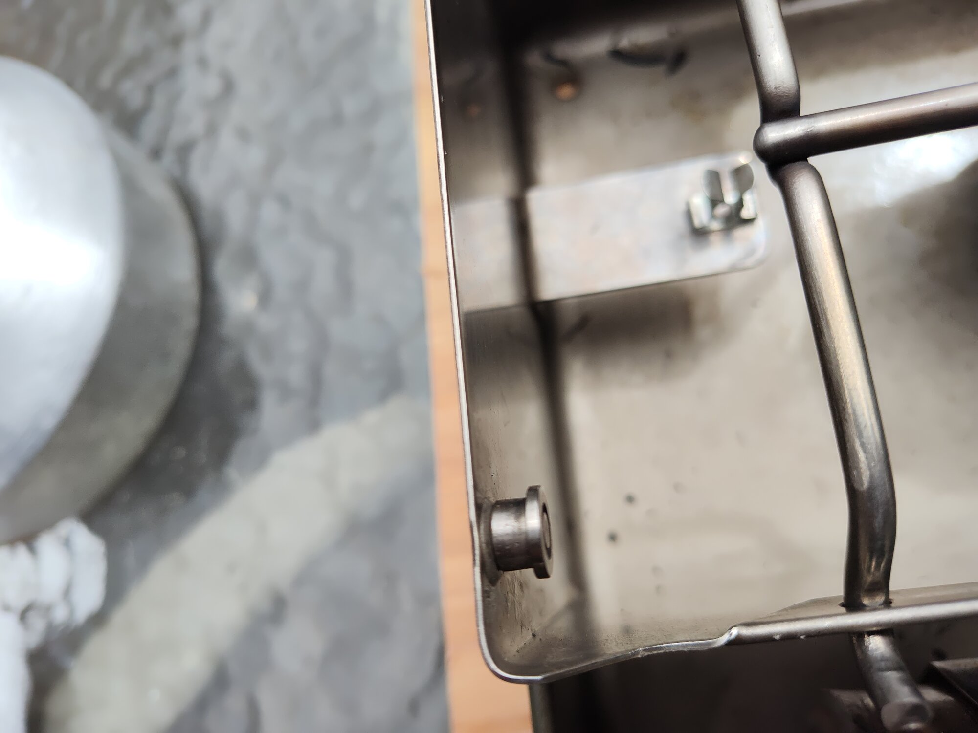

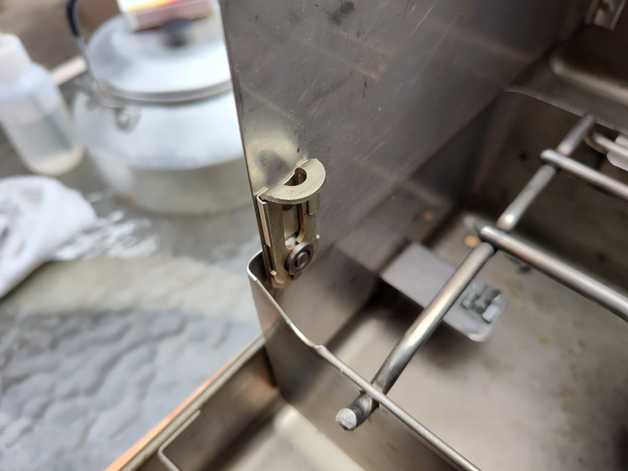

    Knew these were heavy, knew these were built solid, but didn't realize just how solid. The wind screen is stainless steel, and is as heavy as the steel that makes up the font on many other stoves. The clips holding the wind screen arms are stamped stainless steel and machined(?)! The font is tig welded stainless steel.

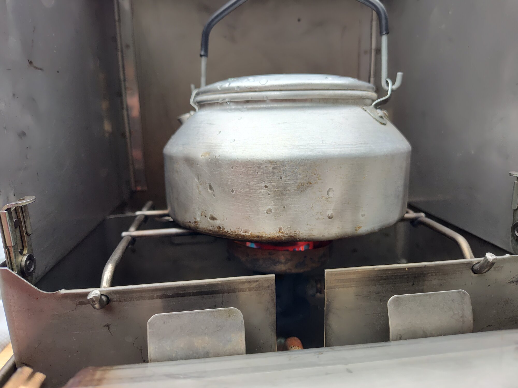

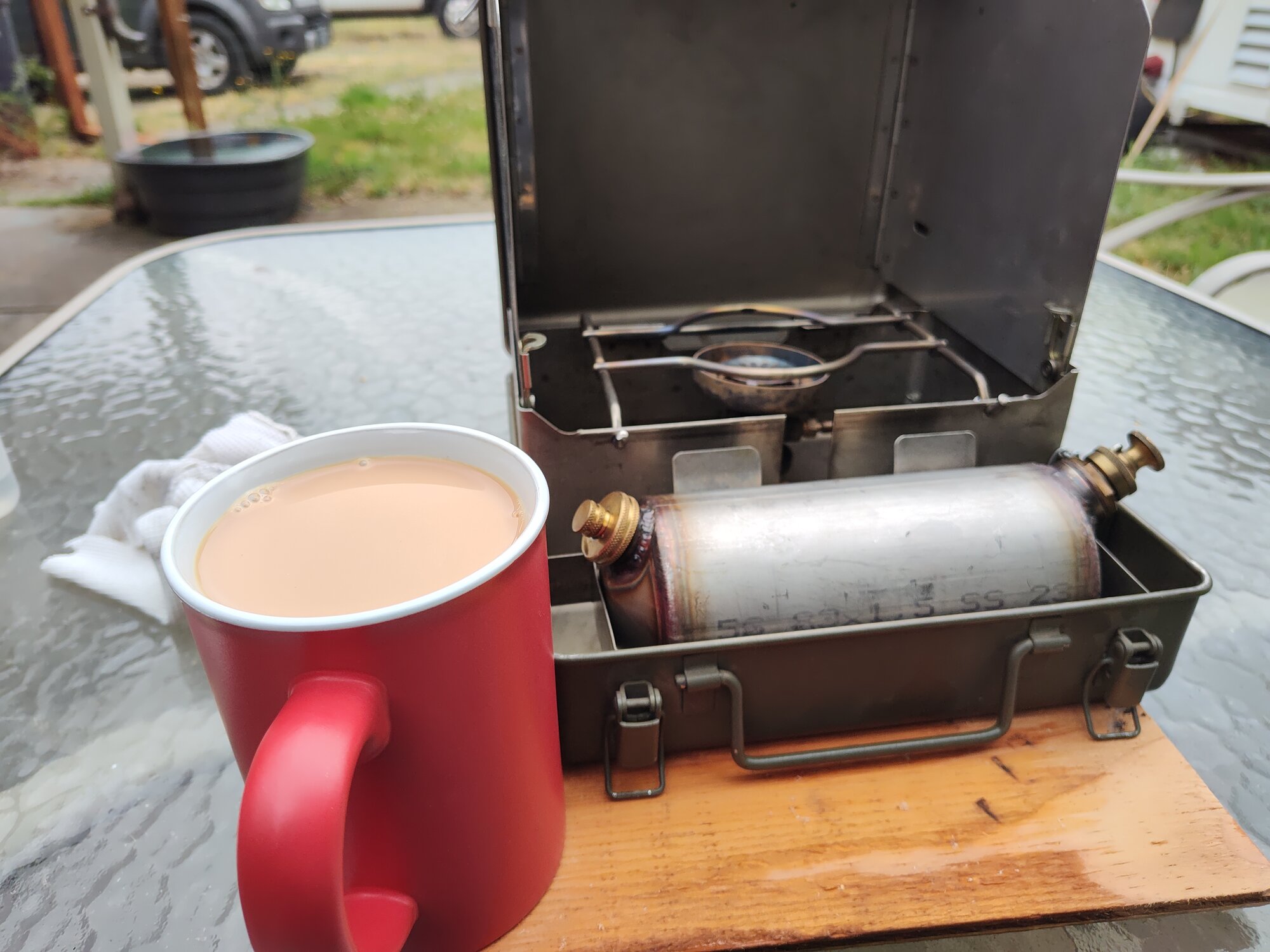

    Since I had it out, it would have been rude to not put a kettle on it.

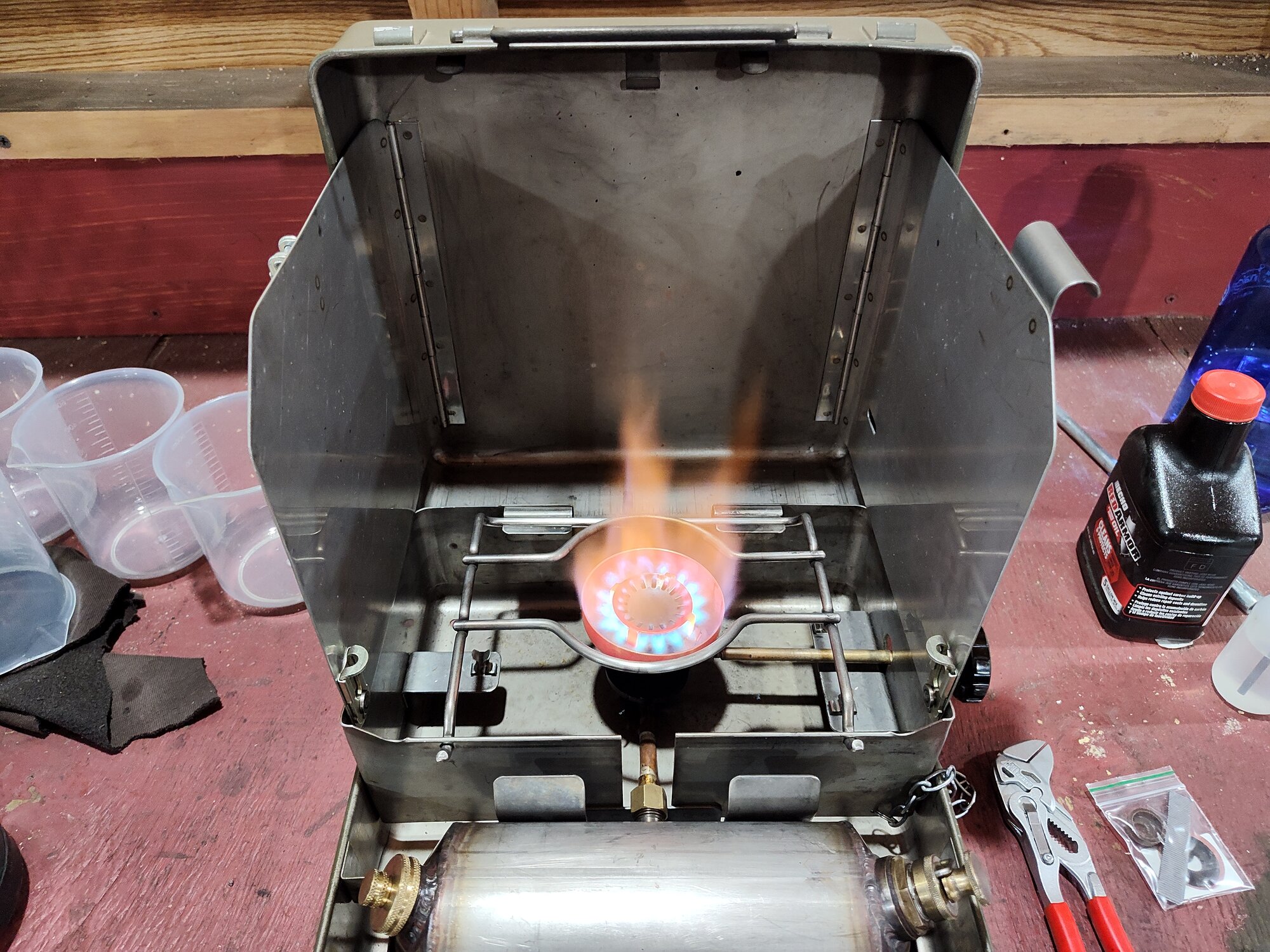

    Found the stove needed a double prime with alcohol to get burning initially, then careful ramp-up to full power as the burner heated and was able to vaporize fuel more readily. This might have been caused by using R99 renewable diesel, which is what happened to be in the first fuel can I grabbed. Flash and boiling points of R99 are ~40c higher than normal dino diesel.
    I wanted to try burning the stove on diesel, and will definitely take it to the woods and make a bacon butty on diesel, but will likely revert to kerosene for continued use. Less likely to coke up the burner, likely better manners in use, and the diesel had a bit of an odor of unburnt fuel when in operation that can't be healthy. Hoping that odor is gone with kerosene use.
    Thanks folks. Land Cruiser is in the shop at the moment, but once it comes back it'll be bacon butty in the woods time. Stay tuned.

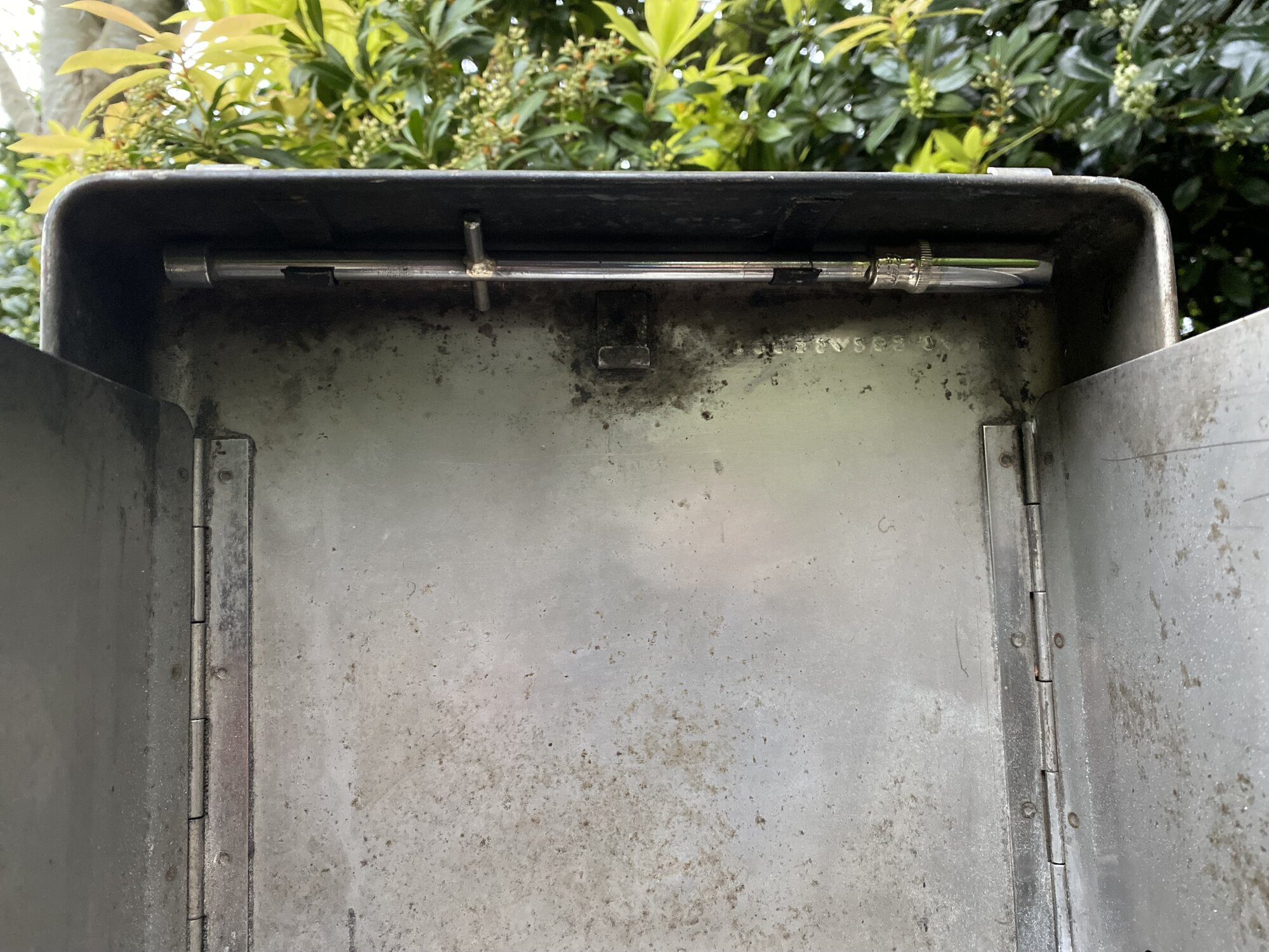

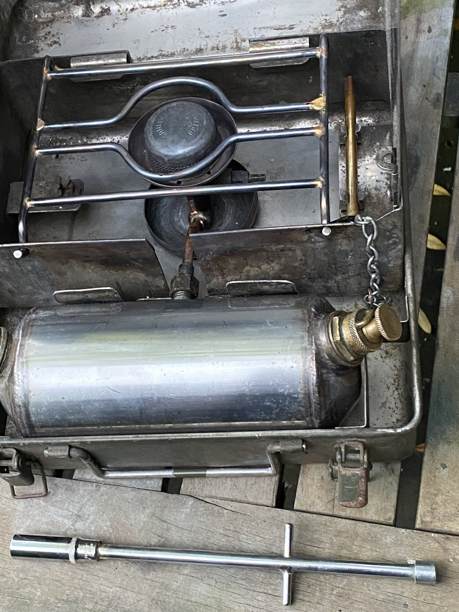

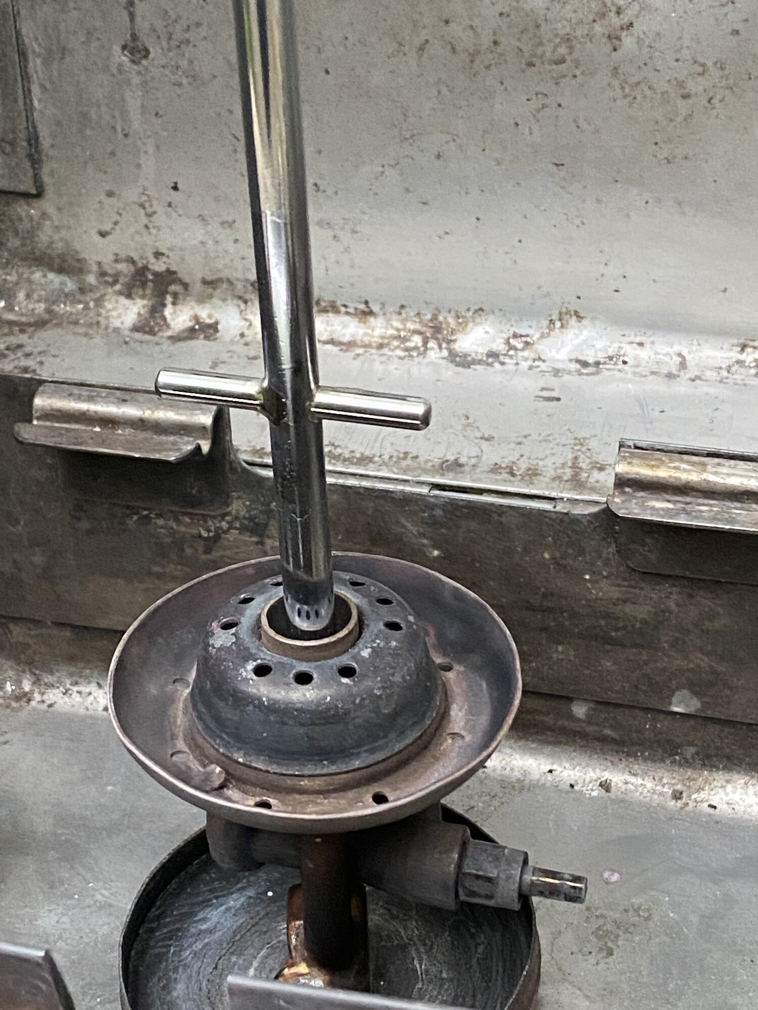

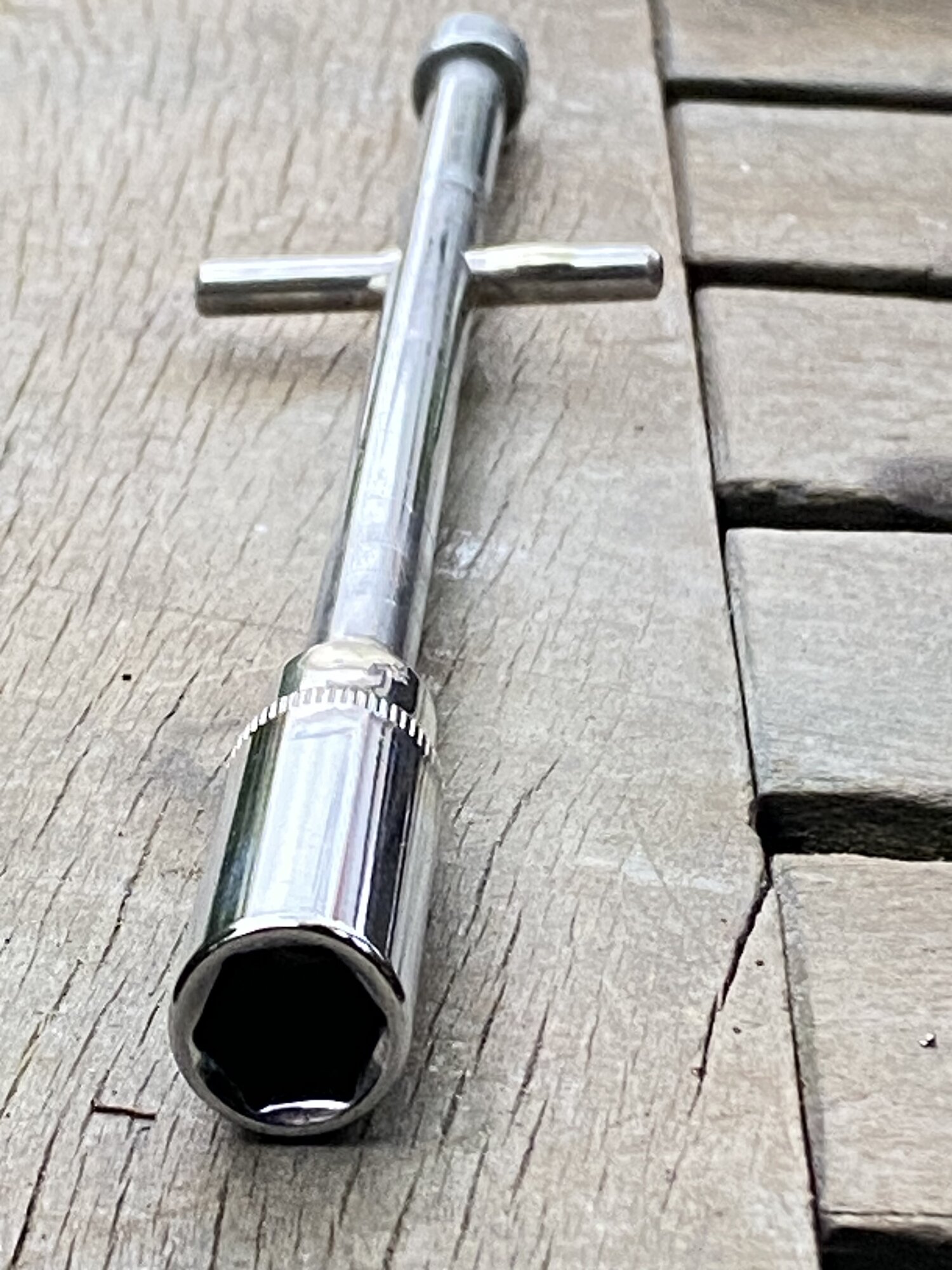

    At last eh?!! You’re probably right to use kero instead of diesel.

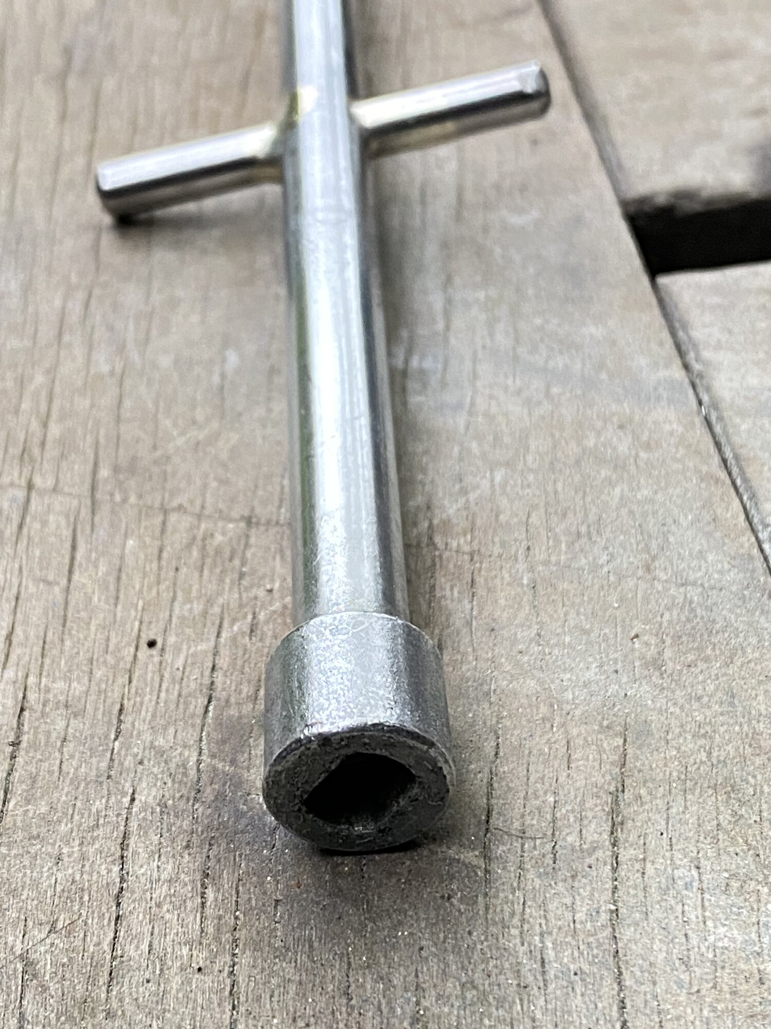

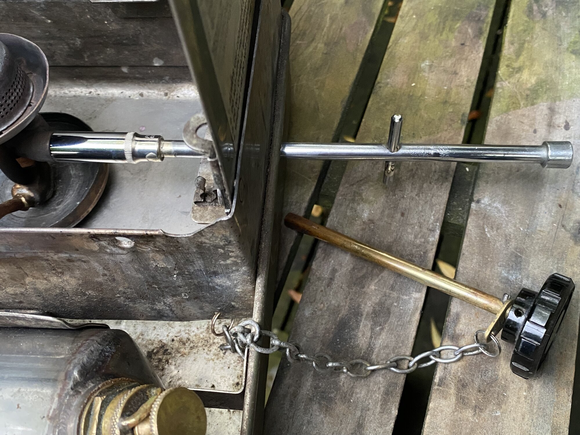

    I’m not sure if you have the multi-tool that stows in clips in the lid, but no big deal if not.
    It’s possible to fabricate one using a ‘long’ 10mm socket and NRV wrench.
    IMG_5786.jpeg IMG_5787.jpeg IMG_5789.jpeg IMG_5790.jpeg IMG_5788.jpeg IMG_5785.jpeg

    John, yes it came with the multi tool.
