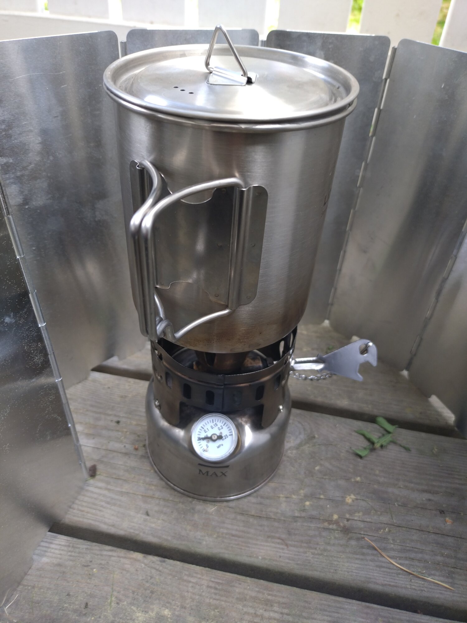

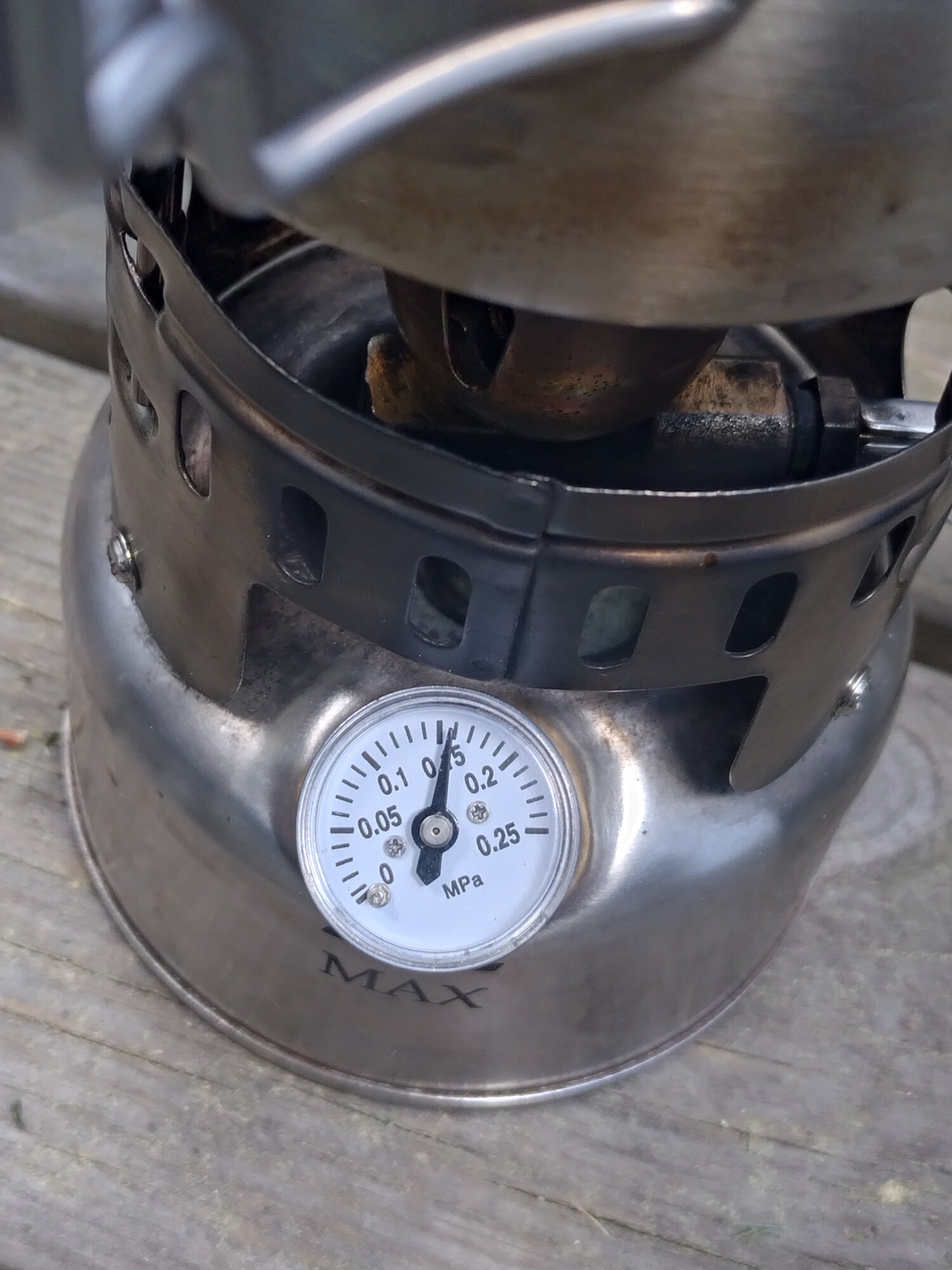

    I found a fuel cap with pressure gauge for the g43s from AliExpress. As a test I boiled some brown rice and monitored the pressure readings.
    This is what my setup looked like. I ran the stove on full power to get the water to a boil and then turned it to a level that would just maintain the bubbling. For the first ten minutes the pressure kept rising steadily for 0.01 Mpa per minute. After that the pace slowed finally reaching 0.15 Mpa or 1.5 bar or ~21.75 psi. The pressure stayed at this reading until turn off.
    Total boil time was roughly 25 minutes. After turning the stove off the pressure increased another 0.01 Mpa. The fount was hot for the most of the time but I was able to touch it for a second or so. This gave me a bit more confidence using the g43s for more than just quickly boiling a kettle.

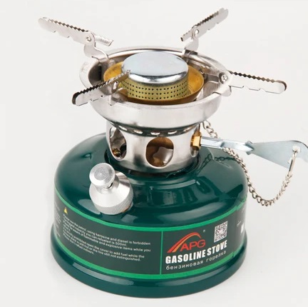

    Funny your burner head is larger than what most of these come with.
    Looks like the the Iwalker G43-S stove, basically the same stove but a wider silent burner head.
    I swapped such a head off my green APG Silent burner stove and found it to be less efficient.
