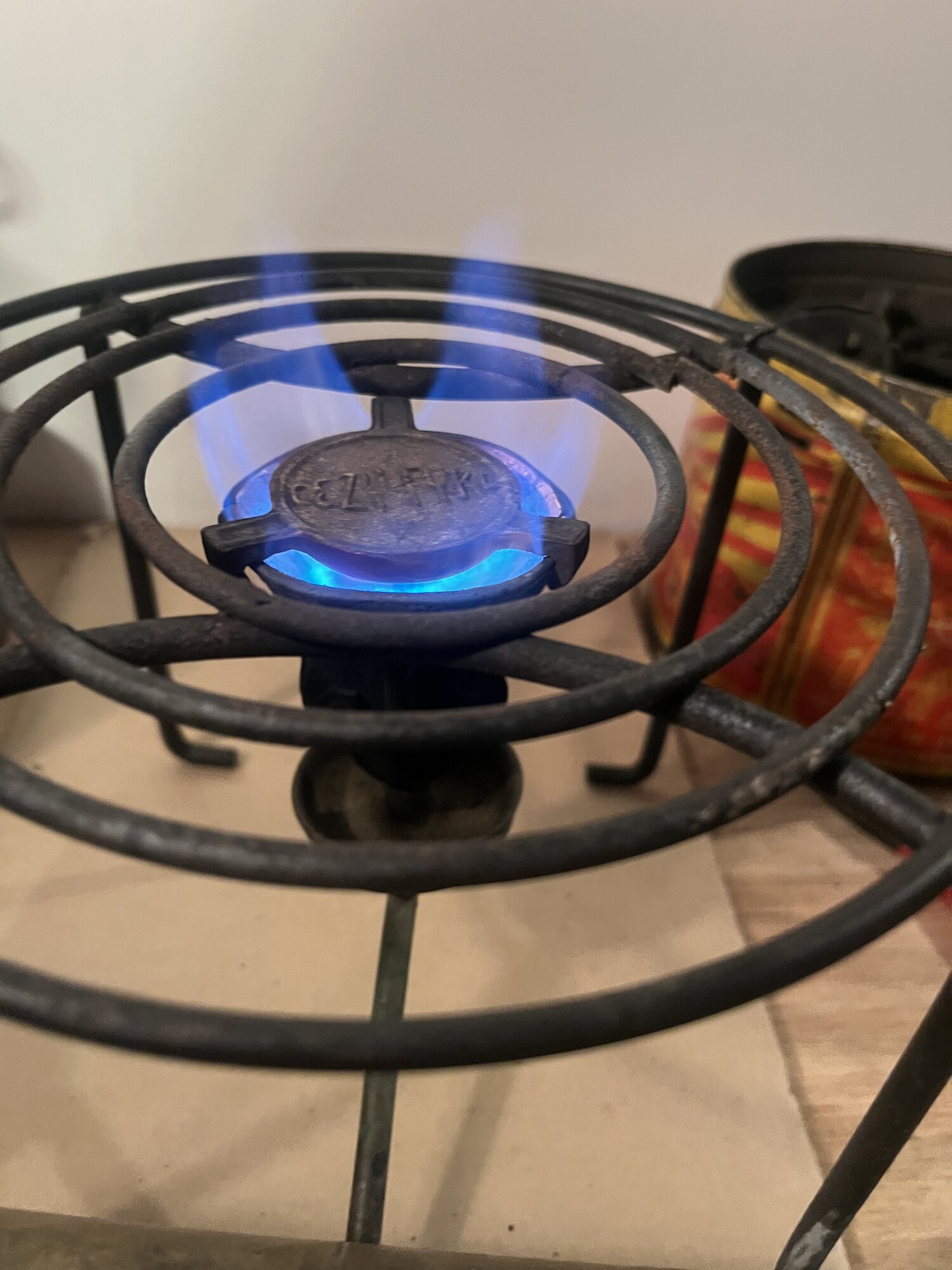

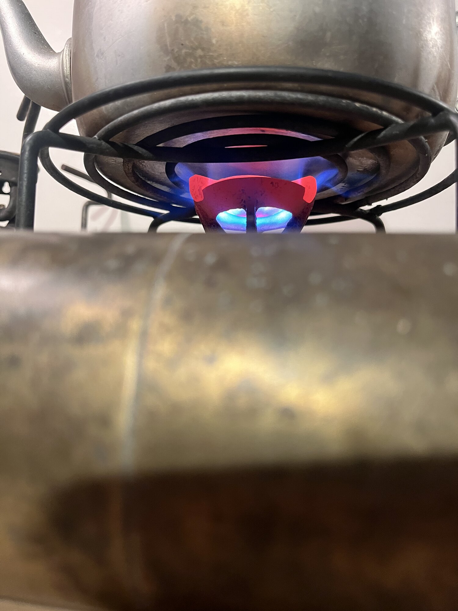

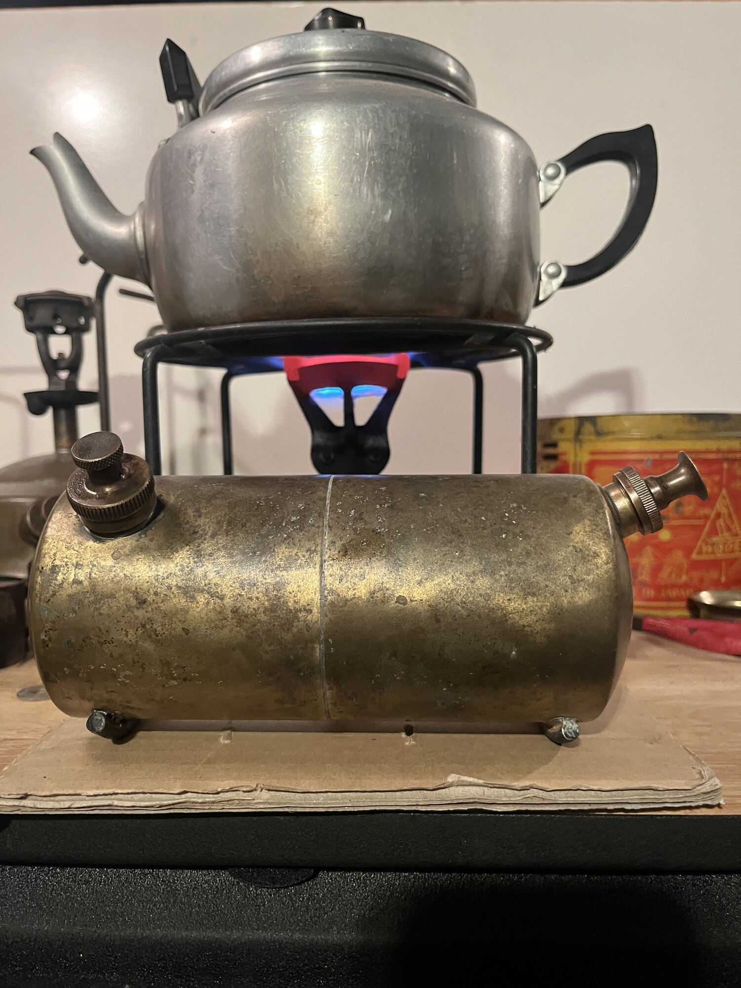

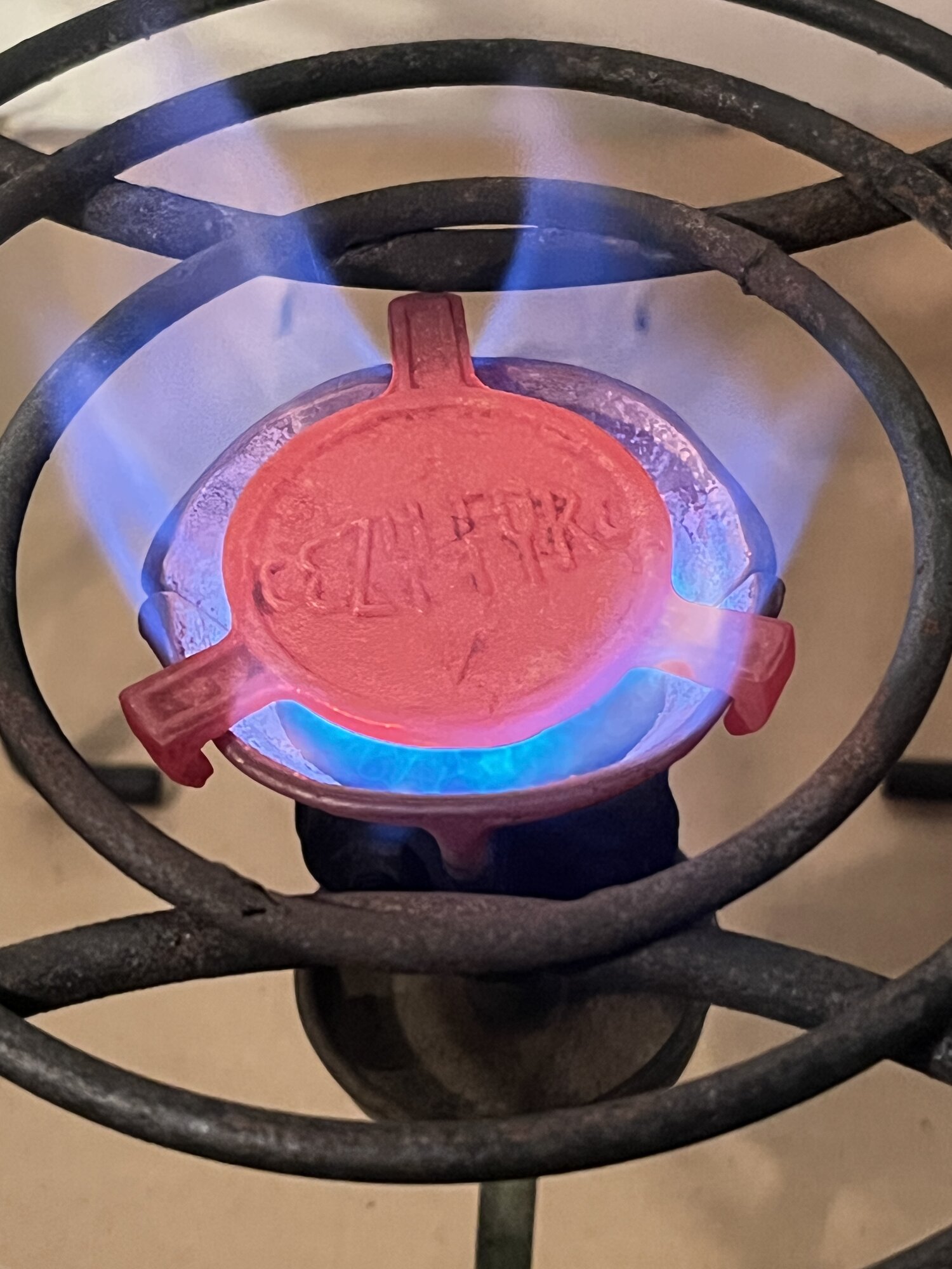

    It’s been a busy few months since Rodger’s post above and now, but in the meantime I bought some spare bits and pieces that included an Ezy-Fire heavy brass burner plate.
    I though this burner plate would do the job on this peculiar Heatapan burner, but when Rodger was here last time we were fiddling around with the old Svea No.1 burners and didn’t get to fire up the Heatapan.
    So, today I got some time to try it out: the Heatapan with the Ezy-Fire burner plate. —> Excellent results!
    Notes:
    Kerosene fuel; 0.32mm jet; requires adequate preheating.
    @Rodger Willows @Blackdog

    Almost like it's animated.
  6. Rodger Willows
    Rodger Willows Subscriber
    Mar 7, 2017
    425
    Tasmania
    @Tony Press
    It certainly burns well with the EZY-FYRE flame plate!
    I’m thinking you might have needed 2 (or more) preheats and judicious flame control to bring it up to that glorious glowing red…
    Great work!

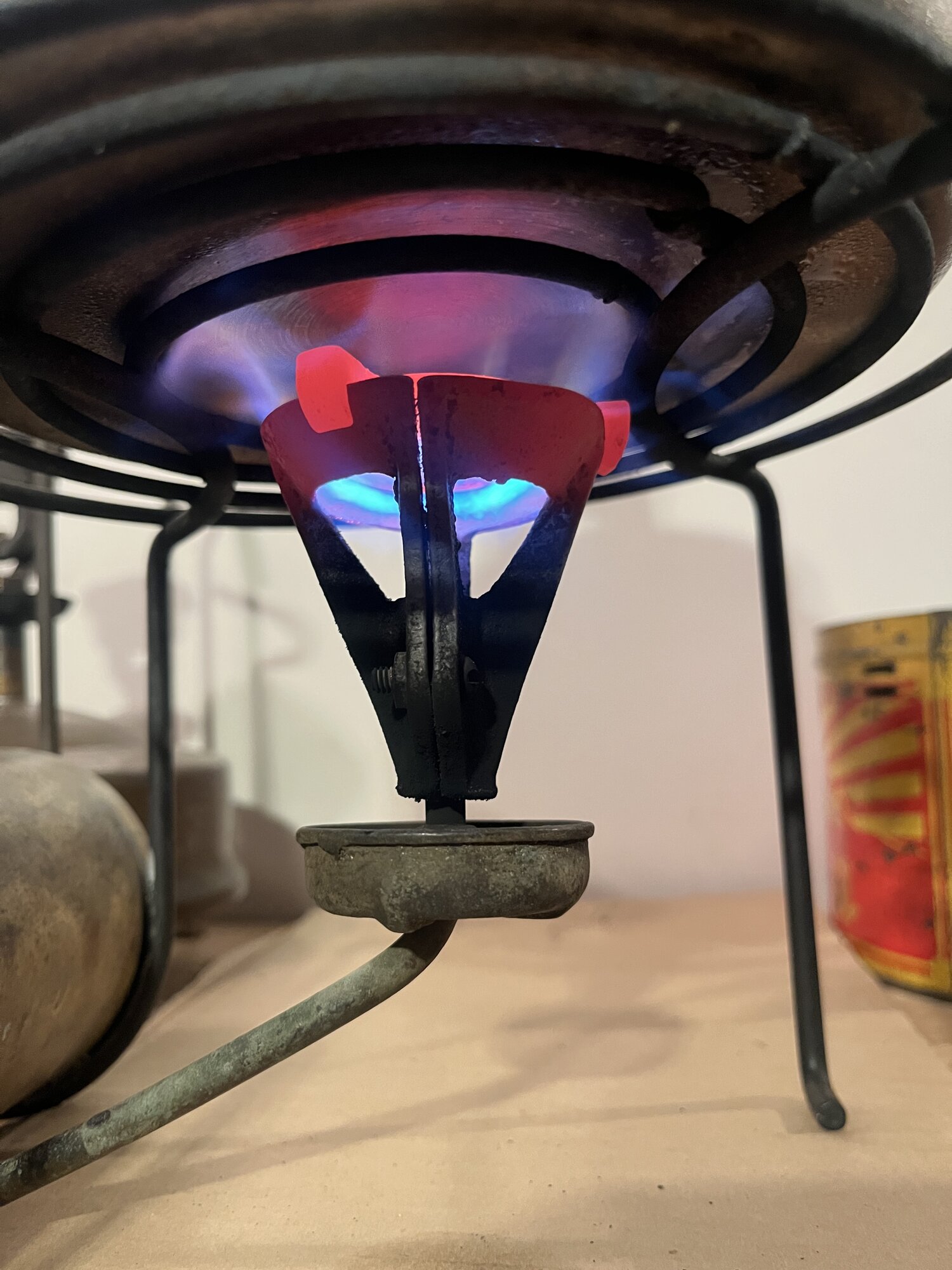

  8. Blackdog
    Jan 7, 2009
    3,483
    Dreaming of snow
    That flame plate is a beautiful casting, it looks a little delicate though. I suppose the same could be said for the two-piece cast burner bell. The whole stove is a great piece of design though, what a shame they are so scarce!
    It certainly seems to like having the full volume of the burner bell to achieve a good mixture, in other words a burner plate mounted high.

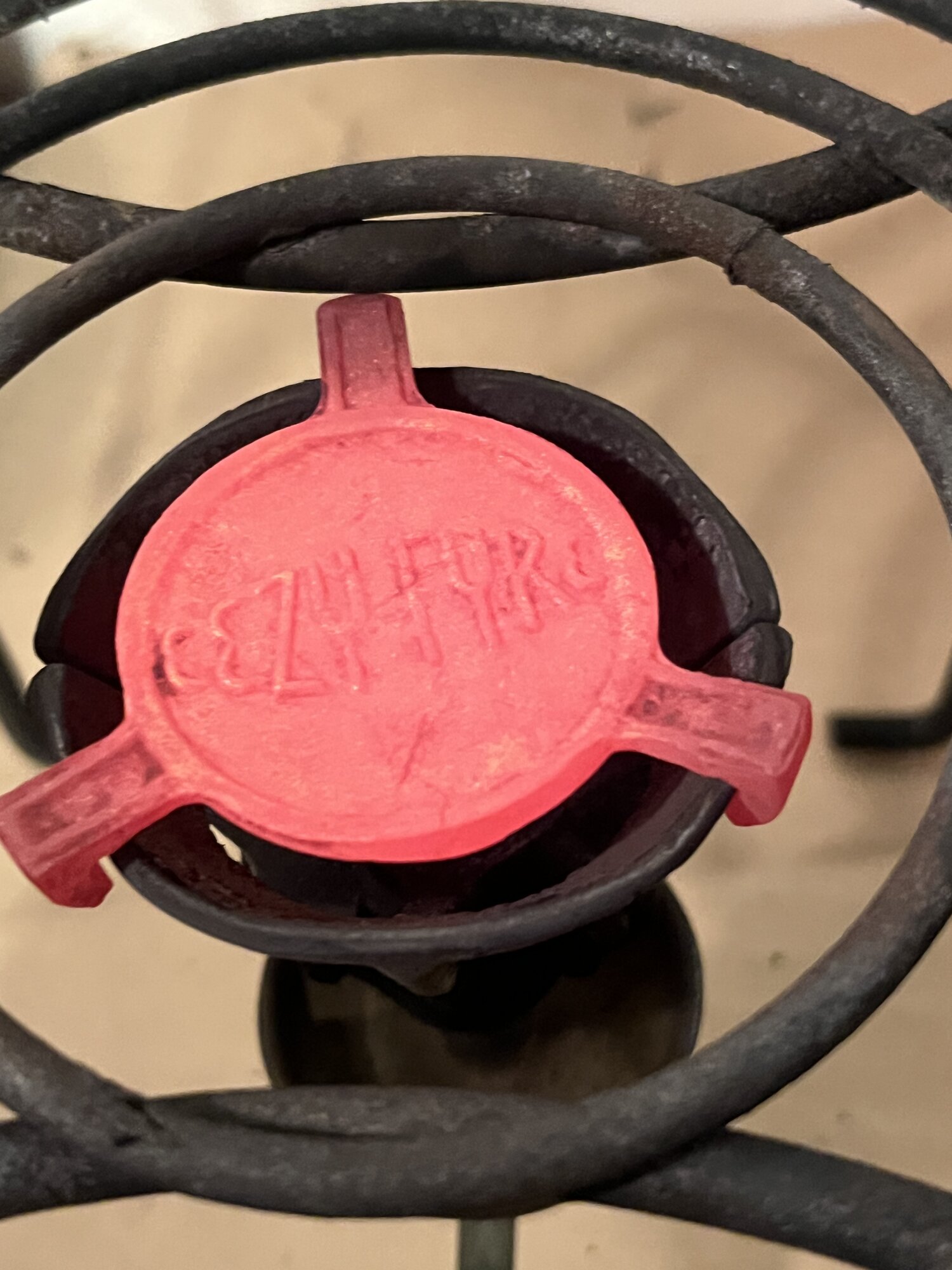

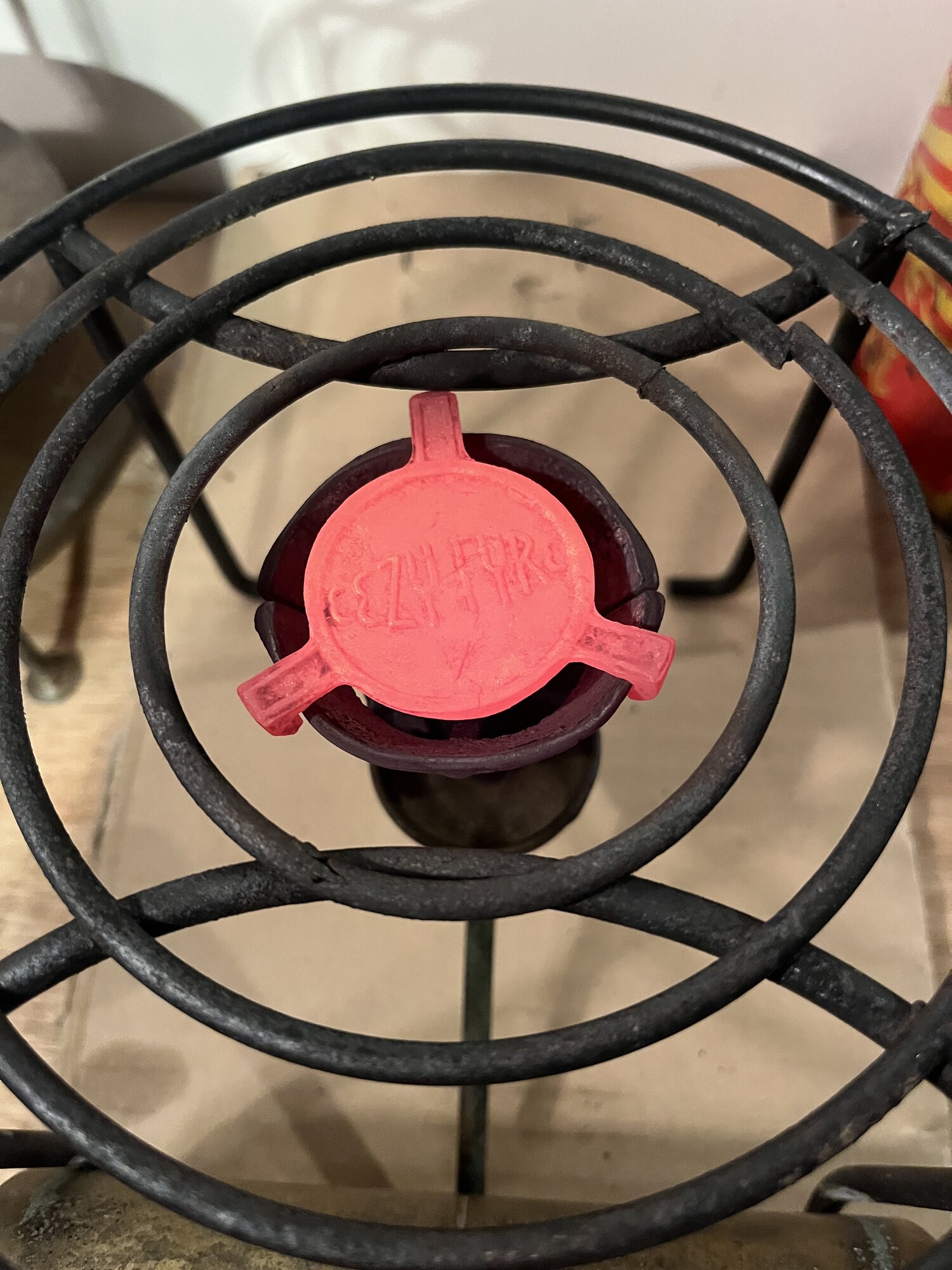

  9. Tony Press
    10,792
    I’ll post some photos of a naked Eezy-Fyre flame plate after the frost dissipates and the temperature edges above zero, but the flame plate is not delicate, @Blackdog.
