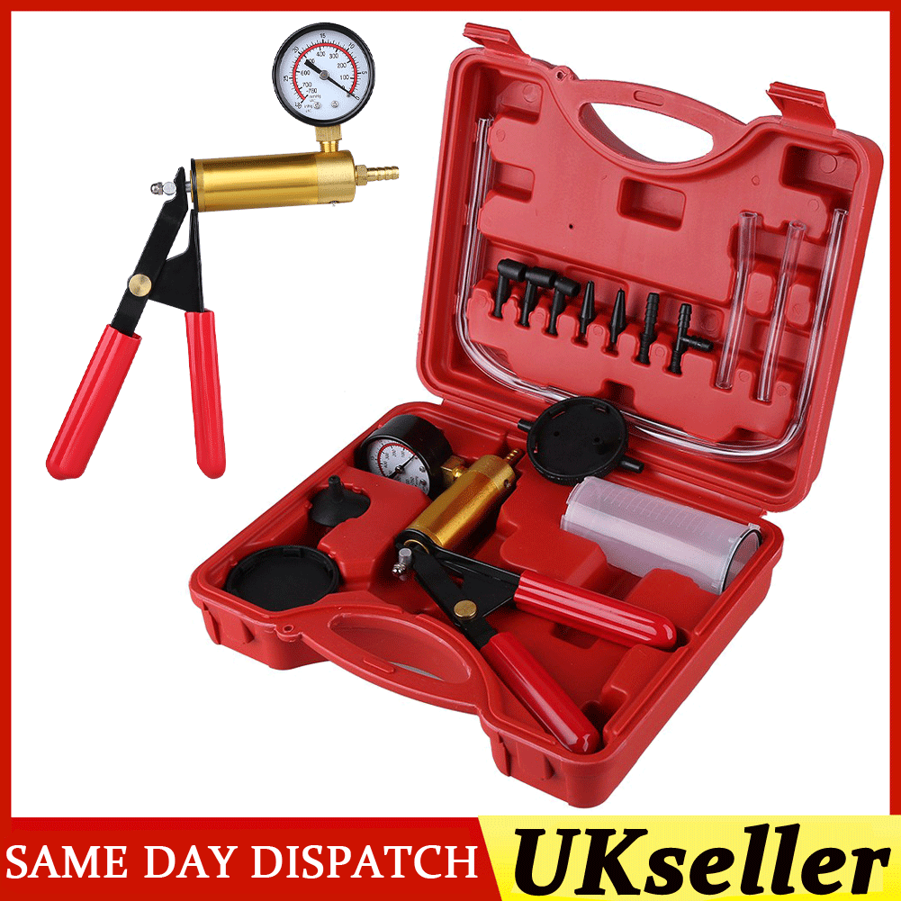

    Rather than pressuring fluid through the blocked generator, I've been messing around with an old brake bleeding kit found in the back of my garage.. Utilizing the vacuum pump and a small section of hose fixed to it, the other end can be hose clamped to the generator and cleaning agent sucked through the generator like a straw...
    I have had some degree of success but an idea that needs tweaking ( a fair bit ) You can also see the crud being pulled out passing through the pvc tubing.. Must admit having an item of gear like this lying around seems ifffy.. memories of Austin Powers and his Swedish P***s pump being found at customs...!!!!!

    Clever idea with the brake bleeder. It sounds like a success so where’s the tweaking required?
