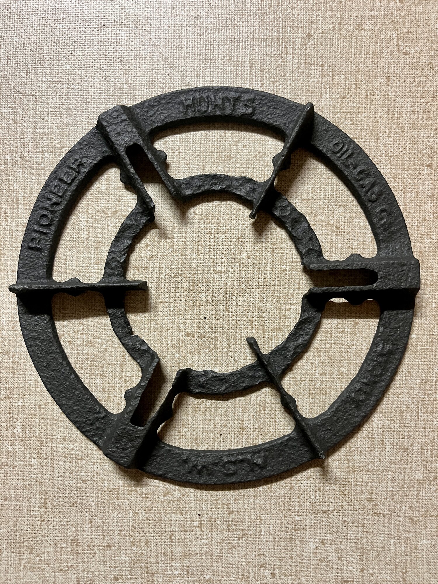

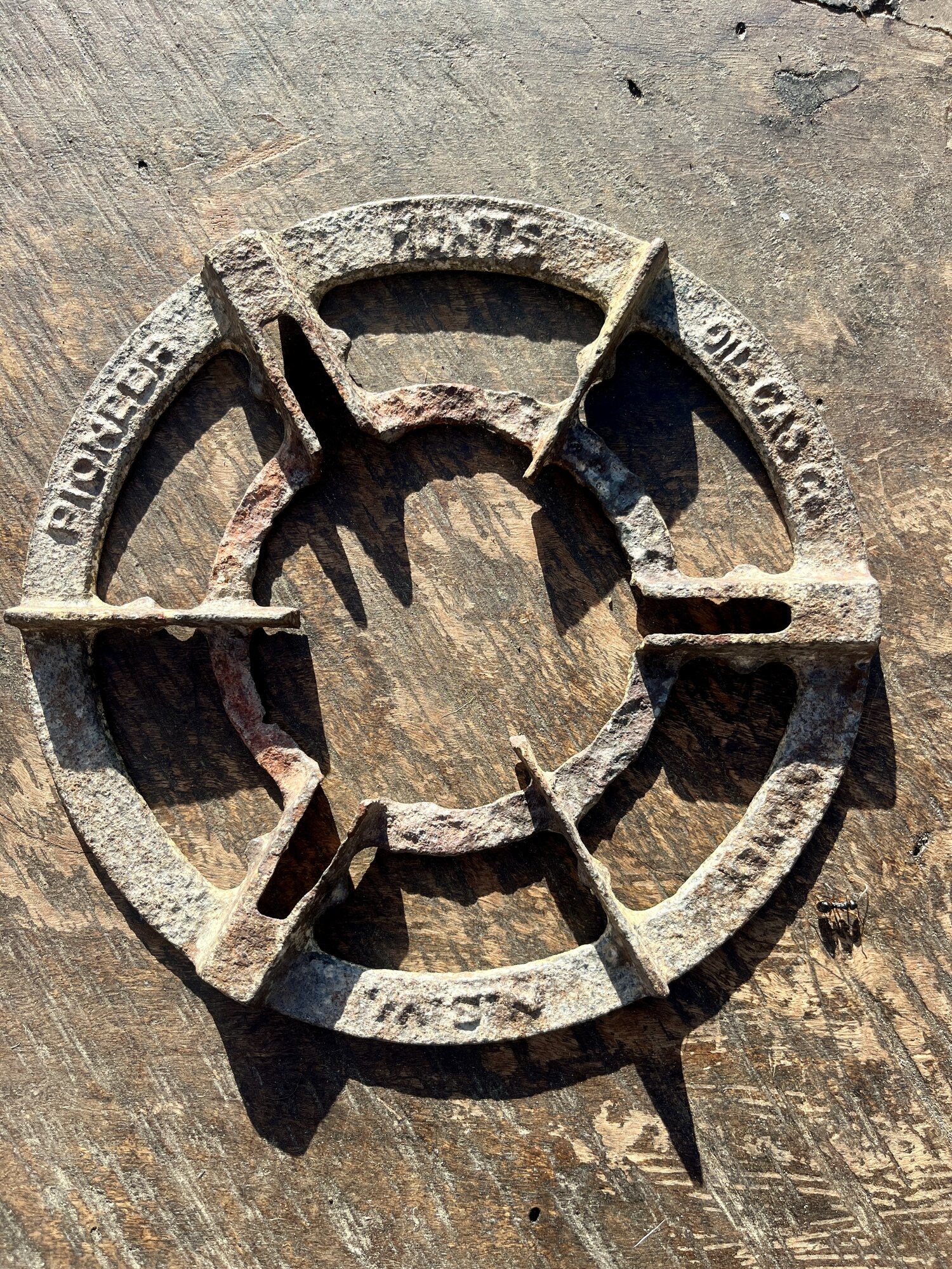

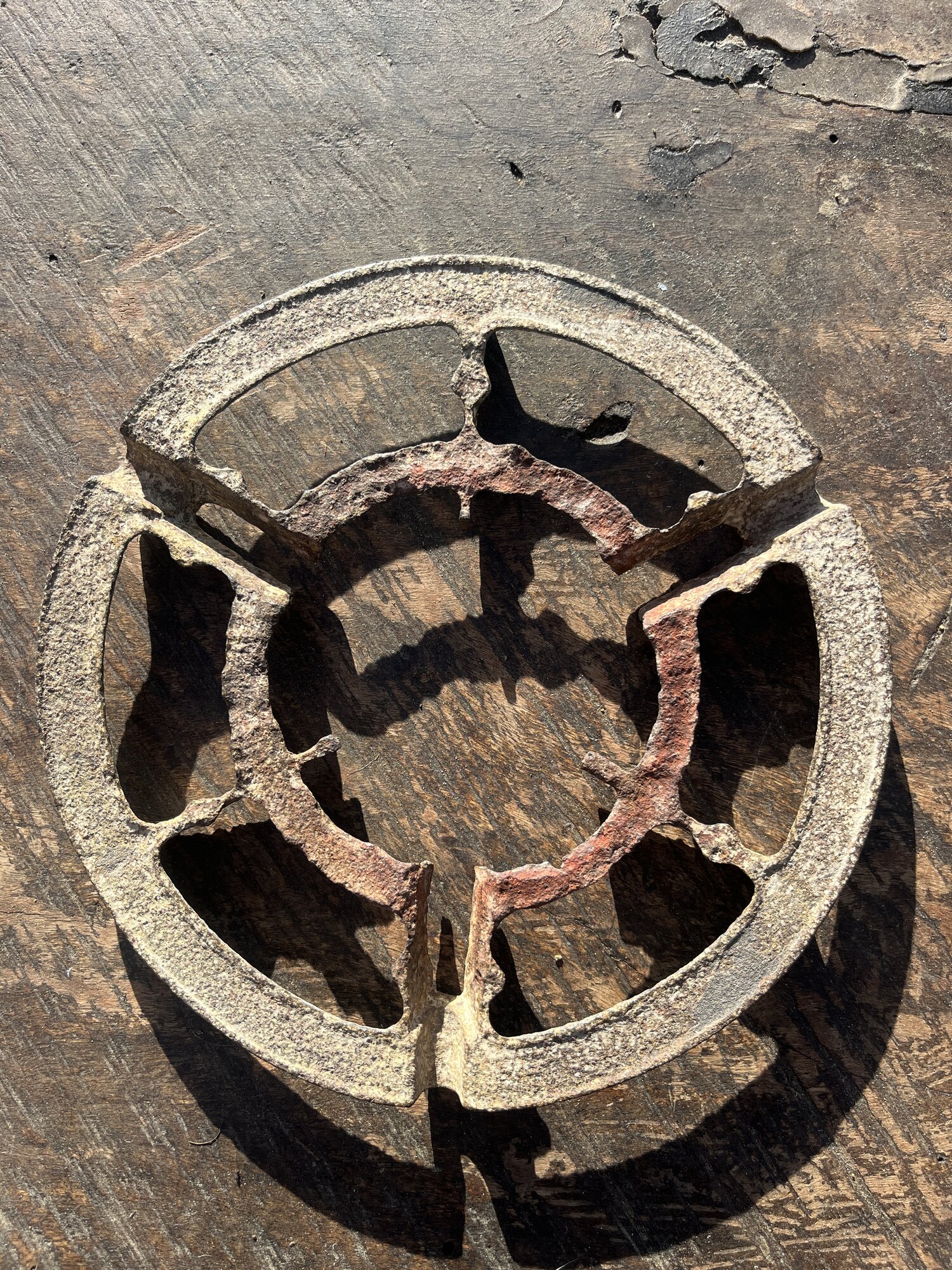

    First update on the Hunt’s Pioneer stove.
    The trivet does say “Sydney” @Rodger Willows.
    I removed as much loose rust as I could from the cast iron trive using a Dremel wire wheel, being careful not to damage the fabric of the trivet.
    I then treated it with Ranax which is a proprietary rust treatment; then boiled the Ranax coating off and painted the trivet with a very high temperature pot belly stove ‘charcoal’ paint. Then baked the trivet in an oven at its highest temperature.
    I didn’t do any repairs to the thin rusted parts of the trivet as I wanted to keep it as is. I’ll use another trivet for the stove when it’s burning.

    @Tony Press
    Wonderful preservation. The wording is much more apparent in relief now.
    Thank you for the update!
