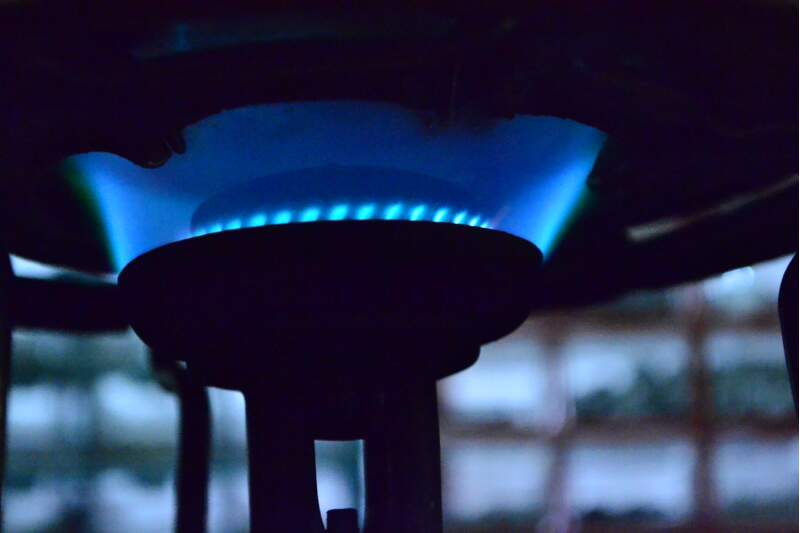

    Here's a stove I found with an unusual silent burner cap. Instead of flame holes in the burner cap there are flame slots instead. Makes for an interesting flame.
    It is called Iris, which is engraved on the tank and stamped in the pan ring. There's an inscription that it was made in Germany, but that is it.
    Some unusual things to notice:
    1. The really large pump handle.
    2. The Monitor Regal-like priming burner.
    3. The slotted diagonal silent burner cap.
    4. The NRV down in the pump tube.
    Here you go....

    Here are the flames:
    1366173268-Iris_002_small.jpg 1366173316-Iris_008_small.jpg 1366173328-Iris_009_small.jpg 1366173338-Iris_010_small.jpg 1366173357-Iris_011_small.jpg 1366173365-Iris_012_small.jpg 1366173374-Iris_013_small.jpg 1366173396-Iris_017_small.jpg 1366173418-Iris_020_small.jpg 1366173418-Iris_020_small.jpg 1366173426-Iris_021_small.jpg 1366173434-Iris_022_small.jpg 1366173443-Iris_023_small.jpg 1366173463-Iris_025_small.jpg

    Really beautiful flame !!
    nrv check valve look like german lantern style.
    and interesting bottom furrow.
    jerry can system?

    Do the slots make it any more or less silent than other silent burners of a comparable size?

    Thanks everyone! It did just 'fall into my hands' and the stove has many unusual features. The burner is what surprised me since it was obscured in any photos the seller had of it. I thought it was just the run-of-the-mill brass kerosene stove, that is, until I unpacked the stove and got a really close look. It was a WOW moment for me. Hopefully, I've done it some justice....
    Also, I believe this to be pre-WWII as well. There a symbol of some dragons and a star of David in the middle of it. Maybe I could submit a picture so you can see it for yourselves.
    At full power all you could hear was the hiss of the jet and no combustion noises coming from the burner cap. I kept checking it to make sure it was really burning. To gauge how hot the flame was I had a kettle on that I used to cook up a litre of water within 5 minutes. So it was working properly, but very silently. Probably a little quieter than an Optimus 111T or Primus No. 5.
    sam
