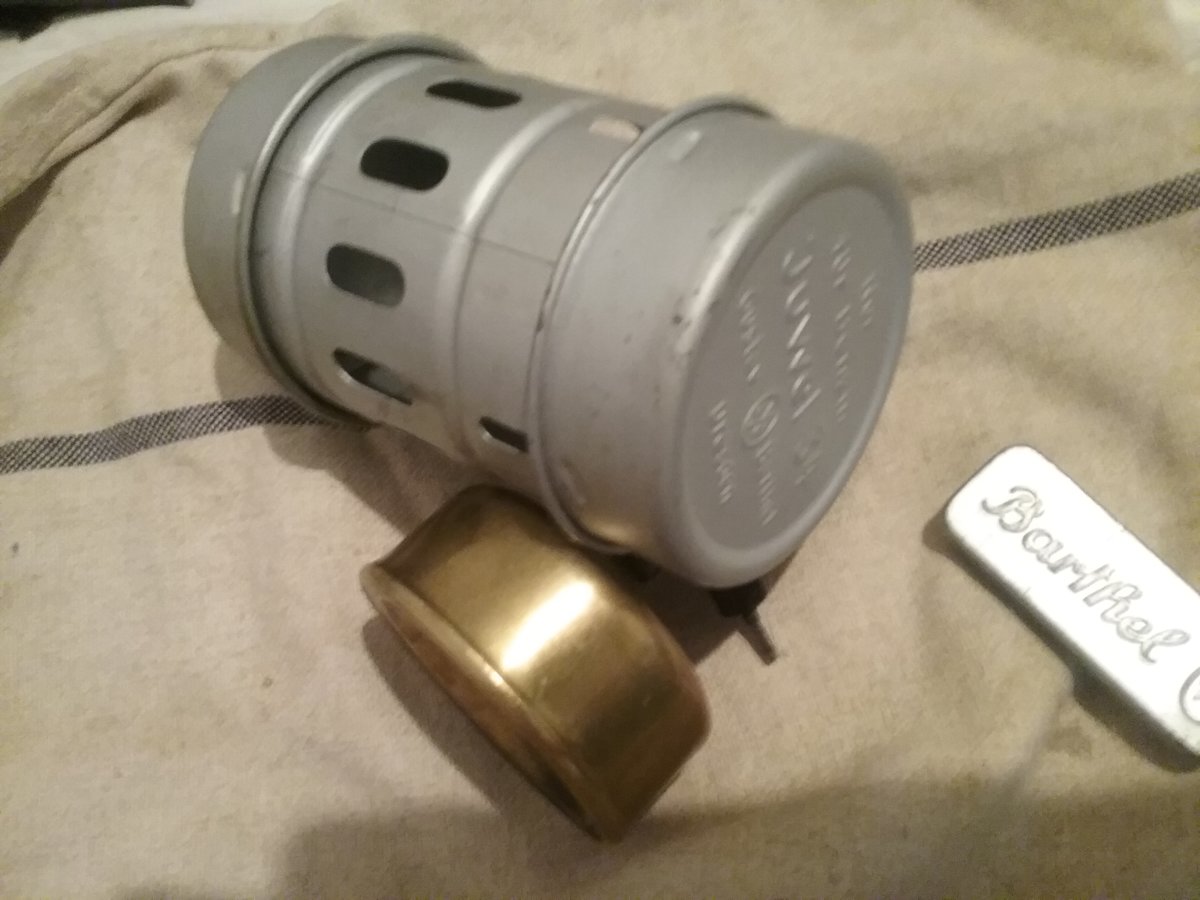

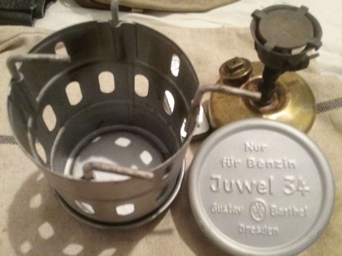

    Positive. They are not common, but Ive had two different ones over the years, one with a steel tank made a different way than normal. Both had wire supports, unlike the stamped steel Ls of the normal 34s. Also, my Arara 37 has twist locking lids, different than yours. My Wiktorin has screw threads like that, though.

    OK. I get it . Twist on lids, as opposed to screw-on lids. Yes, that is most definitely not an Arara 37.
    Standardization might have been one objective, saving on strap material may have been another.
    Another poster, a few weeks back, said he had an Arara 37 with strap-on lids. Who knows? [No pix.]
    Interesting, a Svea 123U is a bare stove w/o cup and windscreen.

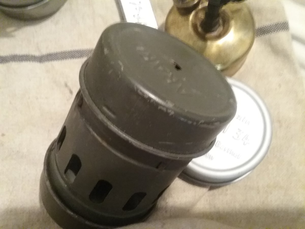

    It must have something to do with age. You will notice the older ones, whether brass or steel tanked, usually have downward angling valve, and all the slots in the side of the windscreen are the same length, because any of them will line up with the valve. The newer stoves, with the stamped sheet metal pot supports have one longer slot for every three or four normal ones. The key can only access the valve through the longer slots. However - I have seen the "older" type in boxes with more recent dates than the "newer" types - there must have been some overlap in the late 60ies, early 70ies.

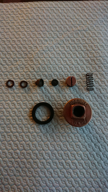

    Yes - under that screw is the Safety Return Valve located.
    Since it can be very hard stuck - you can give it some thin oil (WD-40/Caramba....) and let it soak for a couple of hours before unscrewing it.
    When getting a new stove I always check that the spring works and the pip-holder is not stuck.

    Good morning, back again. After a night soaking I managed to take it apart:
    On the left there are two rings, could that be some sort of adjustment?
    The third from the left side is the plunger, further to the right is a rubber top of the plunger to hold everything tight under normal operation, then the screw and pressure spring.
    I wonder, is there some way to test it?
    And another thing I wonder, suppose the pressure gets too high, and the valve opens, is there no risk of firing the damp coming out?
    Ton.

    If the valve opens due to overpressure, it's very likely the released vapor will ignite. This is better than the tank rupturing, which the safety valve is designed to prevent.

    If the spring is “springy” and not stiff - its good. The rubber pip seated in the plunger must have a little softness in order to seal against the tiny opening inside the filler lid. If the rubber pip is completly hard, then you should change it.
    Can’t recall if mine has the two small washers - I would just remount them in the same place. I can check mine if needed?

    I think I will change the two washers because they are rusty . The spring is fresh and will make a new pip.

    I have never seen these two washers in one of my Juwel 33 and 34 and 84. I guess someone added these, because the spring was not strong enough. Maybe the spring is not original and someone replaced it with a shorter one?

    One never knows what has happened during all those years Bastian, and like Harder says no rings seen. Therefor i skip the rings.
    Talking about rings, is it common there is a ring in the screw part meeting the spring there?
    And maybe a tricky question, should anyone know the overall length of the spring?
    Another detail I was surprised about was the shape of the part the rubber tip is resting in, it is hexagon shaped on the outside, but there is obviously nothing to screw there.
