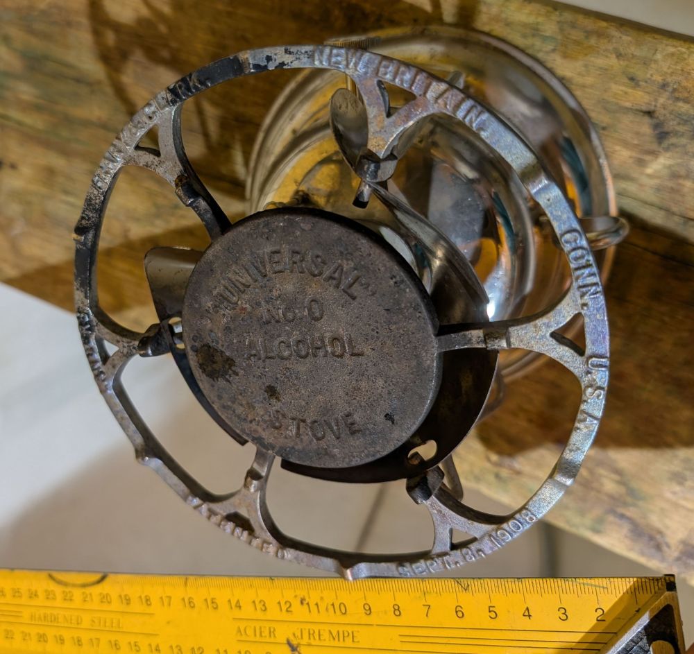

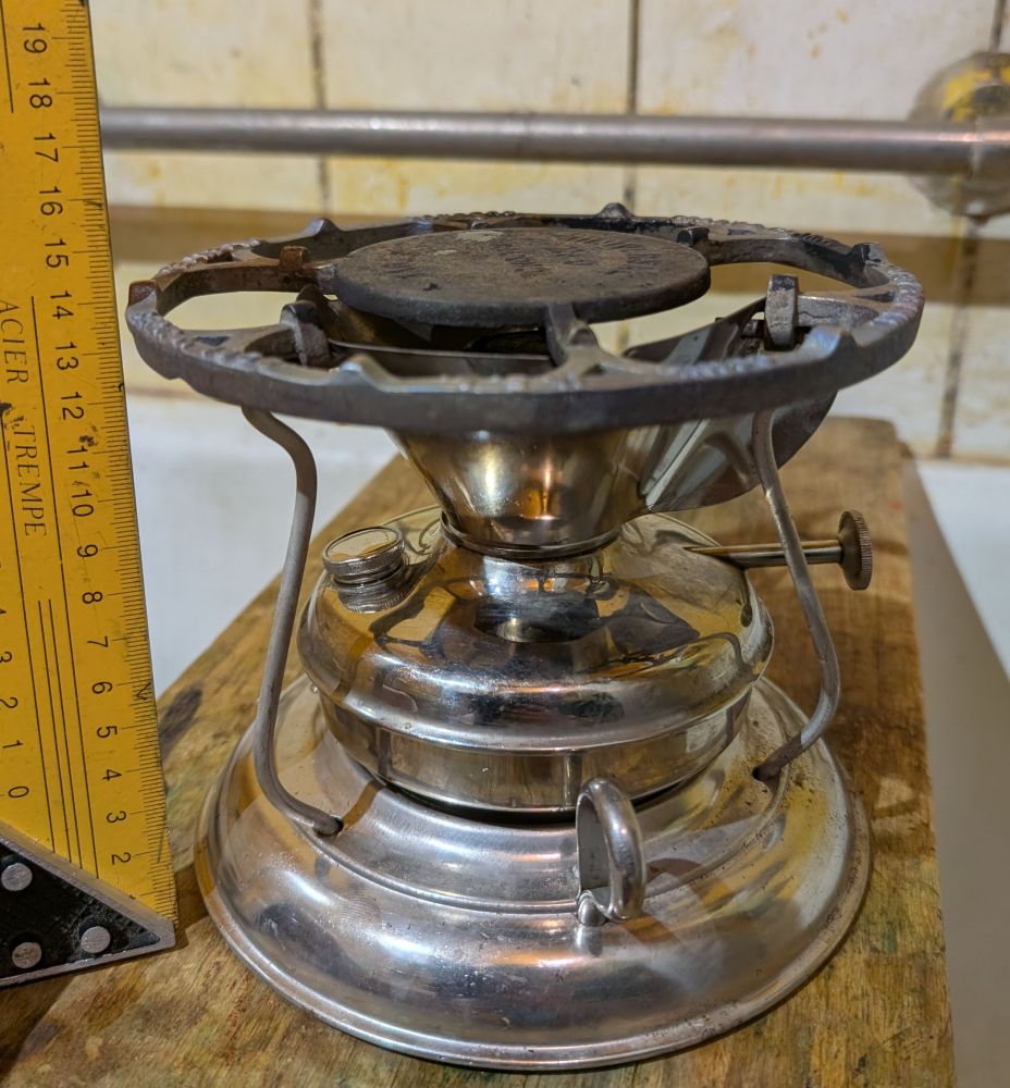

    Yet another Landers, Frary and Clark No. 0 alcohol stove.

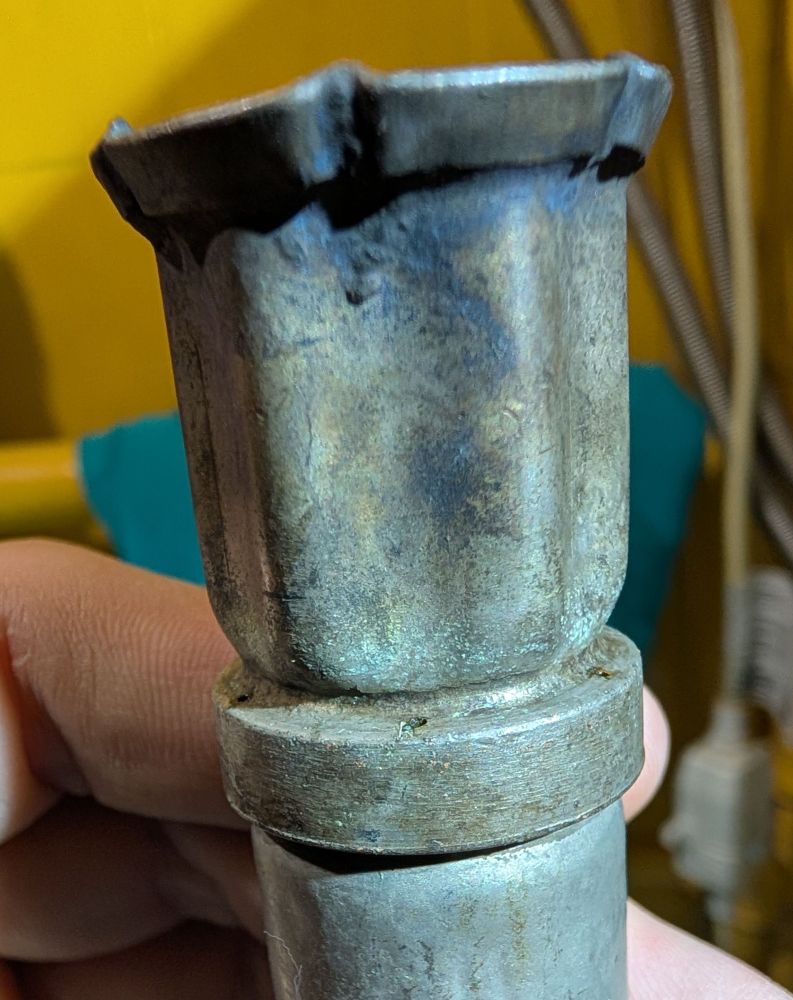

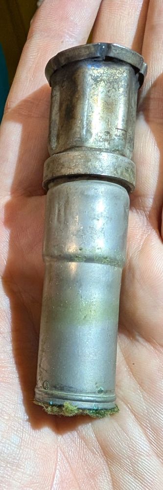

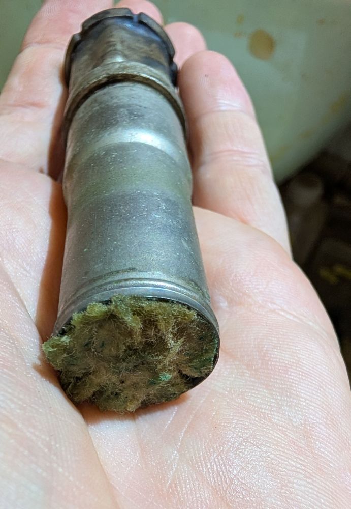

    The wick module is not fixed, I just pulled it up:

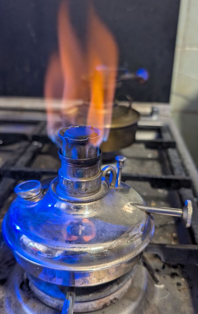

    Initially, the stove worked terribly, there was only one tongue of flame on on side.
    So I had to clean the jets on the wick module with a needle. Here are the jets:

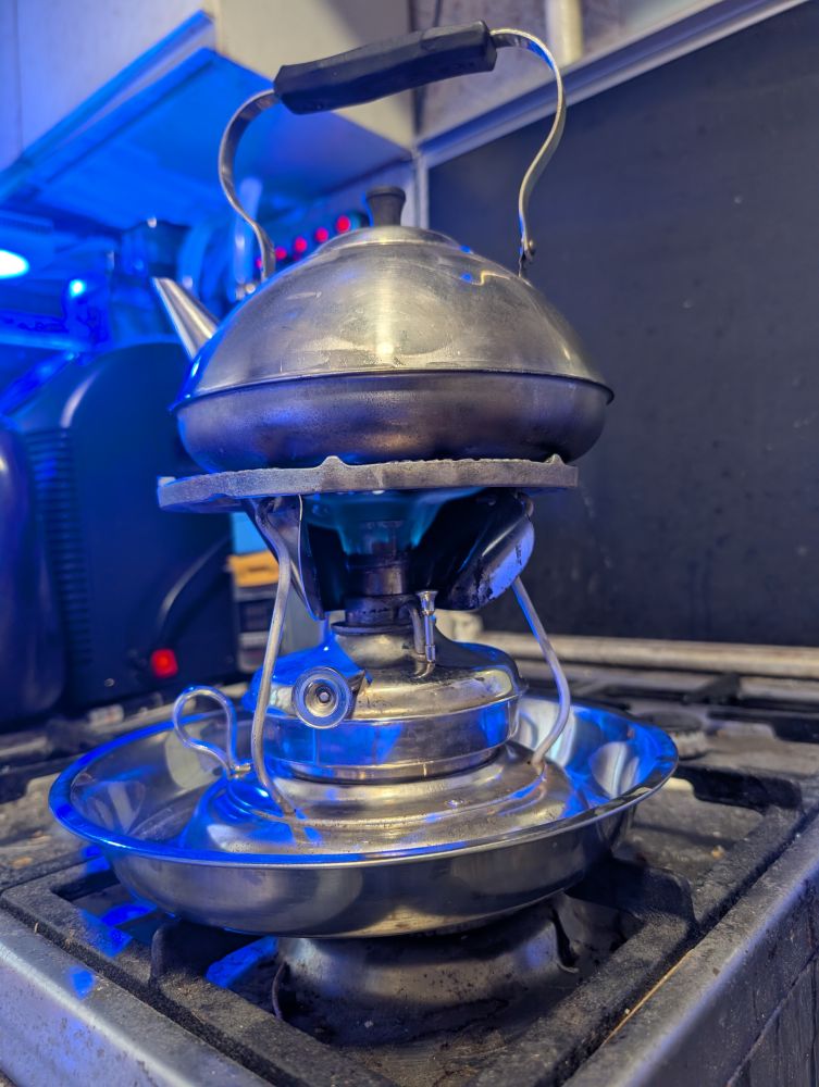

    And now it works:
    Now it boils 500 ml of water in 5 min 40 s. On the same test stand, Primus 96 boils it in 3:20:

    UPD.
    I measured the ethanol consumption. In 12 minutes (the time it takes to boil one liter), excluding ignition, it consumed 31 g.
