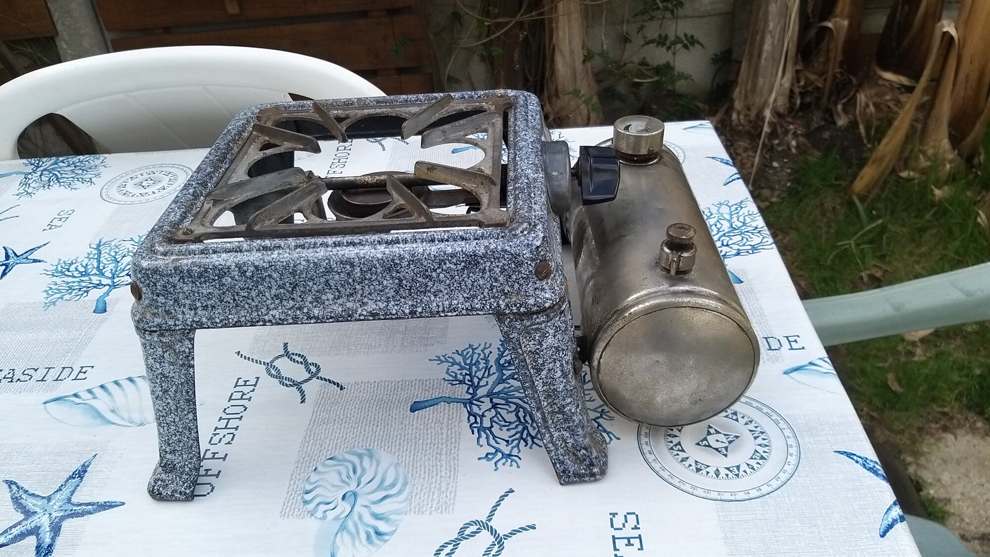

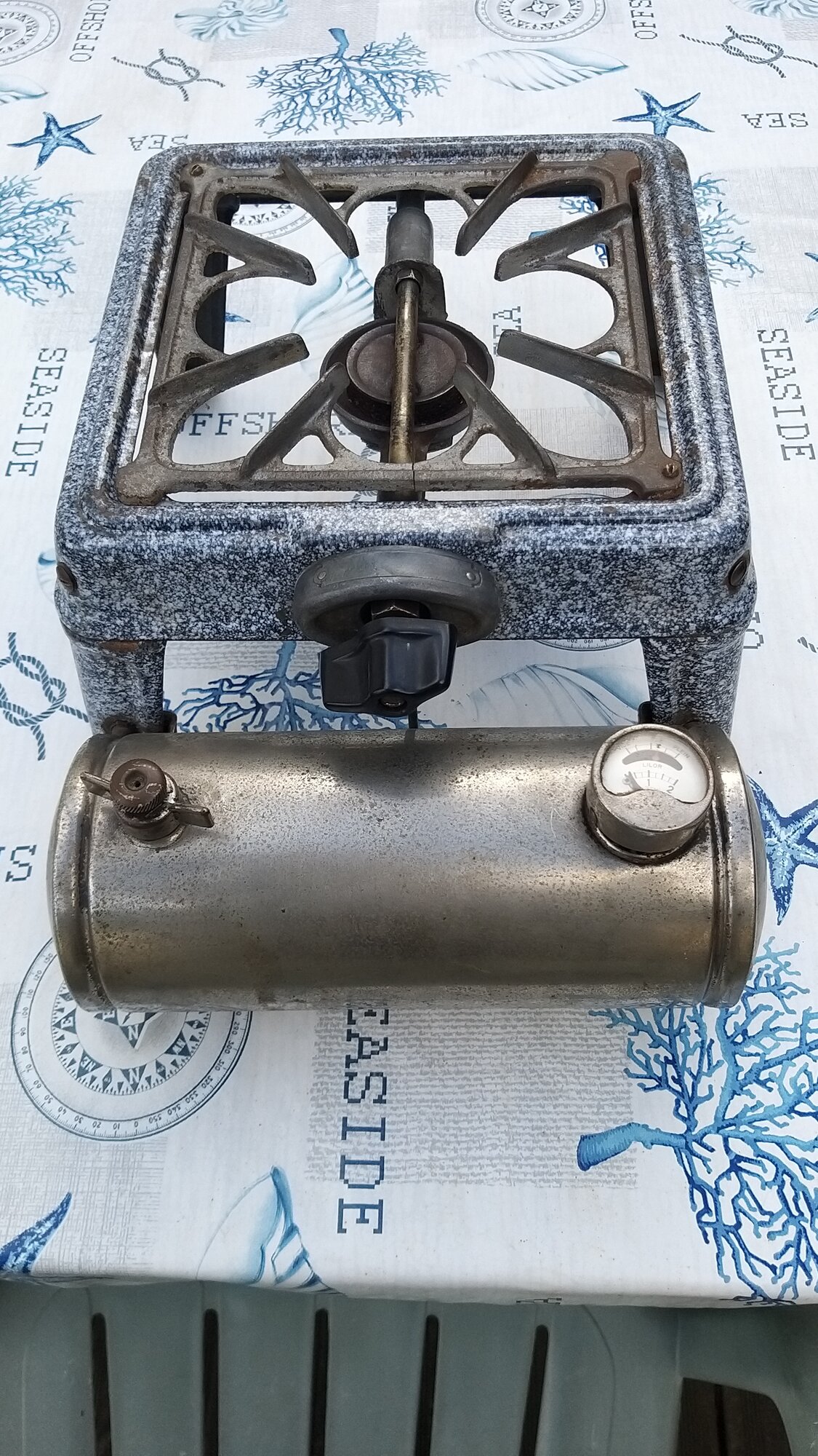

    Received a while ago and just took it out of its shipping box.
    Here is the beast:

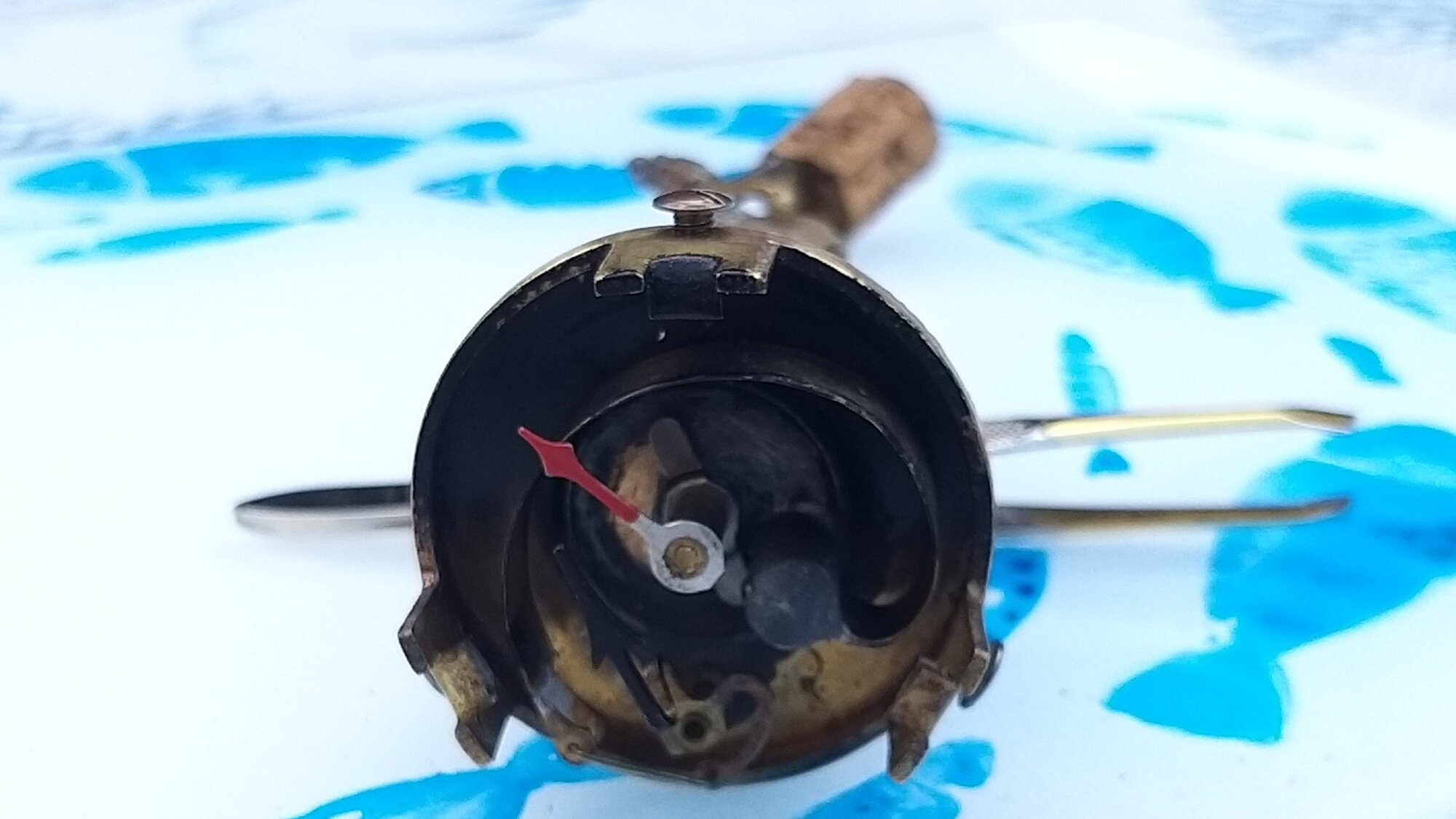

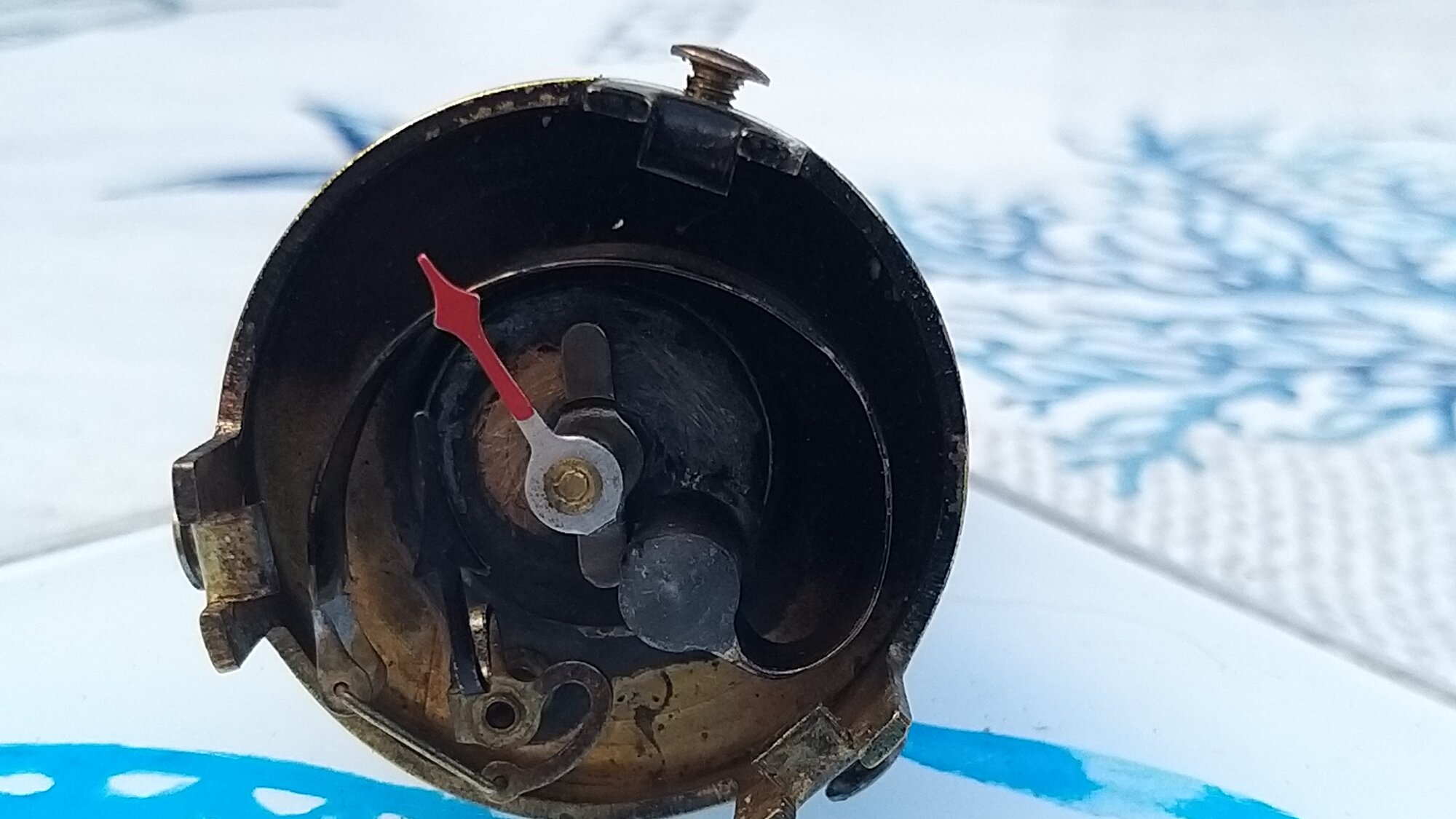

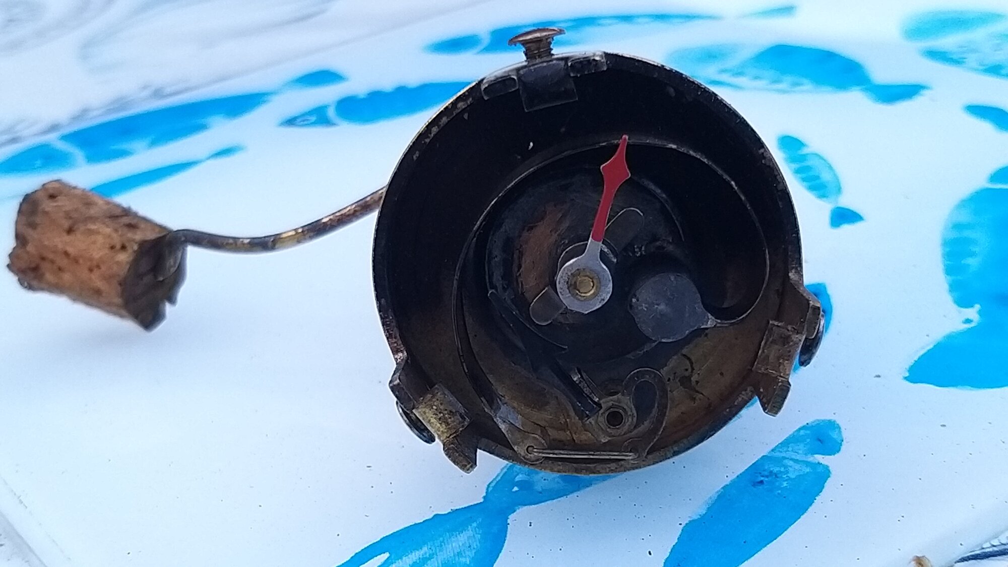

    The level gauge is faulty, so disassembly to see what is blocking.

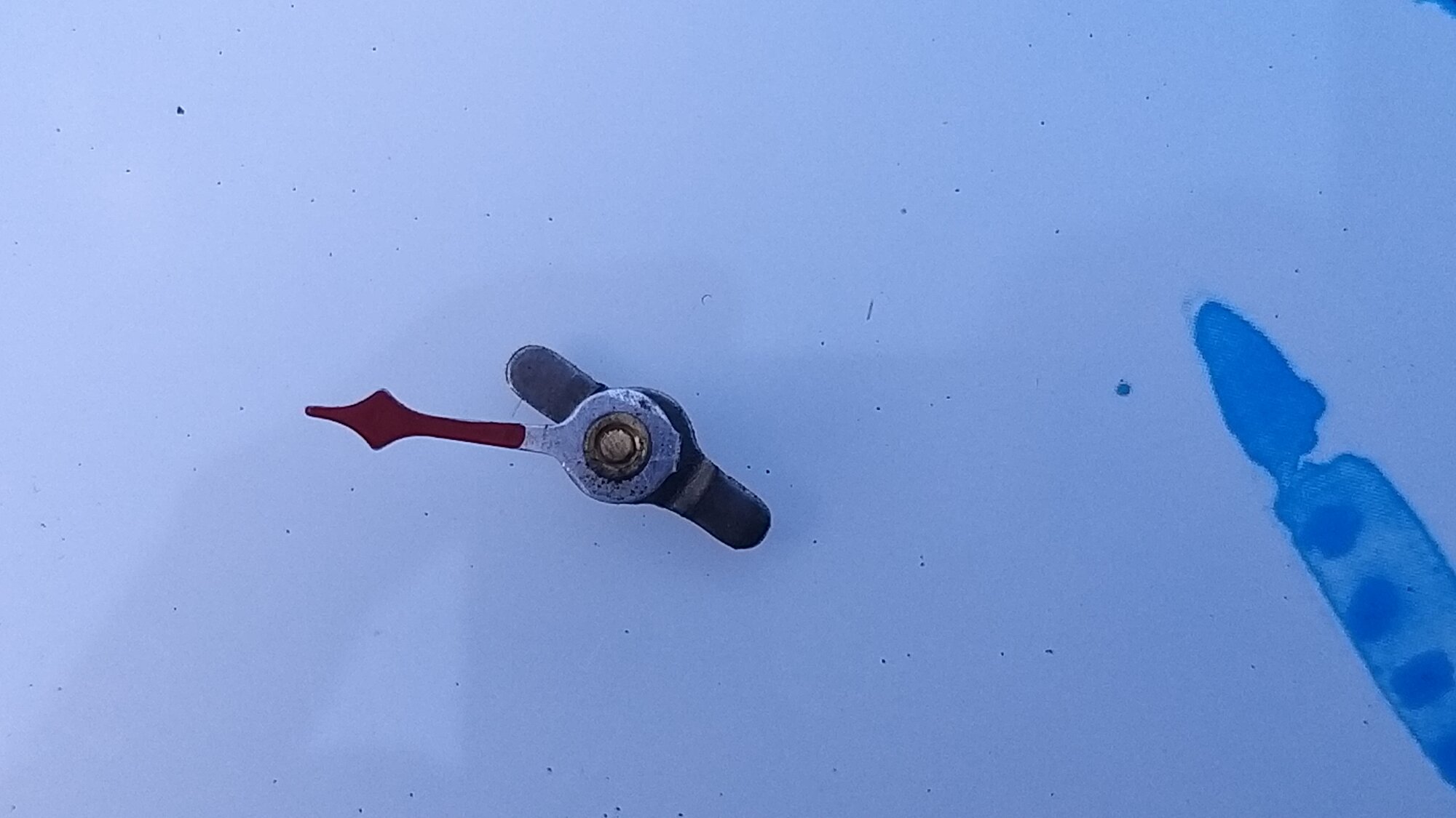

    And surprise, no mechanical connection, it's magnetic!
    In fact the needle is magnetized and tank side on the axis, a U that I assume in soft iron. The whole being driven by 2 cogwheels and a cork float (long live the Bordeaux corks!)

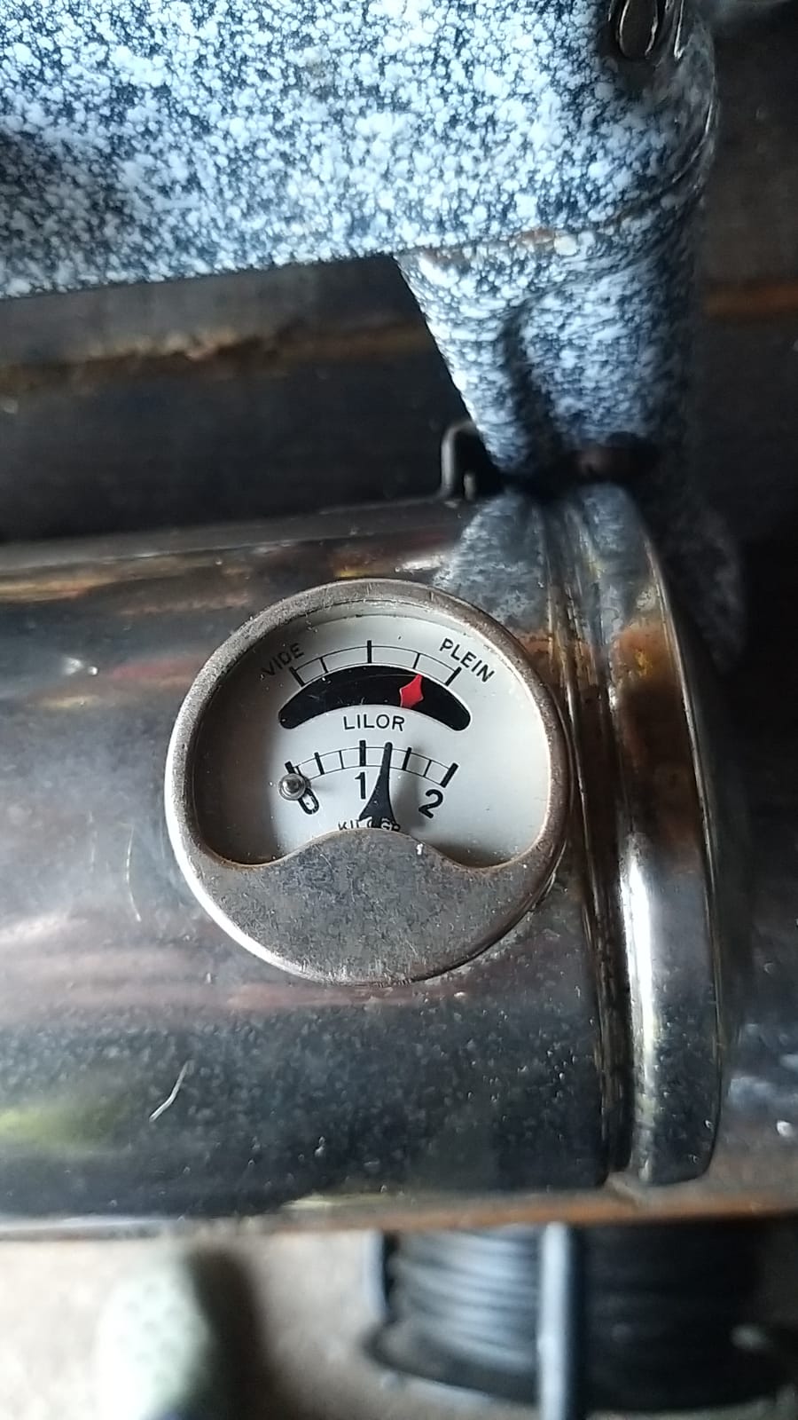

    Empty tank:
    Full-tank:
    And in use:

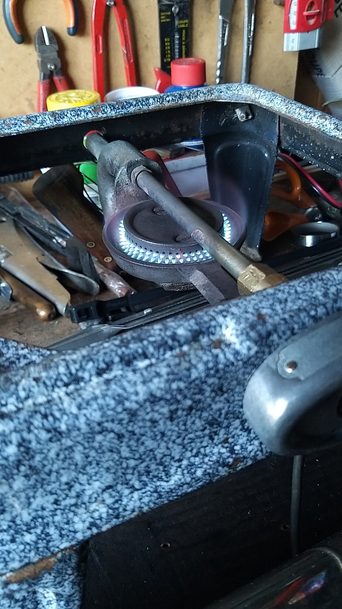

    After unblocking the primary jet, firing:
    Heating test, 1/2L of water brought to a boil in 6 minutes, Slow motion flame position
  2. Nicola Francesco Elia
    Nov 13, 2016
    3,155
    Italy
    @Michel thanks for sharing, that manometer is a beauty!
    I still don’t like and understand this style of finish for the cast, but probably was the fashion of a certain period :)

  3. z1ulike
    4,597
    Ahhh...another enameled stove from France. Nice to see it up and running like it should. Very nice indeed.

  6. Tony Press
    10,858
    Nice stove, @Sellig33.
    Speckled enamel was quite common on Australian pressure stoves and lamps (eg Aladdin stoves).
  7. Nicola Francesco Elia
    Nov 13, 2016
    3,155
    Italy
    @Tony Press Hi Tony, that’s interesting. On which kind of lamps was that common?
    Nicola
  8. Tony Press
    10,858
    @Nicola Francesco Elia
    The Australian copy of the Tilley EX100, the Kayen AP2, had green speckled hoods, and blue speckled hoods (various shades over the years). Aladdin kitchen 2-burner stoves were black and white speckled, and I’ve got a rare big, heavy stove that was green and white speckled.
  9. Nicola Francesco Elia
    Nov 13, 2016
    3,155
    Italy
    @Tony Press because I knew you were referring to pressure lamps, I really missed the speckled hoods… I will go on CPL to check them out :)
    Cheers!
