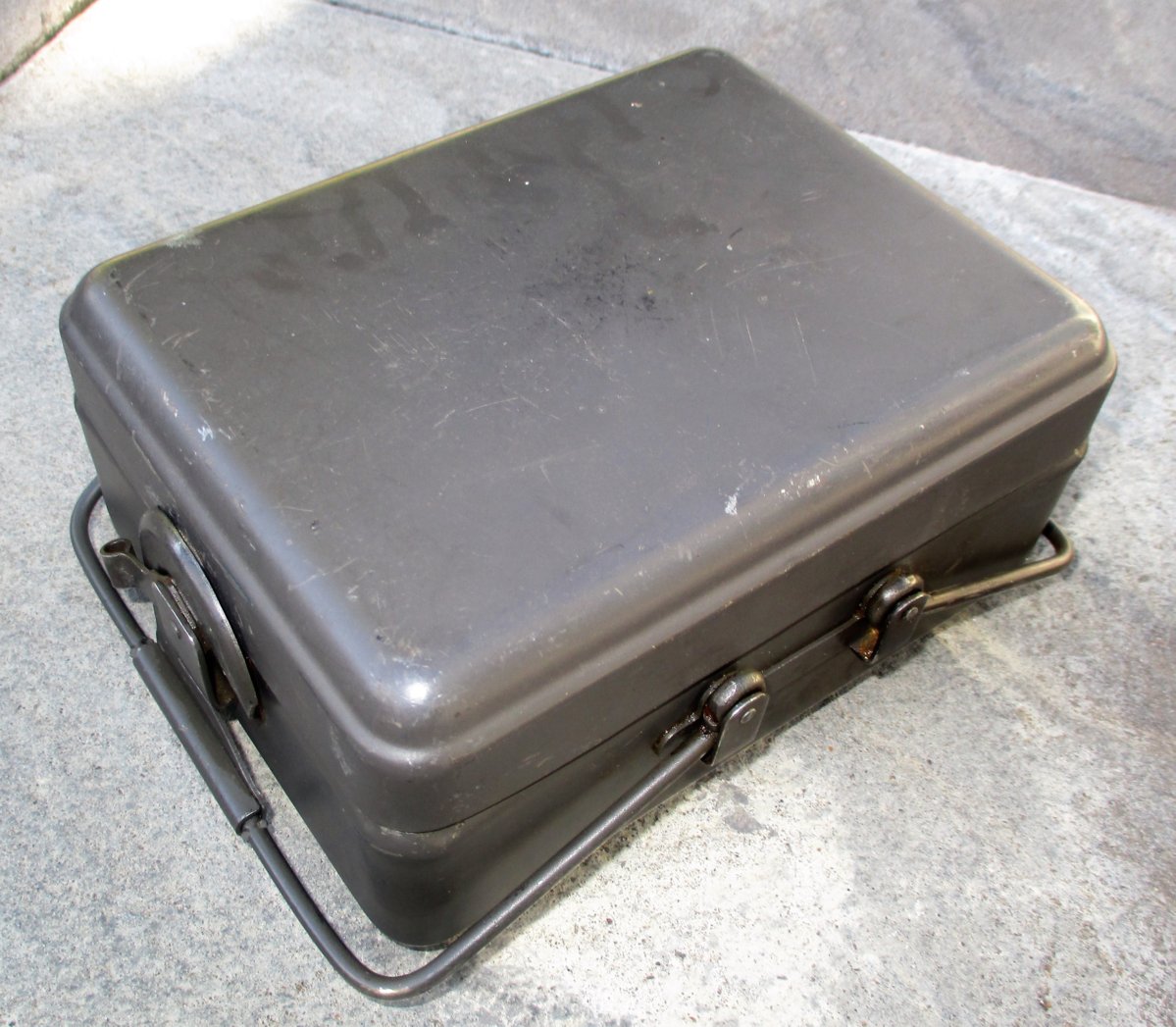

    You imply the that so-called "Military Trangia" (ENMANSKÖK MT) only got its windshield and burner in the early 1960s. So from 1940 until the early '60s it wasn't a stove at all, just a couple of mess tins? That would explain why the windshield and burner are often seen without the mess tins.
    Do you know why there were both stainless and aluminium versions of the mess tins? There are various contradictory explanations around, such as the one which says the stainless version was introduced during WWII because of a shortage of aluminium. Do you know where the truth lies?

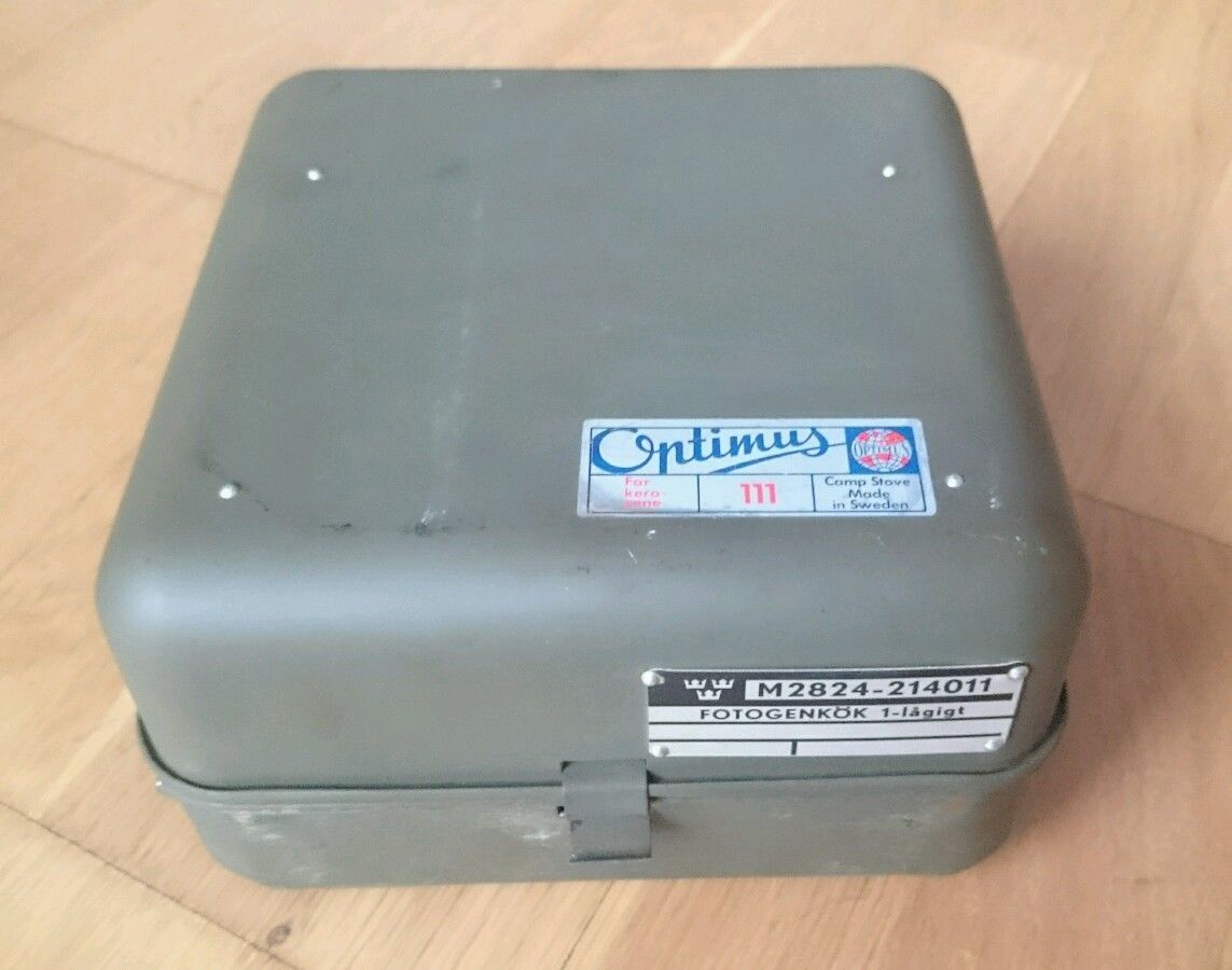

    Finally, heres a picture of an Optimus 111 which has features of both the first version (No FIV-number on the plaque and no “utgåva 2” inside) and the second version (Silver sticker and no embossed 111 on the lid) .

    UncleRob: I have never seen any rock-solid proof that it was aluminium shortage that caused the stainless version of the KOKKÄRL M/40, but it is very probable that that is was happened. Sweden has no aluminium mines, but plenty of iron. And thanks for the photo of the “hybrid” Optimus 111!

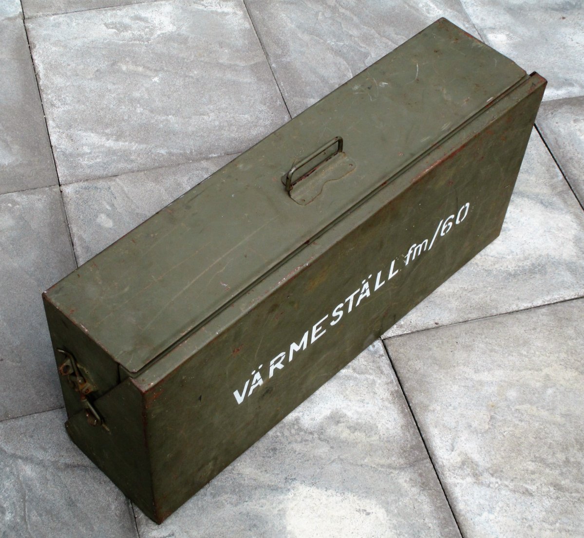

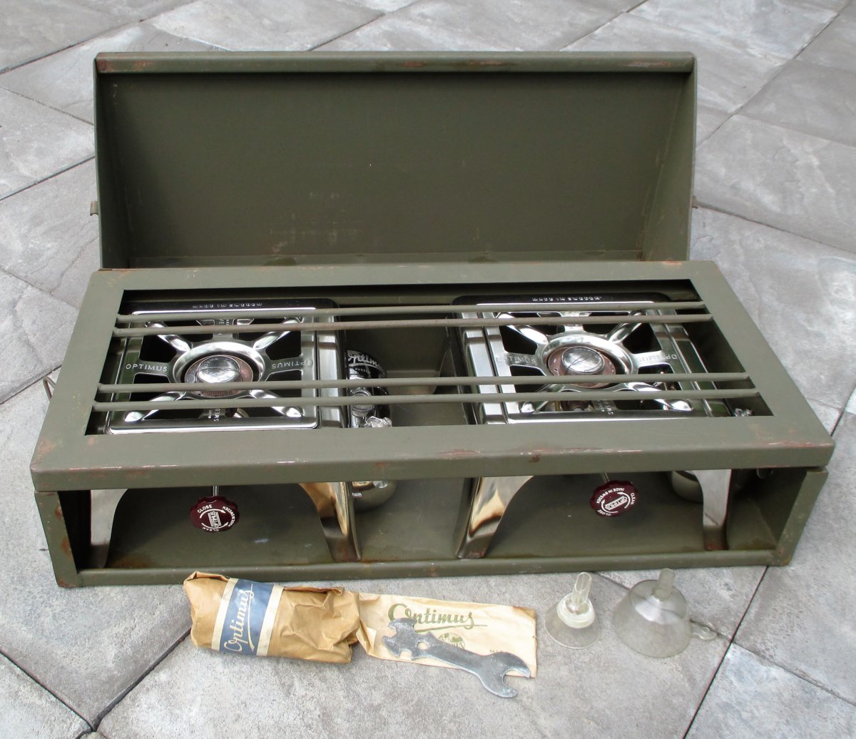

    Optimus 181 F in VÄRMESTÄLL fm/60 (Heating Rack Trial Model/60) and M2824-102119 VÄRMESTÄLL (Heating Rack)
    This set is seldom seen. I have not found any traces of the Trial Model in any data base I have access to or in any other public database. As it is a set only intended for tests and trials it is not that strange. (“fm/60” stands for “försöksmodell 1960” i.e. Trial Model 1960) None the less, I had expected to at least find it in the Swedish Army Museum's database. As this set was used in military trials that took place in the early 1960’s, it was no longer in the inventory in the late 1960’s and left no traces when the Material Administration database was re-done at that time. Un-like many other trial models it was included in the Armed Forces inventory as M2824-102119 VÄRMESTÄLL, but probably only in small numbers.
    The set consists of the 3-part box, two Optimus 181 F and some accessories. The box is very sturdy (even for army issue) but very simple with just an open-front box, a lid and a grate. The two Optimus 181 F are rare examples of of-the-shelf stoves actually stamped with the military “Three Crowns” markings. The marking on these two can be found on the flat iron that supports the burner. Which accessories that were included originally is impossible to say. When I found it, it contained a plastic alcohol can in its un-opened original wrapping, a fixed wrench and two siphons (including one Optimus). It seems reasonable that these accessories are original and included in the kit from the beginning. Apart from that, there were an opened package of Radius 0/87 cleaning needles. They make less sense since they are intended to be used with for example Radius 1 and 5. The burner on the Optimus 181 has a built in cleaning-needle and don’t really need an external one.
    There is a really tight fit when one tries to close the box. The scruff marks on the Optimus sticker at the front of the stove are tell-tale signs of that. The normal transport configuration appears to be with the right stove turned around so that both founts are facing each other in the middle of the box. Even though there appears to be plenty of room for the two Optimus 181 to move sideways within the box, the fit is so tight that they don’t actually move at all.
    This set is unused, although there are some marks and rust on the box after over 55 years of occasional handling.
    /Stefan

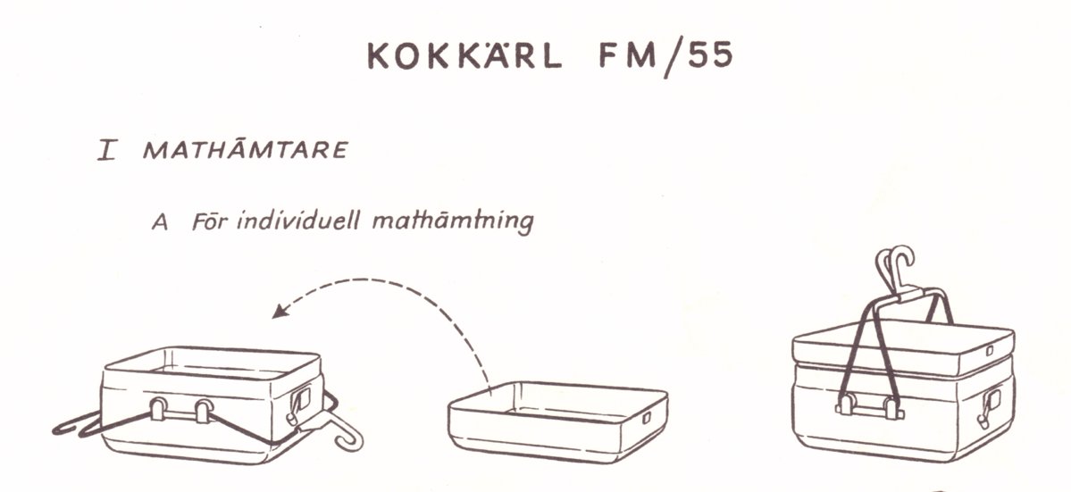

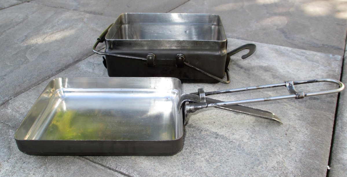

    KOKKÄRL FM/55 (Mess Tin Trial Model 55)
    Strictly speaking this is not a stove, but it is added as a complement. The Mess Tin Trial Model 55 is made of stainless steel and consists of the lover part (with two handles with hooks and a locking mechanism on the short sides) a lid and a handle/grip. The grip is used to lift the lid when it is used as a pot and put over open fire. The lover part can be also used as a pot if hanged over open fire in the hooks. The handles with hooks can be attached to another mess tin so you can carry a whole stack of KOKKÄRL FM/55 if you fetch food or water for the whole squad. You can also attach the steel three-part cutlery set M/29 to the handle/grip.
    There is not much information on this piece of equipment, but it is briefly mentioned in Leif Högbergs book “Snuskburken” from 2013.
    It is obvious that there was a lot of trials going on in the 1950’s on how to equip the soldiers with mess tins and stoves. KOKKÄRL FM/55 was not adopted but instead a windscreen and burner was added to the mess tin KOKKÄRL M/40 to provide every soldier with his own stove. Another example from this time is the testing of Esbit 27 KOKUTRUSTNING, ENMANS M/1957 (cooking equipment, one-man m/1957) that resulted in the procurement of Optimus 91 (ENMANSKÖK JÄGARE MT) in the late 1950’s or early 1960’s.
    More photos here.
    /Stefan

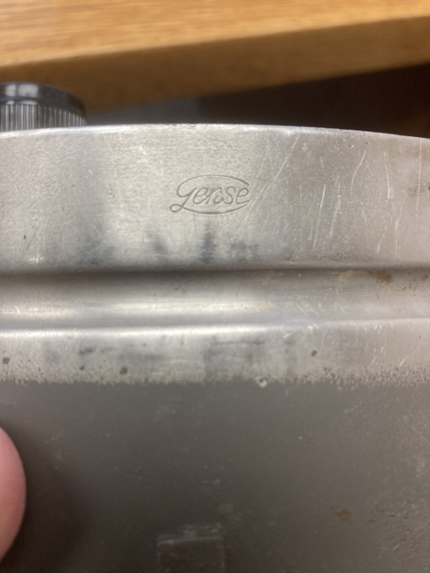

    I have an M-40 with a Svea stove (1965 triple crown) fuel bottle 1965 triple crown. The main pot has this engraved (see photo). No other markings on the pot, lid or windscreen. I can’t find the company. I think it was “Jense”, or possibly a Jensen? Thanks for any info! IMG_1063.jpeg IMG_1063.jpeg
