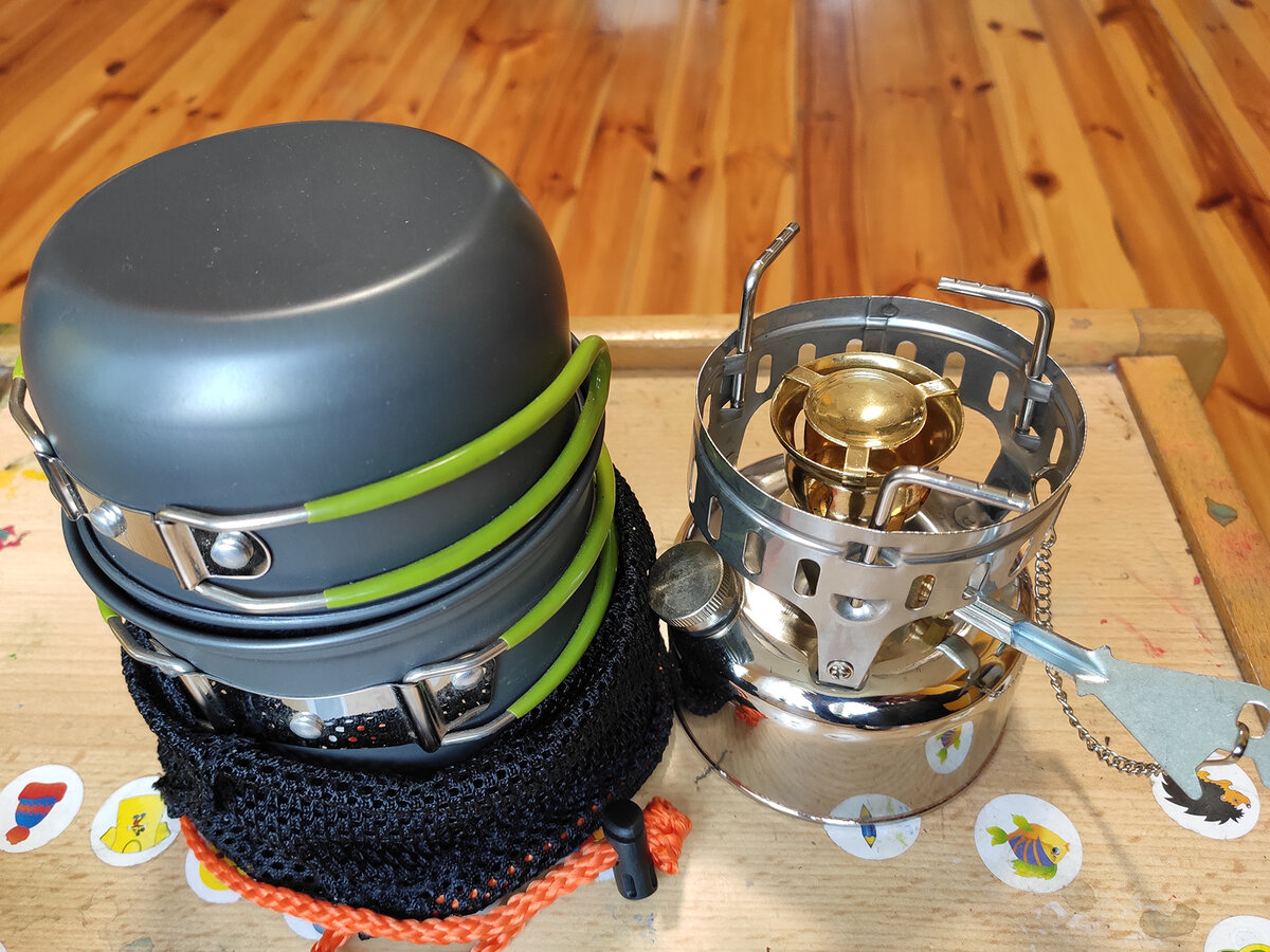

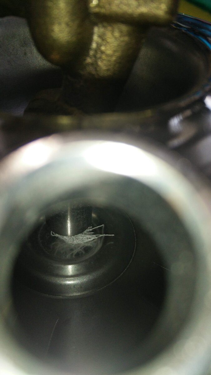

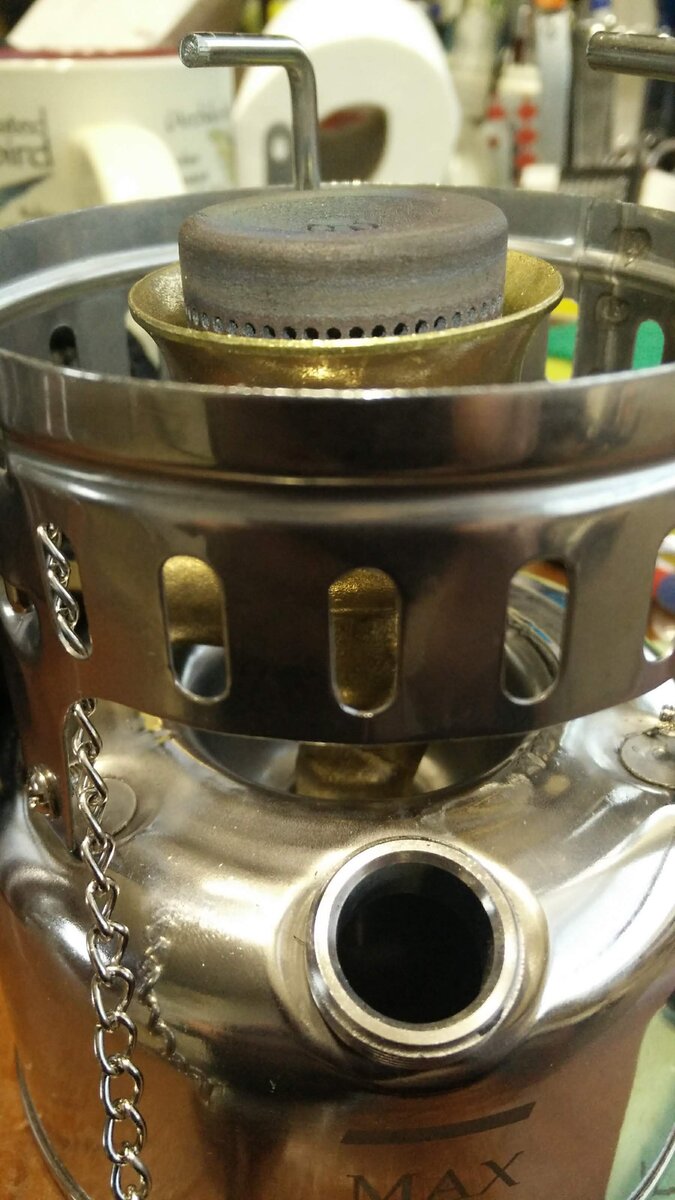

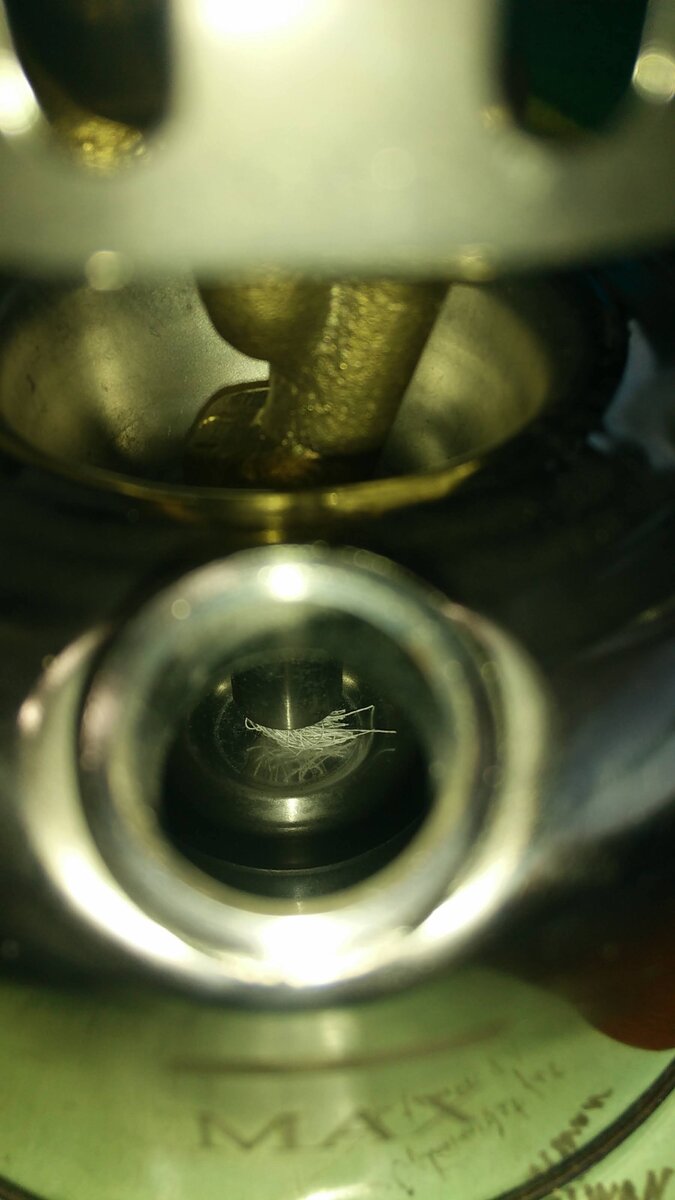

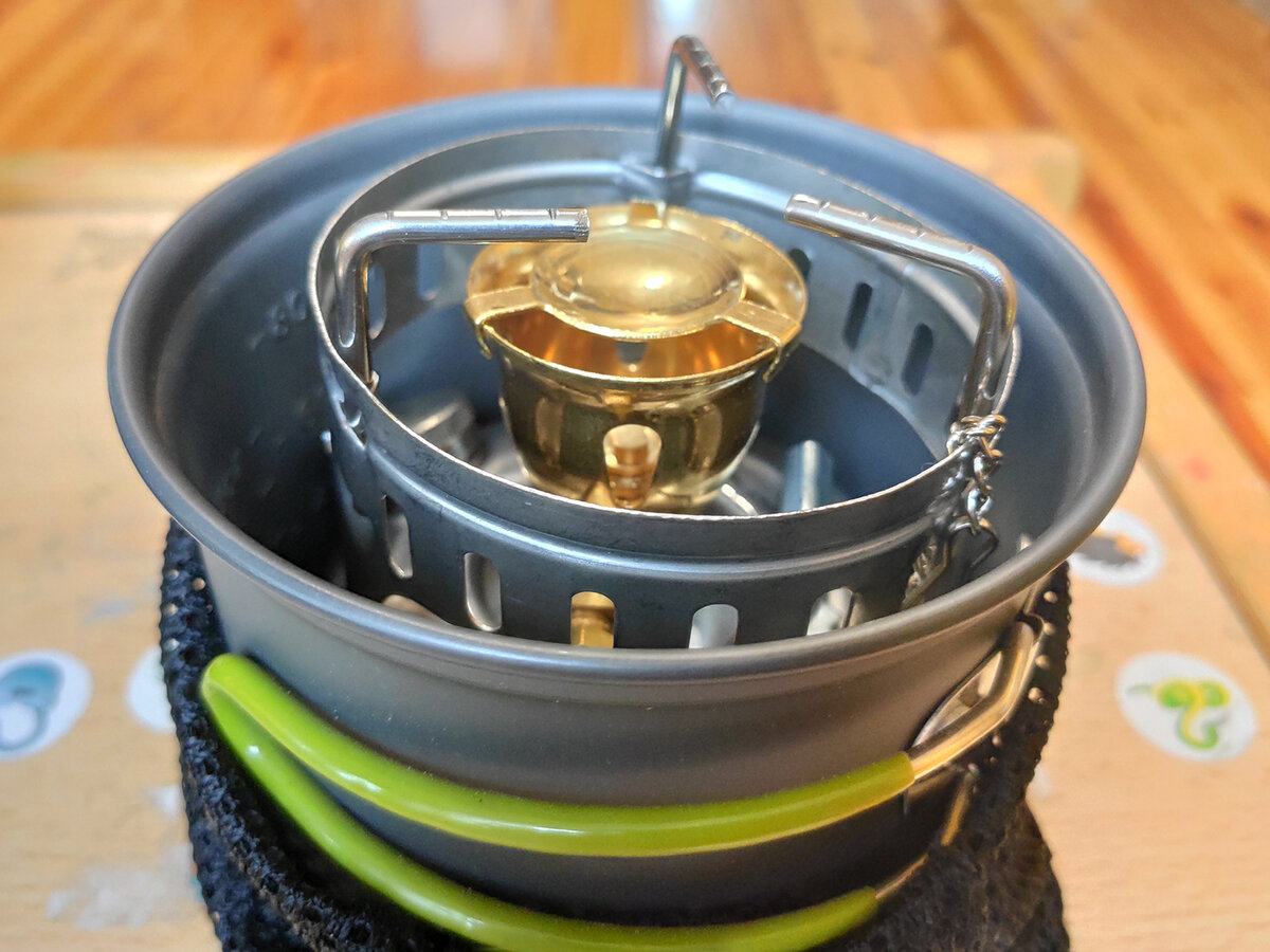

    Hi
    I just received one and I can see a wick inside.
    Have a look!!!
  2. JP2
    JP2 Subscriber
    Jun 26, 2018
    1,528
    Canada
  3. JP2
    JP2 Subscriber
    Jun 26, 2018
    1,528
    Canada

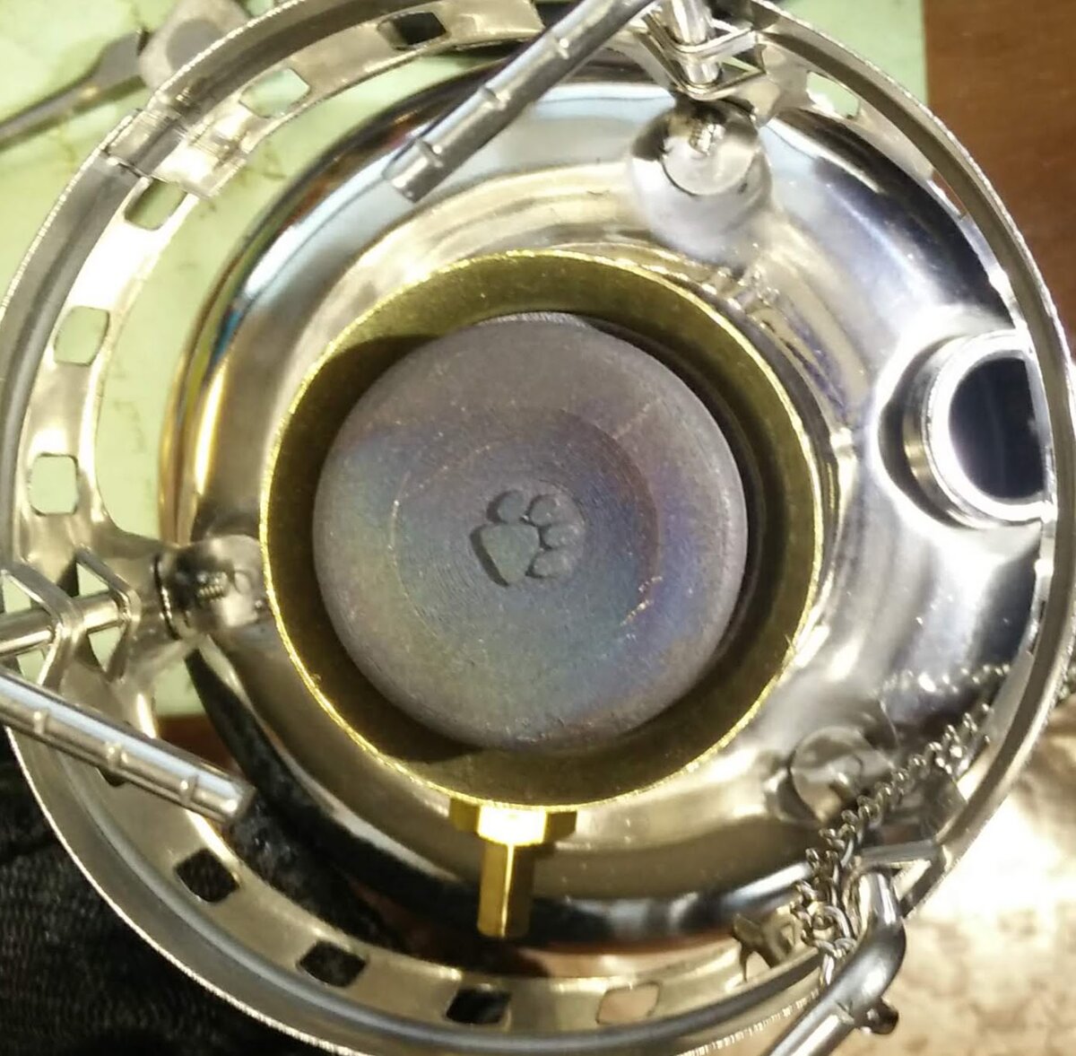

    Also, I did not try yet but with a silence of 8R on top, it may work !!!!!!! but still maybe to low.
    Which one is a bigger size silence burner ? IMG_20210105_154205.jpg IMG_20210105_154205.jpg IMG_20210105_154241.jpg

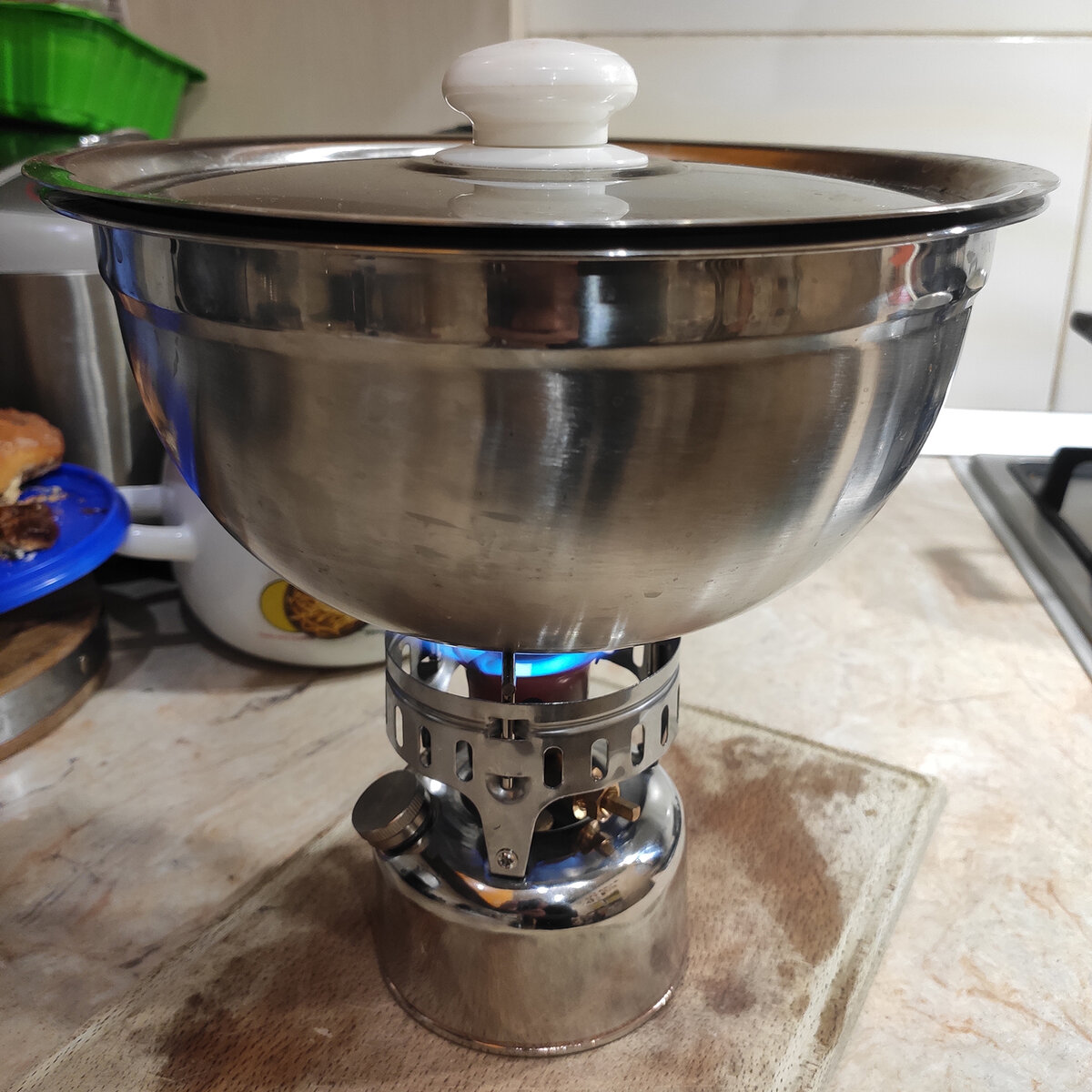

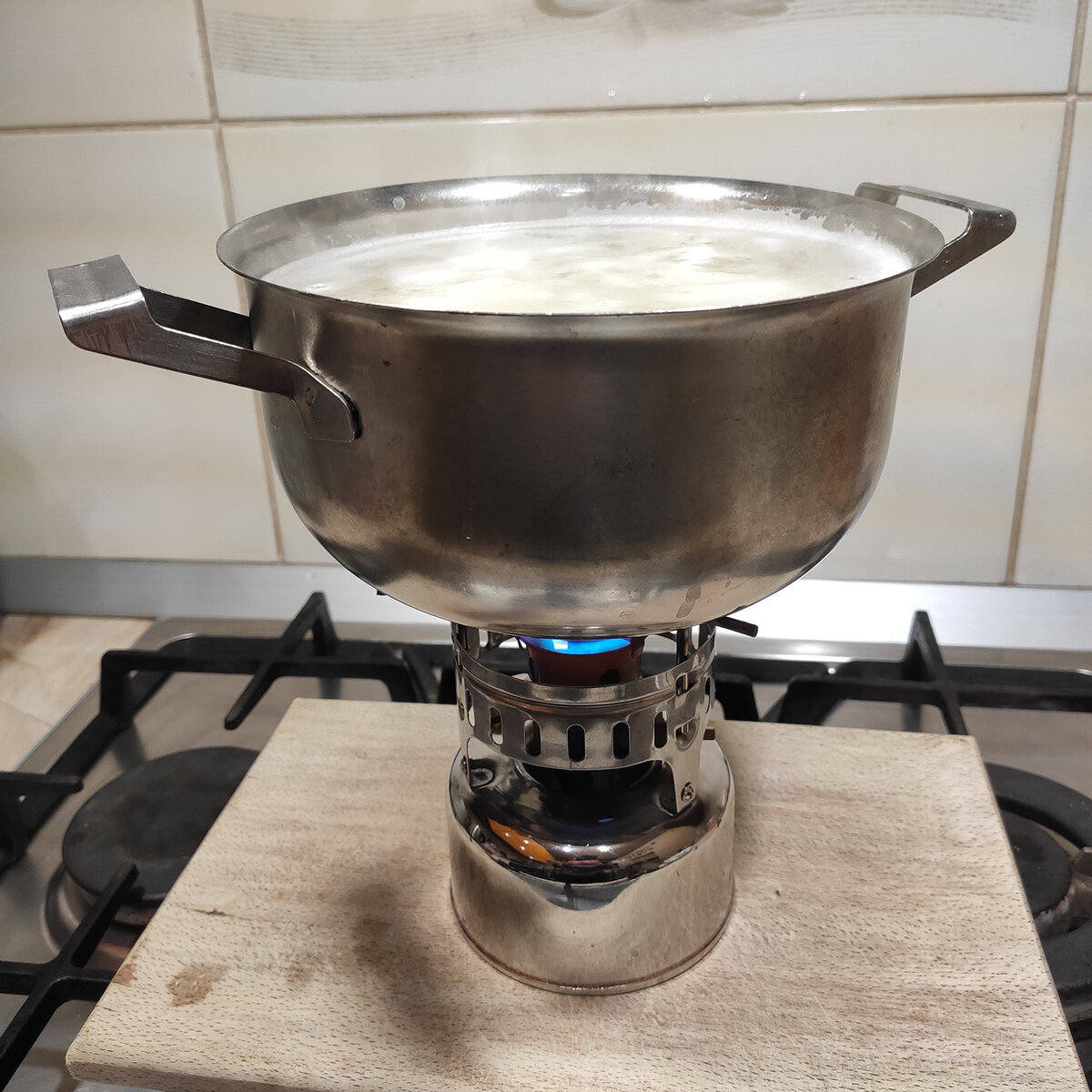

    Be careful about using a heat exchanger pot or kettle on this stove. I tested the one I just got out and as the legs aren't wide enough to let it stand on the outer rim of the kettle, the flames contacted the fins at maximum power and I could see some white fuel vapors exiting from the exhaust cutouts and some condensate buildup that dropped off the fins. Lifting the kettle off solved the problems I had. I may have to cut some pieces of brass tubing to extend the supports so they support my specific kettle and other heat exchanger pots I have in my collection will probably be necessary for full power operation.

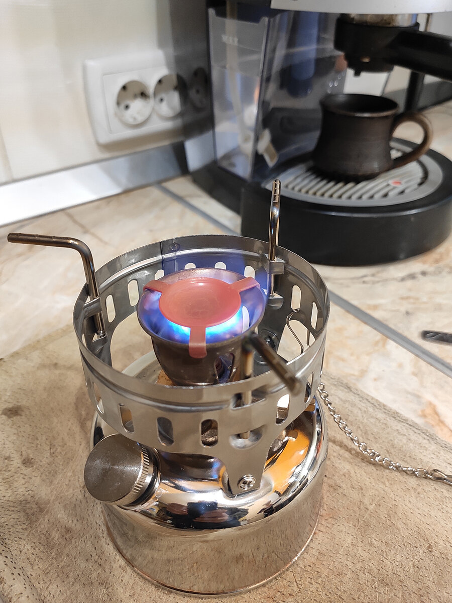

    I don't think alcohol is even needed to get this started after watching a Svea 123 startup video which involved using hand warming of a tank to get some fuel into the bell and valve body.
    Lightly using a jet lighter to warm the valve/burner body or alternatively just applying a few seconds (less than 5!) of heat on the tank and then running the valve to the point the needle comes out will pump a little bit of fuel out that splashes the jet and inside of the bell. With that initial bit of white gas I find that after ignition it will get it eventually warm enough that the valve can be cracked open to start off a weak yellow jet that will soot the inside of the burner hell and splash plate which serves to start the heating process.
    After a while of heating (maybe a minute or a few) the flame turns blue with the associated roar and the soot burns off the inside in normal operation. The tank and valve body remains clean and free of any soot and the alcohol bottle isn't needed except for the sake of a quick start but I think I'll stick with blasting the brass valve of it with a jet lighter for a little longer.

    Well with the Lixada it seems that the same method of gently warming the tank (by jet lighter anyways) like a Svea, it can be primed with the white gas and minus any sooting aside from the initial soot that builds up inside the burner bell and splash plate which is then burned off. The jet never gets dirty nor does the valve body.
    Said video on the 123 which involves using white gas to prime without sooting is this one:
    I just skipped the step of letting the fuel flow down the valve body and find that with patience it'll be enough to crack the valve open afterwards to continue letting fuel out to keep a small weak yellow flame to warm the bell up.

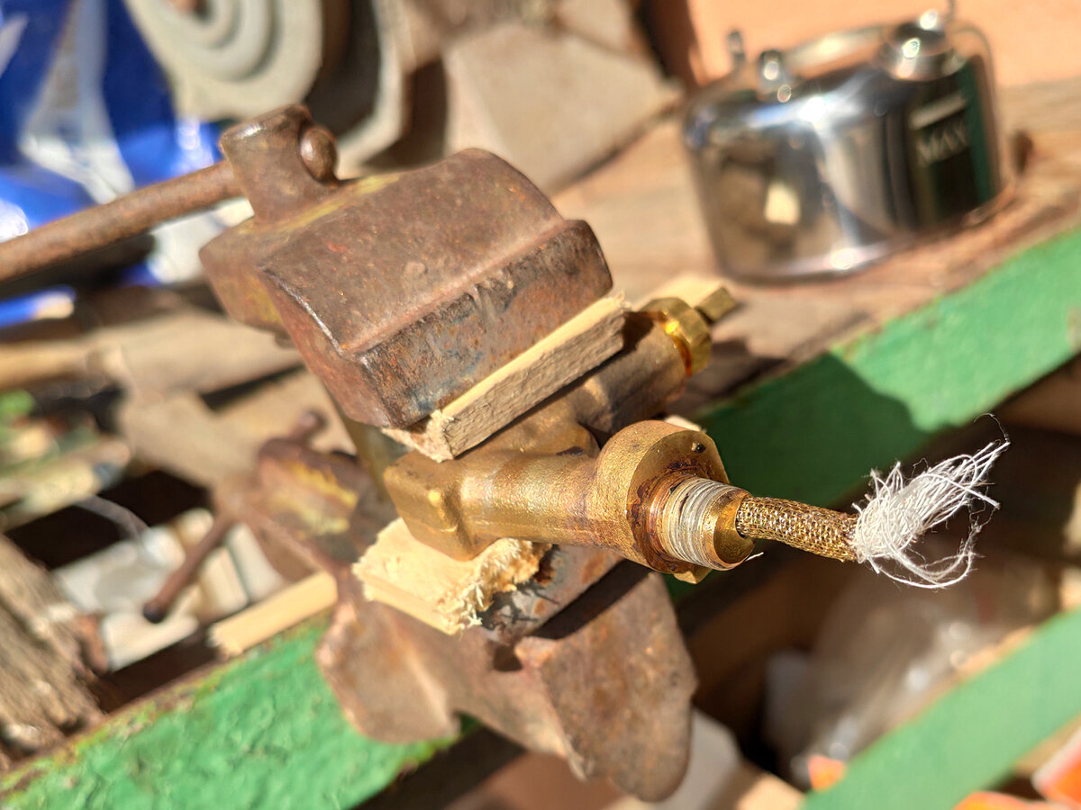

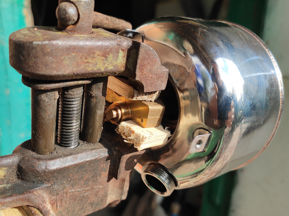

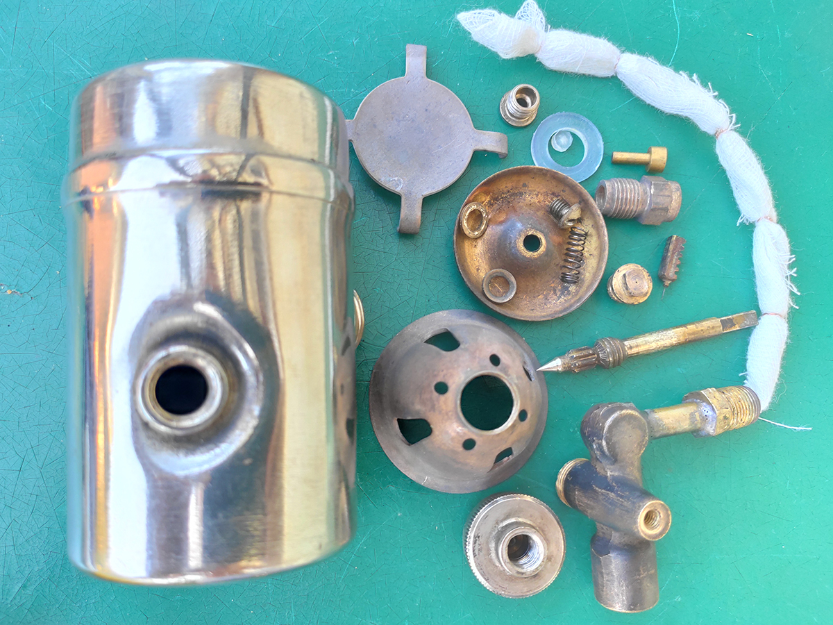

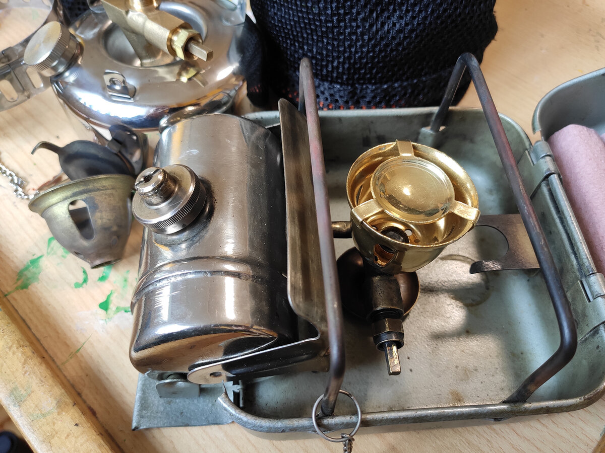

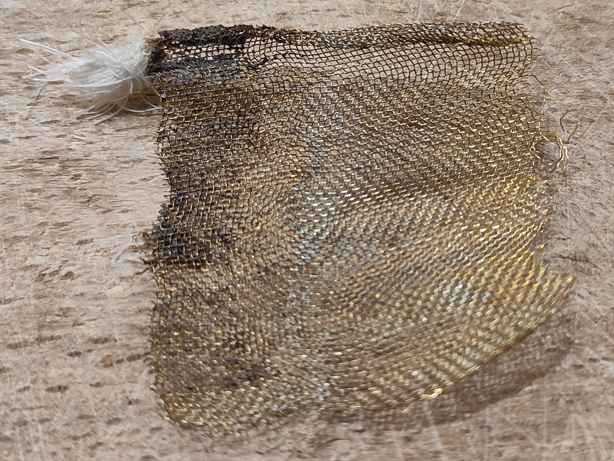

    @JP2 wick is very weak... demo-version of it))) but. its working.
    Its disadvantage is that it does not use all the gasoline from the tank.
    Im disassabled-repaired lixada (had a bad thread tank-burner seal). Saw IT...
    I have experience in repairing a PT-1 primus (Optimus 8R ussr clone, in my picture), so made for lixada a normal wick from a cotton bandage.

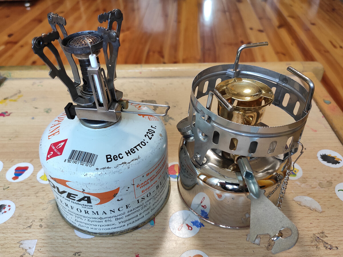

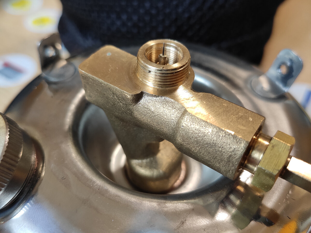

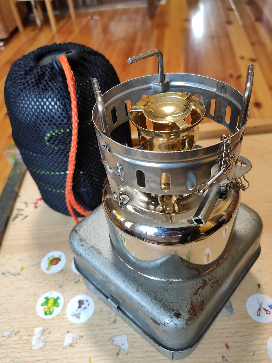

    More photos
    lixada01.jpg lixada02.jpg lixada03.jpg lixada04.jpg lixada05.jpg lixada06.jpg lixada07.jpg lixada08.jpg lixada09].jpg lixada10.jpg lixada11.jpg lixada12.jpg

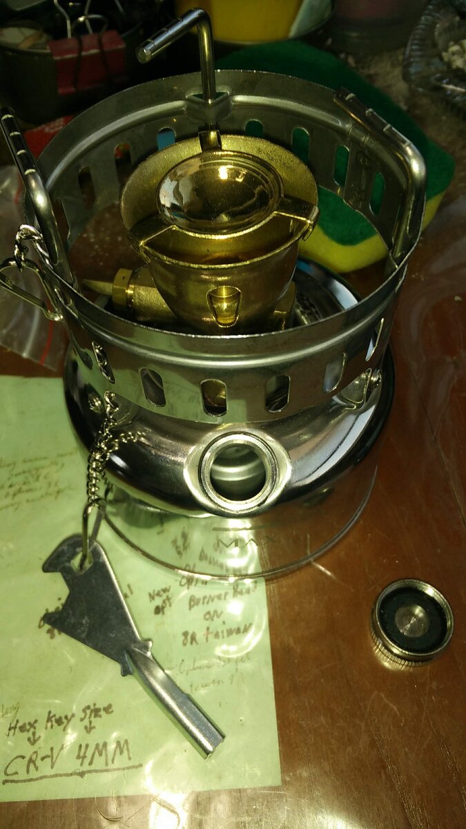

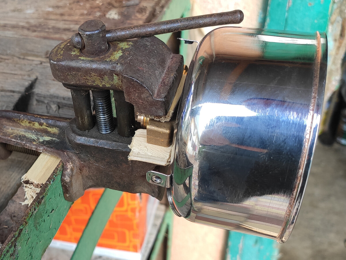

    Hi i had a spare optimus 8r srv, bored it out with s hole saw, and silver soldered srv to the lixada stove. works fine.
