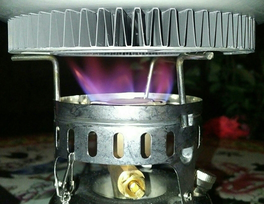

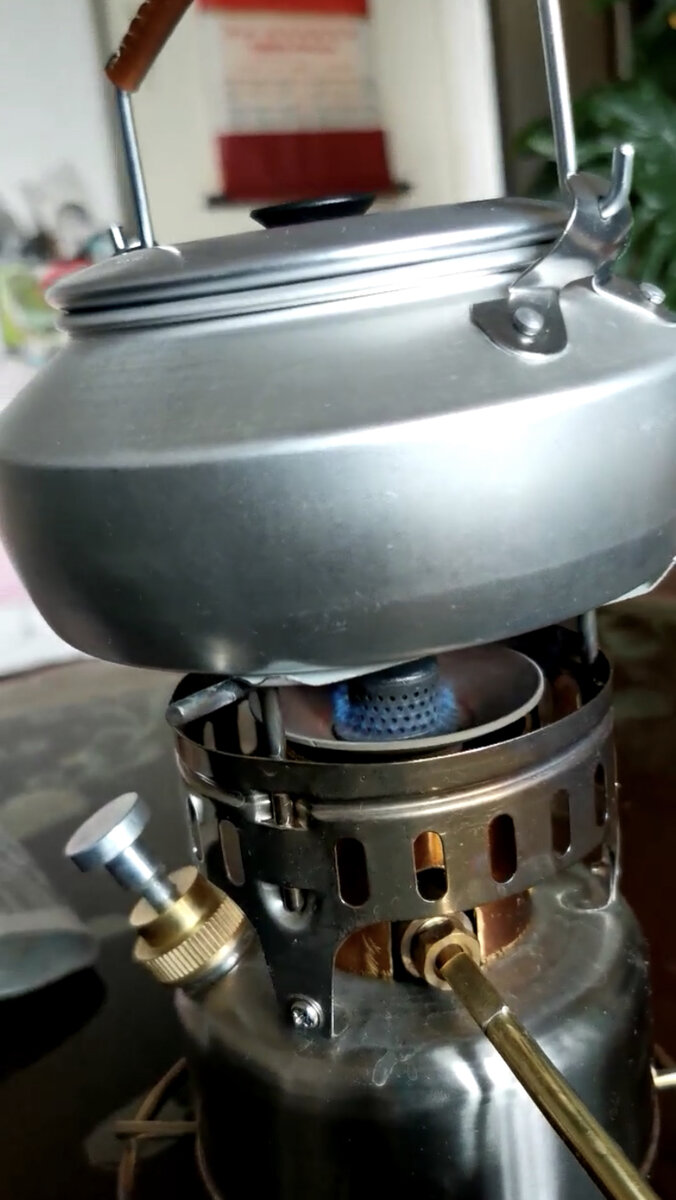

    :lol:Alcohol fuel

    @Yehong
    Hi, it works on Alcohol, how you did that? What happened to the wick?
    Where your pump come from? Nice one
