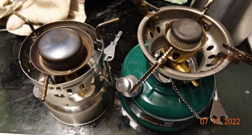

    So to answer my own question!!
    Does the Larger burner head make it faster at boil time?
    I recently bought an APG Stove with the larger silent burner head, great stove larger than the Iwalker and holds more fuel..
    So I swapped heads the APG didn't like the smaller head at all, nothing but a fire ball.
    The Iwalker on the other hand worked well with no issues using the larger head.
    So does it make for a better stove?
    In A WORD, NO!!
    Actual boil time was up by 2 extra minutes the font became hot as a waffle iron and consumed more fuel..
    Although it looks cool and beefier it's not at all efficient as with the smaller head.
    CASE CLOSED!!!!

    It may work with a wider base pot, I used a Tall 5" base pot with 8 cups of water..
    Wide head 10 minutes, narrow head 8 minutes.

    So curiosity got the better of me and made a 50/50 blend of Kerosene and White fuel to see what would happen..
    The results are good, boil time still 8 minutes (Correction with 7 cups) of water and a nice flame..
    Will increase the Kero to 60%.

    Increasing the percentage of Kerosene didn't work..
    Needs a Kerosene jet my guess?
    Big yellow flame ball was all I got.:-k

    You can add a little bit of anhydrous alcohol (avoid exceeding >10% or it can get too lean for the first attempt) or 91% isopropyl to that kerosene-white gas mix and it'll burn with a blue flame. I accidentally put kerosene mixed with charcoal lighter fluid (didn't label the bottle) into mine before without realizing it and was confused by the yellow flame before I sniffed the fuel. I experimented with mixes before and it is safe combustion wise to add a small quantity like that to improve the burning characteristics of kerosene.
