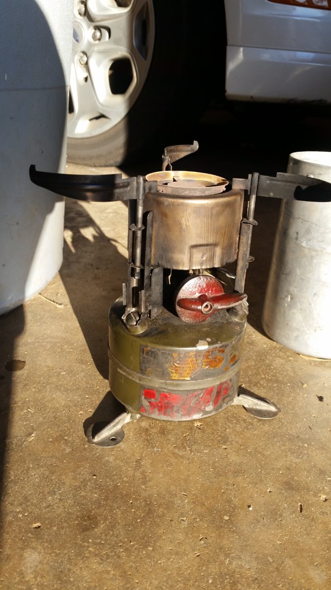

    Hey guys. I have one of these M1950 stoves. It's a Rogers 1952. I have multiple fuel nozzles/orifices mounted on unclippable little holders attached to the burner support legs. My question is each for a different type of fuel or just spares?
  6. Murph
    May 14, 2010
    2,237
    Milwaukee WI, USA
    Only spares.

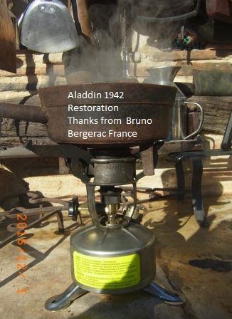

  12. Bruno QUEYREL
    Nov 9, 2016
    2
    New life for my mod 1942, just restored and burning perfect. I just had a problem with NRV brass bottom of the pump, change it for a used one* AAA.JPG , put new leather, and a viton seal.
    a generous veteran sent me that part from California.
