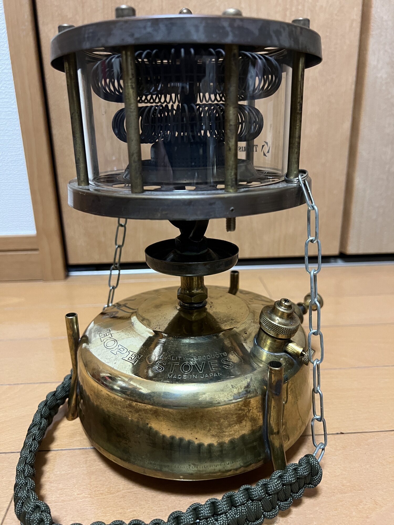

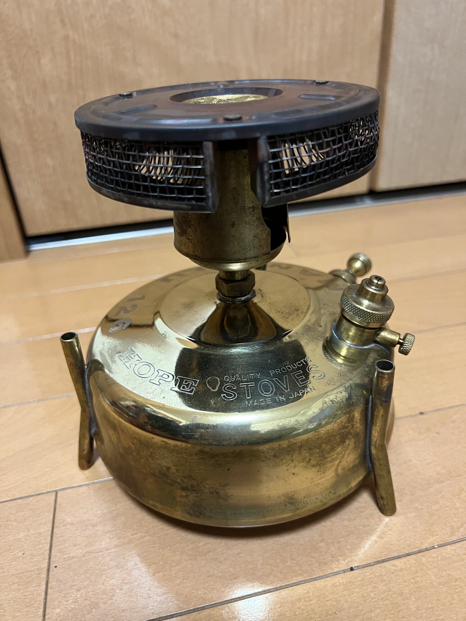

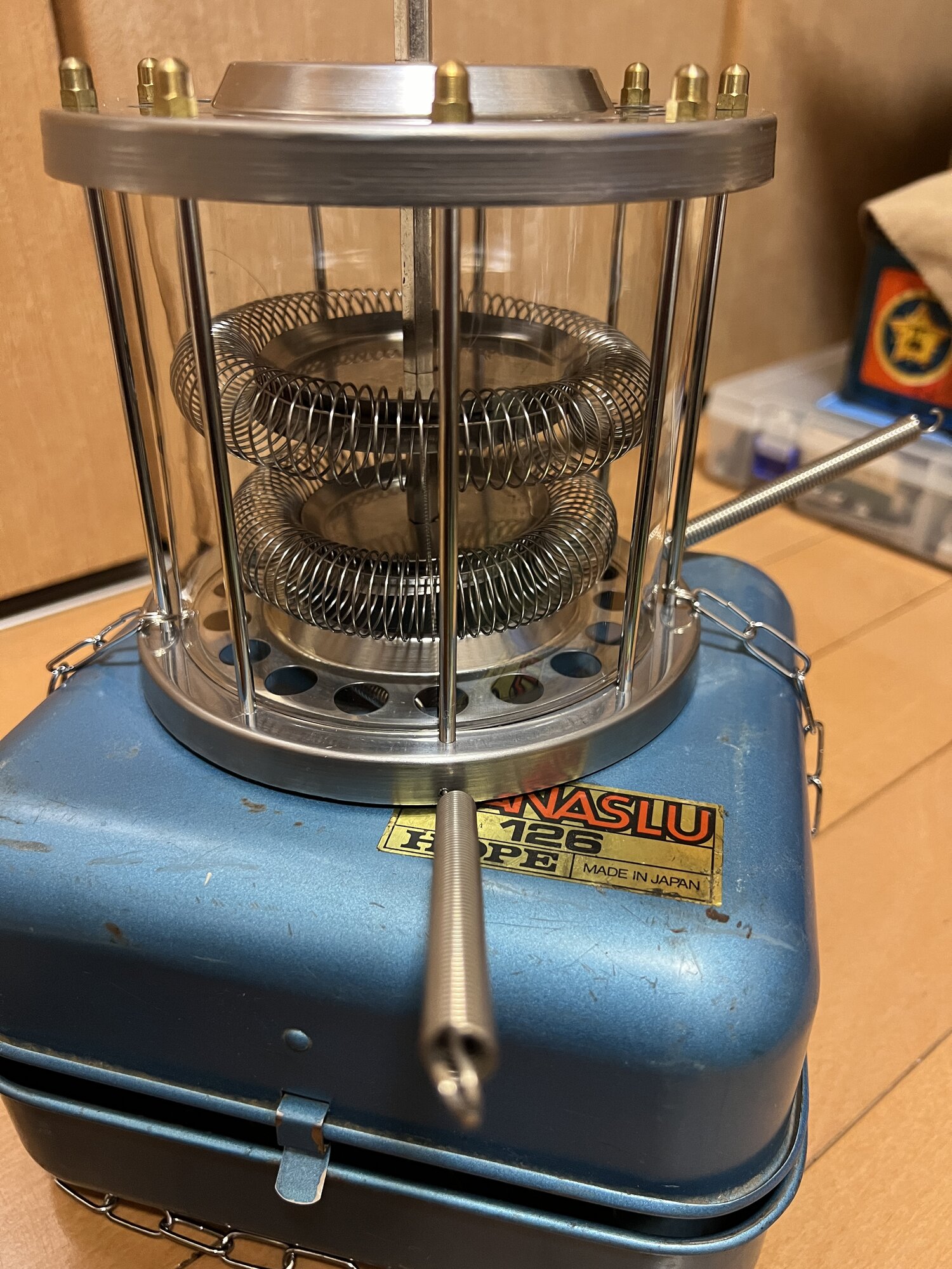

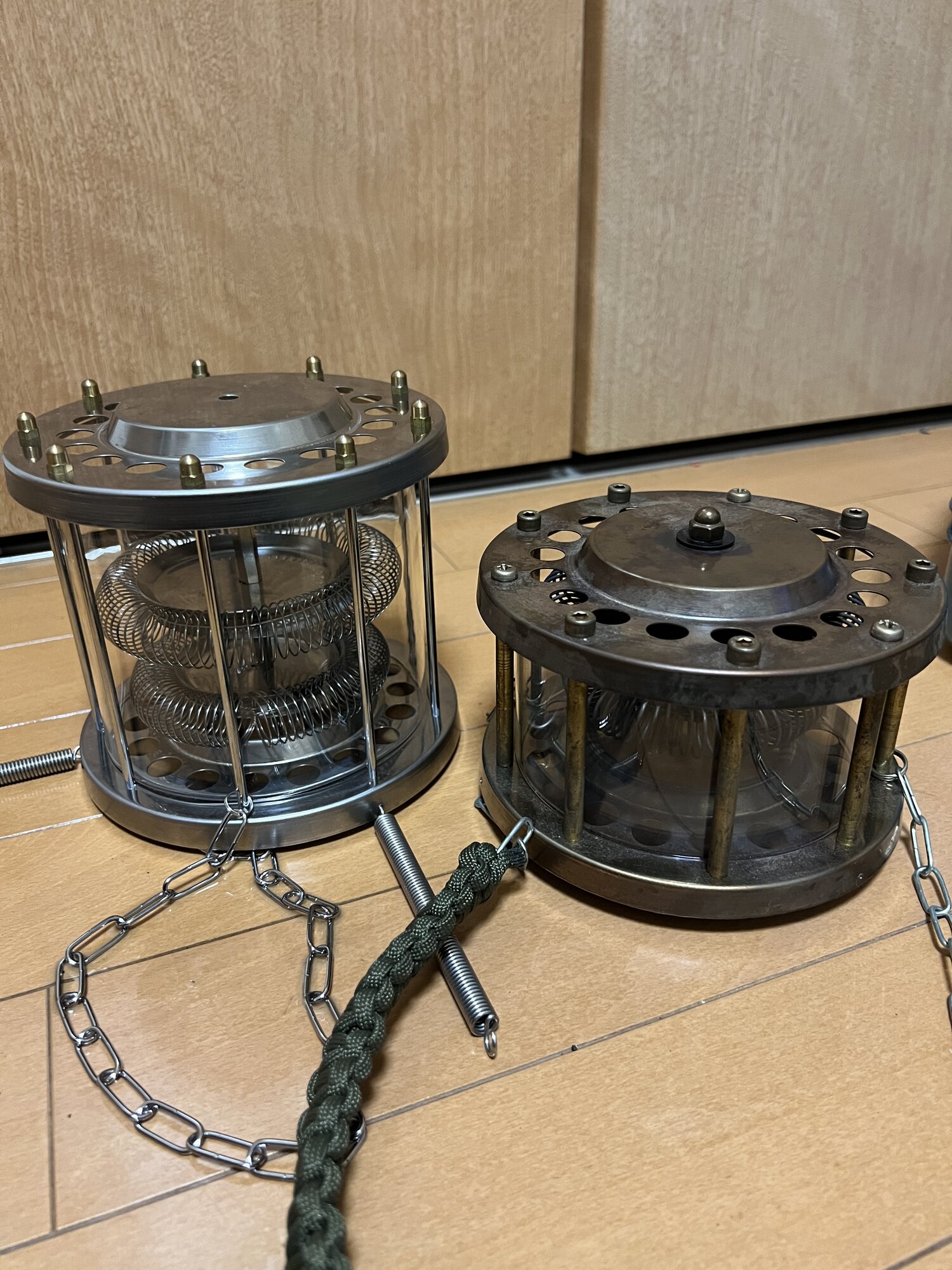

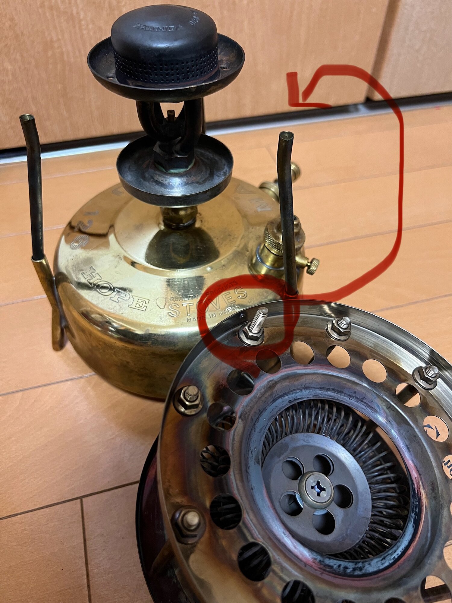

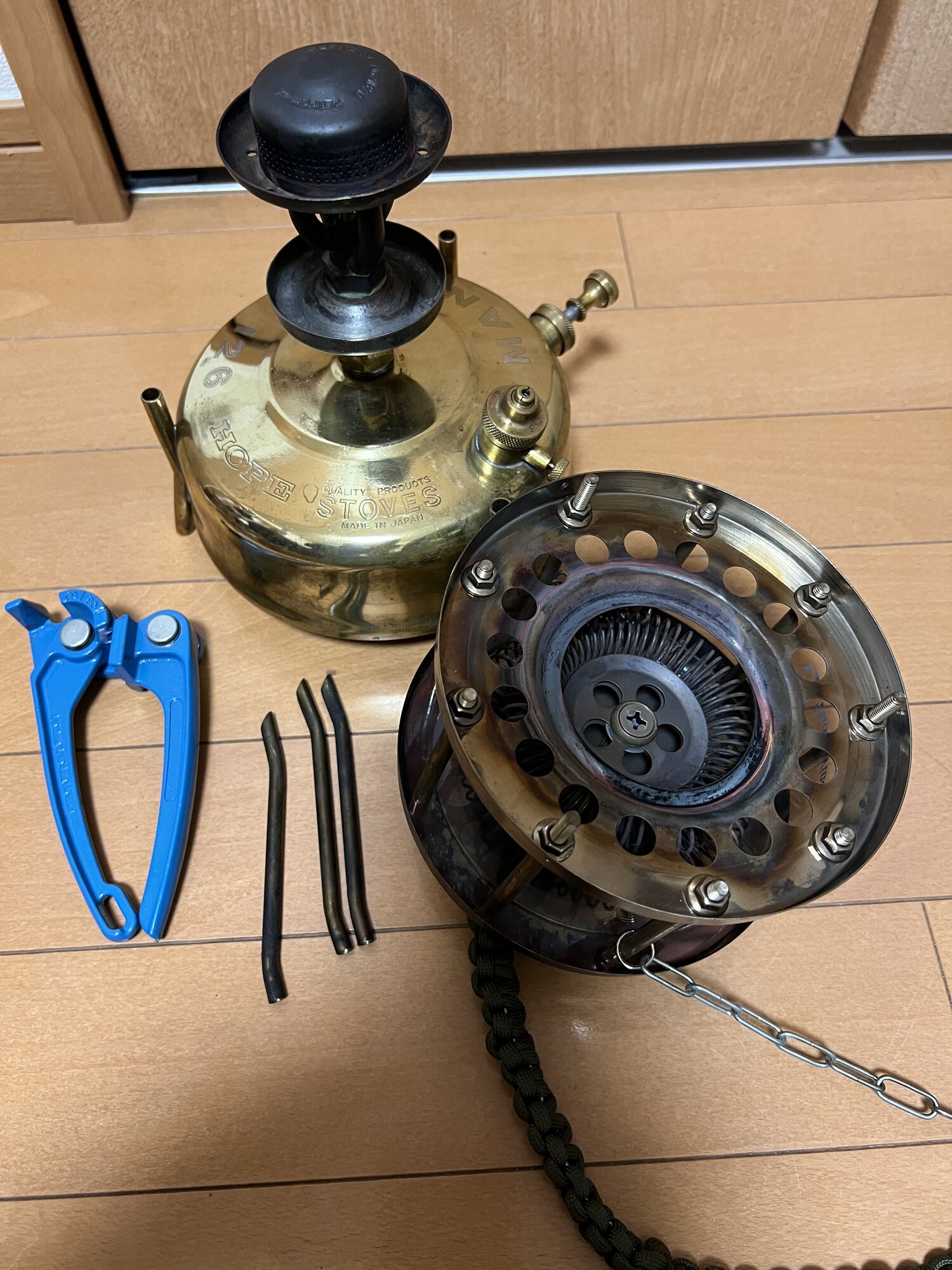

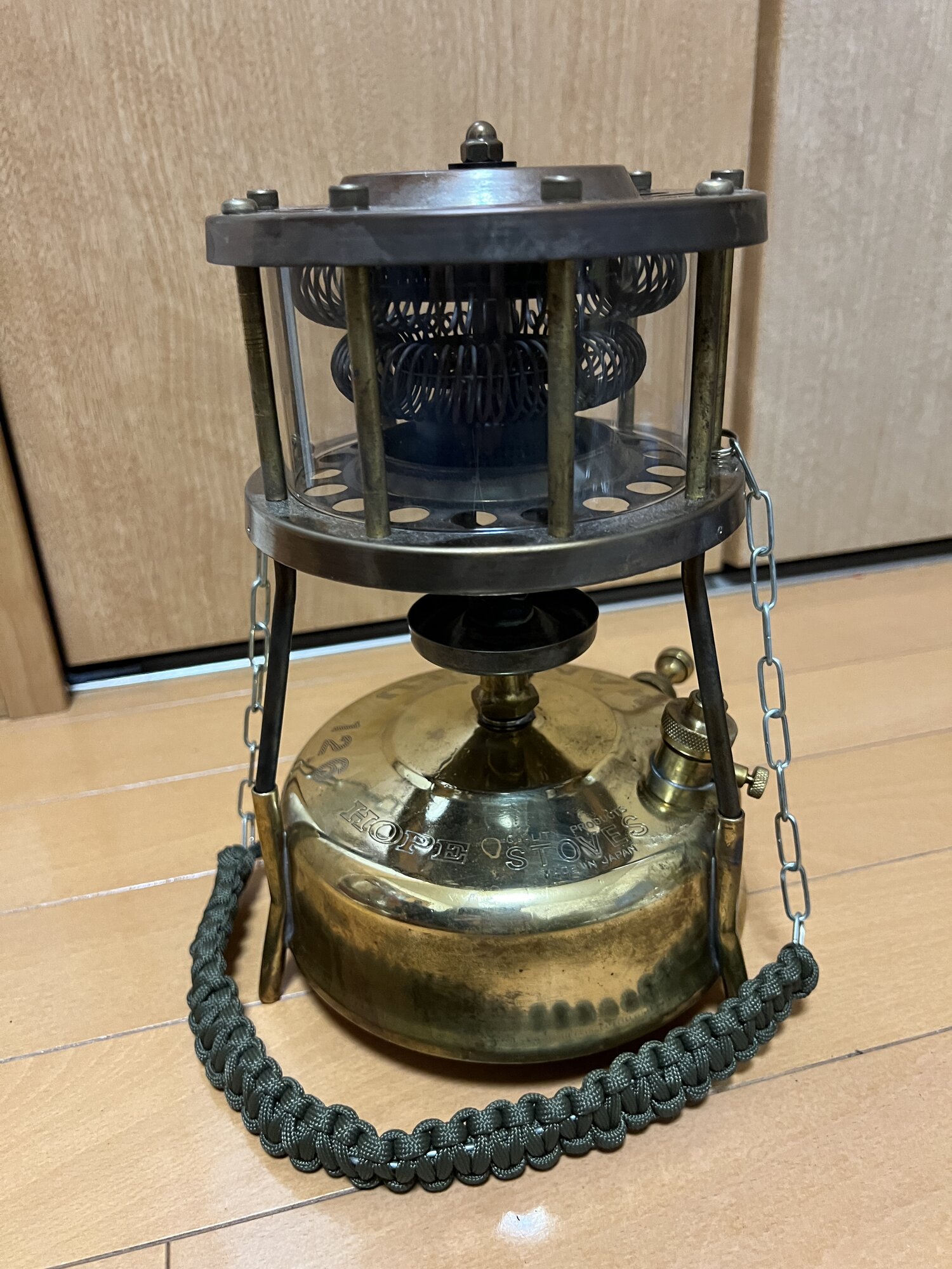

    IMG_2051.jpeg Manaslu's genuine heater attachment can't warm me up enough. IMG_2043.jpeg
    When I looked it up on the internet, I found out about a stove heater made by a Japanese manufacturer called "Takei Burner."
    I collected the parts of the "Takei burner" and made a heater attachment. IMG_2044.jpeg
    Fortunately, the "Takei Burner" attachment is compatible with the silent head, and the problem was cured successfully. IMG_2046.jpeg
    However, the stove parts of the ``Takei Burner'' are tall, making it difficult to heat the coil with Manaslu's silent burner.
    So I replaced it with a short piece of glass I found at a shop in Japan and built a stove that could heat up even Manaslu's Silent Head.
    I placed the heater attachment on it, but it is unstable if it is placed on the base of the head.
    Insert the brass pipes into the three bases attached to Manaslu.
    I thought that if I could support the heater attachment with that pipe, it would be better without putting any strain on the head.
    It's completed. After that, it will be even safer if you press the stove heater and Manaslu body with a spring.
    I wrote this using Google Translate while taking a photo with my iPhone, so please forgive me if it's a strange sentence.
    Best regards,
    Shimmei.I
