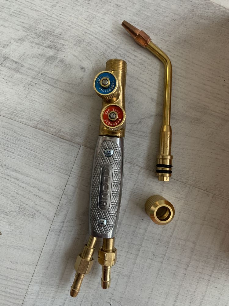

  7. Gabriel Lorin
    Nov 4, 2023
    294
    Romania
    never tried it so don't know about "black flakes". ideea just came in my mind when playing with an oxi-acetylene welding torch. the tips are made of copper there too. brass body though... image (27).jpeg

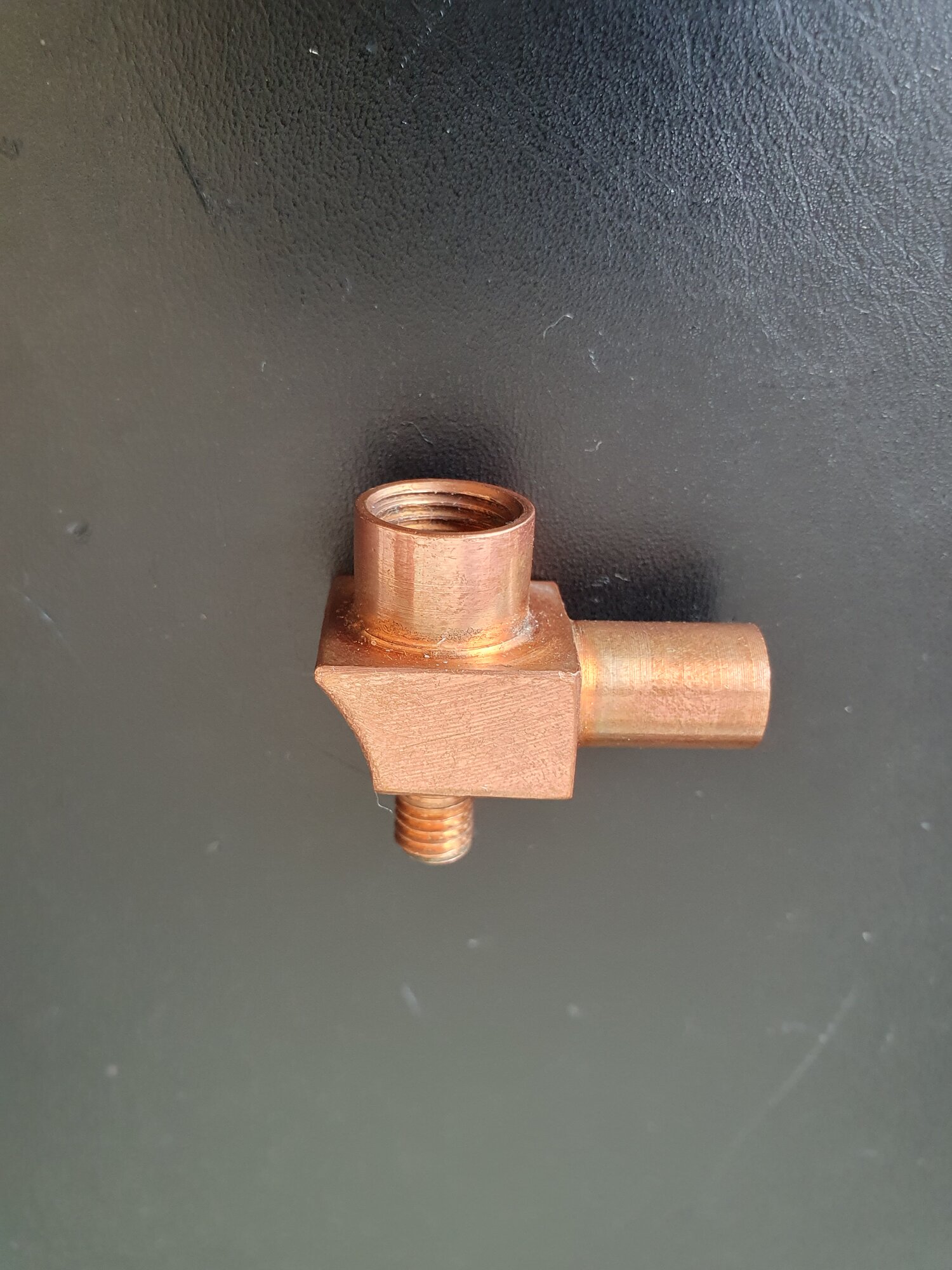

  8. Staffan Rönn
    Oct 21, 2018
    746
    Stockholm, Sweden
    The very very first prototype of the Nova burner valve house was made in copper, image below. It is true that copper has better heat conductivity compared to brass, but if I remember correctly brass was chosen for production since it is easier and more rational to machine and drill etc.
  9. Gabriel Lorin
    Nov 4, 2023
    294
    Romania
    @Staffan Rönn if that image is really the first nova prototype I have to thank you!
    my suspicions were real and based on something real.
    Brass is for budget builds. I did had around about 18 kg of copper high purity 99,9% but to melt ,pour without defects and machine it into a burner was beyond me or my means.plus time...
    Another option would be to just design a burner using autocad 3 D ,some AI testing would be nice too taking into account copper properties. Do it right the first time ,not experiment pointelessly .
    Corrosion resistance is better in brass from what I understand... If you ask me, a new burner every 5 years would be ok ,if its copper fully.
