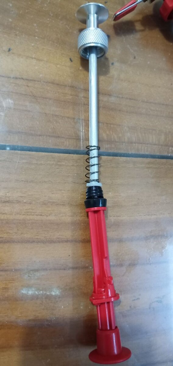

    Yes, I wanted this stove to work for decades. I'm planning to try on the leather pump cup from Primus later after I buy it, or if it not fit, I might end up making one myself.
    That's very kind of you sir, I don't want to troublesome you. Your answer has been a handful of insight into my question. I think 2 spares will be enough for now.
    I did try the BRS pump cup, but it was too small compare to MSR DF's pump cup.

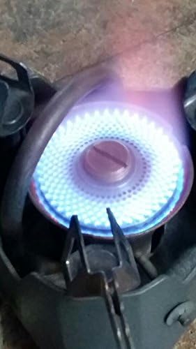

    The first thing I did was changing the DG jet. Unscrewing it was really hard. I remember to screw it a little loose so I can unscrew it easily. But I think because the stove was lit several times, the screws might be tighter than before.
    I replace the DG jet because the flame was spreading dominantly to 1 side only, to the left side of the knob, rather than to spread evenly.
    The modified LPG hose was 3 layers, and I added a smaller silicone hose that encapsulates both the MSR Dragonfly connector and the braided hose connector.
    I burn LPG/propane/butane using the DG jet, and with the modified hose + Lindal connector attach. It burns a blue flame beautifully.
    It connects to the BRS fuel-pump perfectly. Burns blue flame. I added 10-20% of anhydrous alcohol branded by Merck to the gasoline fuel. With hope to add more oxygen to the burning fuel.
    This is why I liked the BRS fuel-pump. Mostly metals, fewer moving parts, easily unscrew everything to service, cheaper parts. A BRS pump-valve/pump-cup only costs IDR20 (USD1.36). I haven't found any BRS fuel-pump service kit, but I thought I might use some parts from the MSR DF Expediton Kit.
    With this setup, MSR Dragonfly still simmers wonderfully. And still, roar powerfully at maximum flame (consuming more fuel quicker).

    If anyone curious to know my issue with MSR Dragonfly, which was not spreading the flamce evenly, you can see the video I upload in here:
    And after changing the DG jet with the one from the MSR Dragonly Expedition Kit, the issue was resolved! Anyone can watch how it runs now, here:
