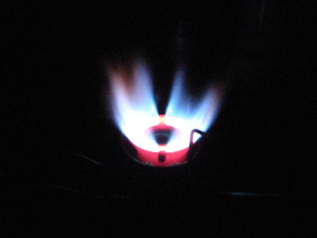

  14. snwcmpr
    22,031
    Flame shot.
    I fired up the Firefly, shut it off, cooled it off, then lowered & evened the flame spreader, cleaned the jet, and flushed the line.
    Then I fired it up again. White gas, newer but not latest pump, 11 oz MSR fuel bottle, and it's open all the way.
    Ken in NC
  15. hikerduane
    10,849
    Plumas County, CA
    Flame looks very good. I took my Everest XGK and my new to me Super Fly out Saturday night, did not bring the FF. I'll take a look in the kit, see what it has. Edit. Pricker, jet removal tool, allen wrench, N.S. pump spring?, pump cup, fuel tube o-ring, N.S. Pump control valve o-ring, 2 retainer rings, flame spreader, instruction sheet, rubber ball, O.S. Control valve o-ring, XG jet.

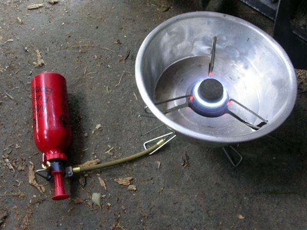

    Windscreen for the Firefly .. Homemade.
    I think this works well.
    Ken

  19. snwcmpr
    22,031
    This is the Firefly I posted about with 2 other stoves.
    This pan came with a Sigg Tourist kit.
    I looked at it today, and said "This will fit the Firefly" so I cut it up to fit.
    And a 1400 pot fits well in there.
    Ken
  20. Matukat
    Jan 7, 2008
    4,782
    Pueblo West, Colorado, U. S.
    Good job Ken! :thumbup: I have done the same thing with an angel food cake pan and although it looks like it will work, I did my cuts with a hack saw and am having a hard time cutting the slots large enough for the pot supports :( without making it ugly. :roll:
