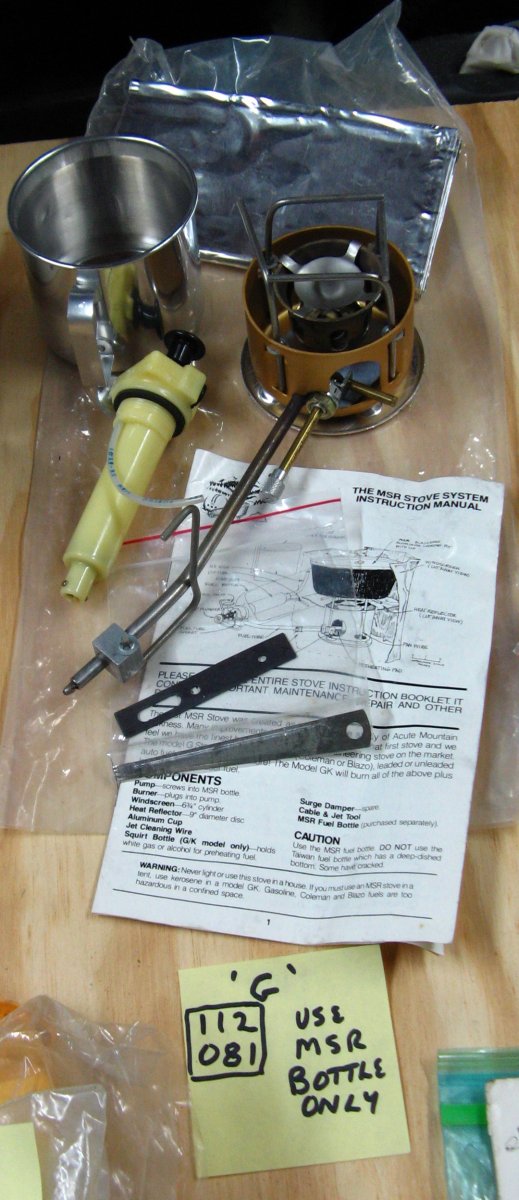

    Yes, looking over the instruction sheet there is that boilerplate front and center, as well as embossed on the pump itself "Warning - use only MSR fuel bottles MFG. by MSR" (to remove any doubt I guess.) It does have that liability "odor" to it for sure.
    I'd forgotten about the voluminous instructions, and all the fiddly bits included, what with the maintenance kits, different caps, plastic this and plastic that, check balls and o-rings & proprietary gizmos. And then the periodic recalls of the latest and greatest iteration. Yeesh.

    I am going by the instructions included in the G/GK stoves.
    The MSR bottle is referenced in the G/GK instructions.
    Is it not safe to assume that the X-GK came after the G/GK series?

  19. snwcmpr
    22,128
    MSR Fuel Bottle mentioned on same page as a reference to the GK stove.
    I am sure the SIGG bottle was still available for sale at the same time. It was and still is a viable fuel container.
    Ken
