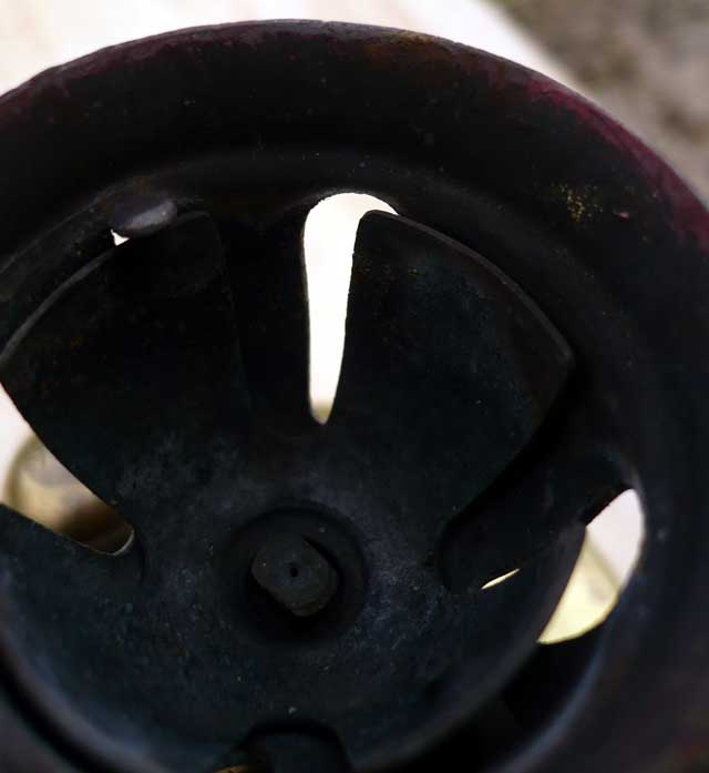

    Bonjour @Yannick Michel that is an interesting stove, you are going about everything the right way.
    Alcohol is hygroscopic, meaning it tends to have an affinity or absorb moisture or, even humidity right out of the air.
    I don't know how much of a concern phase separation of a naptha/alcohol mix in a stove might be. Does anyone know why a gasahol fuel mix was contemplated or used? Postwar scarcity or something? Straight Naptha would be preferable over alcohol or auto gas or anything else. It never goes bad, at least not in my experience. Alcohol fuels (in the tank) would tend to trash rubber gaskets prematurely, maybe. Avoid if possible, seems to me.
    I've found the jet pricker isn't needed very often, if ever, but if it is needed, you'll need it very badly. Can you see through the jet orifice right now? If so, I wouldn't worry about it for the moment.
    A "light" gauge acoustic guitar string - the high "E"; is just under 0.23mm and serves well for the purpose, until a special genuine, authentic bespoke pricker can be obtained ;) It should work for larger jet orifice, too.
    This isn't rocket science (well ... kind of) but it is important not to alter the characteristics of the jet orifice, they are a precision component and scratches or gouges invisible to the eye may adversely alter flow characteristics.

    I tried to remove the dirt from the jet burner but I did not succeed. I can’t see nothing through the orifice. I have ordering a small needle in stainless steel of 0,2 mm. I hope it will work.
    Yannick

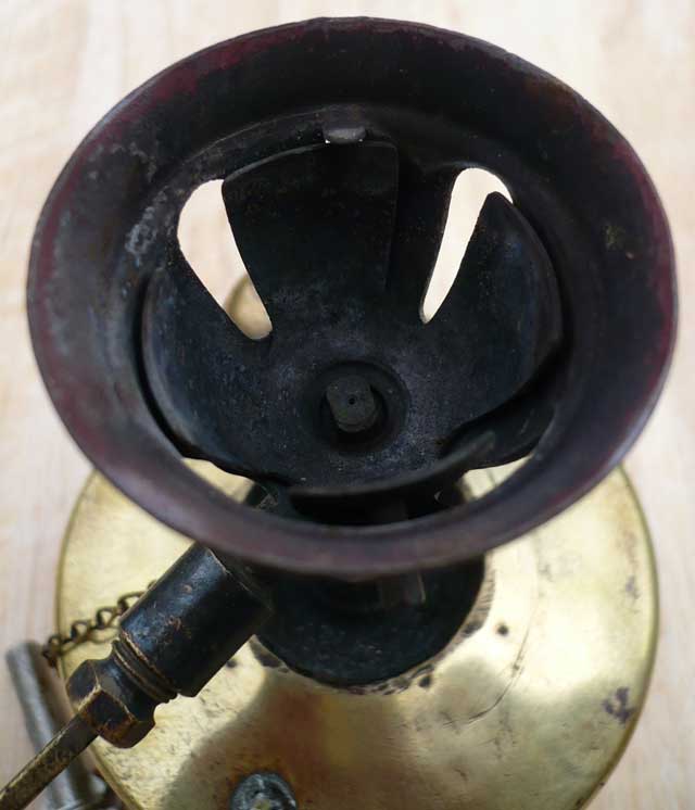

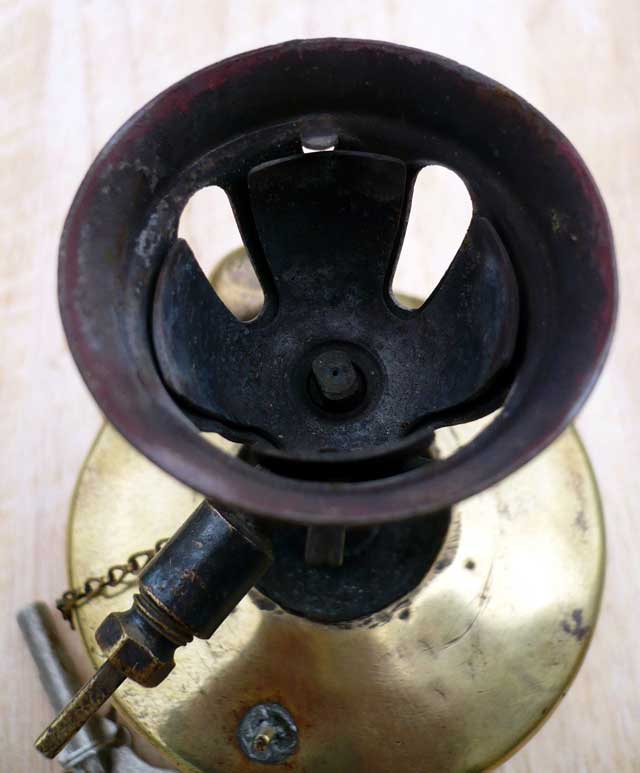

    I also wonder if it would not be better to remove the part in the tulip which normally was used with the other fuel ??
  11. Tony Press
    10,832
    Just make sure it is fully opened.
  12. Yannick Michel
    Yannick Michel France SotM Winner Subscriber
    May 21, 2021
    621
    France
    Yes the first I fired it, it was in the wrong position and it seems to work badly. Fully opened, it was better. Thank you Tony.

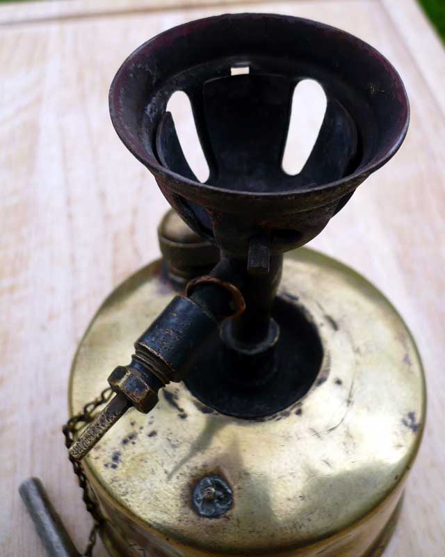

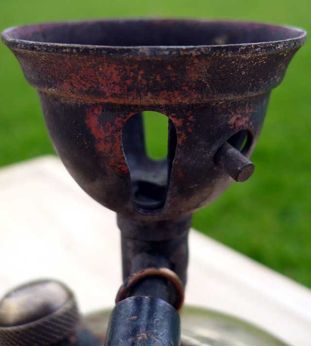

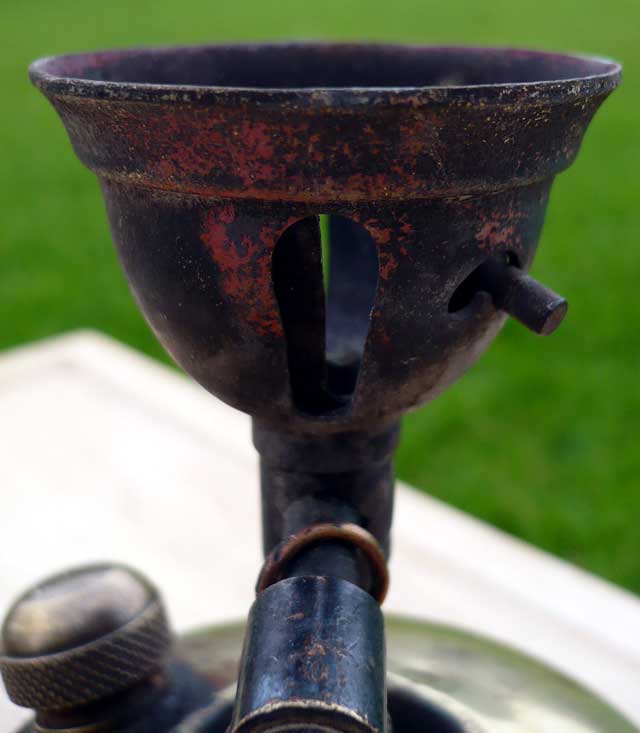

    New try : the flame is yellow/ orange... not blue.
  17. Yannick Michel
    May 21, 2021
    621
    France
    Is it normal that the top of the tulip became red quickly ? I don’t want to see this stove exploded !
    On the photos, it was my last try and curiously the flame is not blue like my first try this morning.

  19. Tony Press
    10,832
    That pot looks good!
    Usually the flame will get bluer after a good run; and will burn cleaner with the pot in place.
    It is normal for the flame plate to become red like that.
