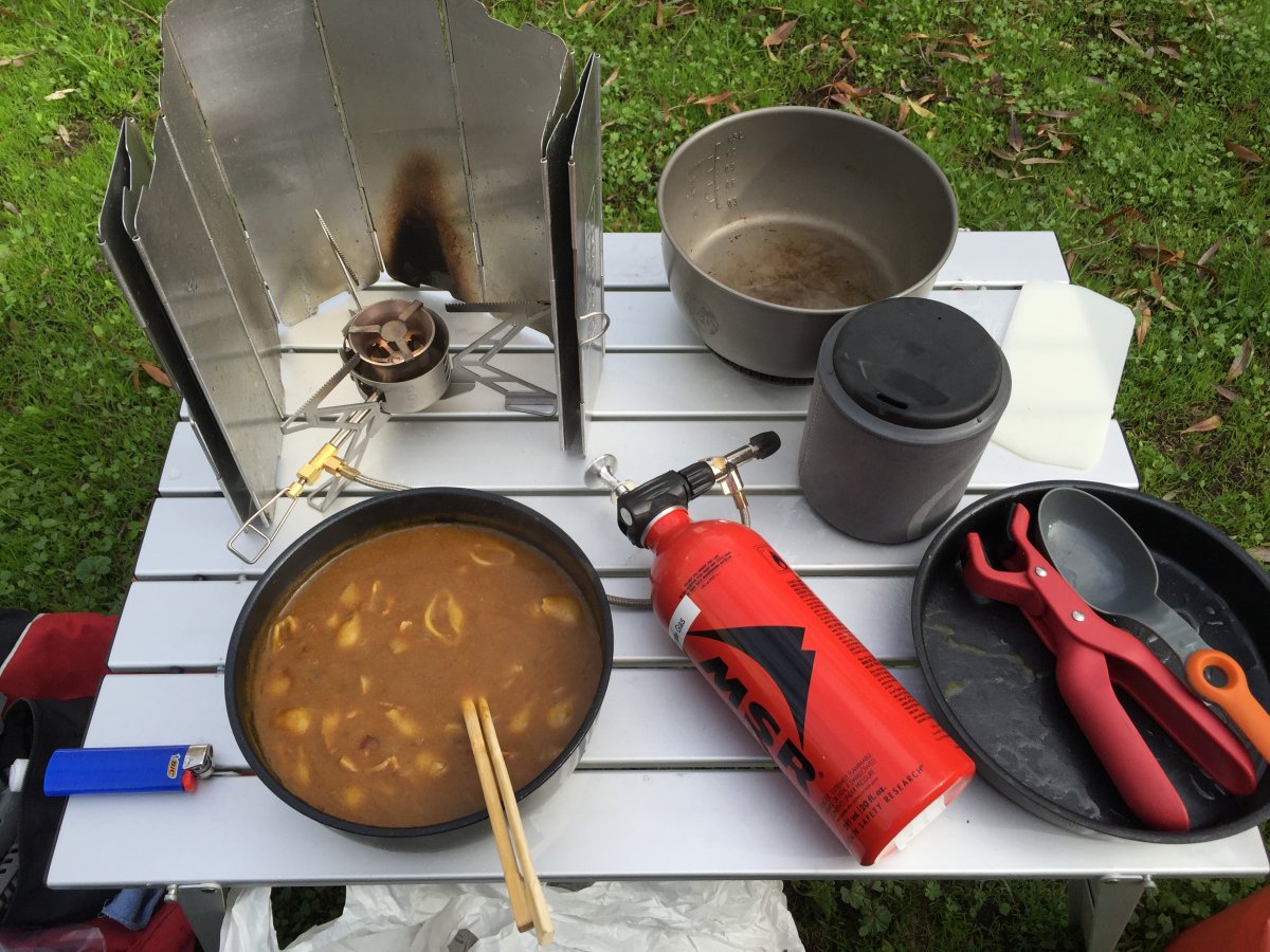

    I was going to, but in my tests earlier this week, I noticed that it doesn't seem to work as well with the heat exchanger for some reason. Works exactly the same with all other pots, but with the heat exchanger pot, it seemed to be slower. Might be that I did something wrong.
    And when there's a pot on top, and simmering is the only goal, it seems as though the roarer is not that loud. Extremely annoying at full blast, but only do that when boiling water, which is fast, so figured I'll just keep the silent burner for the gen 1 Omnifuel, and for the gen 2, go with the included splash guard.
    By the way: curry all done, and delish!
