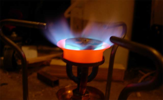

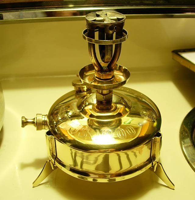

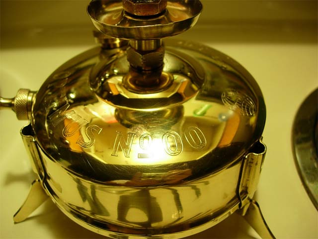

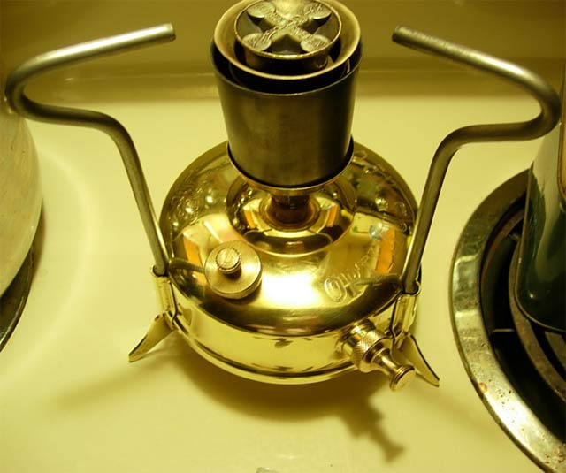

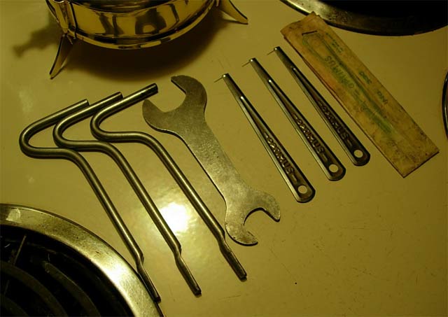

    Here's a few to get ya started.
    1355149220-150308_059.jpg 1355149225-150308_060.jpg 1355149233-150308_061.jpg 1355149241-150308_062.jpg
    1355149249-150308_063.jpg 1355149256-150308_064.jpg 1355149271-150308_065.jpg 1355149280-150308_066.jpg
    Ian....

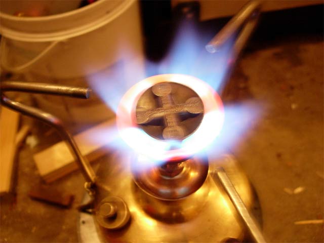

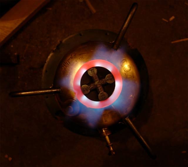

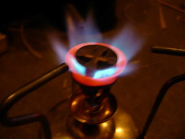

    And a few more to warm your heart.
    She purrs like a kitten and is very clean burning too as you can tell from the color of the flame.
    Ian....
  3. kerophile
    14,338

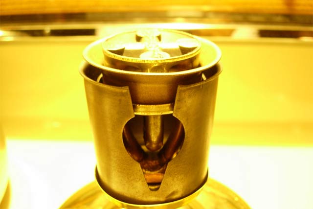

    Hi Ian, Really nice fettle and your Op.00 looks good and operates very well. A couple of minor points:
    1. In your first photo the windshield is upside down. It should be supported on the top gallery and not obstruct the spirit cup. Try it the other way up.
    2. There should be a reserve cap for the tank, which is "parked" on the top of the pump knob when not in use. These are quite often missing from veteran stoves. A fellow CCS member, Exeter-Yak, manufactures excellent replacement items.
    Well done with this stove, and great pictures.

  5. Spiritburner
    11,667
    Great pics! & a lovely fettle. I reckon this one to be mid to late 1950's. I date code on some of the paperwork may give a clue.
  6. ilerner2
    Feb 10, 2008
    52

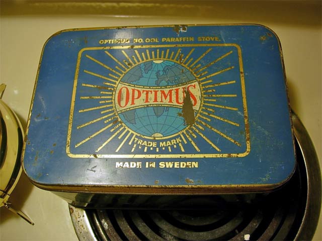

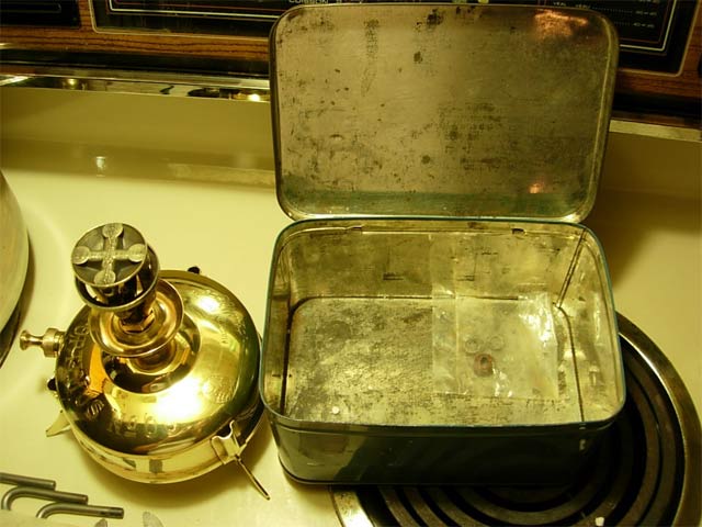

    Kerophile, upon closer inspection of the tin sure enough the spare cap was there. I tried to screw it onto the pump handle but the washer inside the cap appears too thick to allow the threads to get a start. Oh well, at least I have it!
    Ian....
  7. kerophile
    14,338
    Hi Ian, I am pleased you have the reserve cap as they are oftem missing on veteran stoves. You need to remove the old washer from it and make a new one from 1.5 or 2mm thick nitrile rubber. You will see there has been a fair bit of correspondence on CCS about this rubber recently.
    Here is a tip: If you want to remove old, hardened washers from reserve caps or filler caps you have a choice;
    1. You can either hack them out with a sharp implement and risk cutting yourself or scratching the brass, or:
    2. You can hold the cap in a pair of pliers, apply heat from a blowtorch, or stove and then prise out the now softened old washer.
    Nice Fettle.
