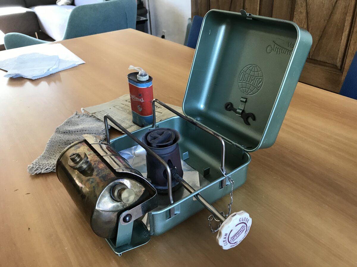

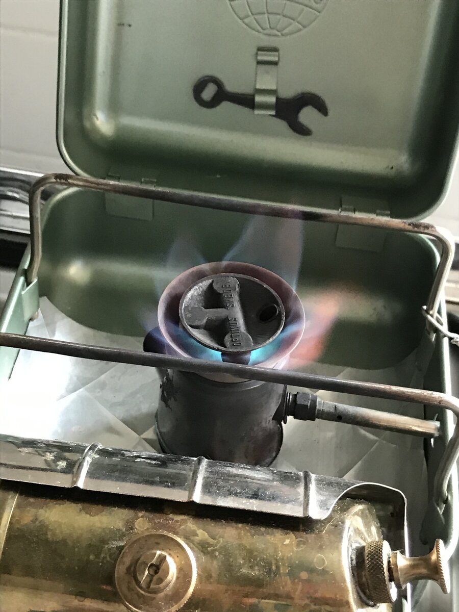

    Hi all,
    A little soaking in olive oil and some fiddling around trying to get the thing back in the tube: the pump is performing fabulously,
    With a borrowed fuel cap from one of my other 111’s it is time to try the beast:
    preheat with meths, and then:
    oops, little flame from spindle to be adjusted. After having done that it performes great!

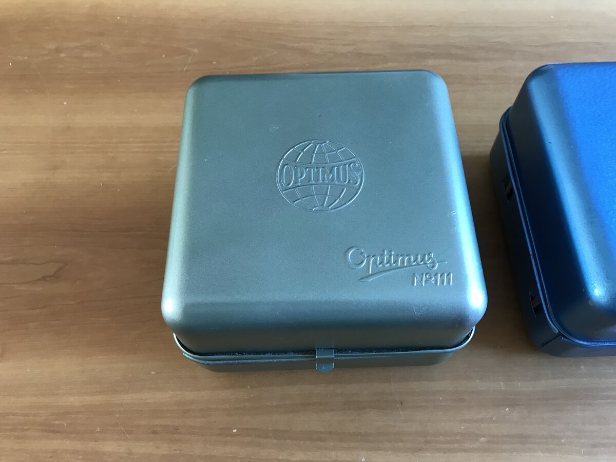

    Hi folks,

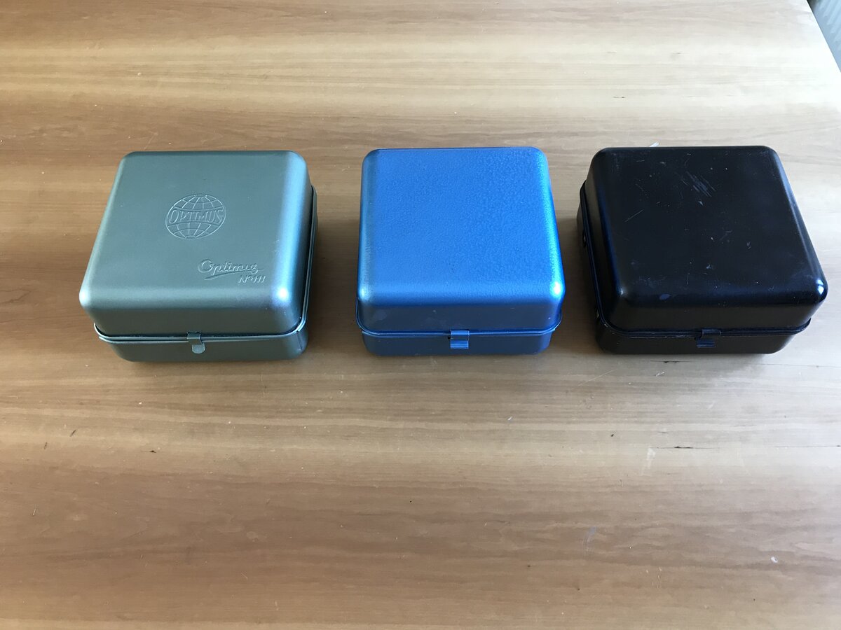

    I finally got to the refurbishment of the case of my early fifties Optimus 111.
    Although de upper half of the case was in remarkably good condition, the lower half was rusting and loosing paint. I hesitated whether to preserve the good part and take on the bad parts, but decided to tackle the whole case.
    Electrolysis bath and painting had to wait for spring, but now I got round to it.
    image8.jpeg image5.jpeg image7.jpeg image9.jpeg image3.jpeg image1.jpeg image0.jpeg
    I polished the tank only a bit, but the result shows the age of almost 70 years, which is to me better than a finish newer than new.
    If pandemic circumstances allow this year, it will go with me camping!
    Enjoy!
    Greetings, Tonio

    thanks all for the compliments! I surprised myself with the result! All thanks to the knowledge you all share with this forum, especially you @kerophile special thanks. I used Motip paint, number 52750 70E871C4-CC1B-45D9-9965-1E878FD12632.jpeg greetings, Tonio

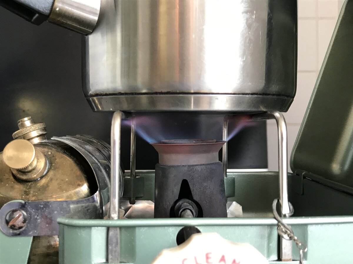

    Hi all,
    After refurbishing the 111, I decided to take it with me on holiday to France. Pandemic circumstances did not prevent camping,luckily.
