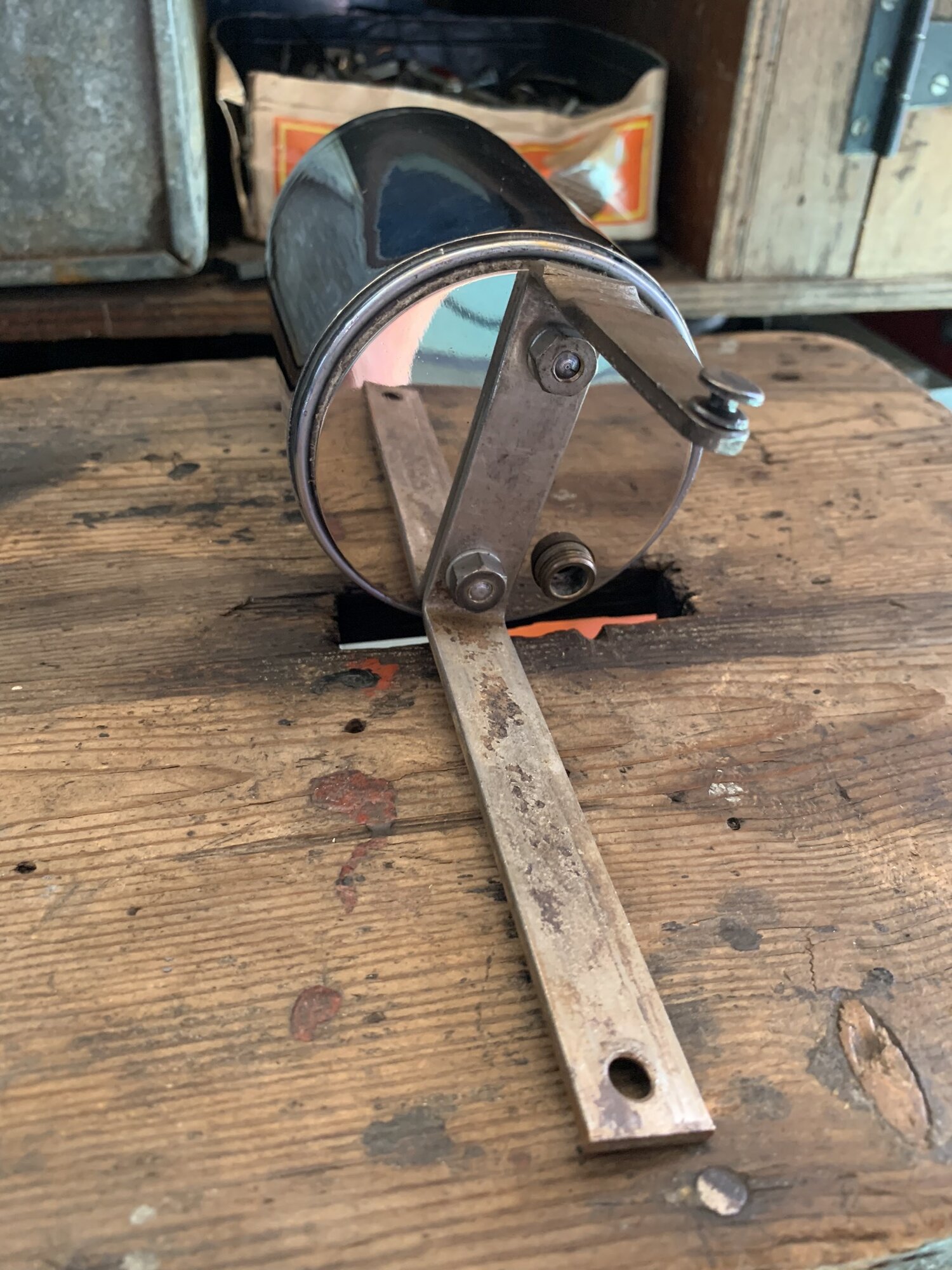

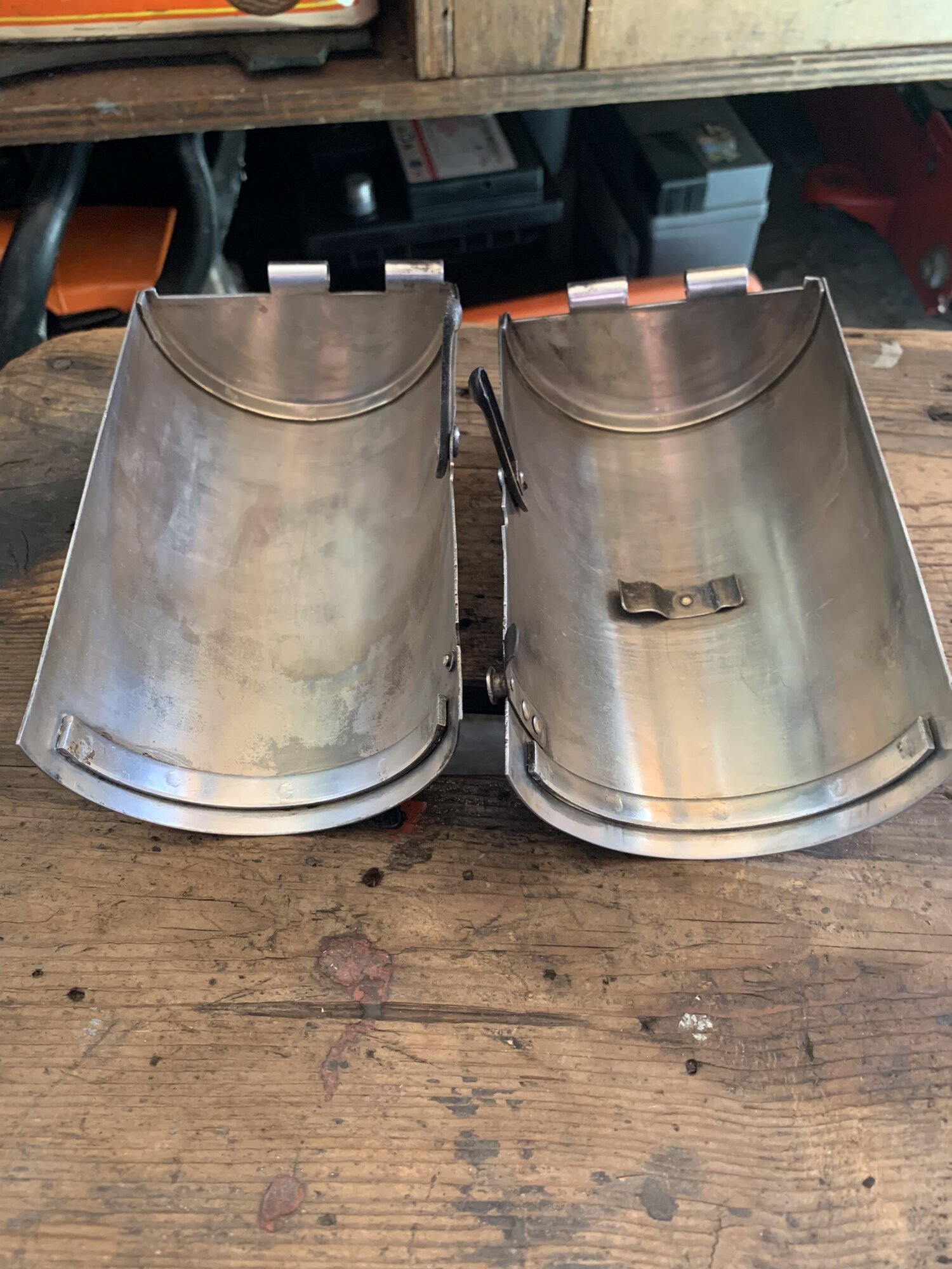

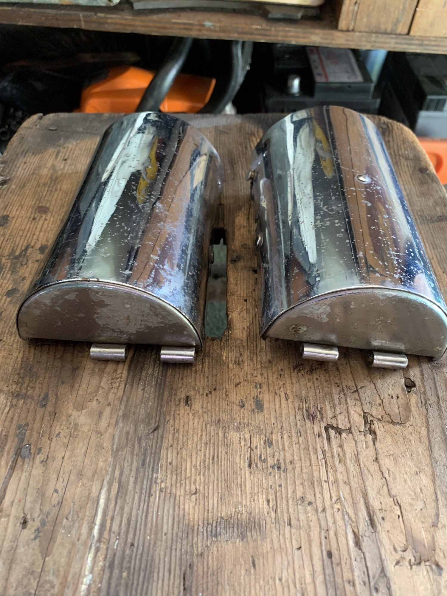

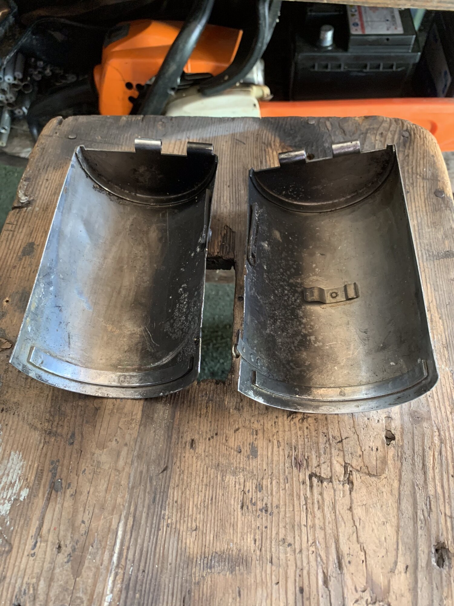

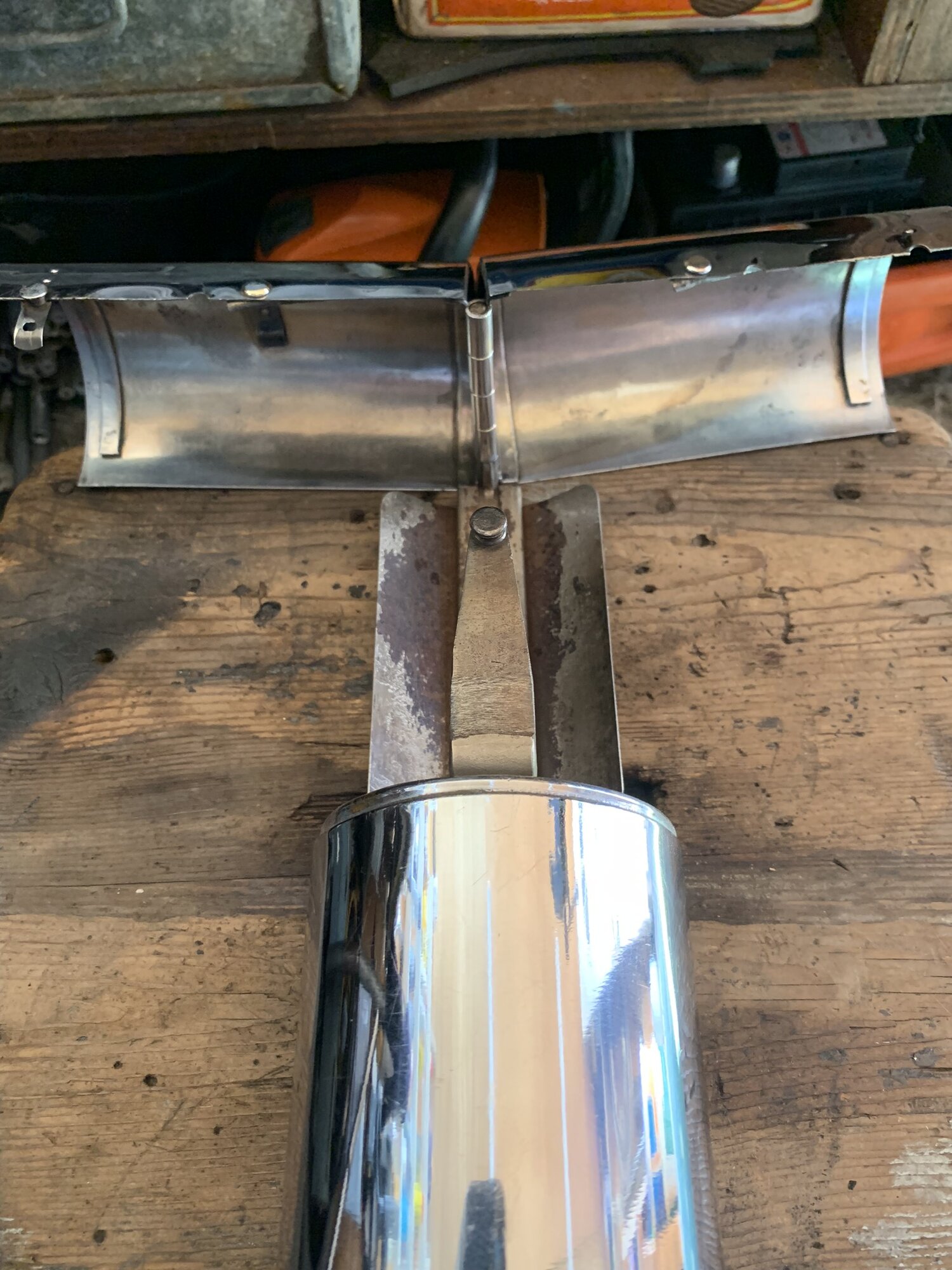

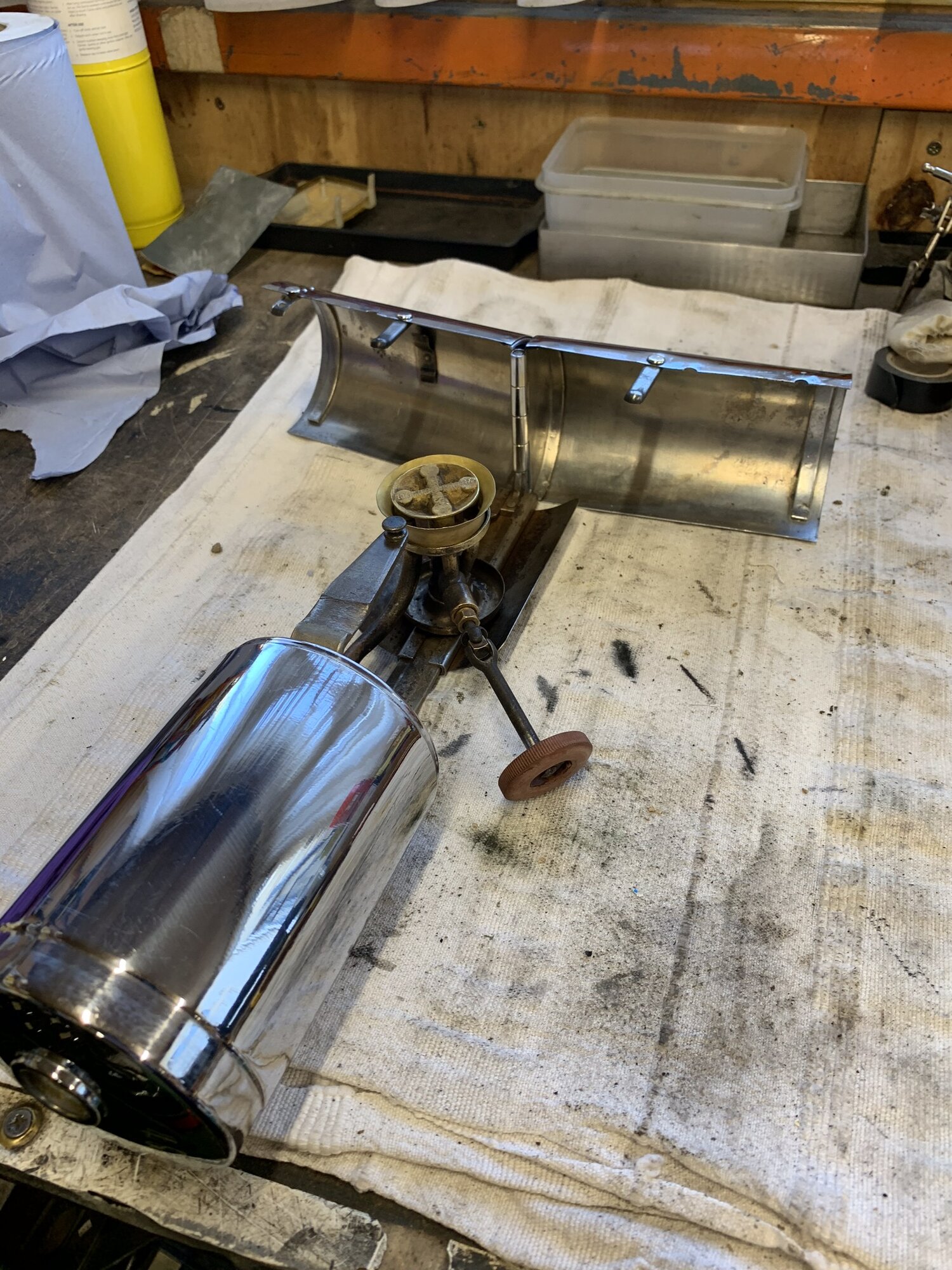

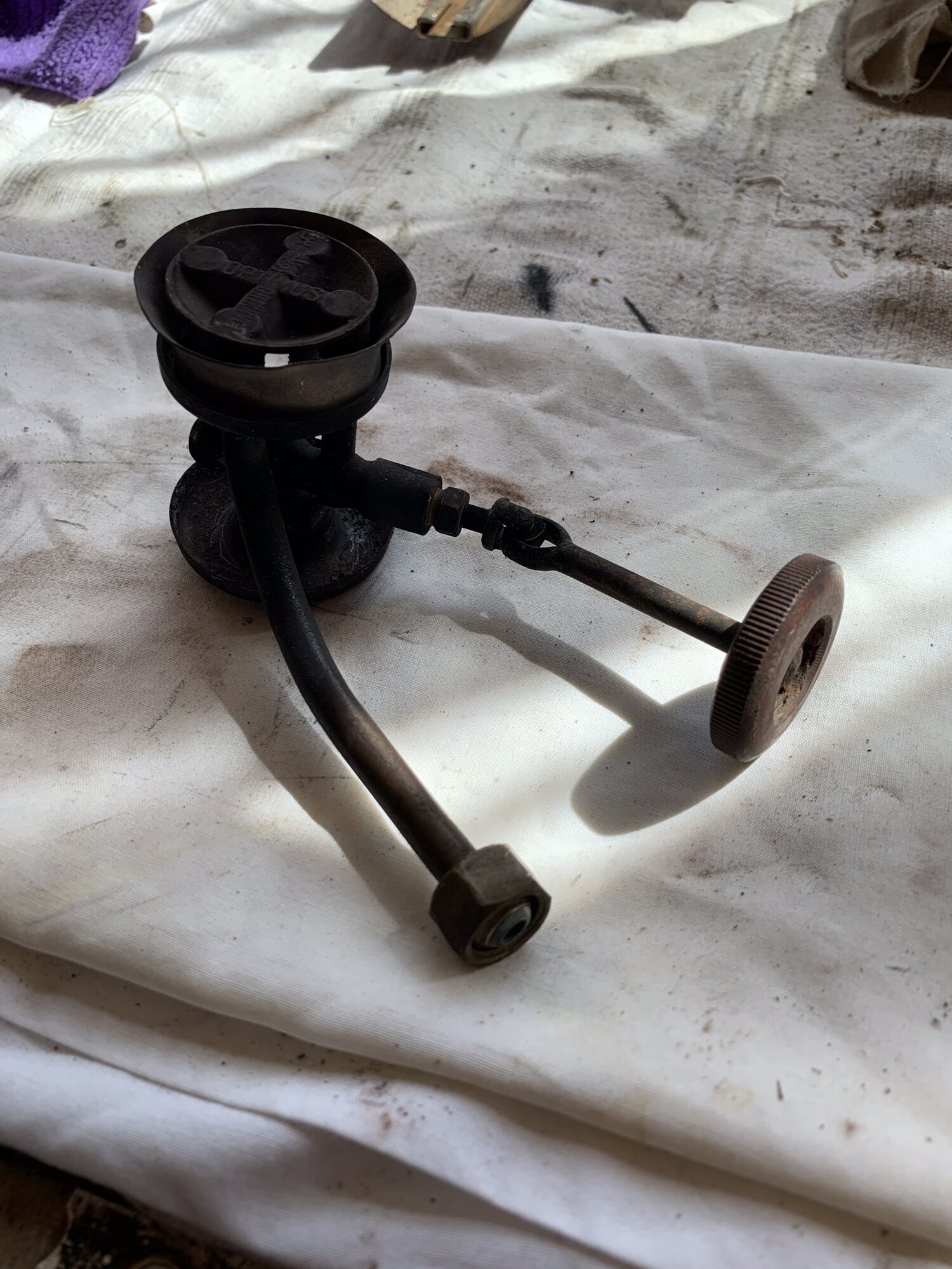

    Clam shells were the first to get some fettling, I had a few dents to tap out and generally clean them up, unfortunately at some time in its life it looks as though someone has decided to use a screwdriver or something similar to prise open the stove, why they didn’t just press the button beats me, anyway I decided not to take a file to the edges it as it would of just made things worse, sometimes it’s best to leave imperfections and life long patina alone as it is all part of the history.

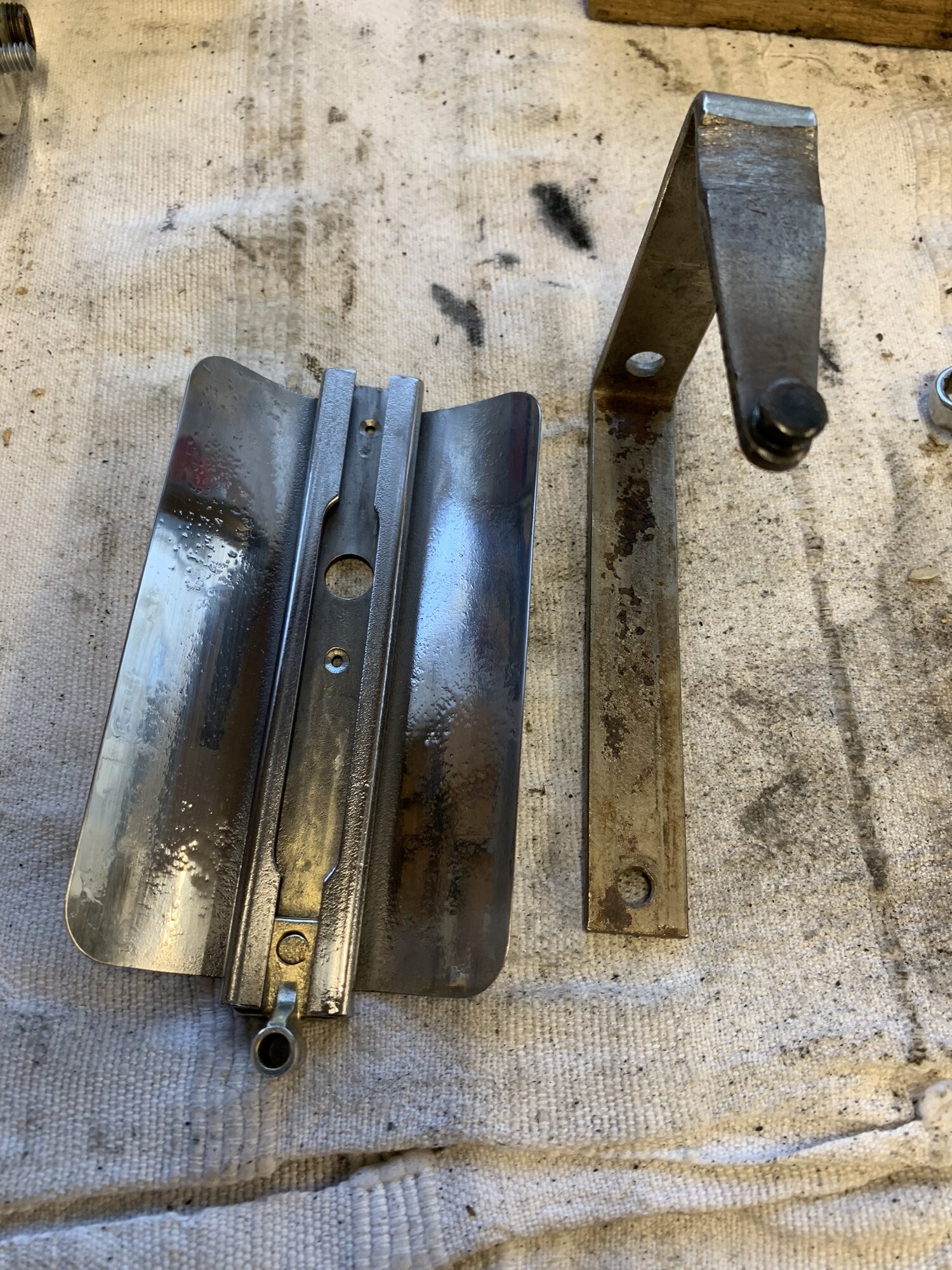

    The nickel plating has started to flake off the bottom heat shield and main bracket that the burner mounts onto and also connects the clam shells to the fuel tank.

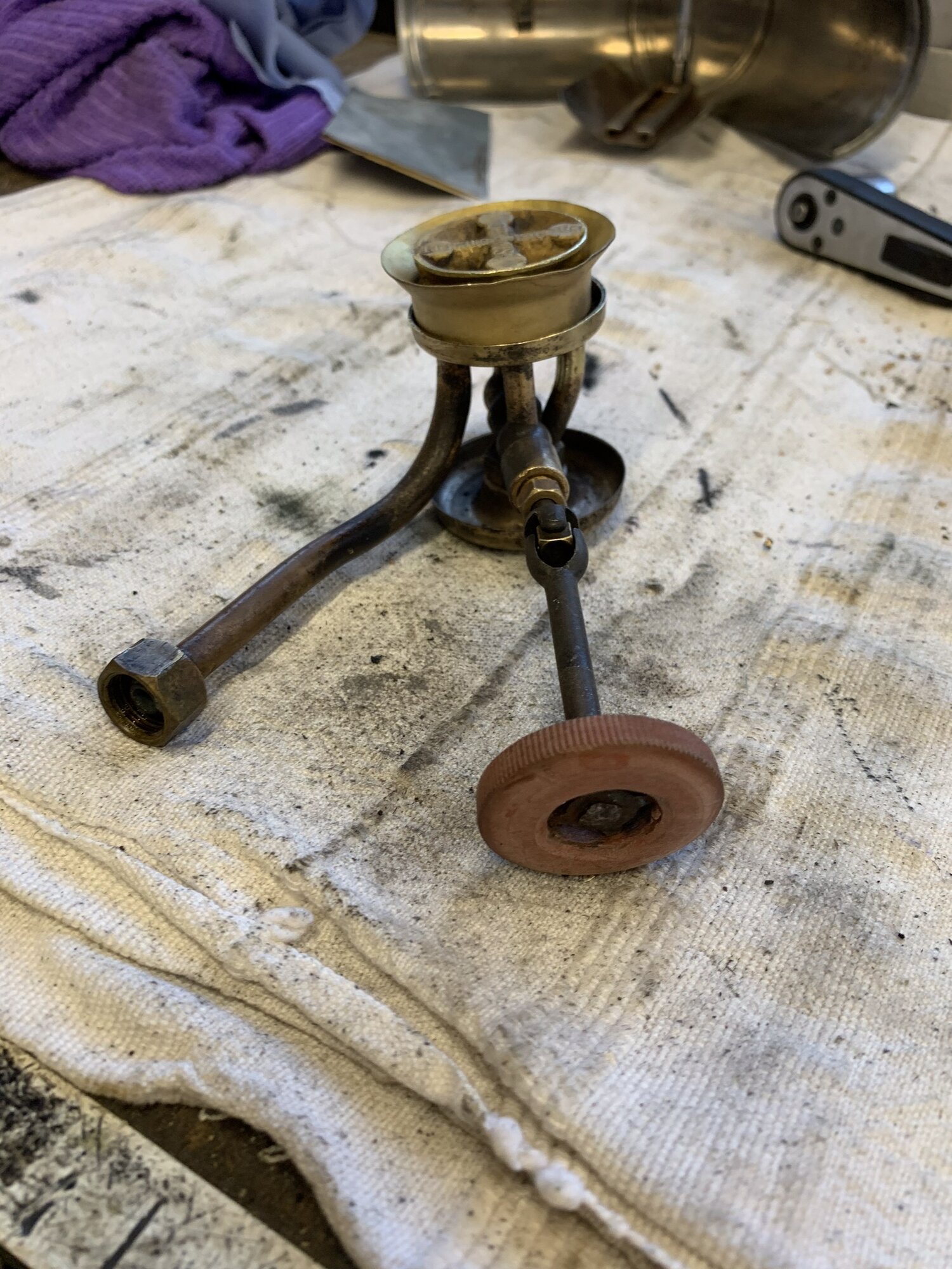

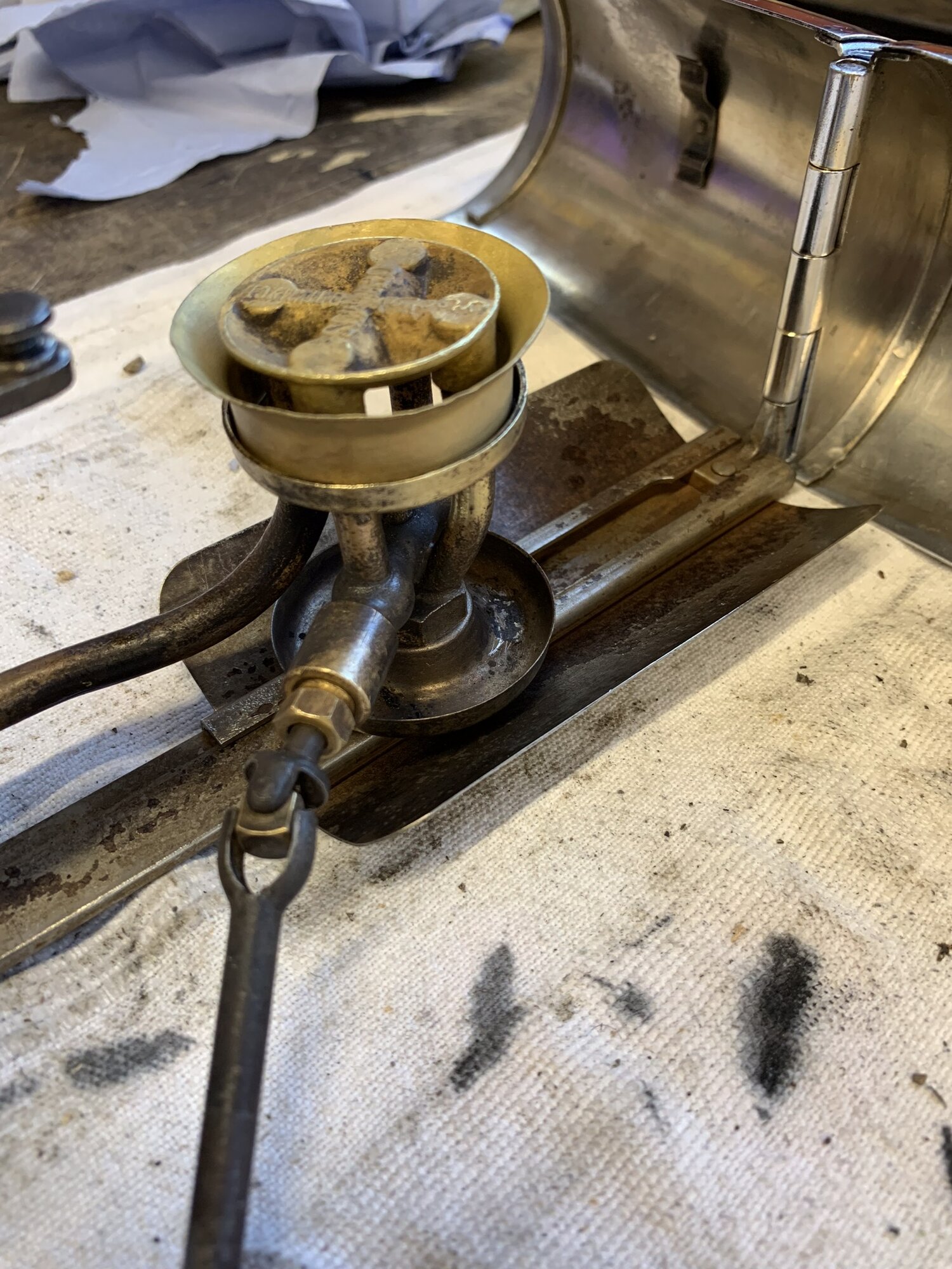

    I managed to get most of the carbon build up off the burner assembly and then started reassembling.
    Next job is to spend some time on the primer pump, new cup washer and cap rubbers needed, any advise on where to source these would be very helpful ? as I’m only really looking on eBay, I have all the measurements.

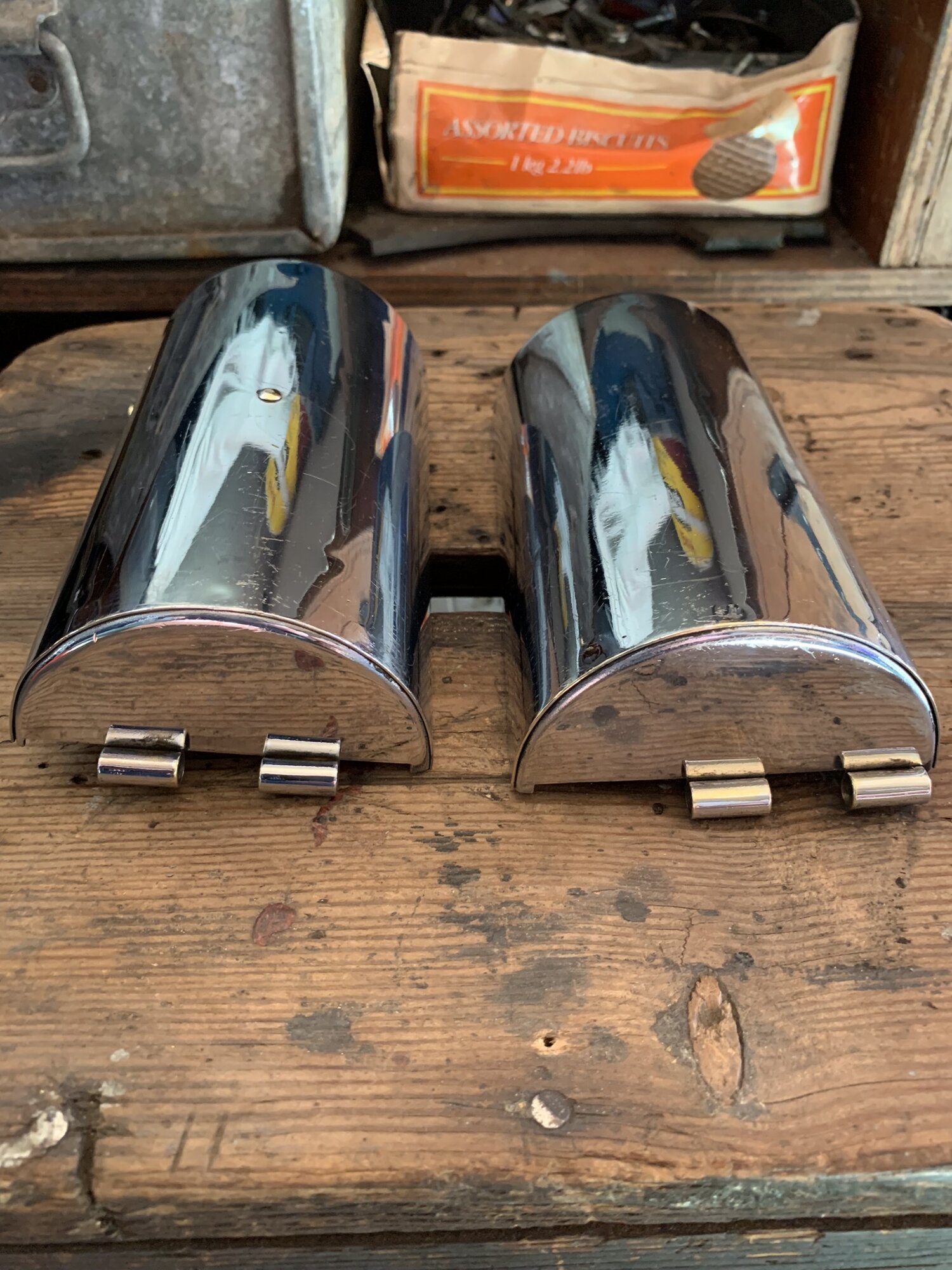

    I have decided that as this stove is a little bit special i have decided to give it the extra special attention it deserves, @presscall suggested that it would be worthy of renewing the nickel plating on the bottom heat shield and mounting, I have had a look on YouTube and i am surprised how straight forward and easy it is, I shall also be asking for the return of my ultrasonic cleaner from a friend so I can and make a better job of removing the rest of the carbon deposits from the burner.
    I have now managed to source and order a replacement leather cub and rubber seals for the pump and ordered some nickel.
    I’ll add another post with photos once I get the platting rig up and running.

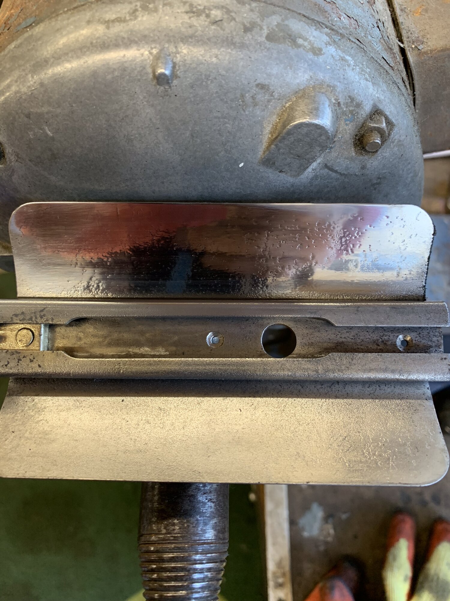

    31592CAF-7DB4-498C-A0A6-0C4F0213E229.jpeg 7F3AF461-8D62-4BB4-AC0C-D55AD9F36101.jpeg 83084545-F55F-4757-B429-D339B9AA8914.jpeg 132F0B77-18FD-4043-8B37-A6F88EFF2212.jpeg 95FFF72D-BF09-4D4F-A2AC-54180E1FEBF8.jpeg 70E43337-C59B-4D76-9676-78A21B11FA72.jpeg 5AB52485-61BC-44E2-A559-58373BC24932.jpeg 70C654C0-DAF7-46CA-A808-E0AFB8AEB3DF.jpeg Quick little update and a few photos.

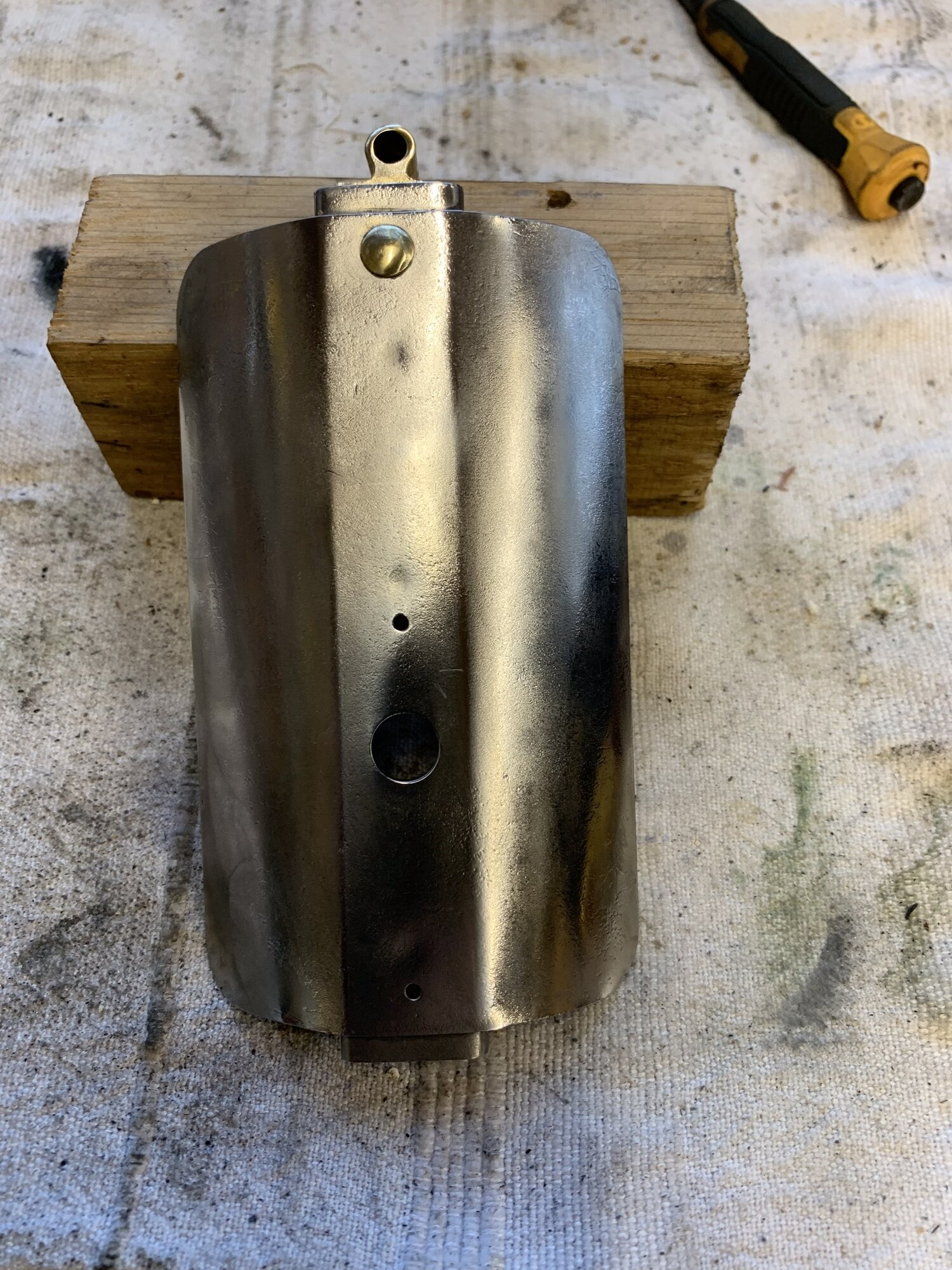

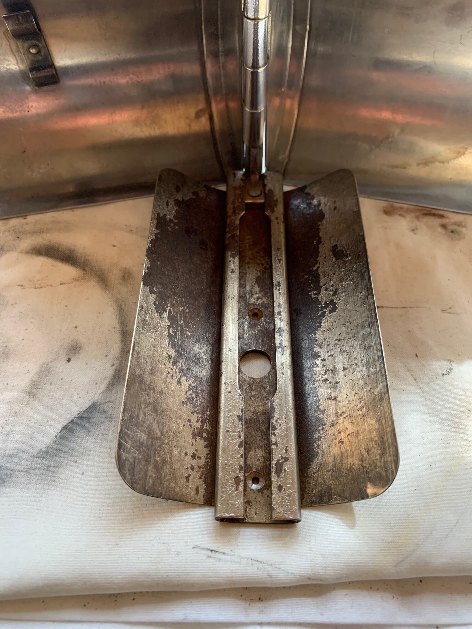

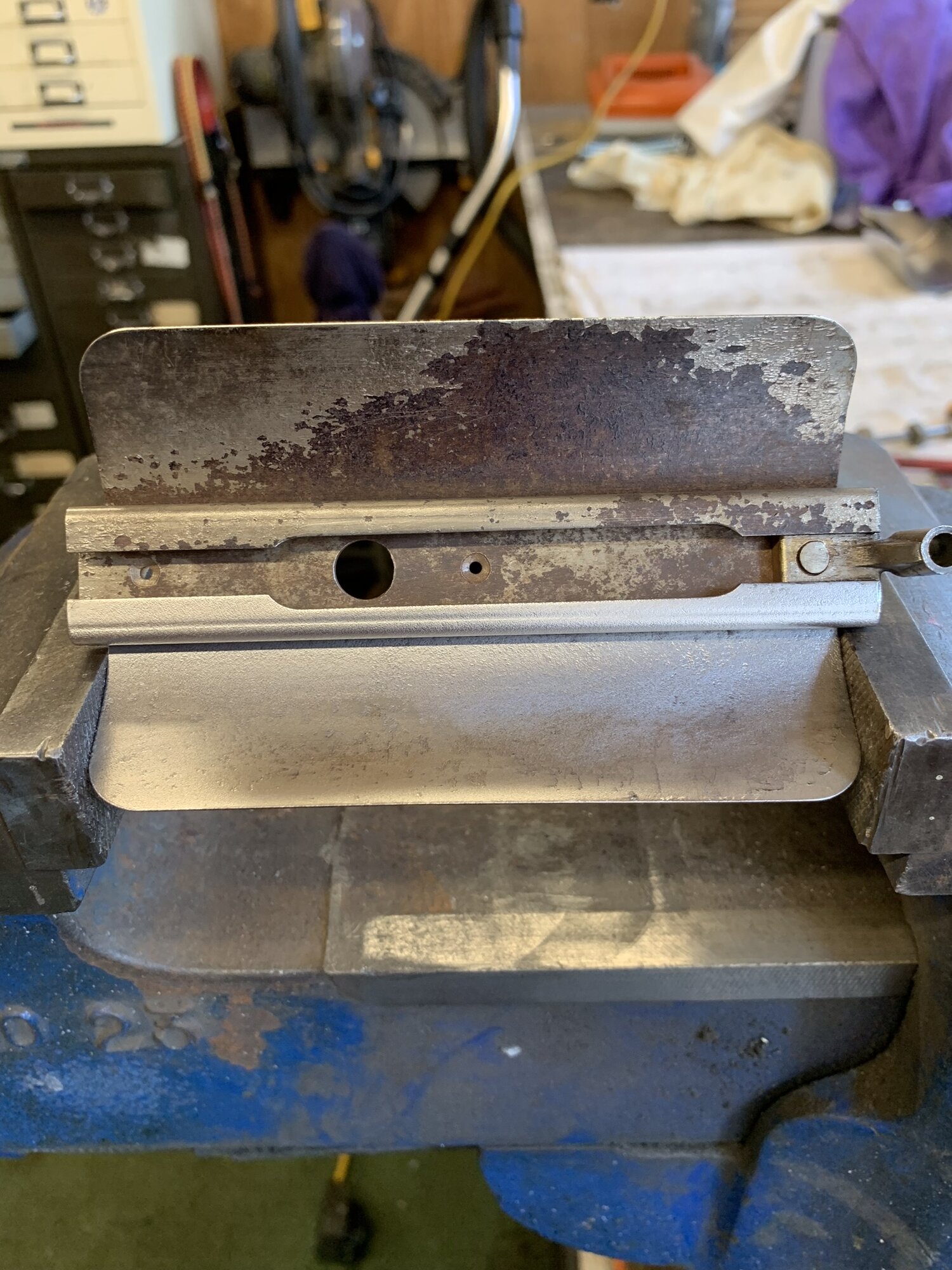

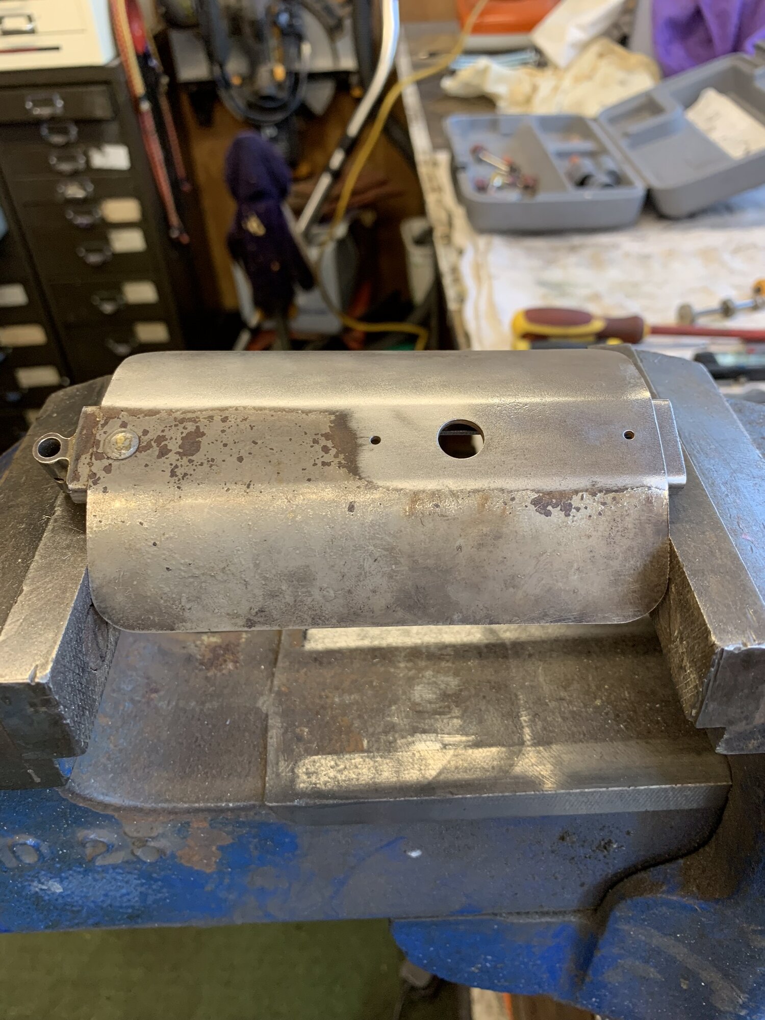

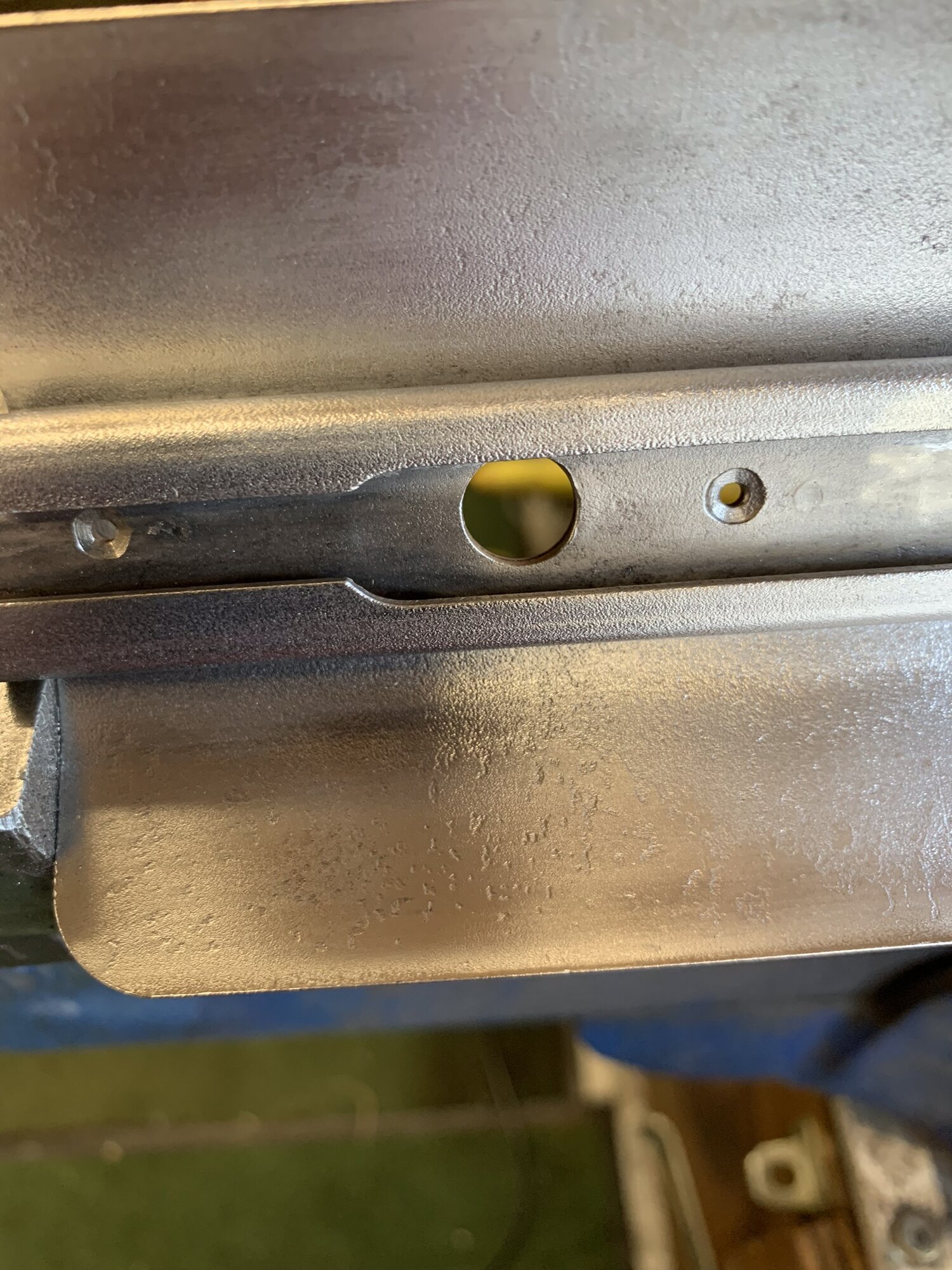

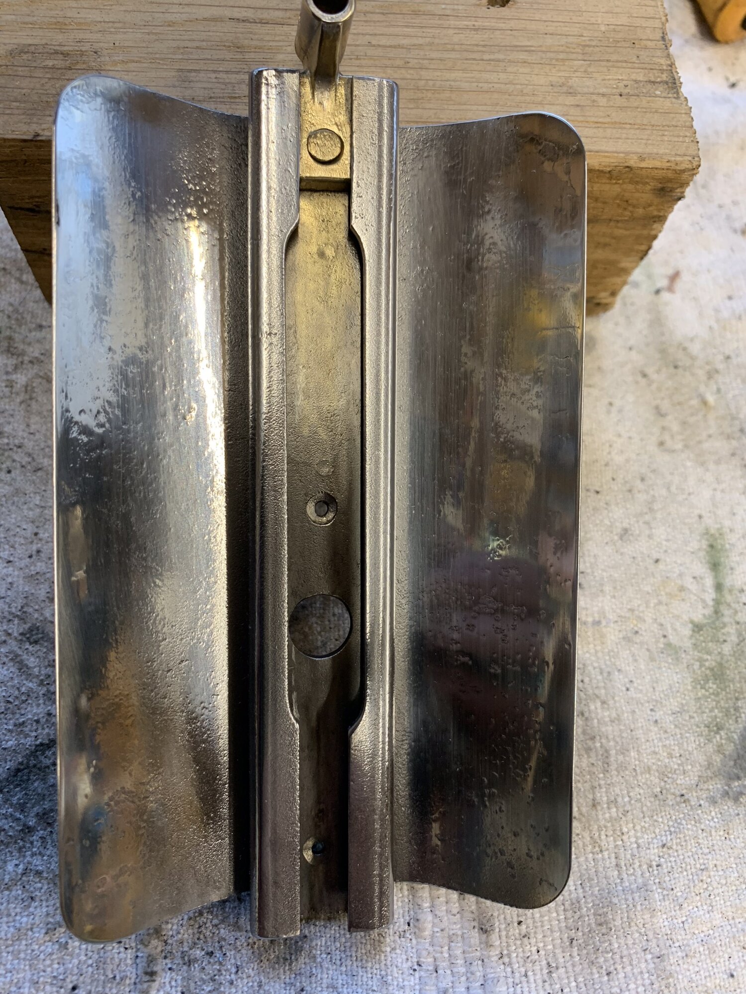

    While I’m waiting for the nickel to arrive I thought I might as well start getting bits prepped ready, so I stripped it down again and started on the shield that sits under the burner, I first removed all of the remaining nickel coating using a rotary wire brush and a little one on the dremel to get into the hard to reach places.

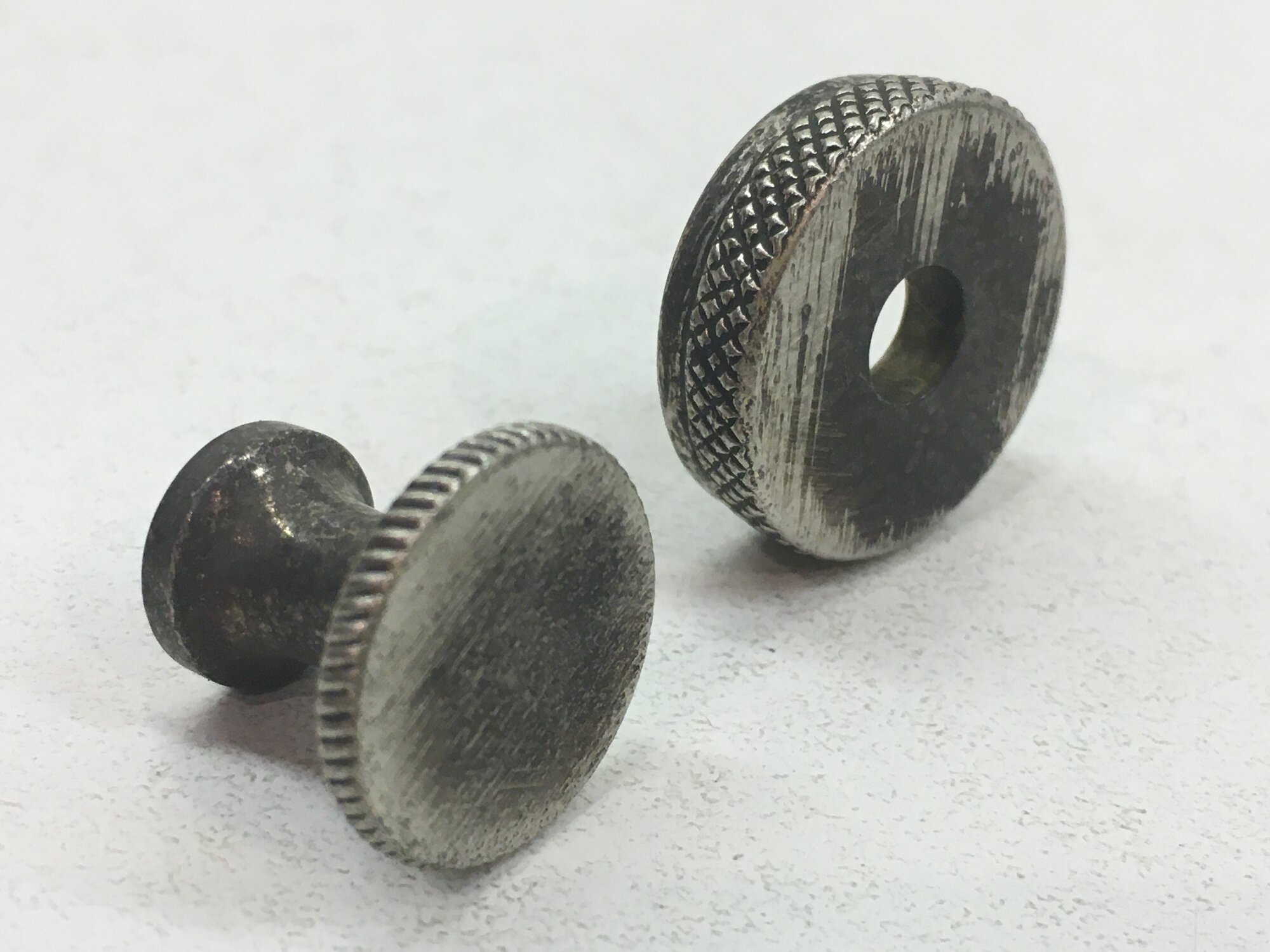

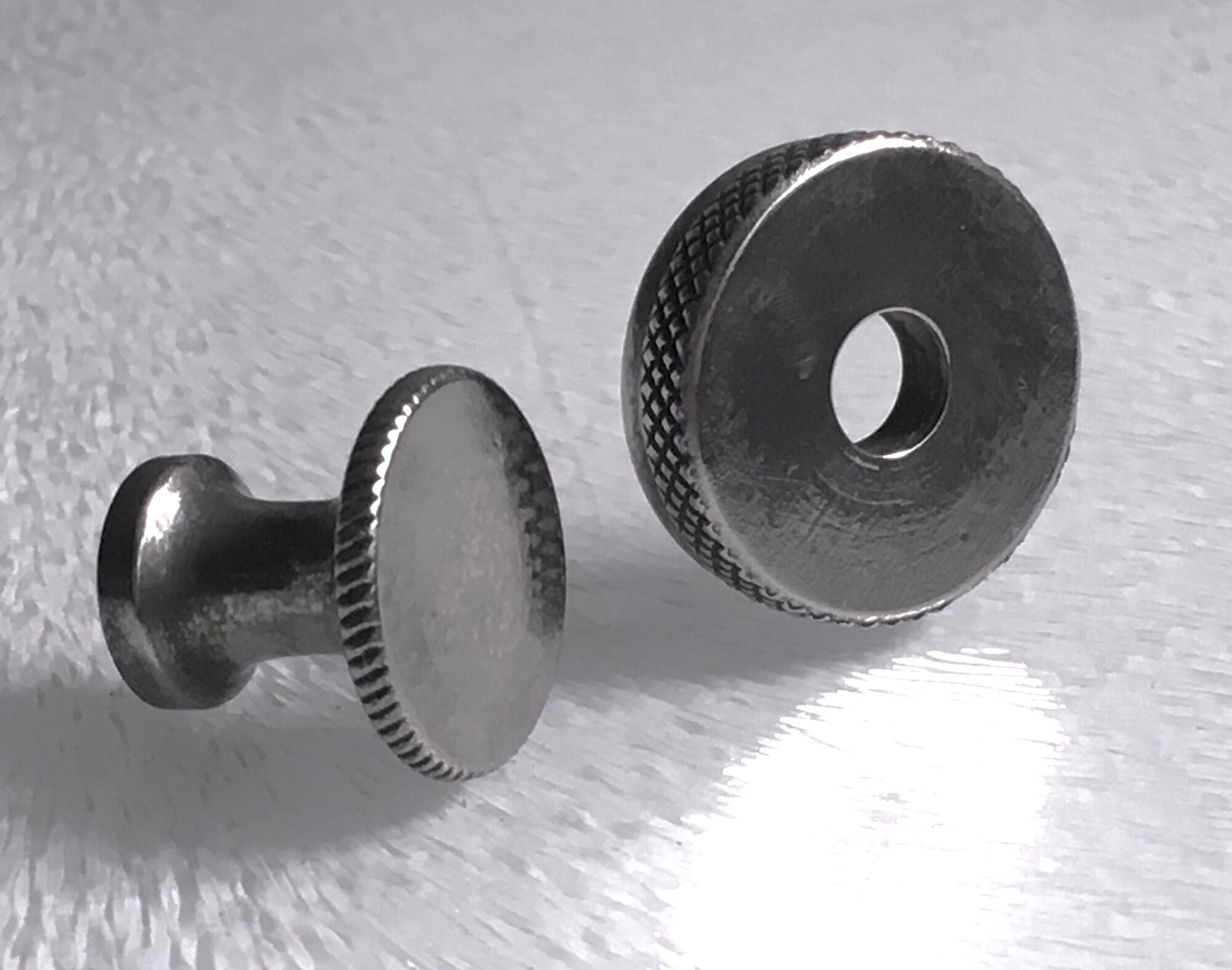

    Then it was time to start polishing with the mop, unfortunately because over the years some of the nickel costing has flaked/worn off the dreaded tin worm had set in on these areas, I managed to polish out all the marks left from the wire brush but the rusted areas were becoming a problem as the metal is very thin and the rust has eaten itself quite deep, so I had no choice but to stop where I have because it is getting dangerously thin, if you’ve done metal polish you’ll know what I mean, so I’m not completely satisfied with the result but it’s the best I can do without risking destroying it. as long as I get it 100% spotlessly clean it should plate ok, yes I know it will show where the rust had been, but you can only do the best you can with what you have, I suppose i could of made another plate, but then it’s not original.
    What would you do ?

    I can be wrong, but I guess John’s suggestion to restore the nichel plating was referred mainly to the body of the stove.
    I don’t think that the burner bottom plate was nichel plated originally, probably those parts were galvanized.
    Personally, I am never for the “restore to new” choice, but that’s personal. As you experienced, trying to achieve perfection implies some aggressive methods on the original material… wire brushing or sand blasting are always non return operations which remove some of the original material forever.
    After the first cleaning and manual polish the stove was already in a very good state, showing its age… I personally like to stop myself at that point.
    In any case, I think you should try to save as much as possible of the original… replacing parts that are honestly in a good and acceptable shape I think is absolutely to avoid.
    Go ahead to the flame shot, that’s what is really important :)
    Nicola

    In short, I highly doubt that the burner bottom plate was originally plated and polished to mirror level… so restoration should also take in consideration the original aspect of the stove. For those parts a dull galvanized grey is what should have been in origin.

    Hi Nicola
    Thank you for your reply, the parts in question were definitely originally nickel plated and not galvanised, the polishing that you see here is needed in the process of plating, once the nickel plate has been applied it will be a dull shade of grey, like you see on the bracket that is next to the shield in one of the photos, nickel plating only becomes shiny if it is polished.
    I fully understand what you mean about leaving it as it was, that was in fact something i was going to do, but as it is a special stove I do agree that re-plating is quite acceptable in restoration.

    Hi, you’re welcome… yes I understand that the extra polishing was the preparation for the plating.
    By the look of what I have seen on photos I thought it was galvanized steel and nichel plated brass, you have the stove in hand so surely you know what it was better than me :) I know that the nichel is not shiny after the plating so that’s fine anyway as protection for the steel and the final look should be ok.

    I'd have left well alone too, especially with such a sought after stove, but each to their own. Replating with zinc rather than nickel would bring less attention to the re-plating over a pitted surface.
    Edited after seeing the above- agree non-polished nickel would be a good bet.

    I have given this more thought at I must now prove to myself that it was in fact nickel plate and not galvanised, I have checked my precious metal testing kit and it doesn’t contain the fluid needed for testing nickel only gold silver and platinum, it is extremely important to me that I get it correct so I have just ordered the necessary kit to test for nickel, I can then test the bracket as it’s still as it was, I’m at a point where I can re-plate it either way, nickel or galvanised.
    Can anyone else comment on this subject please, with there views.

    Ahah you’re doing your job very seriously and we all appreciate your approach, that test would be very interesting and thanks to take the chance to do it.
    In general, galvanization, is a more expensive process and adds a thicker layer of protection than nickel plating. In my opinion a better option for steel… while for brass the nickel plating is the perfect choice.

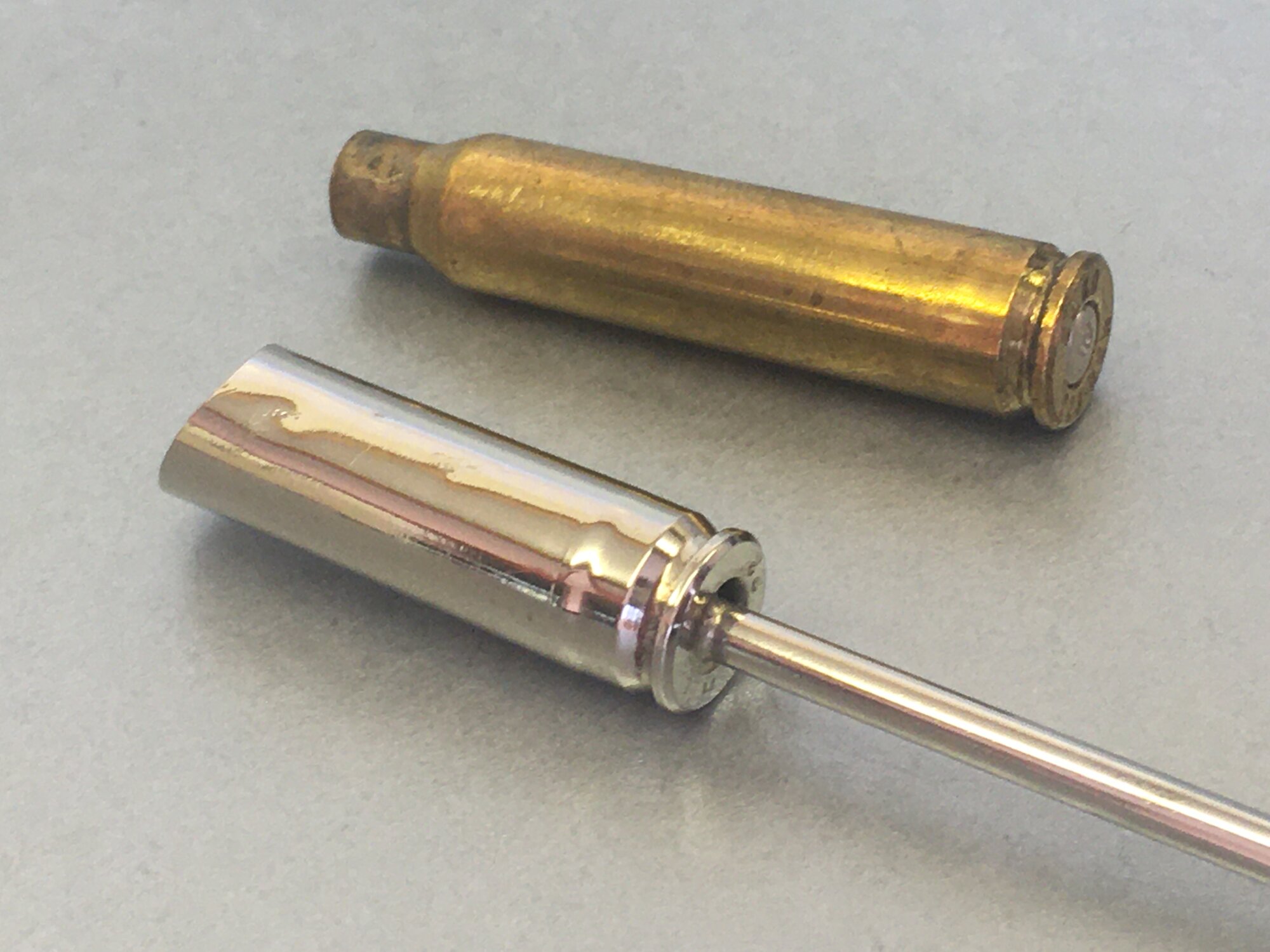

  16. presscall
    13,882

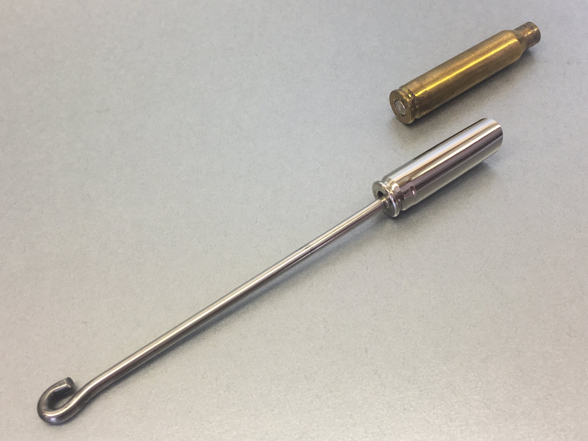

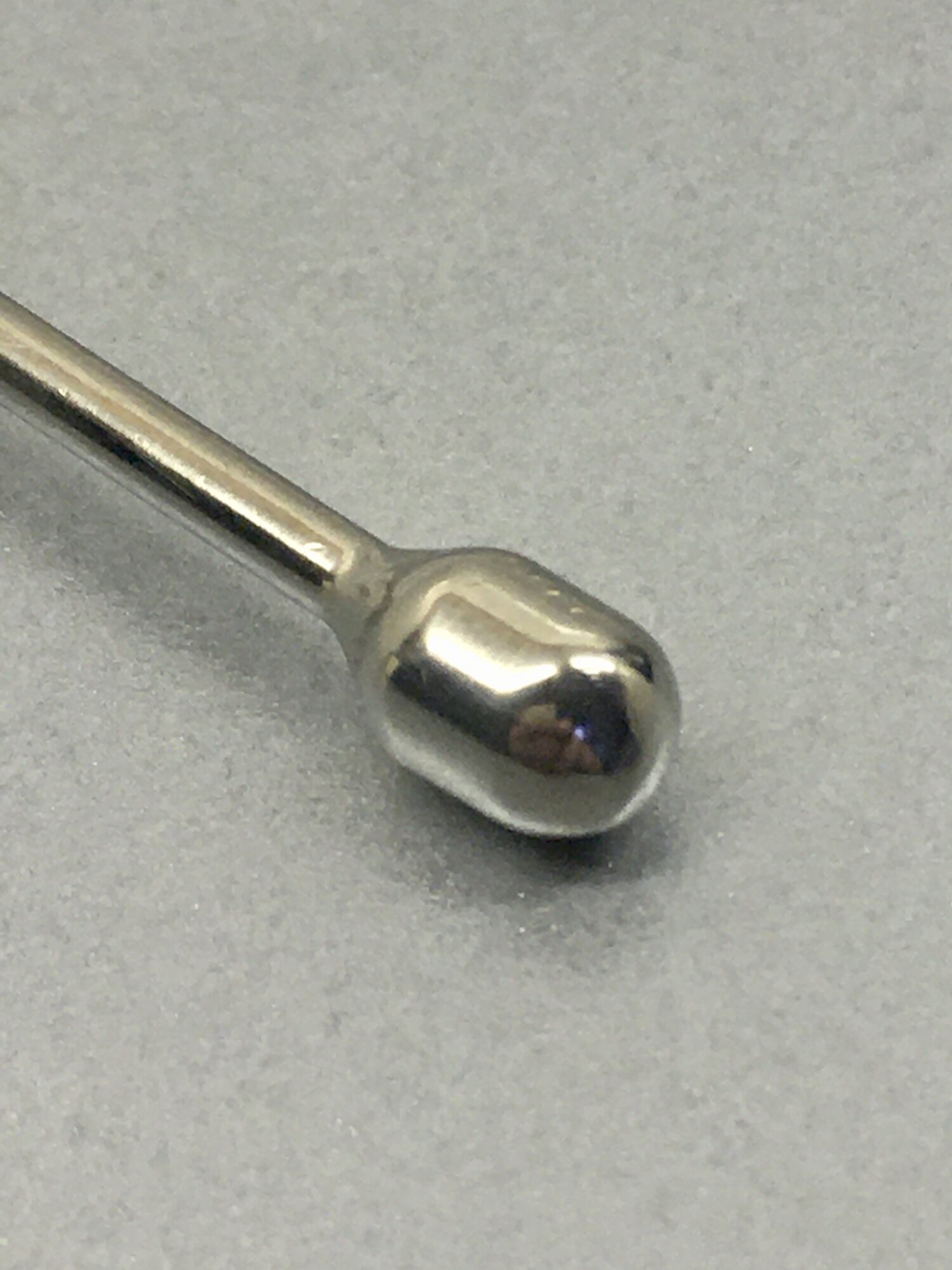

    That’s not what I’ve found. In the case of my initial nickel plating experiment I had the objects plating too long, minutes rather than a minute at most. The result was indeed dull/grey …
    … but acquired a lustre on polishing.
    Latest project to be plated, a lighting torch for lanterns, was shiny straight out of the electrolyte after maybe a minute of plating, moved about in the electrolyte as the cathode (-ve pole).

    @presscall amazing plating! You’re mastering also this skill!

  19. presscall
    13,882
    @Nicola Francesco Elia
    Hi Nicola!
    Like most things, it’s possible to improve with practice.
    An early lesson was that as I’d expected the electolyte expires, easily identified when an object is removed from the plating bath and the nickel rubs off. Fresh electrolyte and the plating makes a robust bond. Moving the object around, or alternatively passing the nickel anode over it on a ‘line of sight’ basis, gives the best coverage and a shiny (not dull) surface straight out of the electrolyte. 6-volts works well for plating. 12-volts is better to make electrolyte (nickel cathode and anodes).
