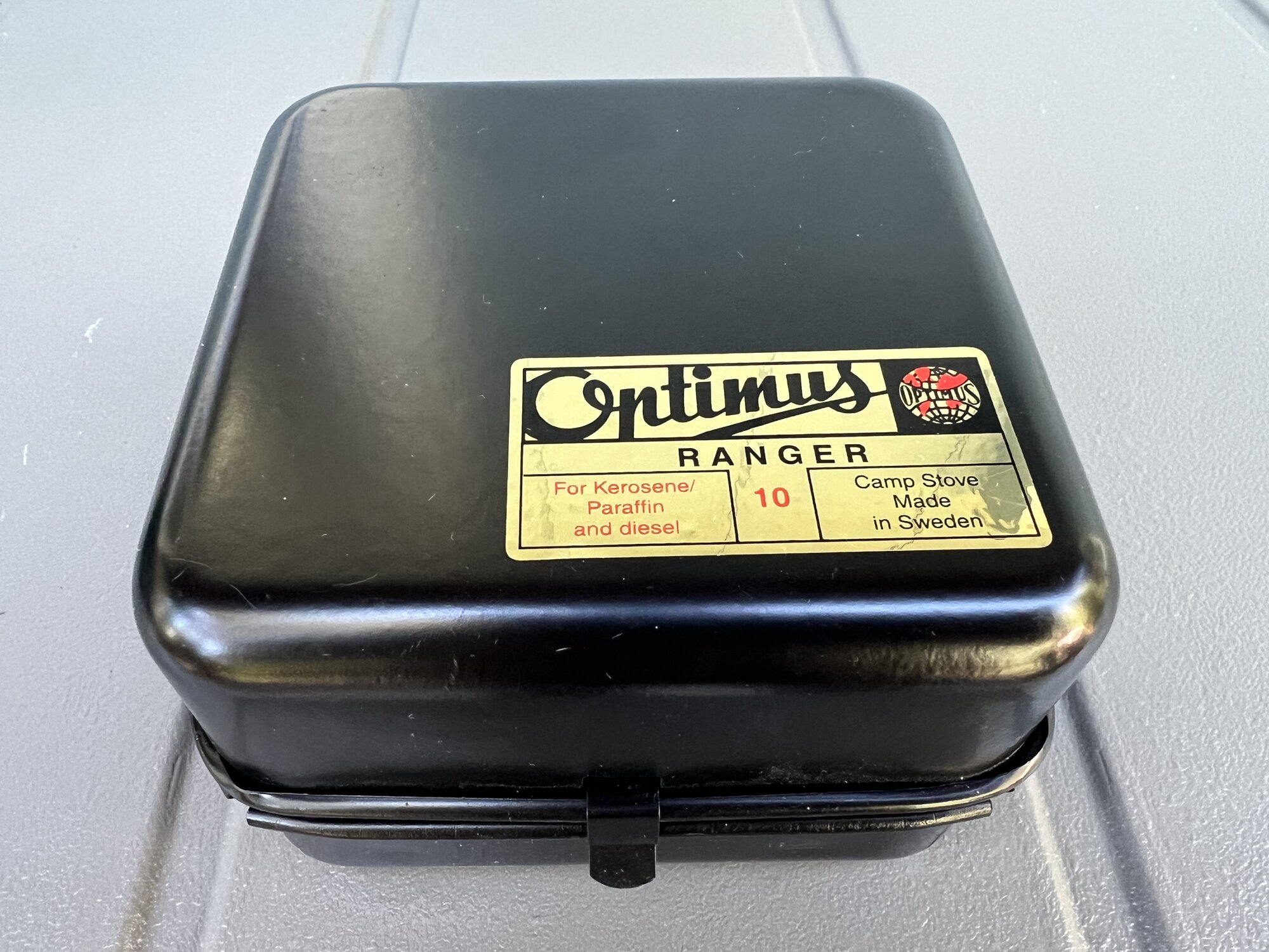

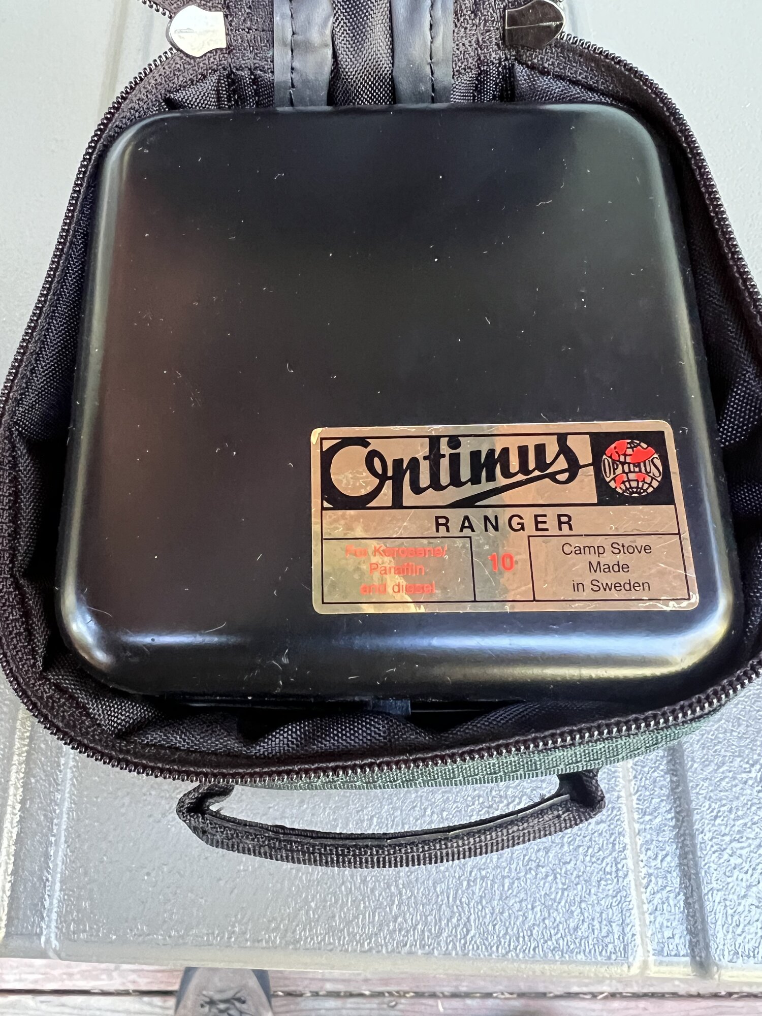

    Greetings, All,

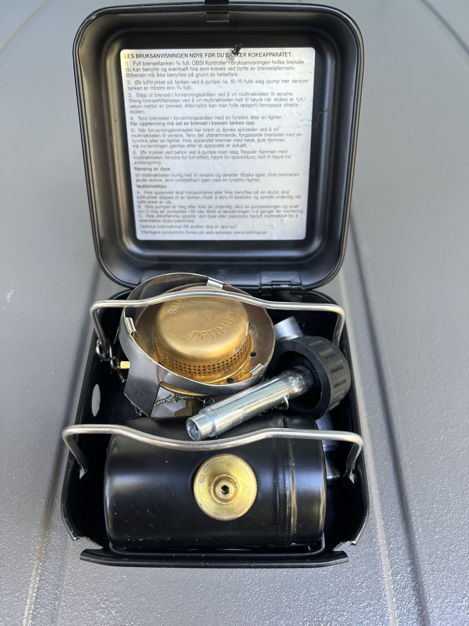

    Some years ago, I was blessed to have found a brand new, in the box, Optimus Ranger #10! I really wanted to fire it up, but decided to keep it mint, instead. Somewhat later, I was opining to a friend in Norway that I really wanted to fire up my #10, but would rather find another one, and thus have one to show and one to use! He got back to me, and offered me another brand new, in the box Optimus Ranger #10! How could I refuse?!

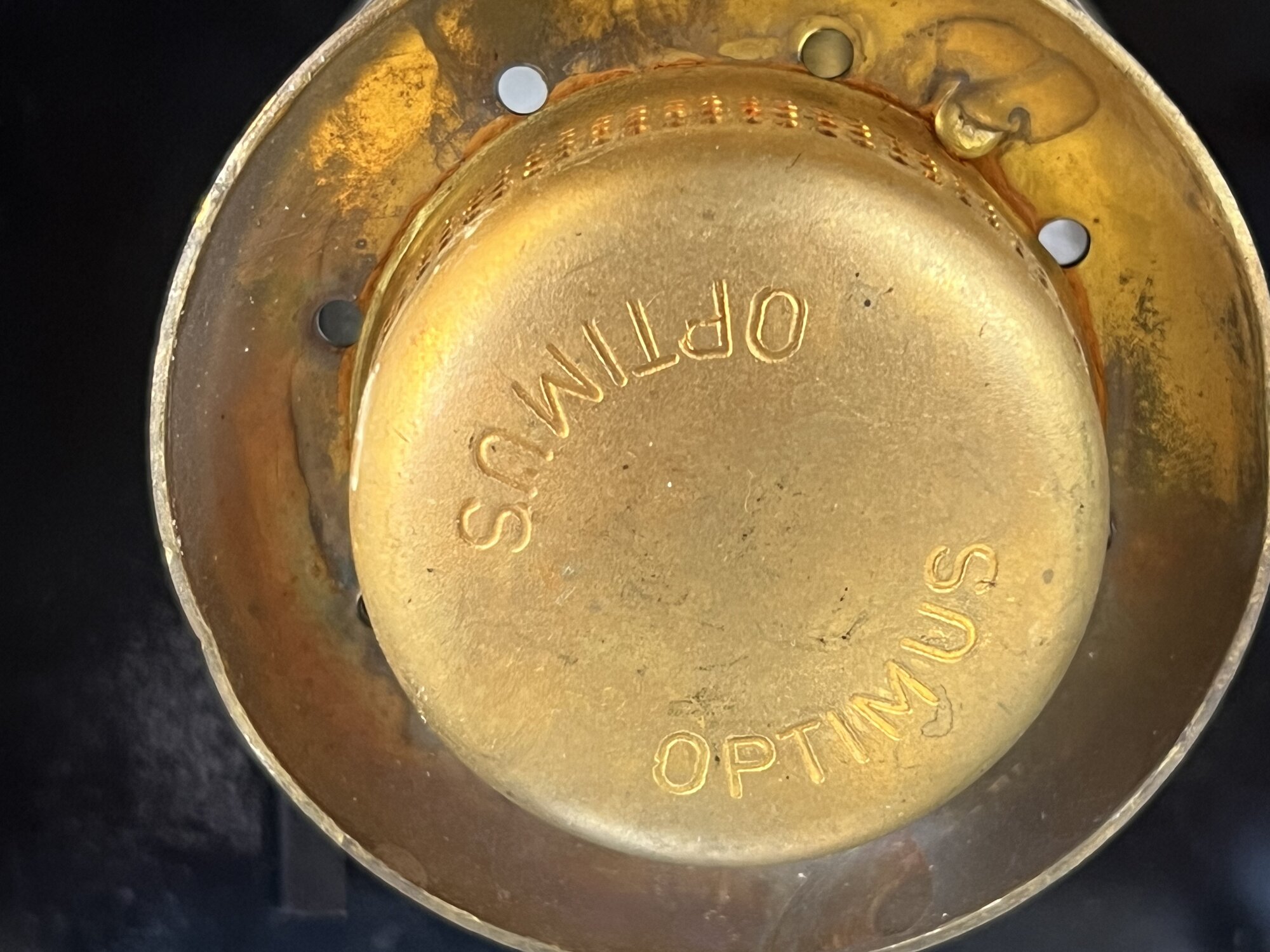

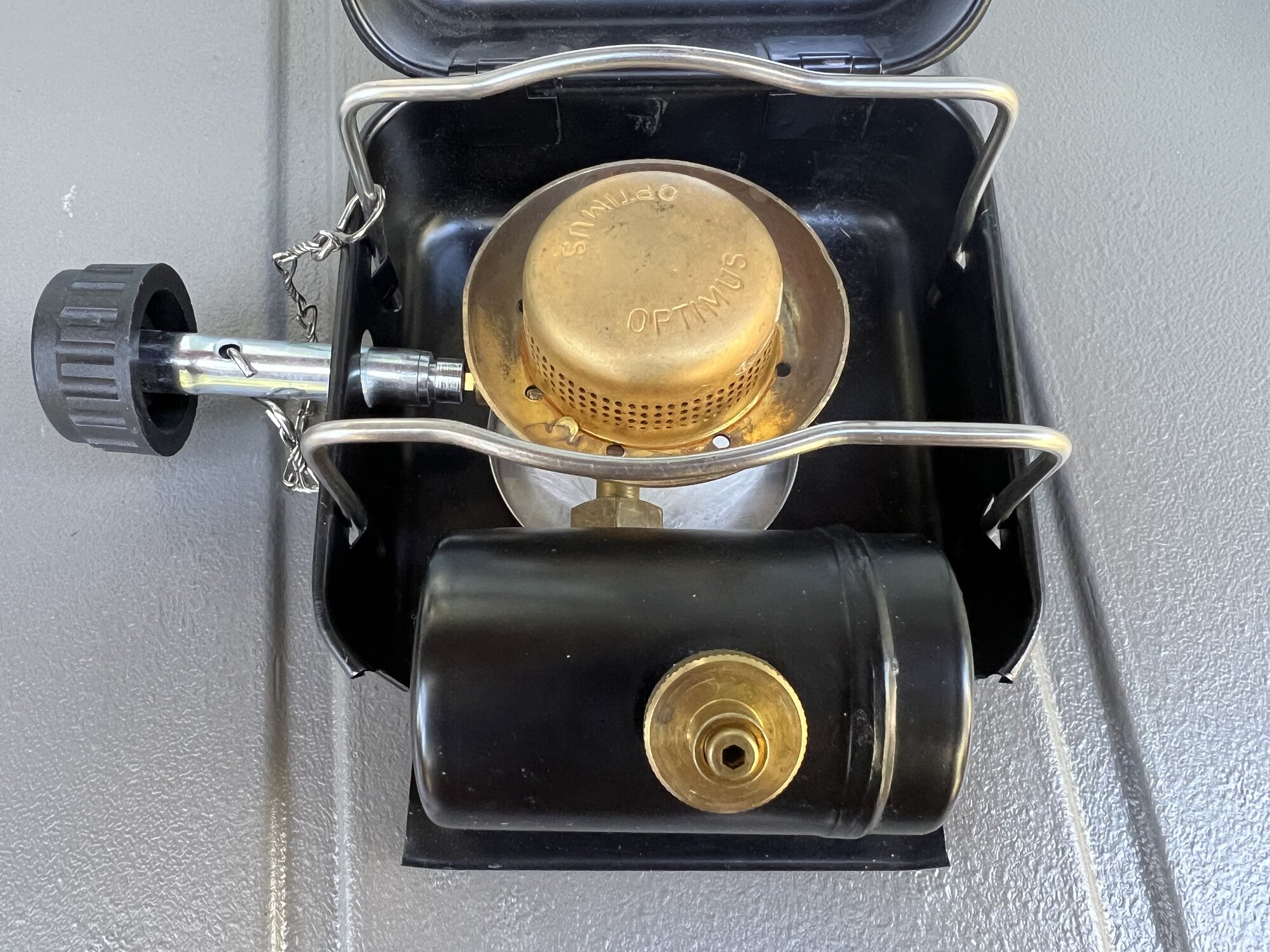

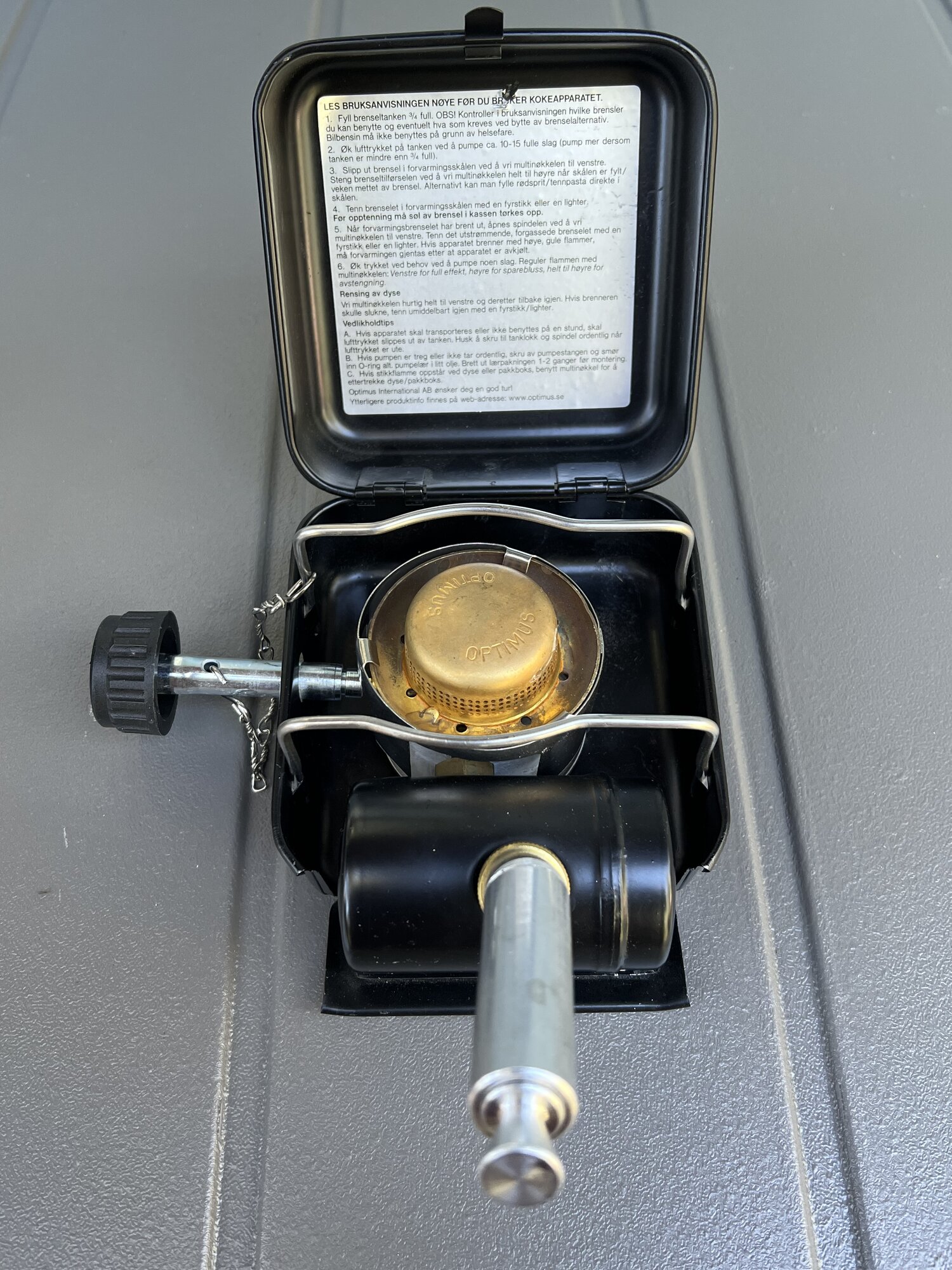

    As soon as it arrived, I fired up my original #10, and was more pleased than I can say! Using ONLY KEROSENE, it burns clean and very hot! It also simmers very well, indeed! Here are some photos of the "show" stove:
    Everything is really crammed in there, but it does fit!

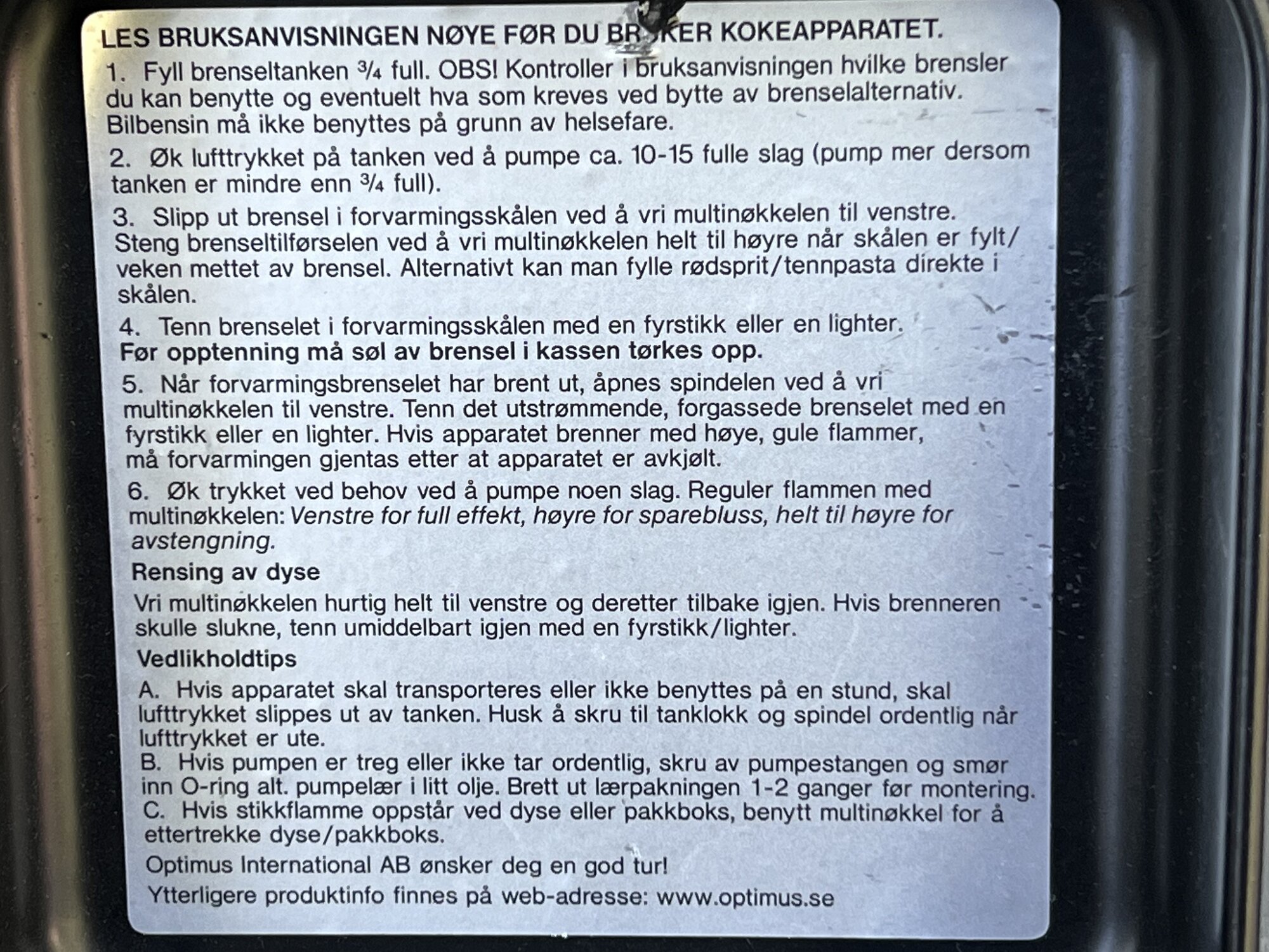

    Are these instructions inside the lid in Swedish, or Norwegian?

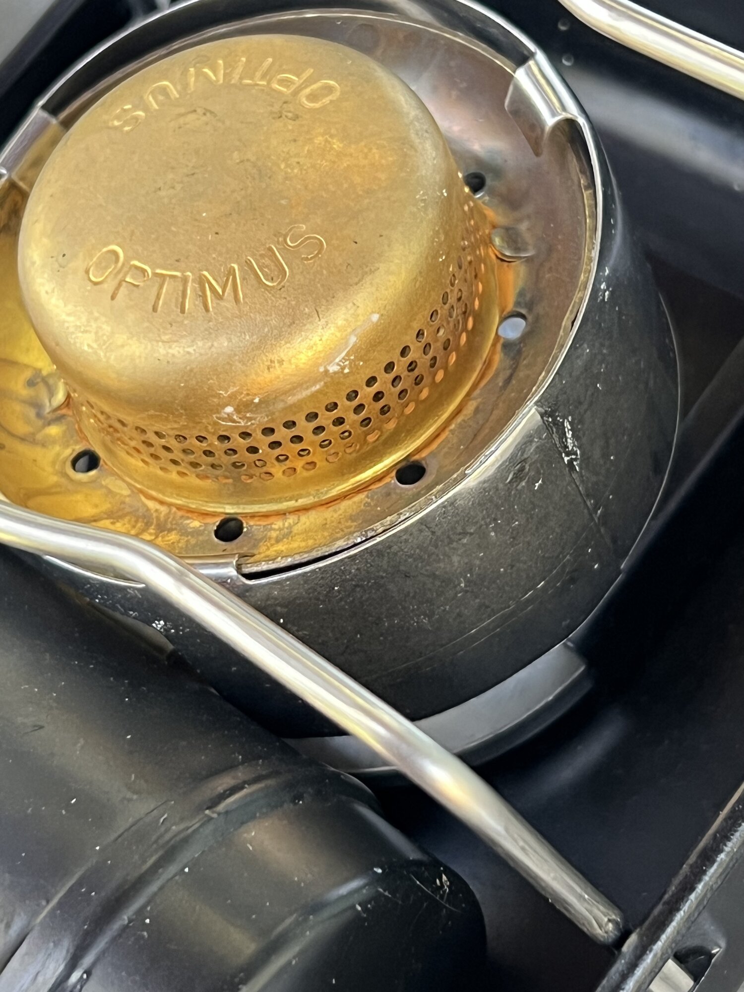

    Here's a peek at the proprietary windscreen. It's different than on the 8R, or other such box stoves. And it "just" fits inside the case, between the burner and fuel tank.
    All setup, and ready to go!

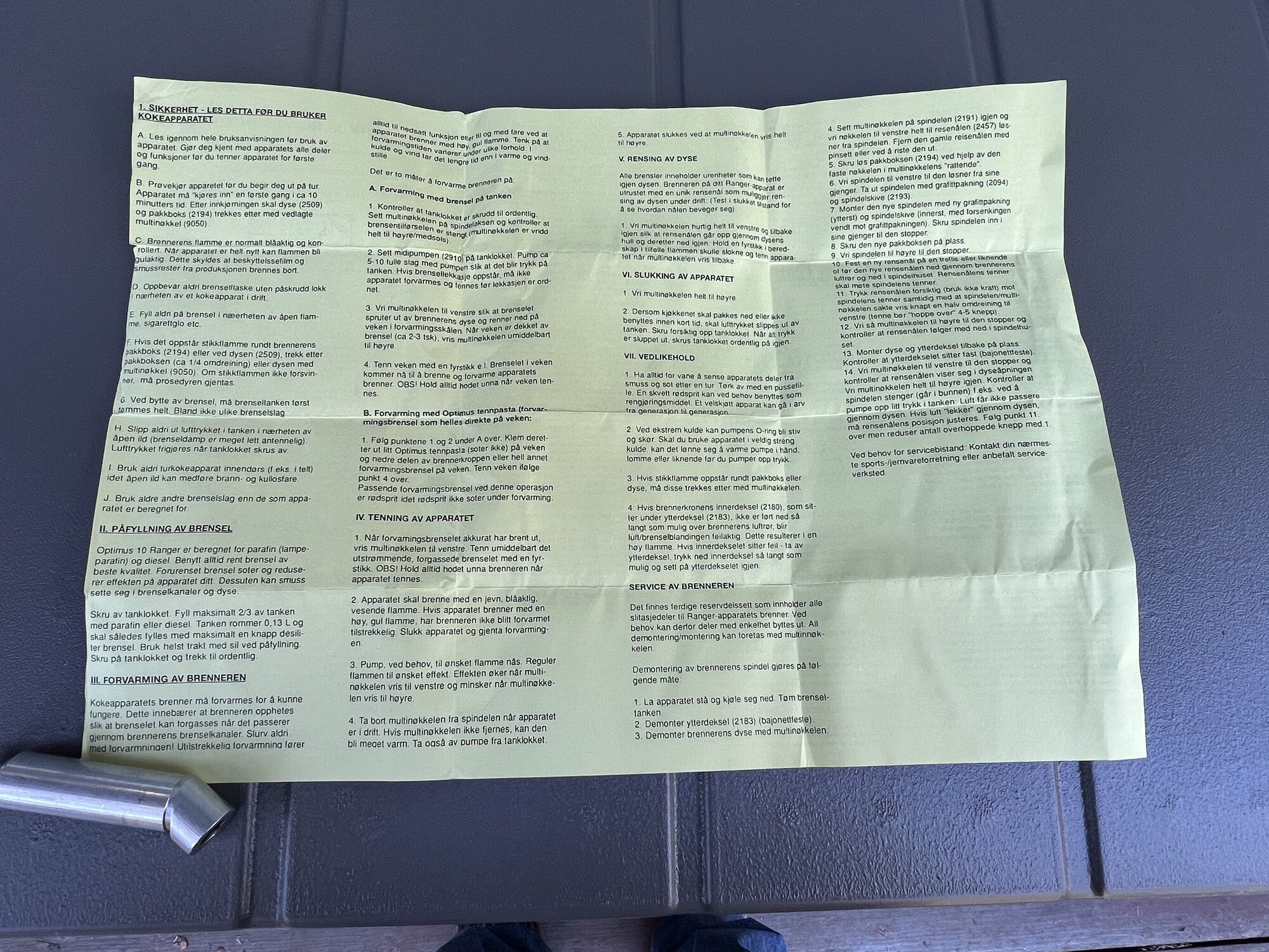

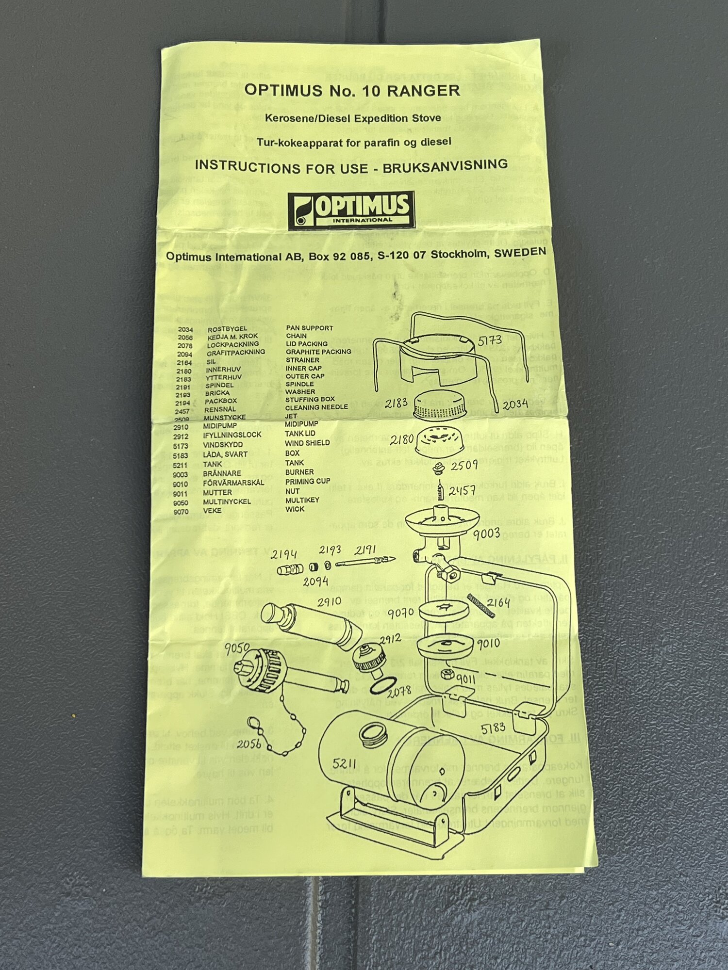

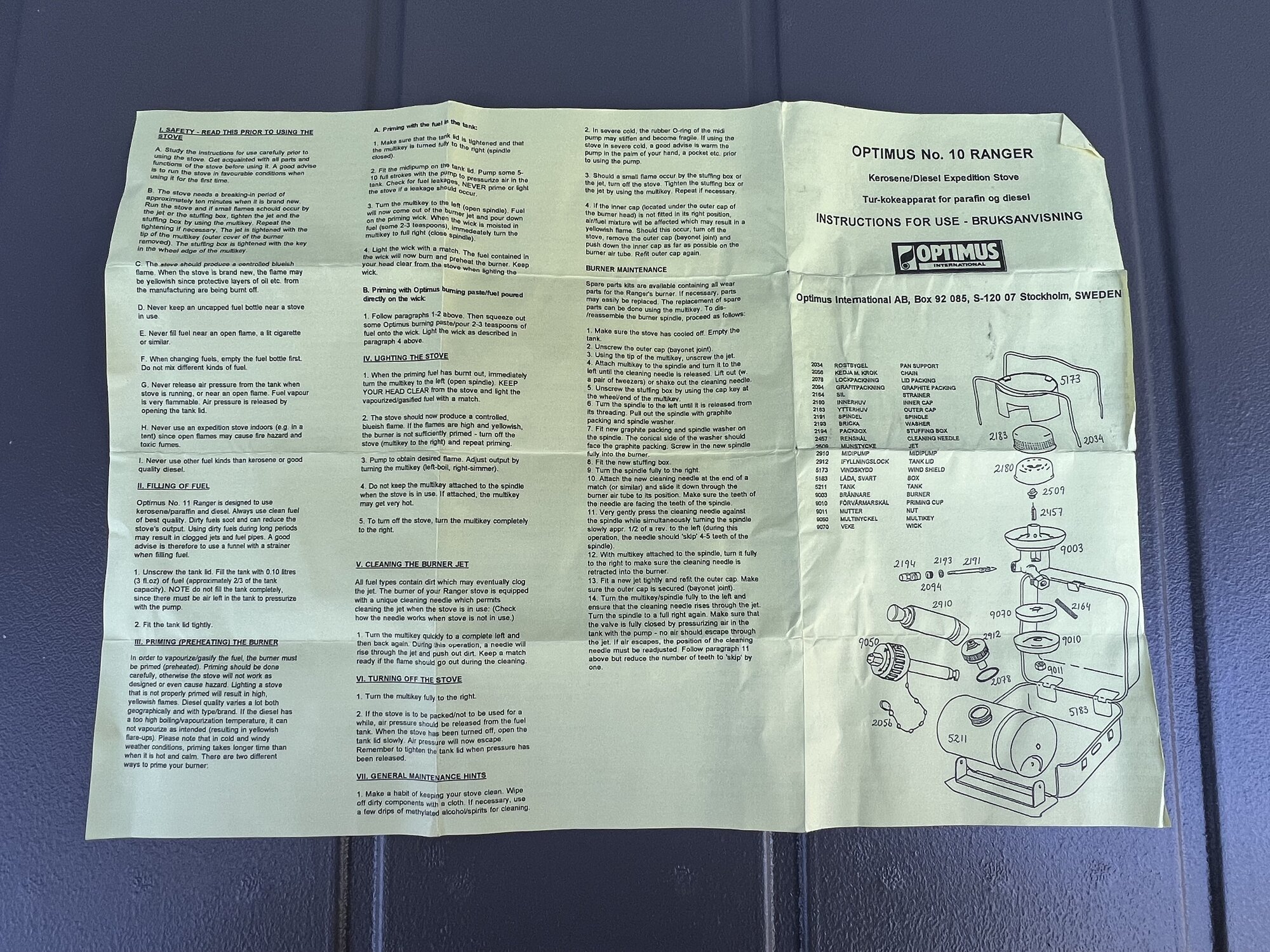

    Here are the instructions, including the parts diagram.
    A little better view of he parts diagram.

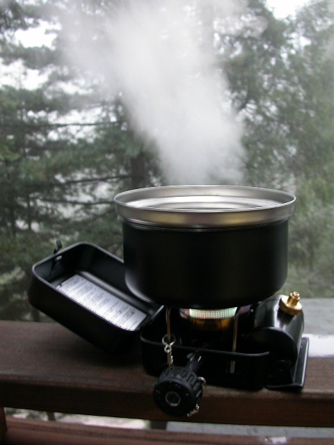

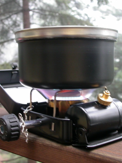

    And, now, some of the "user" Ranger #10. Sorry for the lack of sharpness. My fault. But, you can see this little monster is a real powerhouse, for such a small stove!
    Some folks have complained that their Ranger #10 stove overheated, and blew the Safety Release Valve. I strongly believe that those who complained very well might have used the wrong fuel in their stove. In the times I have used it, it's never given me even a hint of over-heating! YES, the tank does get very hot. But, burning good, clean, K1 Water White kerosene does not over-heat the stove, PERIOD! This little guy is dependable, and easy to use. For it's size, I don't think it has any real competitors, IMHO. Thanks for checking it out, and God Bless!
    Doc (Who is blessed to have two of these little Monsters! Pure Class in their design, and function!)

    And you. It's not too clear from the diagram, how does the pump attachment fit onto the SRV? Is it some type of valve?

    @junior trangia master asked: " It's not too clear from the diagram, how does the pump attachment fit onto the SRV? Is it some type of valve?"
    Archie, if you take a close look at the fuel cap in the photos I posted, you will see that there is a round extension as part of the cap. The pump fits snugly onto that round extension. Works a treat! Such pumps will only work on fuel caps that have that round extension. So, if you have an 8R, for example, you would need to replace your fuel cap with one of the ones used on stoves like the 199, and Ranger #10. I hope that answers your question, but if not, give me a shout! Take care, and God Bless!

    @junior trangia master there is an O ring inside the opening of the pump that forms the seal around the extension on the top of the filler cap that @Doc Mark mentioned above.

    Hi, thanks for a nice report and great pictures.
    I got myself late 1990 that I wanted to use for hiking - had used the 111 quite a lot, and this seemed a great stove for hiking given output and weight - and of course the fact that I liked the 111 stove.
    As for reliability I always had ectra tank lid with me because it in fact turned out that reliabillity was an issue - the cap did not hold the pressure - I assume heat affected the small rubber gasket (o ring and small "piece" on the spring)
    As for fuel I only used kerosene (high quality in 5 litre cans) since it was commonly used with 111 in Norway and was easy to get hold of.
    In Norway mid winter one wants to use big pots to melt water - bigger than the one you used - typically 4 litre aluminium - so heat is probably transfered even more to tank and lid/valva.
    Gloves were needed to open tank.
    When you want to prepare evening meal and the pressure does not stay inside tank, next time one ended up with another stove. In fact I only had it for a couple of years before the explorer 11 the new favourite - the ranger was returned and accepted as warranty because of the valve issue (have a new one today - unused on the shelf)
    My favourite stove on the shelf, but not in the field :-)
    again - thanks for great thread on the ranger 10 and a "Norwegian issued one with instruction in the lid"
    Btw I recently got a hold of repair parts (o - ring and the rubber "piece" on the spring inside the cap) and will try to restore some of the caps I have that do not hold pressure any more.
