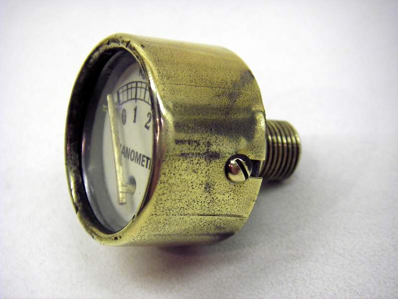

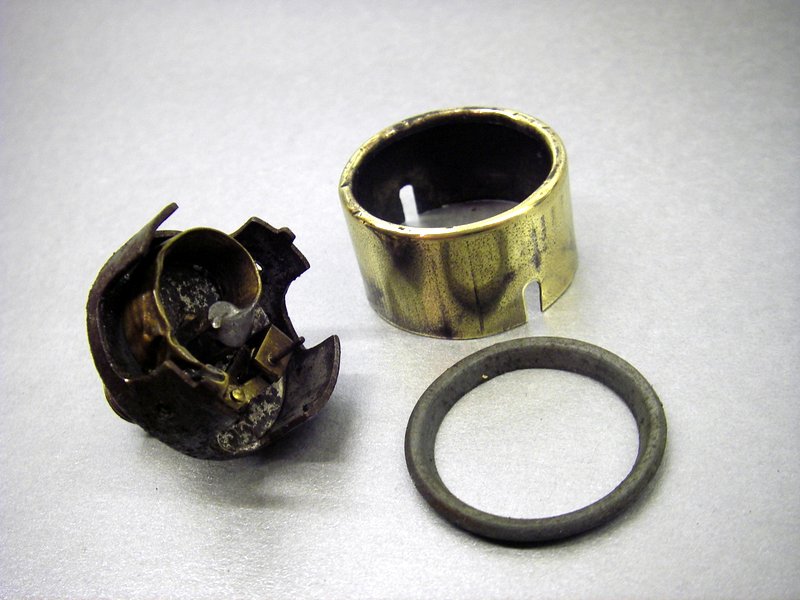

    I've been using a borrowed Taylors stove gauge and got around to repairing the gauge that came with the stove.

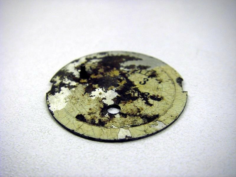

    This was the original you'll remember: no indicator needle, no glass, slightly mauled innards ...
    ... and little remaining of the dial face

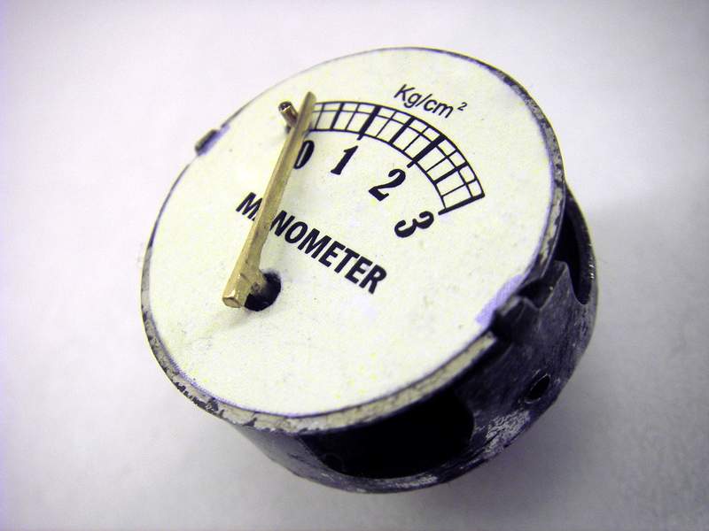

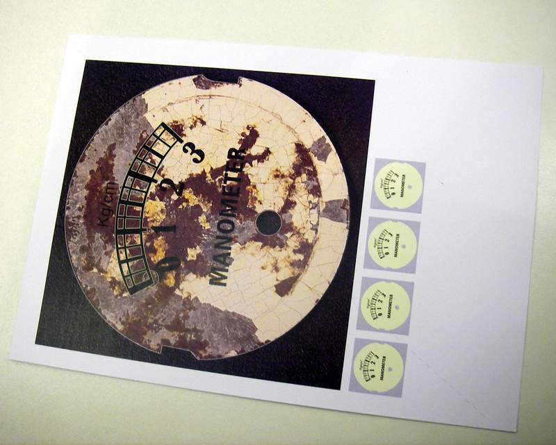

    There was just enough to go on. Some key clues from the traces of paint on the dial face: units of measurement were kg/sq cm, the dial carried the functional description 'Manometer' and the maximum reading was 3 kg/sq cm. - which approximates to 3 bars or around 45 psi.

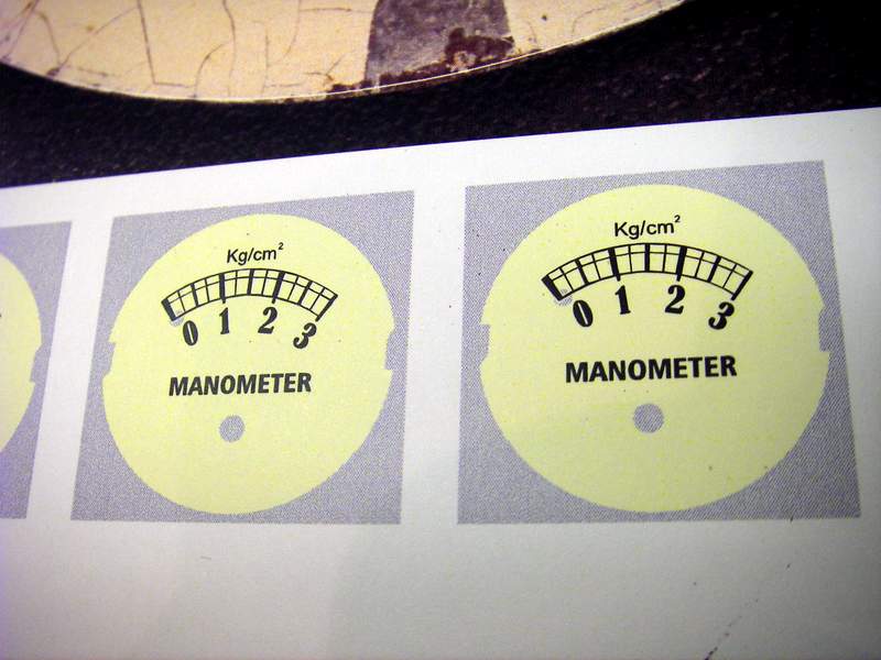

    I handed the task to a graphics artist friend who spent a half-hour on his Mac to produce these
    I asked him to print the dial faces on heavy-weight paper. I could have gone for laser decal paper but whereas a decal is essential for laying on a surface where the thinness of the decal is crucial, in this application that didn't matter and paper would be easier to apply to the metal dial plate, was cheaper and had the semi-matt finish I wanted rather than the glaze of the decal paper I have in stock.

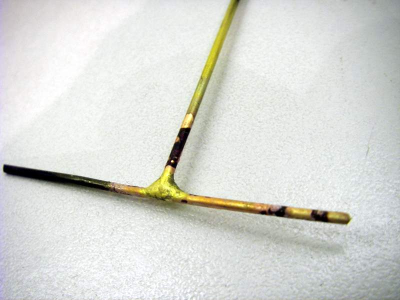

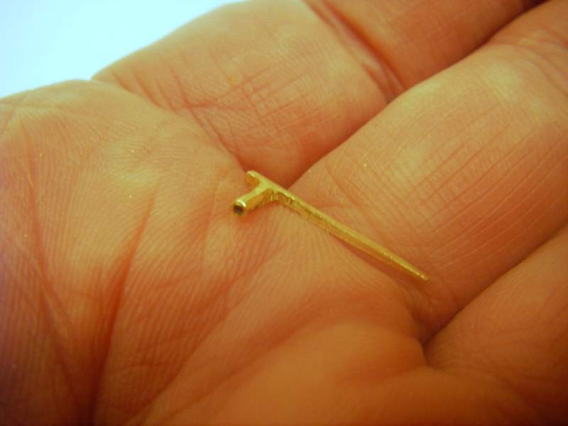

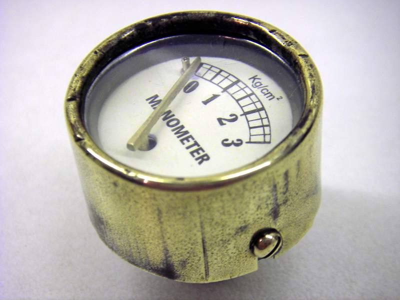

    Next job, making a new needle. I silbrazed a length of fine-bore brass tube (for the pivot shaft) to a length of fine-gauge brass rod (for the needle)
    Tricky work with a Dremel, but a needle and pivot shaft resulted

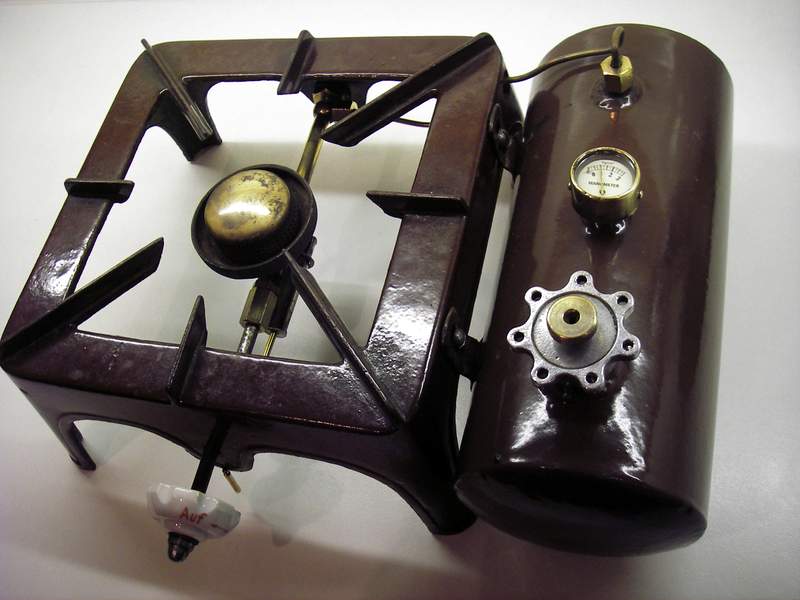

    I fitted it to the gauge and tweaked the bourdon tube mechanism to respond the right amount to a known level of pressure from an air compressor. I wouldn't claim this to amount to accurate calibration but then it didn't need to be, somewhere around 1 kg/sq cm of air pressure in the tank is enough for fierce maximum heat setting if required

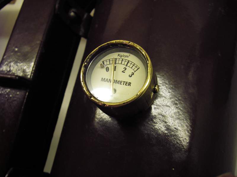

    Gauge reassembled with new sight glass and ready to reunite with the stove
    Taylors gauge removed and put back into store, original gauge for the stove back in place
    Pressurised, ready to fire up for a celebratory brew, project finished

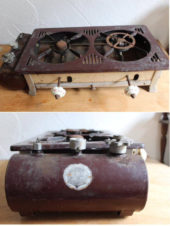

    Good the decal's still intact on that one @gieorgijewski
    The double-burner example I provided THIS link for at the start of the thread appears not to have.
  11. gieorgijewski
    gieorgijewski Subscriber
    Apr 19, 2013
    4,301
    I like decals...
    You like decals...
    EVERYONE LIKES THE DECALS
