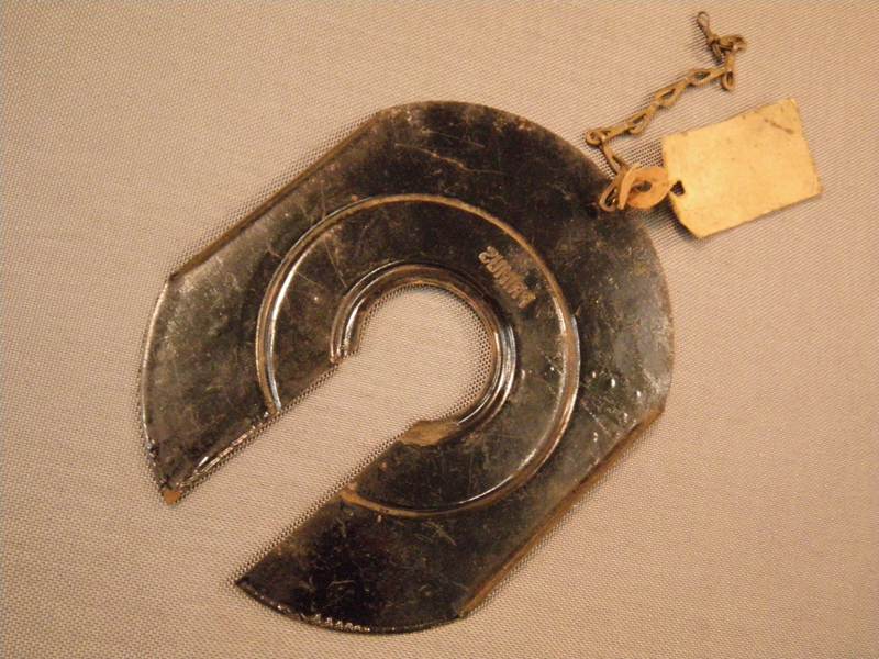

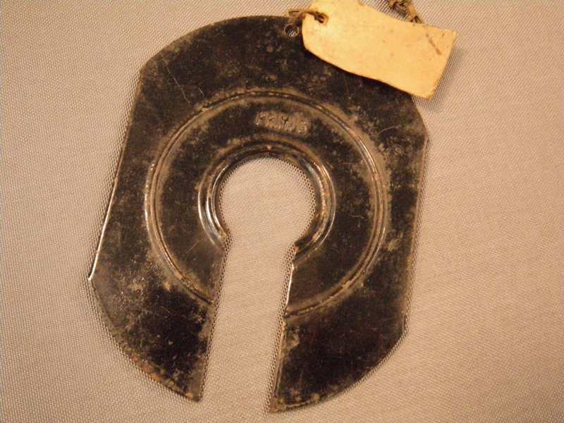

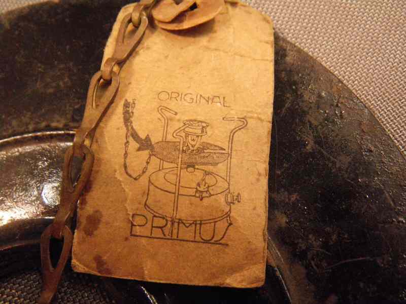

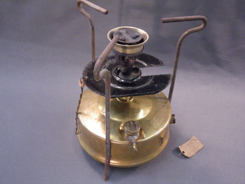

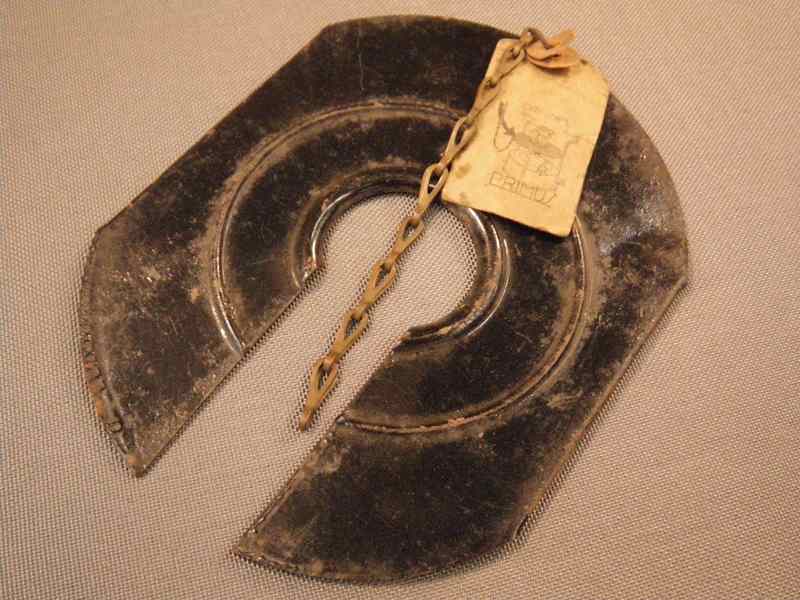

    Here is the Primus 1684 Protecting Plate. This accessory was used on the Primus #2 and #6 stove to deflect(?)/reflect(?) heat from the tank. The plate is shown in the last picture on a Bahco Primus #2.
    1288574819-IMGP5211.jpg 1288574826-IMGP5213.jpg 1288574834-IMGP5214.jpg 1288574841-IMGP5215.jpg 1288574849-IMGP5216.jpg

    :-k I wonder what would the other end of the chain have been attached to - the label seems to indicate something above the stove...

    Over the stove leg if it's under an oven or under a tripod or other large apparatus but on the cast-iron range there is a small hole in the front access flap that the ring goes through.
