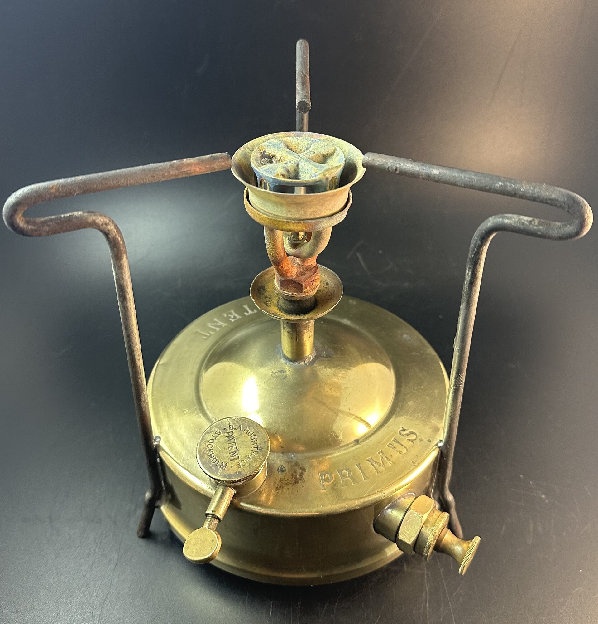

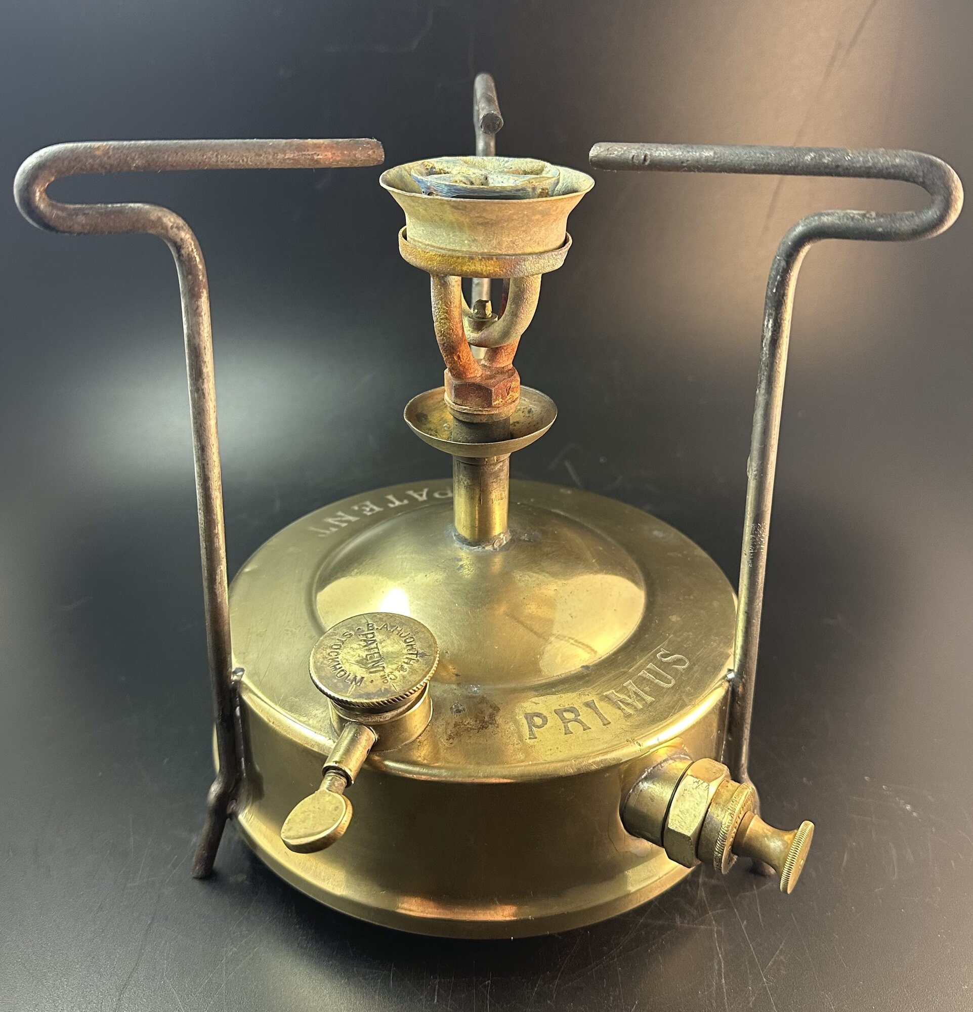

    Hello,
    recently I have been the only bidder on Tradera, on a 7 days auction, for this 1895 un-numbered Primus stove… so I won it for 13€… less than the cost of the most stupid spare part.
    It’s incredible how little appeal these oldies have between international collectors… well, good for me :)

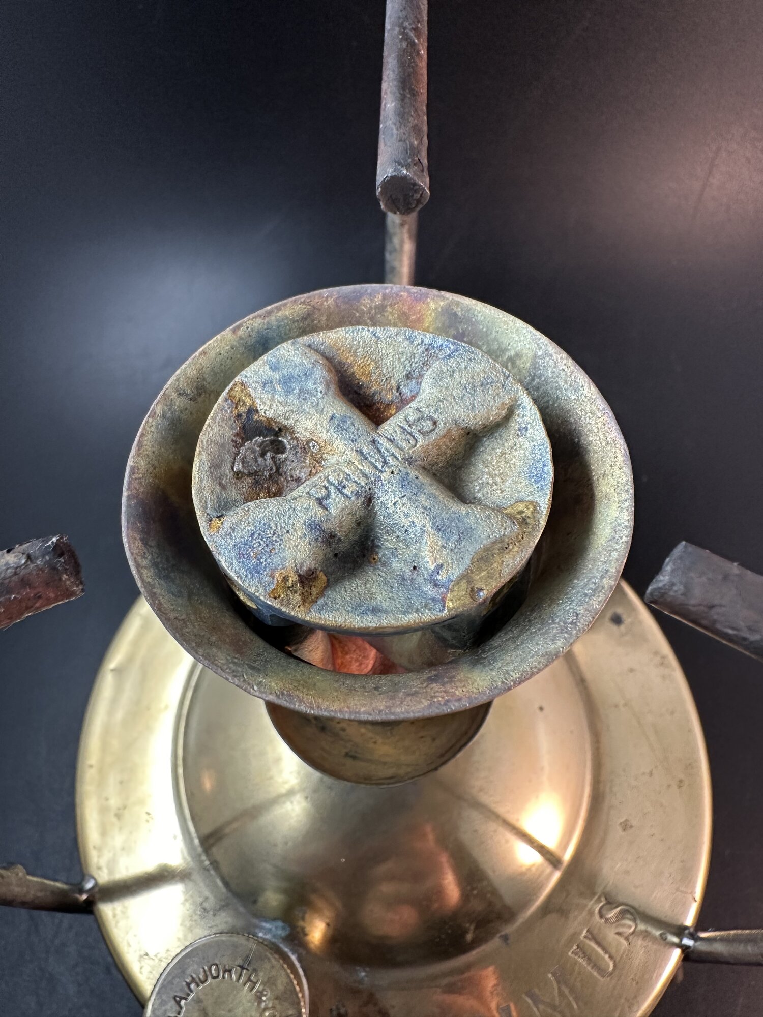

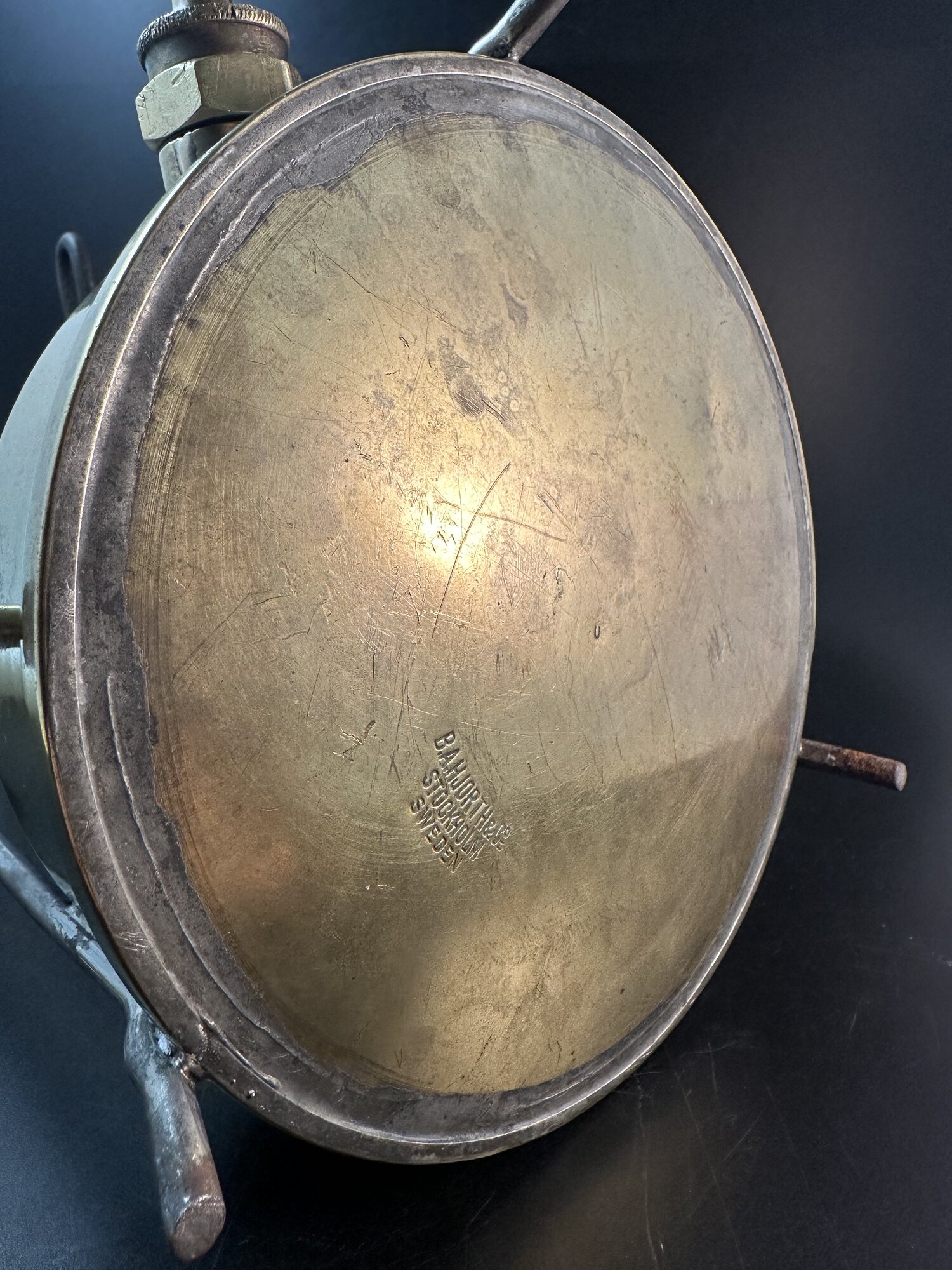

    I always wanted to add an early Primus to my collection and this in particular is the latest design evolution before the introduction, in 1896, of the Pri-LOGO-Mus engraving on tank and the first model numbers (0 and 1). As well probably the last year for the old style bottom stamping.

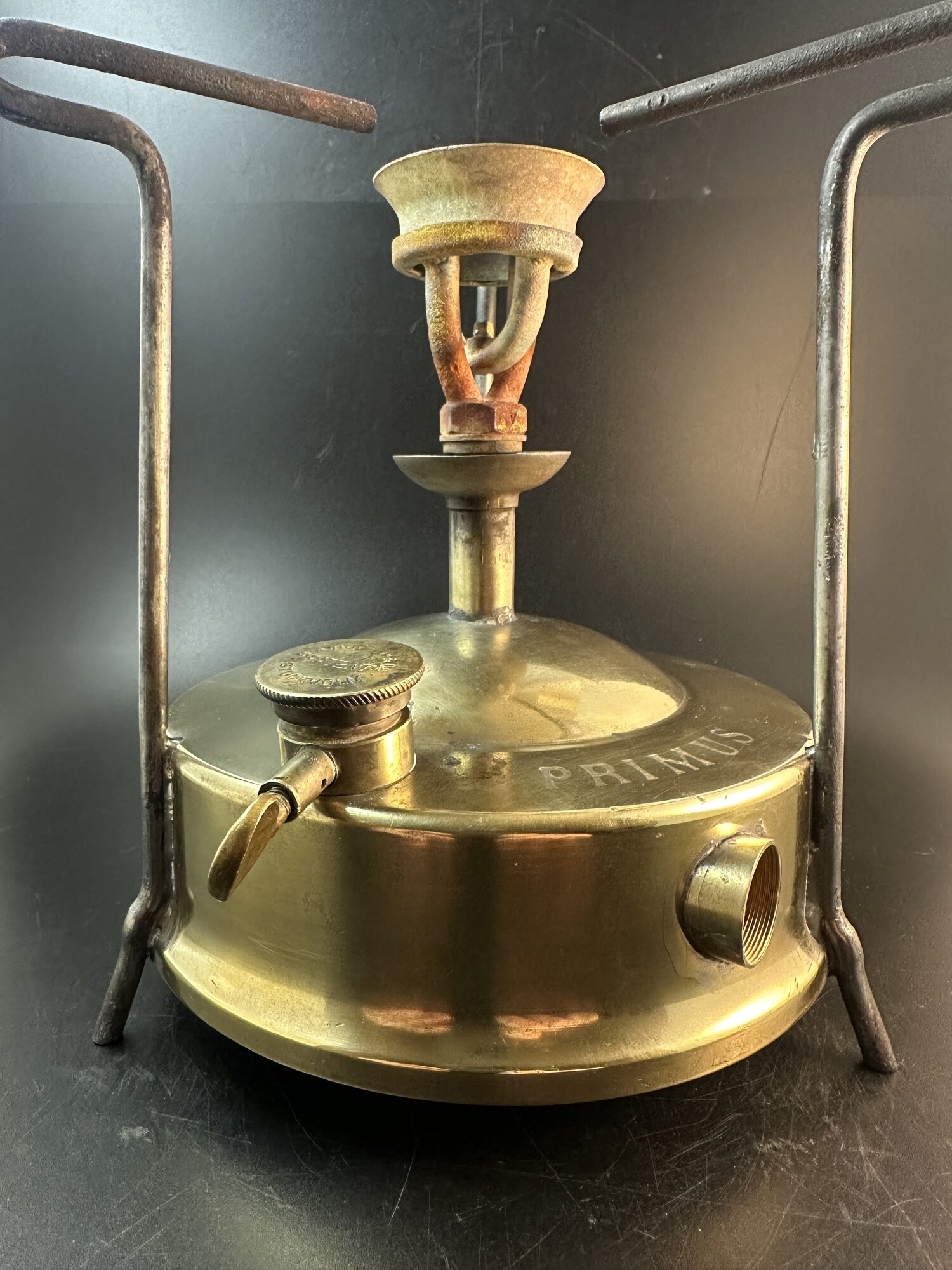

    On this 1895 version we have the recently added hex shape for the burner base and pump removable tube. The burner as well is original (fortunately), confirmed by the “square” head of the jet.
    So, a very emblematic stove, the father of the universally known Primus 1 and father of all the stoves that we know, a design that lasted for 130 years without the need of any major update.
    A stove that can’t be missed in any collection in my humble opinion.

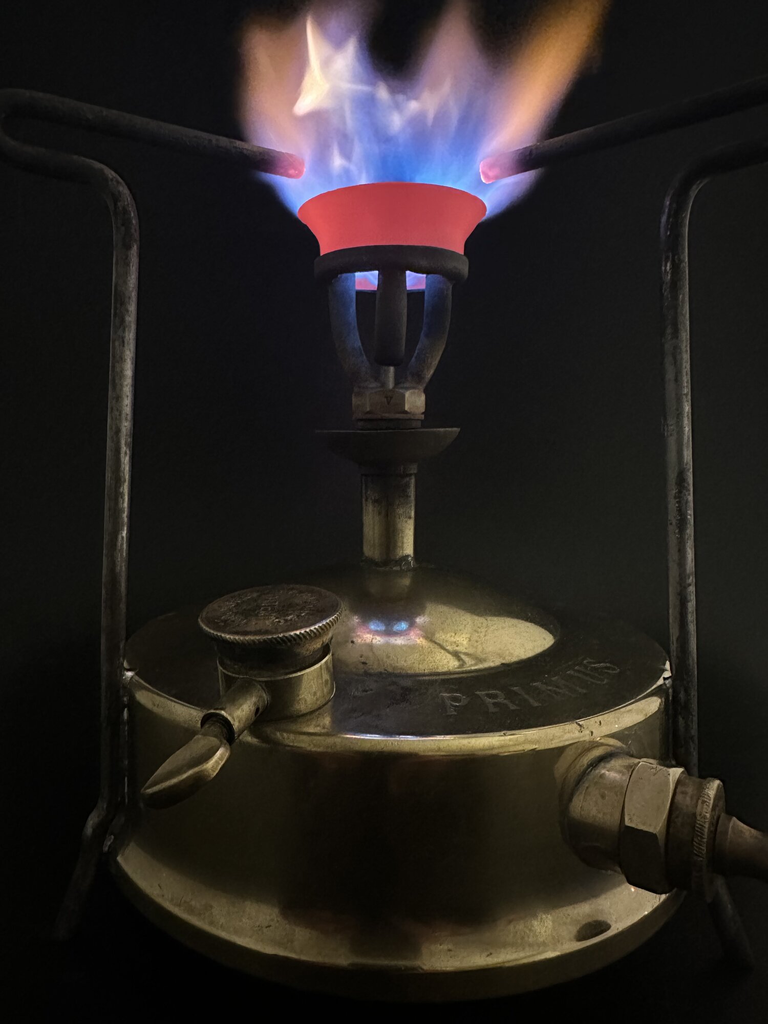

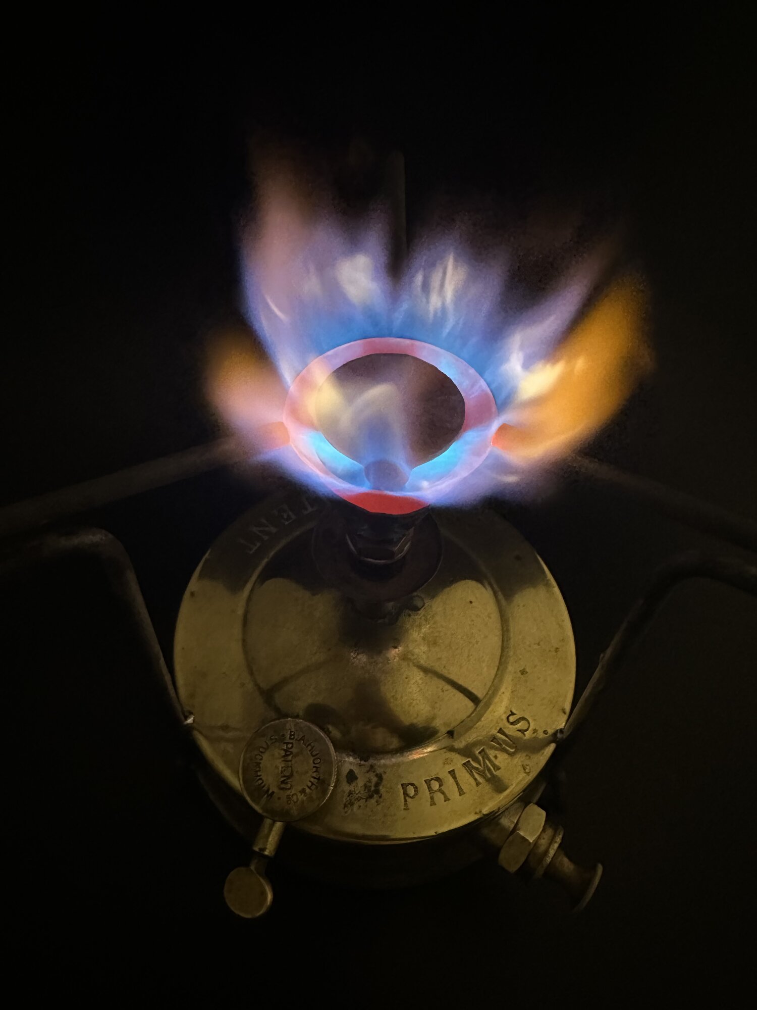

    I fired the stove with its 130 years old jet, clearly a little worn, but still performing not too bad… absolutely no need to add a new jet to this stove just to achieve a better flame.

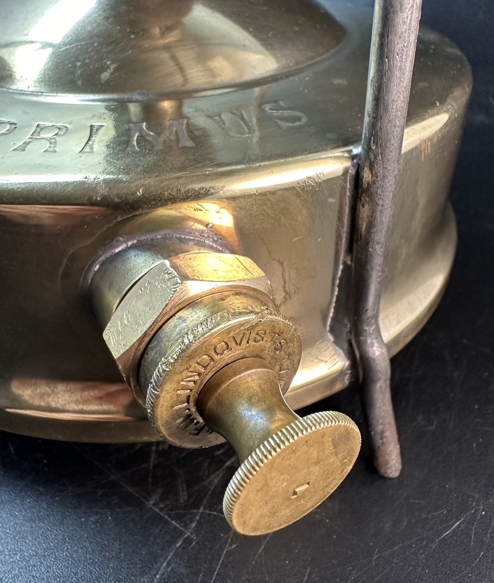

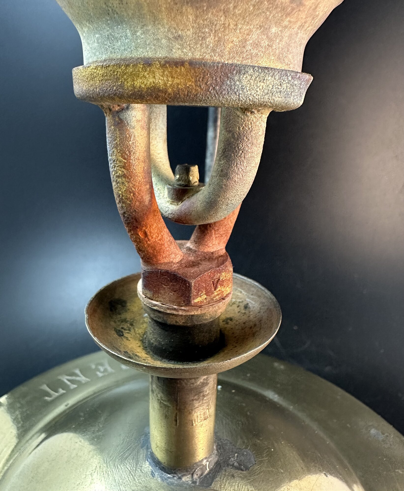

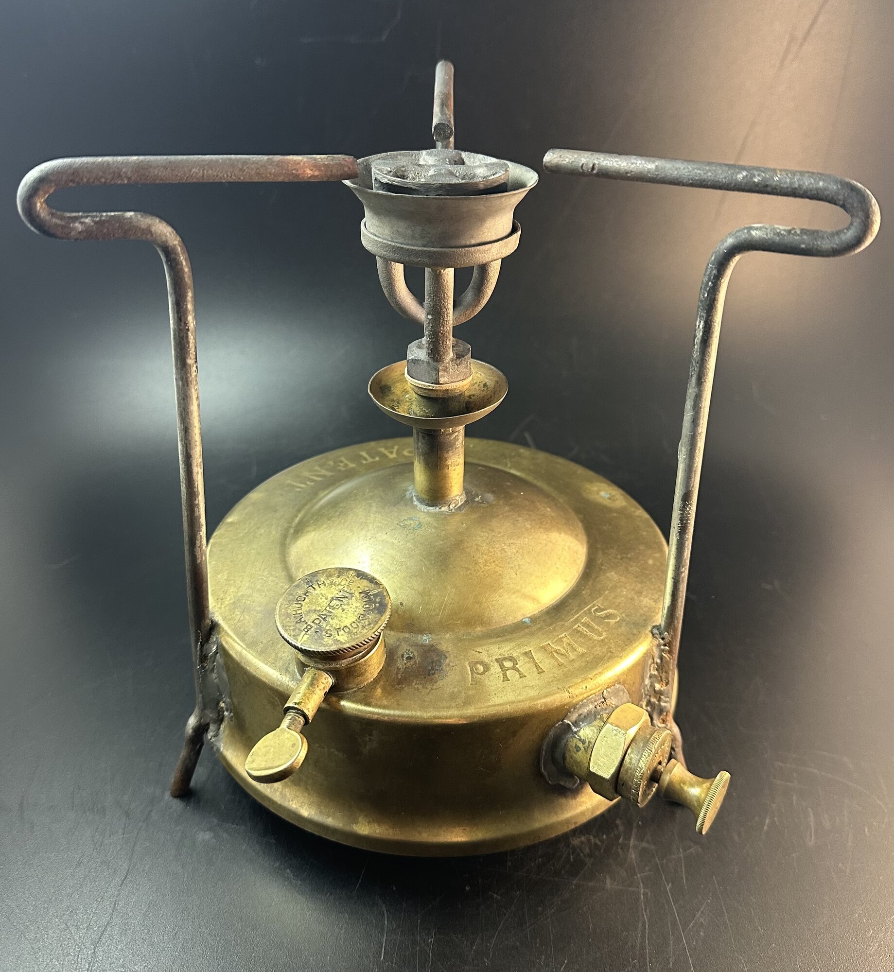

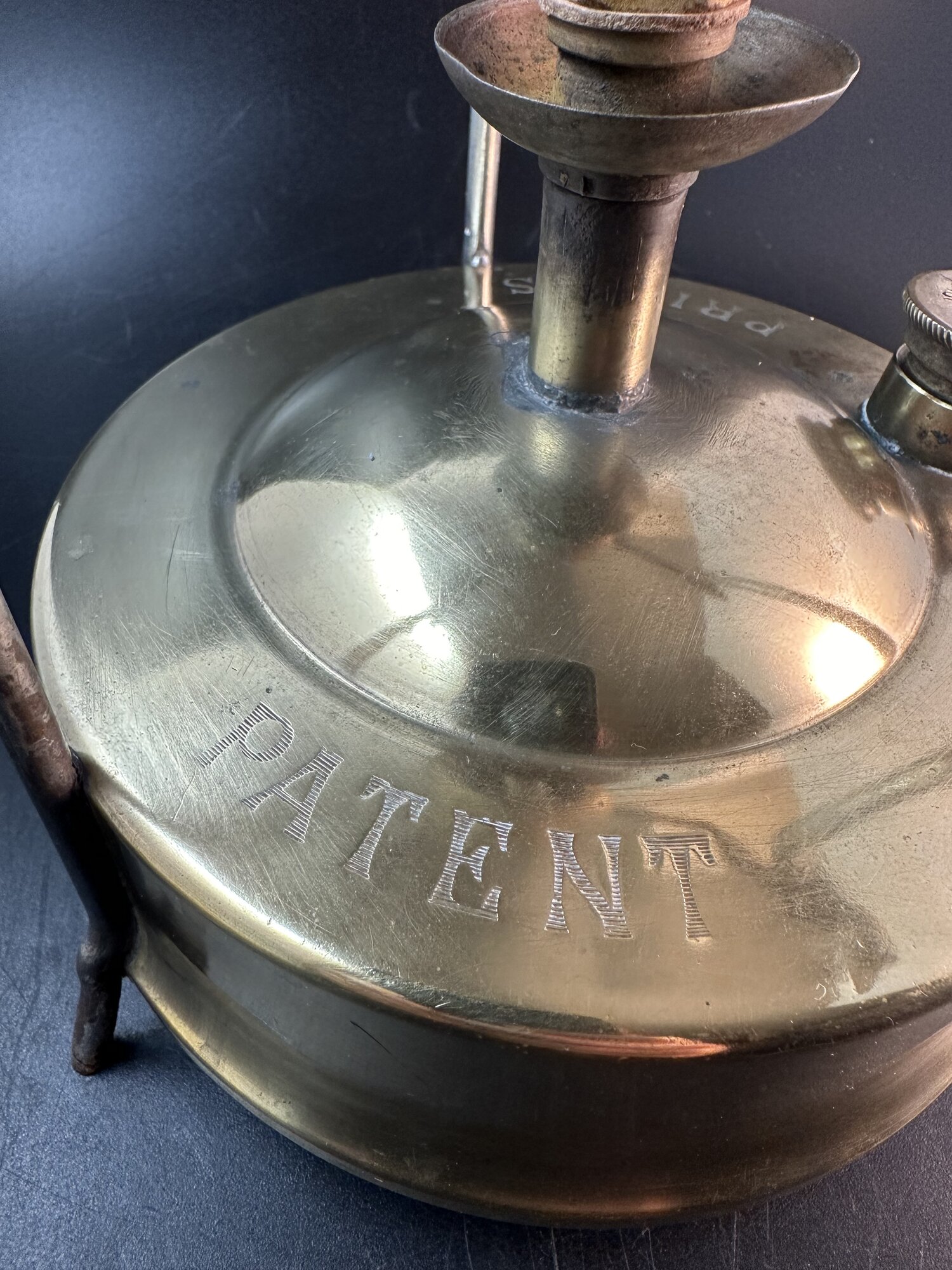

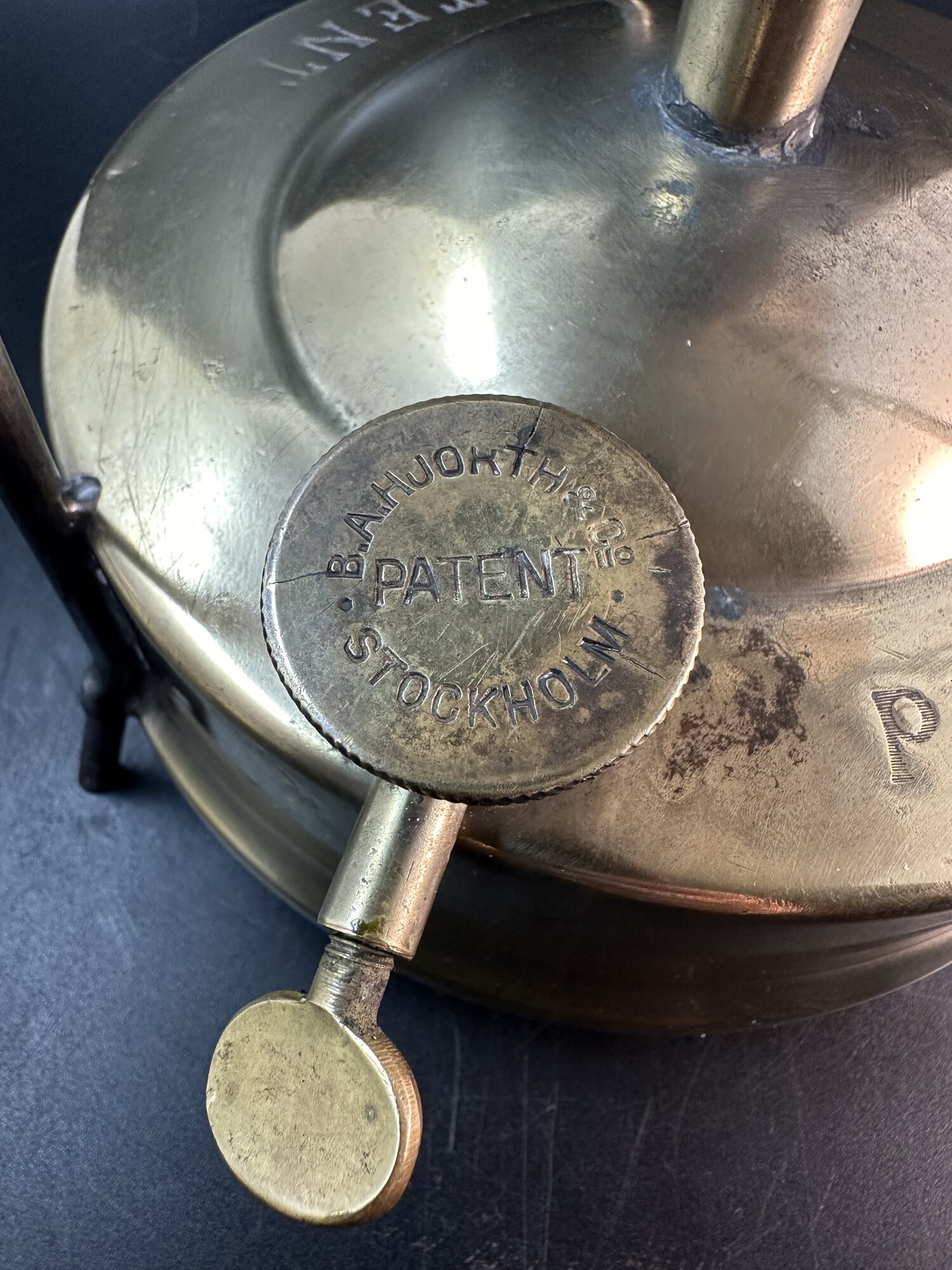

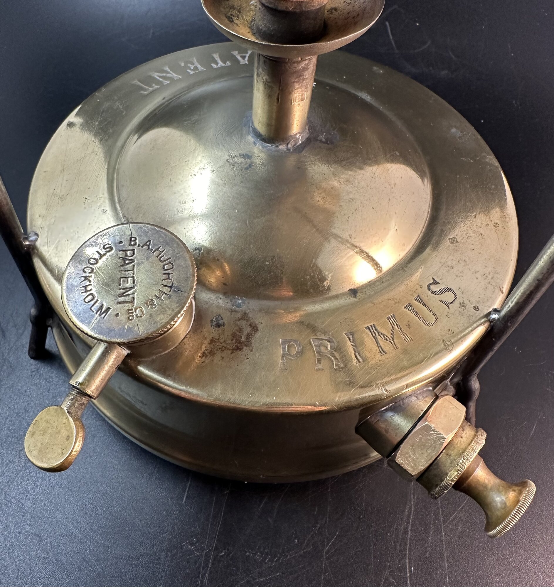

    Here it is after a little restoration (I will explain in detail next):
    IMG_6153.jpeg IMG_6154.jpeg IMG_6155.jpeg IMG_6156.jpeg IMG_6157.jpeg IMG_6158.jpeg IMG_6159.jpeg IMG_6160.jpeg IMG_6161.jpeg IMG_6162.jpeg IMG_6165.jpeg
    A short video of the stove burning:

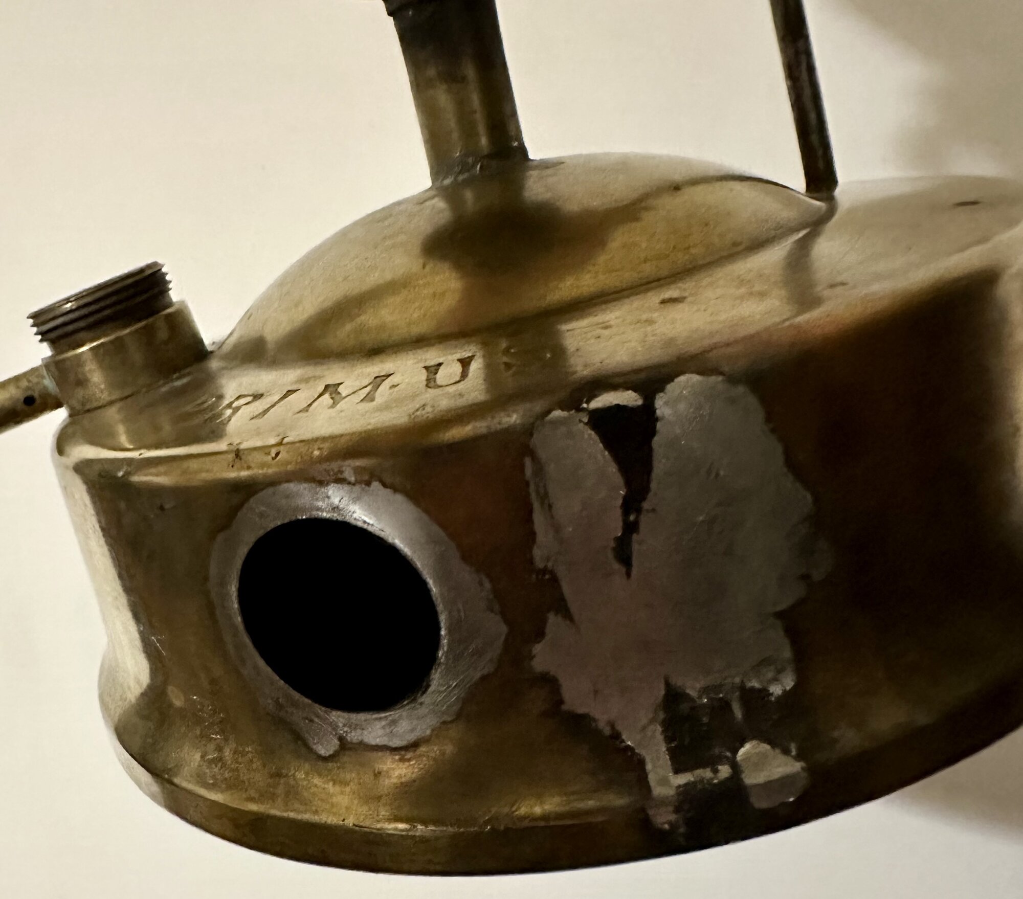

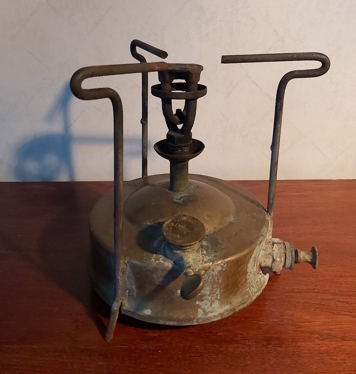

    Now let’s talk about the restoration. After a basic clean and fettle my job was done, I didn’t want to disturb the stove too much, leaving also the very ugly soldering repairs at the front supports and pump tube:

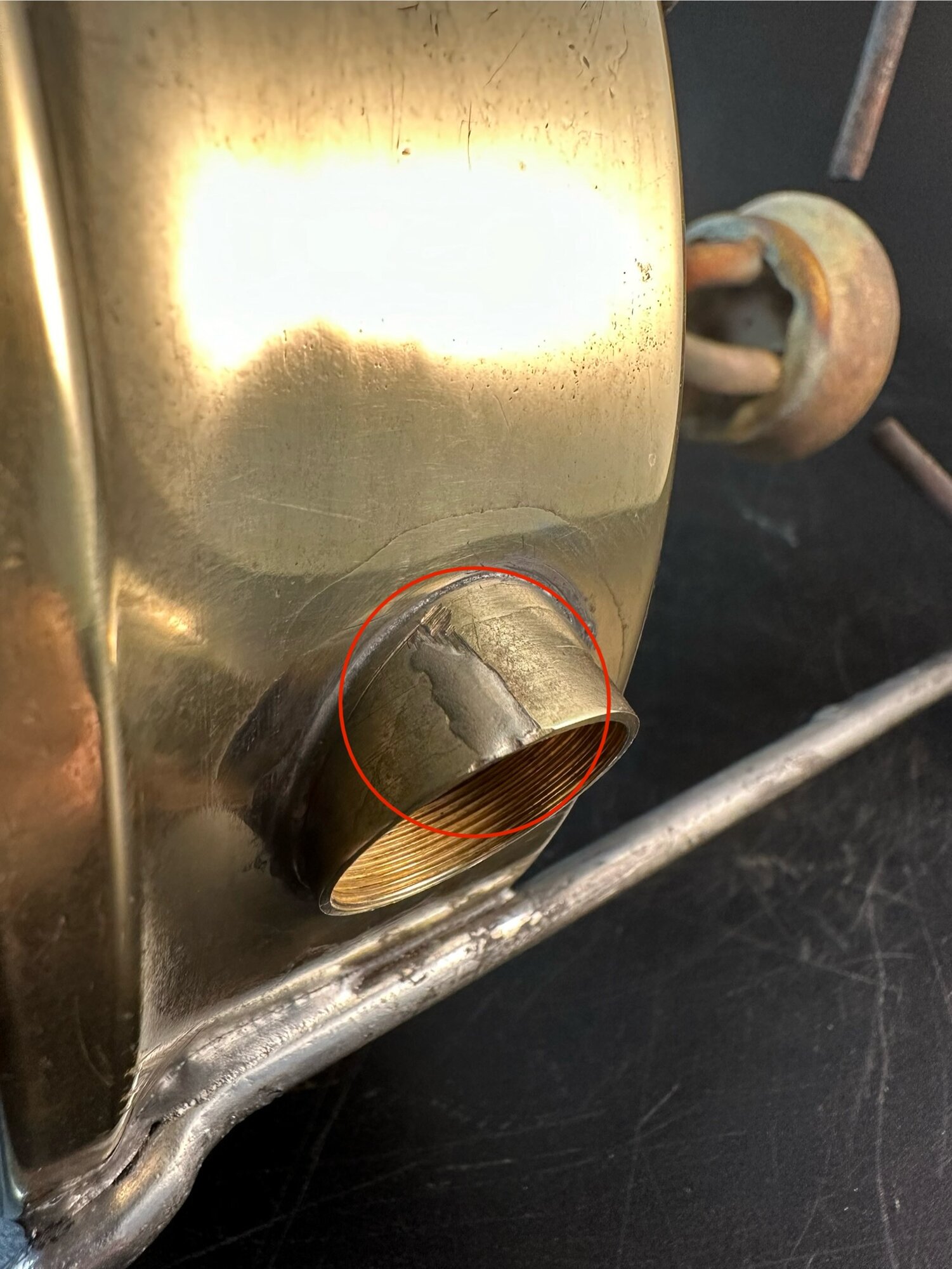

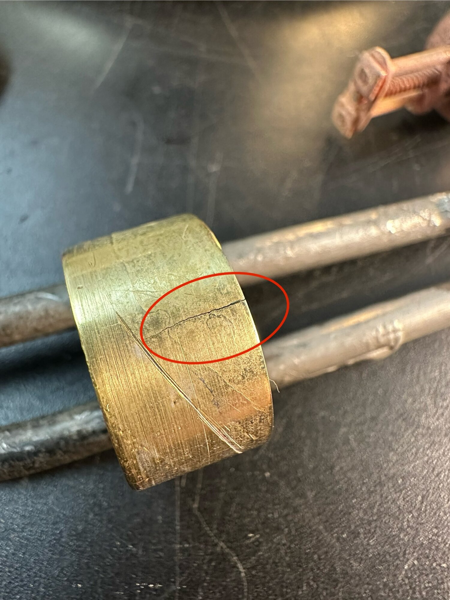

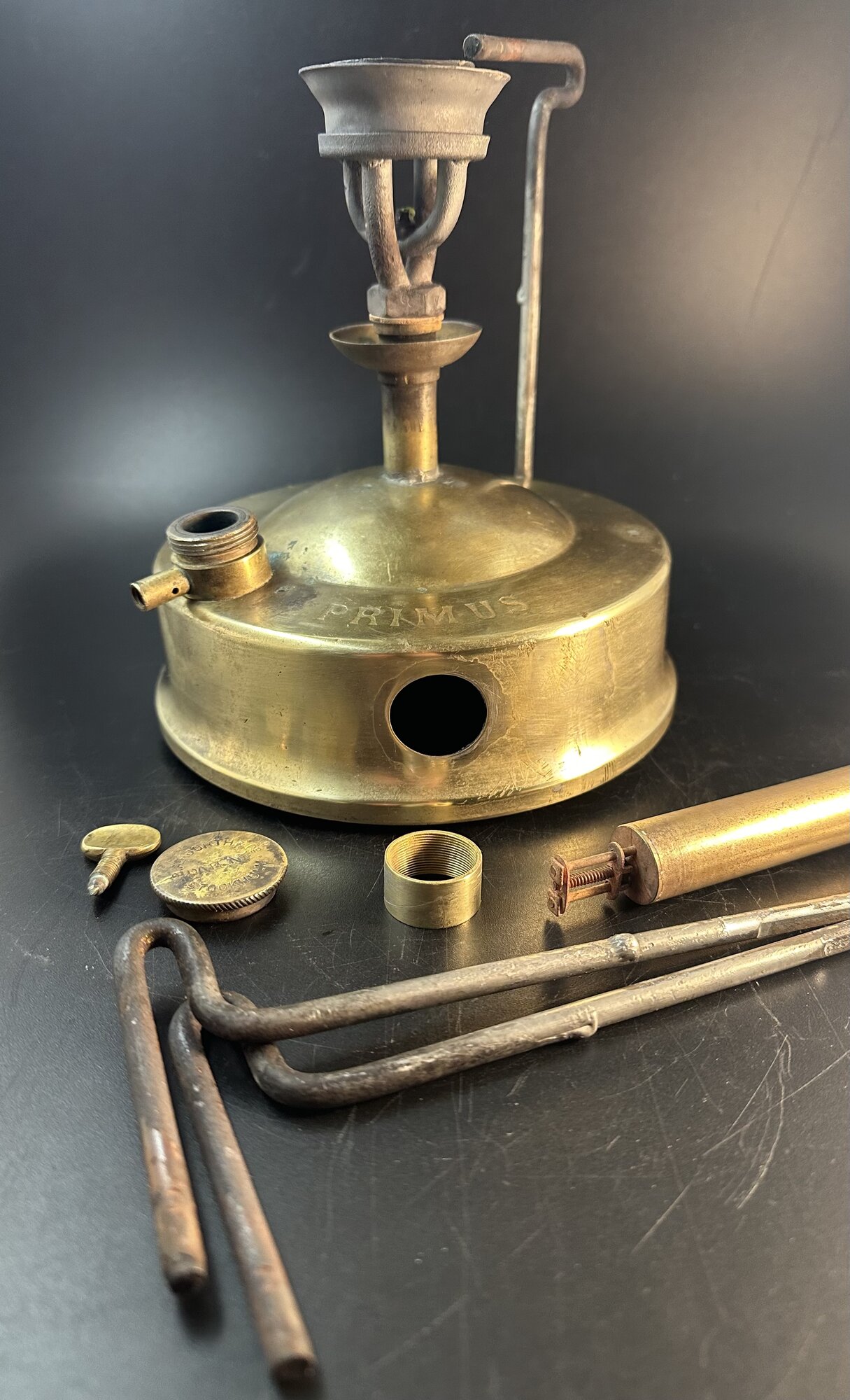

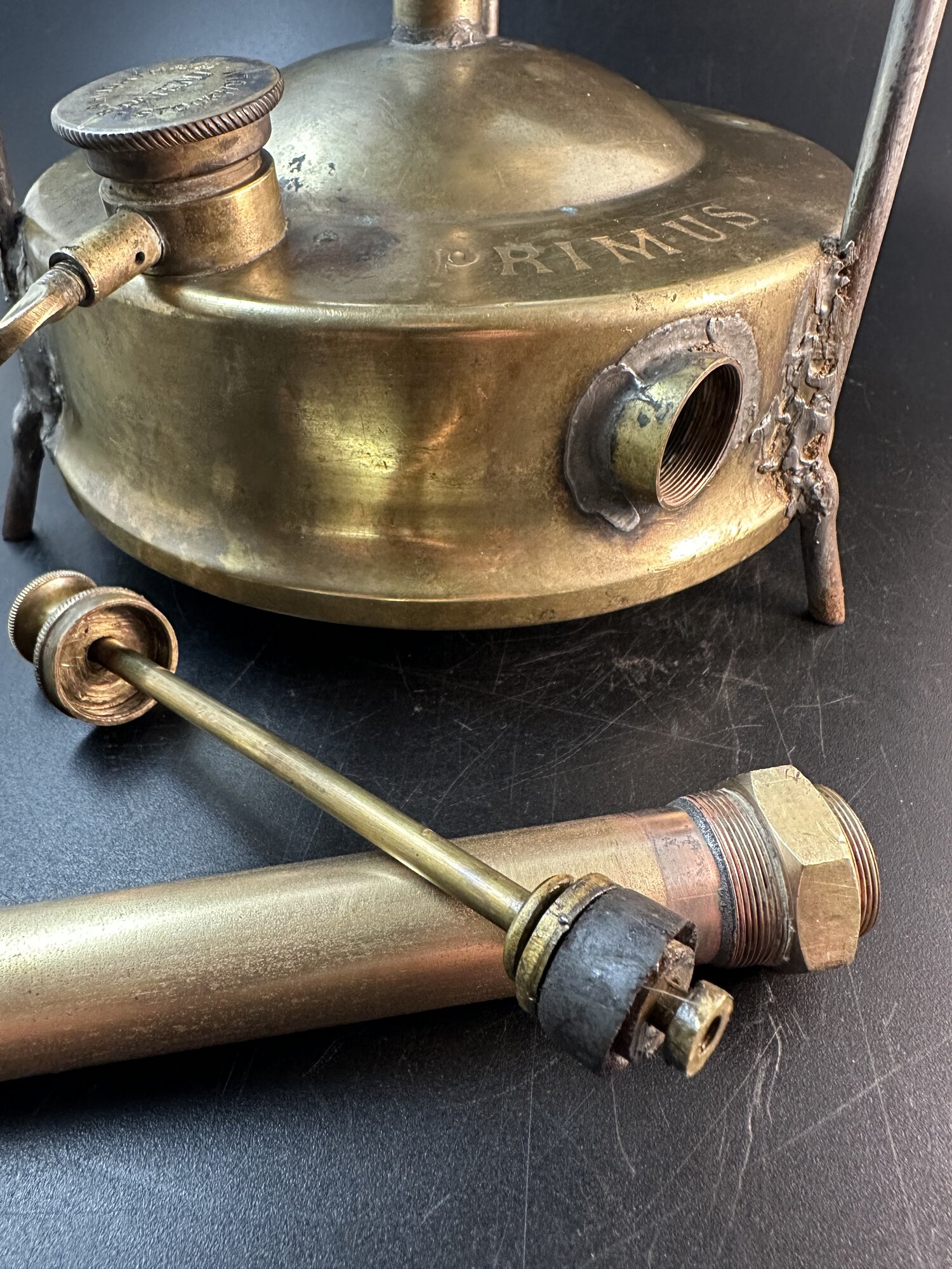

    So I fired it and everything seemed ok, but then I noticed some kerosene on the bottom plate… so a leak was somewhere…
    After some investigation, I found the leak at the pump tube seal so I renewed the seal and tested again… the leak was still there.
    So I made a better visual check and I noticed a tiny crack on the pump tube tank fitting, so that was the cause of the leak.

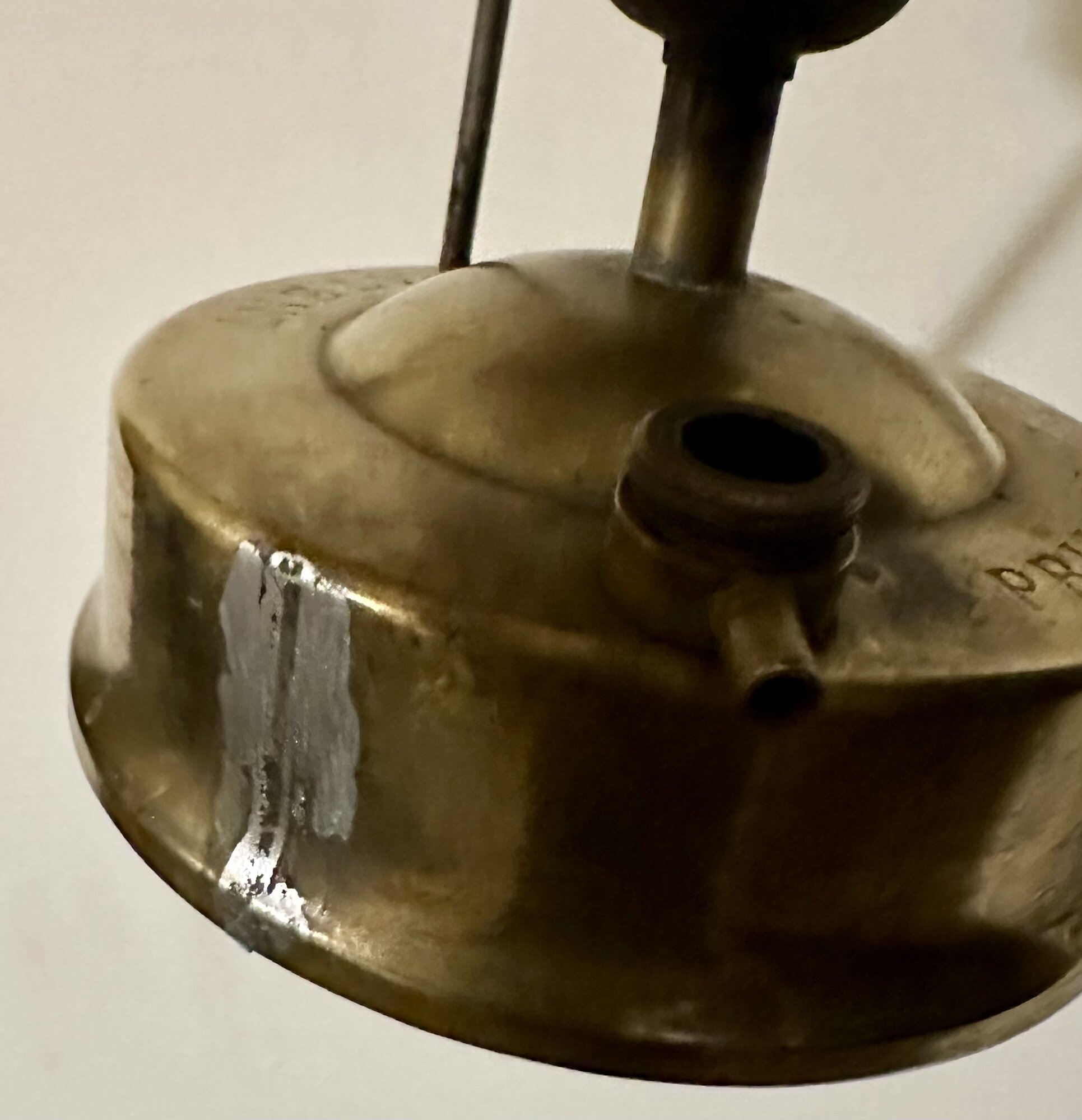

    The only possible solution was to remove the fitting and braze the crack. At this point, having to work on the tank, I decided to make a full restoration, clean the ugly solder repairs and reposition the supports in a better way (they were repaired not too perfectly).
    So desoldered the parts and wiped away a lot of solder:
    Then with some 1500 wet&dry paper I removed the layer of lead and cleaned the parts to be ready to start soldering:
    The crack on the pump tank fitting:
    I masked the internal threads and brazed the crack, then lead soldered everything together and polished a little to remove all the traces of flux:
    Job done and stove reassembled with the pump and fired, fortunately everything went smooth.

    Looking at the photo's and the video of the flame pattern the jet orifice has very little wear, may be the jet was changed in its history but if so this jet has been in there for many decades, once again Nicola well done there :clap::clap::clap:

    @mr optimus thanks Brian, I appreciate your words! I think the jet is still the original one. As I said, it has a squared head that I have found only on pre-1900 stoves like Aetna and Vulkan.
    So, a little rich flame is acceptable! :)

    You didn't mention the NRV. Did it require any repair? From what I know and read, this solution was reliable.

    The NRV was functional with the original cork pip, but I have anyway replaced it with a piece of viton… I really like this old type of nrv and I think it’s pretty simple to fix. The pip is big and it hardly fails to seal.

    @igh371 thanks Ian. Usually I keep the original cork pip, but I noticed it was a little rotten… so because I intended to well seal the pump tube I’ve chosen to make a long term repair to it.
