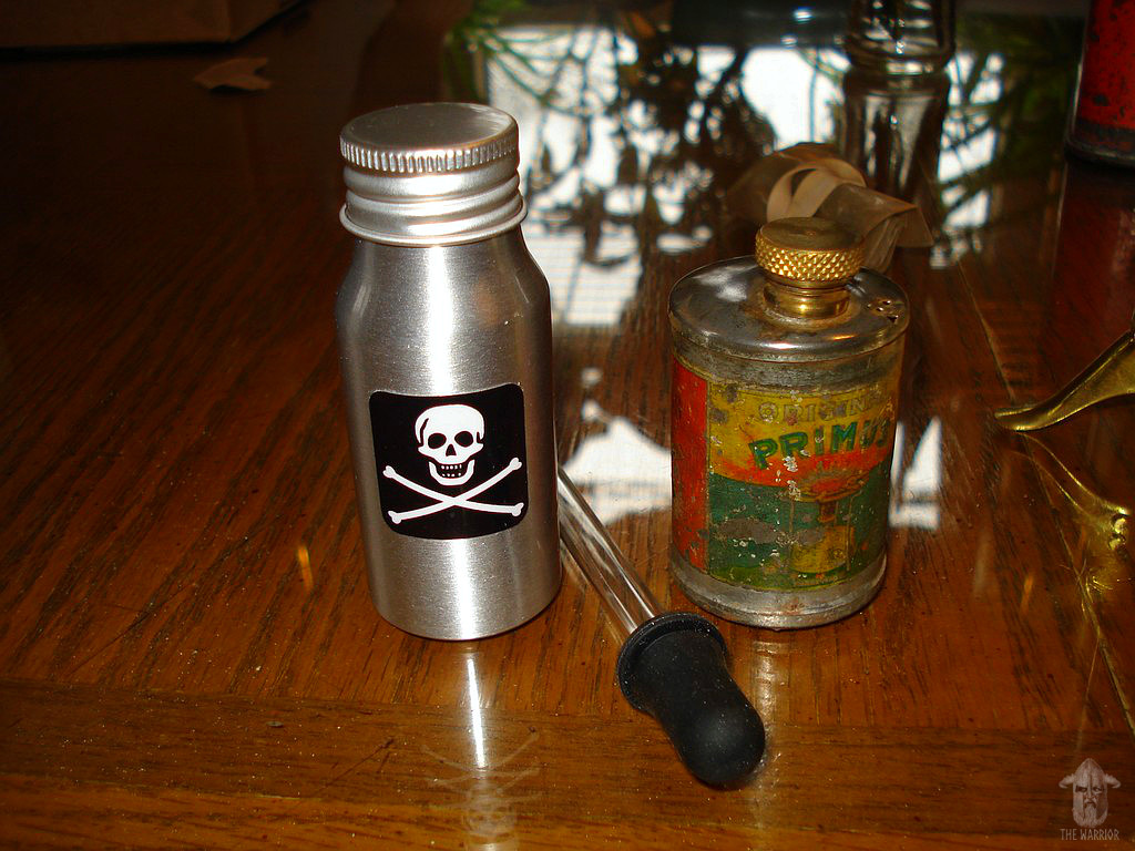

    Those tin made spirit cans rust quickly due to humidity in air and from inside when there has been meths that always contains little amount of water. I have oiled (inside also) my unused tin spirit cans to prevent them to 'decay away'.

    I may oil up the inside of the can, and wax the outside for preservation.

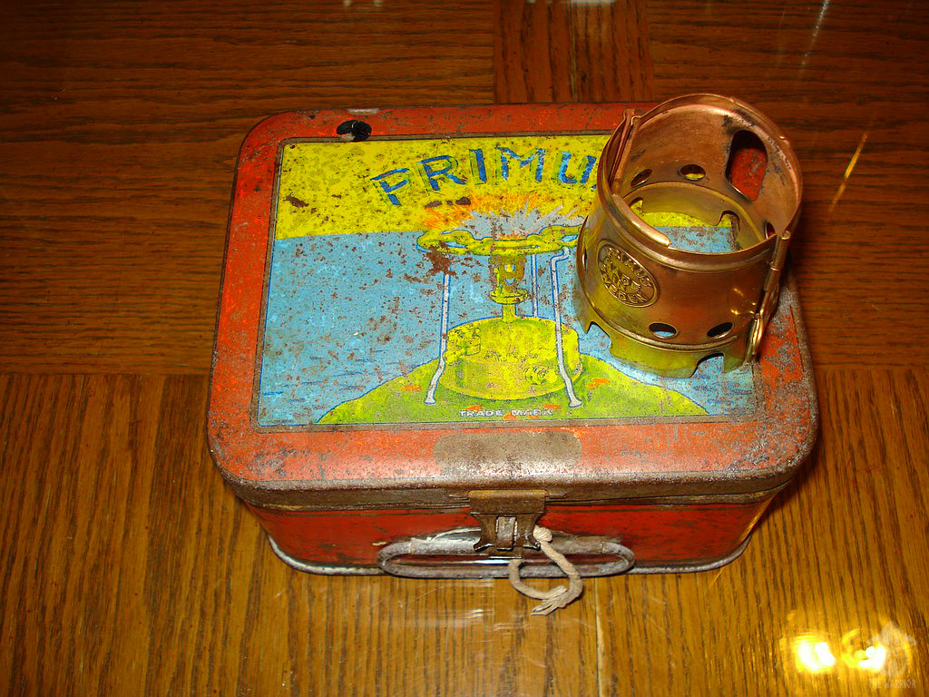

    Lighting sucks, so not the best photos. My instamatic doesn't do too well in low light, so I had to use the flash. Raining outside, so that's a no go.

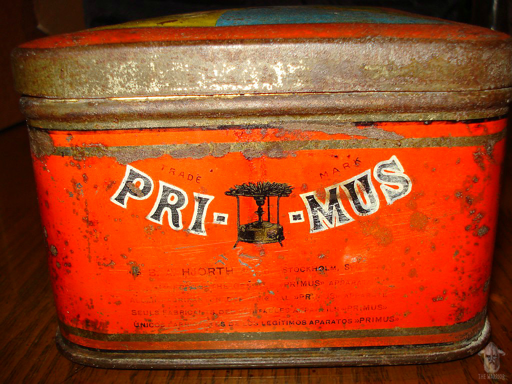

    The goods:

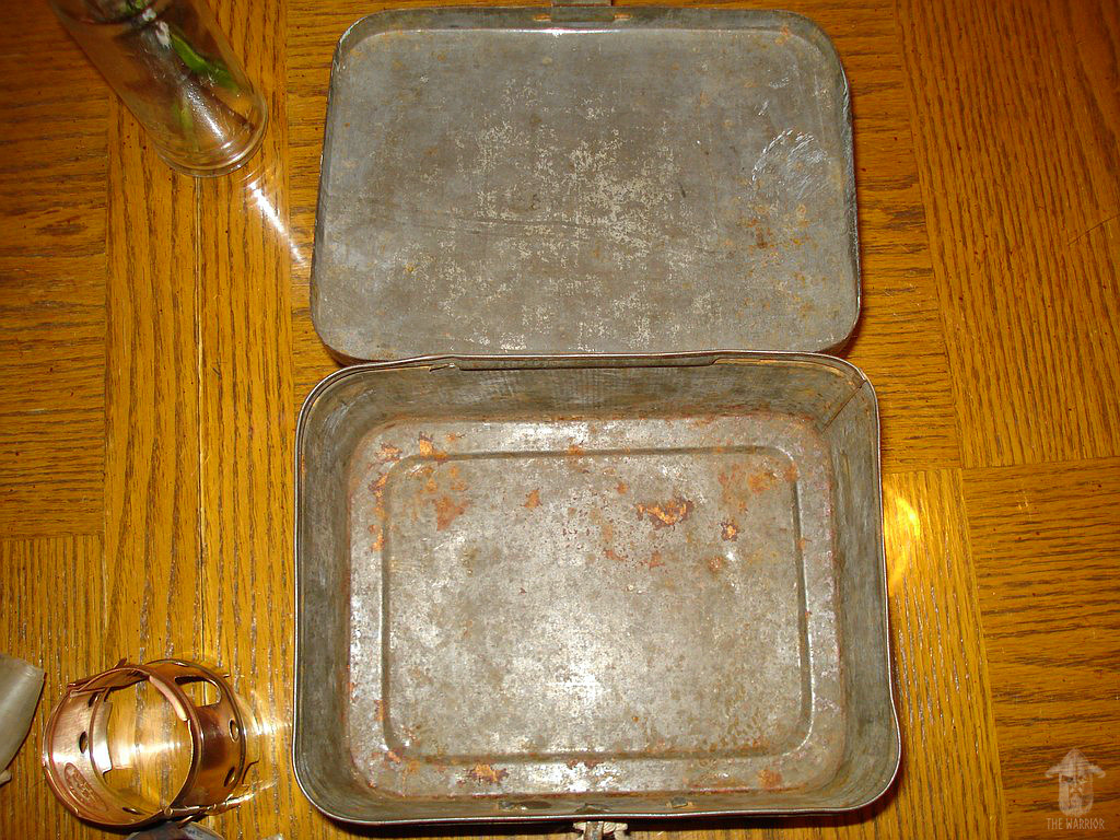

    Tin has minimal rust inside:

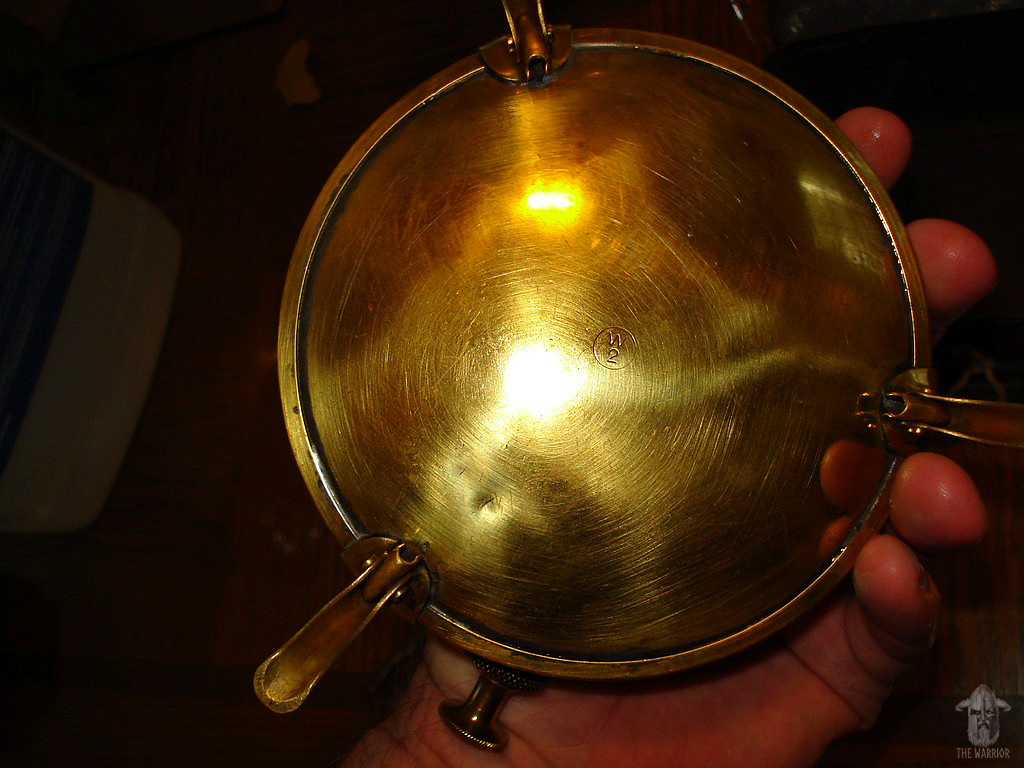

    Underside. Says W2 on it:

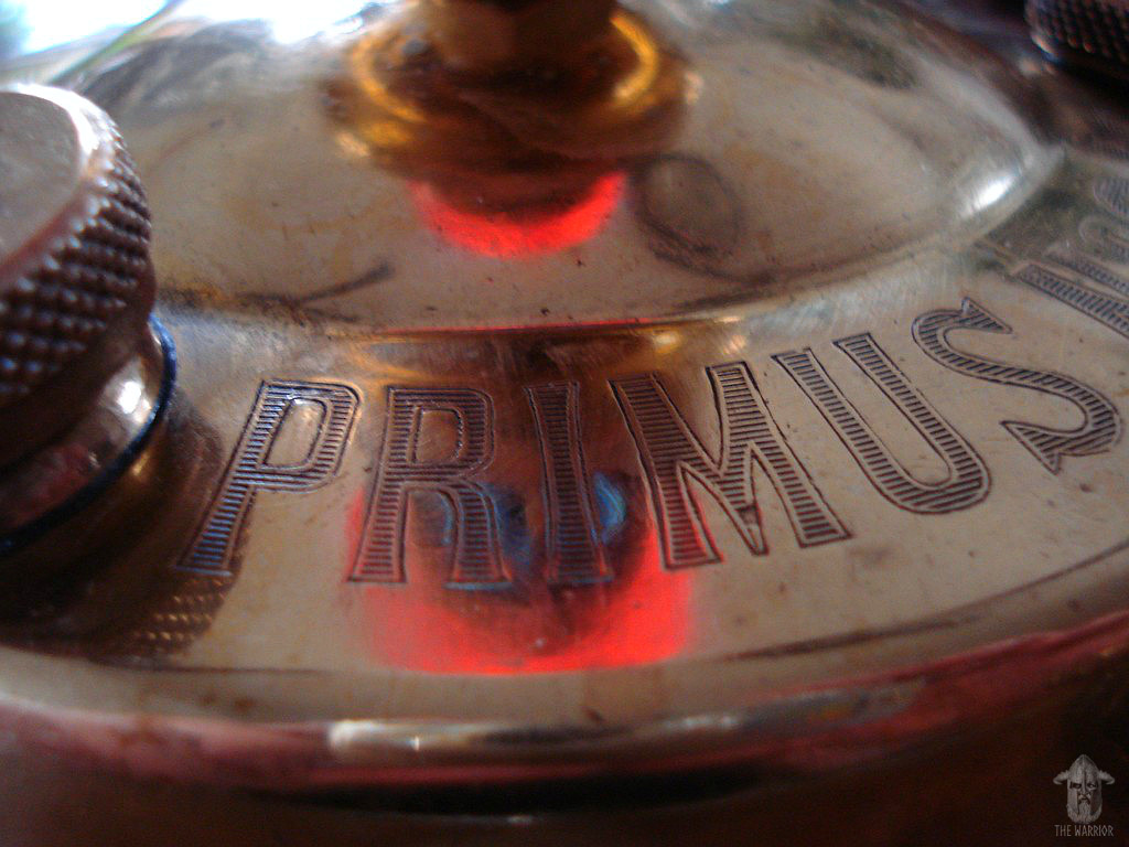

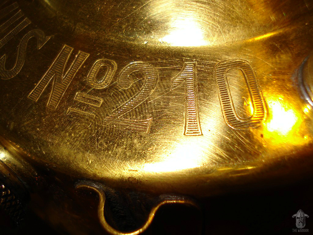

    210:

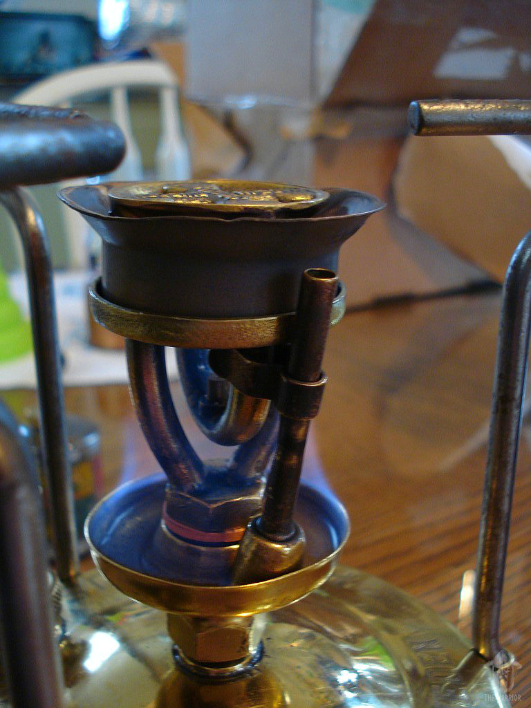

    Burner. Turned the pilot lighter right side up:

    My spirits can next to the original:

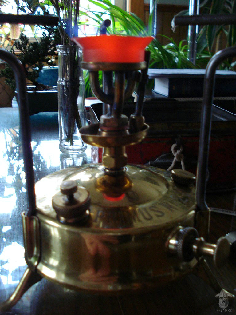

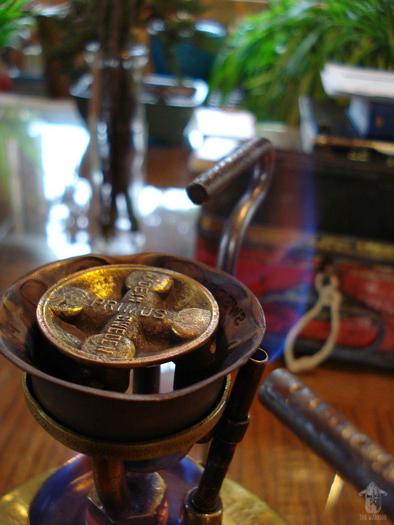

    Fired up the alcohol:
    A few seconds in, and the pilot lighter came alive:

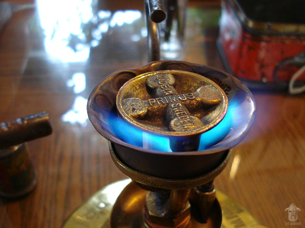

    When the priming flame was about gone, I started pumping. Nope, it wasn't working. I had to take the pump out, and flare out the leather a bit. It was well oiled, just not quite hitting the sides. Put it back in, and re-primed it. This time it lit right up, but it was only burning on one side:

    Started doing a little better after letting it run for a bit:

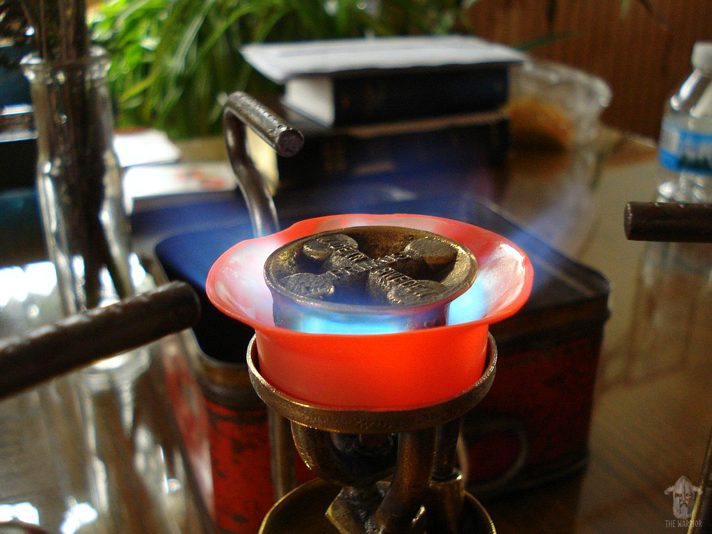

    Oh yeah, I forgot to use the pricker. Did, fired it up, and it roared to life:
    Priming cup is a little wonky:
    Don't know if this is the correct tin or not, but there's no way the windscreen will fit, haha.

    Oh, you have to take the windscreen apart, duh.

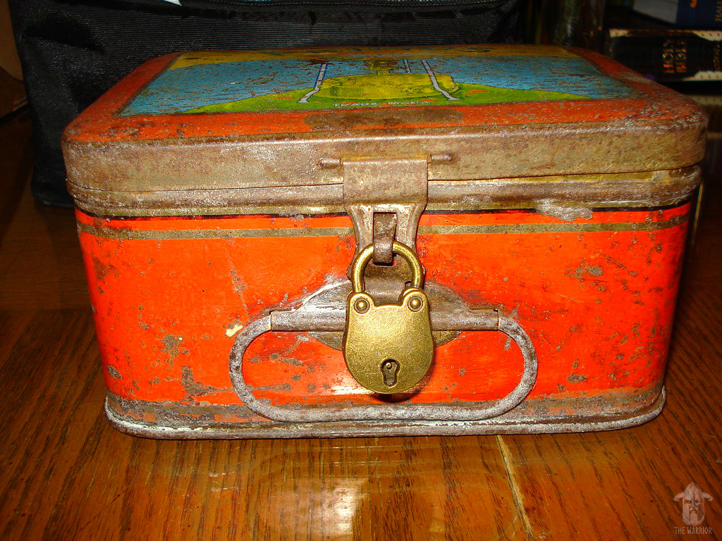

    Wife reminded me of some little brass locks I ordered some time ago:

    Good with the lock-- now the thieves won't be able to break into the box; whatever will they do?8]

    Thanks Ed. Heck yeah, between the rigid structure of said box, and the massive padlock, should be good to go, haha. I actually take a sling bag to work sometimes, and bought those locks to lock the zippers.

    Between the photos I just took, and the seller's on page one, can anyone give me a date on this? Thanks.
  20. The Warrior
    Dec 5, 2019
    3,053
    Illinois, USA
    I think 1932.
