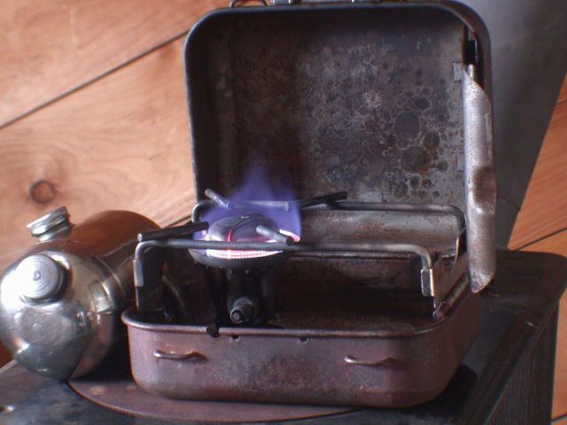

    this is the sister stove(brother?...dunno how to tell stove sexes apart: labstah's i do)) to the green one above...what is the original color of this one?...what yr?(has AS5 on nickel plated tank) the burner cap has 5 rows that works really well both starting and long term(the pic here is of this stove on for abt 1/2 hr...cap is NOT glowing too red and flame remains blue pot on or off))...i find the pump action of this stove to rival the German smoothies...this is a very pleasurable stove to use IMO...k-chunk

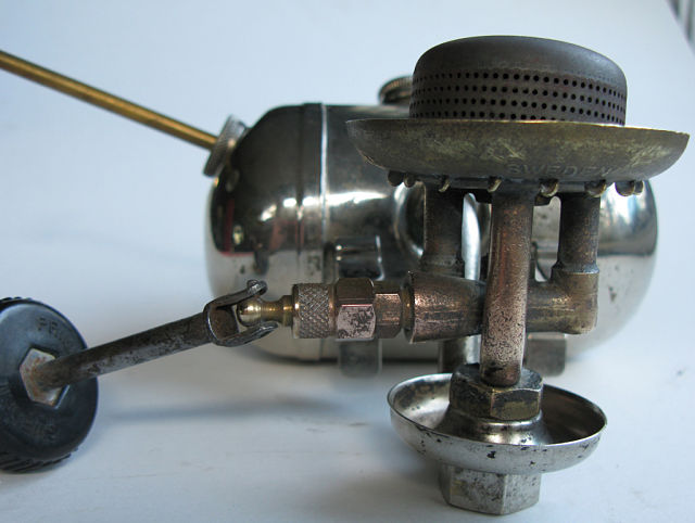

    from an earlier thread abt modifying a primus 41 to a field usable rather than home collectible; it has been suggested to swap the 4150 burner w a svea 1915...can one interchange/replace the svea 1915 w an optimus/primus 207 burner?...why not find another primus 4150 burner instead of a svea 1915?...pardon my ignorance...kablamachunk
  5. Spiritburner
    11,637

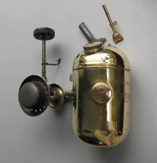

    As a 41 is on the bench at the moment this is occupying my mind. The 41 silent burner is as the catalogues state the 4151. From recent posts by SMolson & my own experience of my 41 fettle where I couldn't shut of the burner with needle down I'd suggest the 4151 burner works exactly the same way as the 4155. The rack & needles etc share the same parts numbers in both. The only distinguishing feature between the 4151 & 4155 is I believe the control knob. The 52 catalogue states as much. You do see 41 silents with both types so basically if you have a hinged control you have a 4151 burner - if you have a straight control you have a 4155 burner. There are different burner numbers again depending if you have a Primus-metall cap or brass - 4145 is Primus-metall, 4156 is brass!!
    What you have there is the 3026 alcohol burner for the alco version of the 41 - the 341. The parts illustration in the catalogue isn't so clear but the stove illustration clearly shows the wicking material.

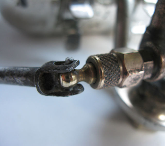

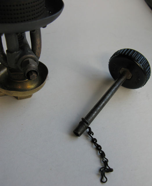

    Thanks again. To clarify, the following will be burner 4155 (kerosene): straight, unhinged spindle/control knob, can be removed from burner.
    The one above is 'missing' its little connector sleeve on her spindle that hand-screws into the burner's stuffing box equivalent to help keep the spindle attached.
    While burner 4151 (kerosene) has a hinged spindle/control knob attached to burner, cannot be (easily) removed from the burner.

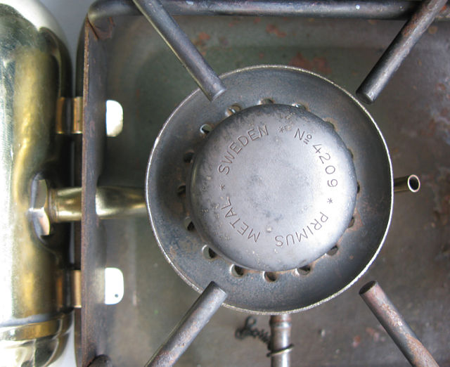

    For the brass/metal cap, do you mean the outer silent cap? Mine are both steel (No 4209), not brass and identified as such:
