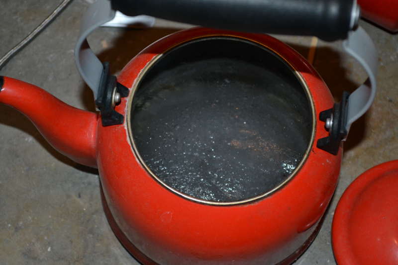

    First I did a boil up of a porcelain kettle with 0.8 litres of ice. I had left it out and let it freeze.

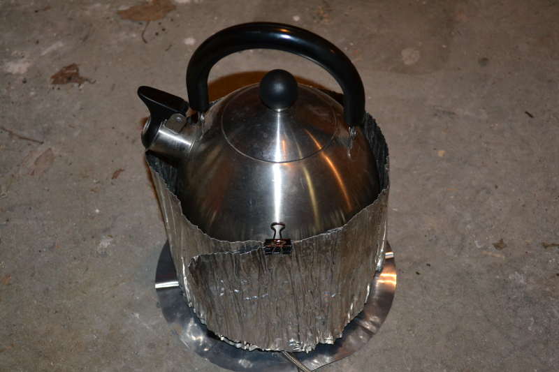

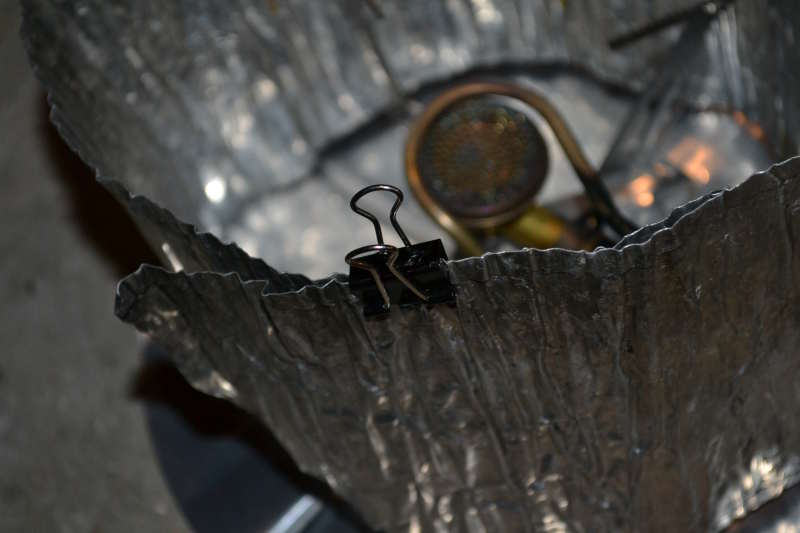

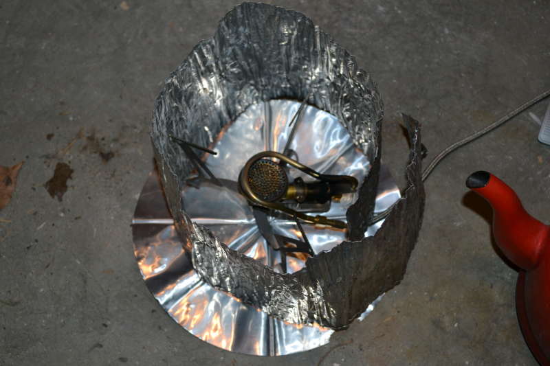

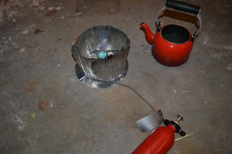

    Here's the heat reflector windscreen setup. The reflector is part of the ExpressLander VF setup, while the windscreen is courtesy of MSR. The idea will be to snug the windscreen up to the kettle to capture the heat from the stove so that we use as much heat as possible from the tiny ExpressLander burner.
    I used small clamp-style, paper clip to hold the windscreen closer to the work at hand. The bottom of the windscreen is jaggy enough to allow air in through the bottom. I adjusted the clip for each of the stoves in the informal test.
    Ready to start cooking. One thing I really like about the ExpressLander is the long fuel line, which is steel braided. The length makes the stove feel safer. MSR stoves seem to have some short fuel lines, requiring extra precautions for thermal conduction safety between the stove and the fuel tank. This fuel line is so long the tank stayed cold all evening.

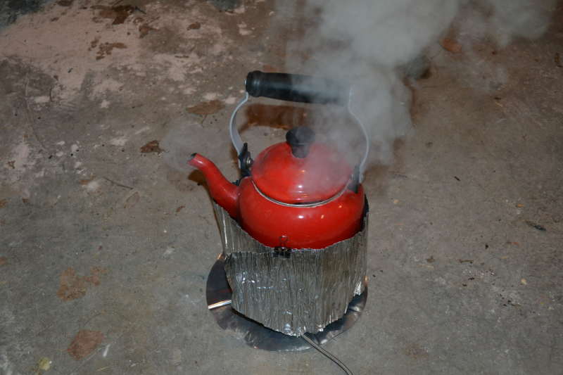

    We were able to achieve a boil time of the ice in porcelain kettle of 13 minutes. Not great but considering that we are heating from ice that's not a bad time.

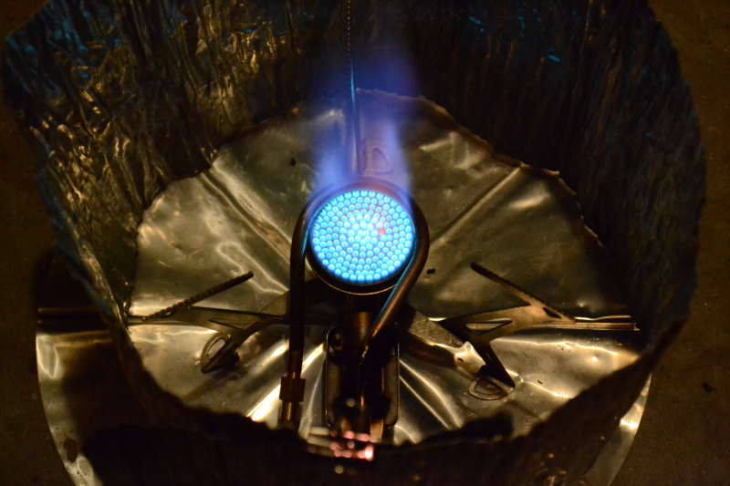

    Here's the stove at full power.
    Here's the setup with my stainless kettle and one liter of 45F water. I made sure the windscreen was wrapped but not tight to trap as much heat as possible. With this setup I was able to achieve a time of 8:30 boil time, which is a vast improvement over what it was before. I can live with that.

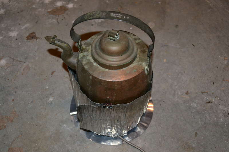

    Finally, I used my brass kettle with 1 liter of 45F water, which is how cold the water comes out of the tap in my house. I adjusted the windscreen to trap the heat and was able to achieve a boil time of 7:25, which is even better.
    I'm glad that the times improved with the use of windscreen and heat reflector. Without them, the time to boil is nearly doubled. Full power is not required to heat anything while you are out on the trail, but using a windscreen with heat reflector vastly improves the efficiency of the stove and cuts down on fuel waste.

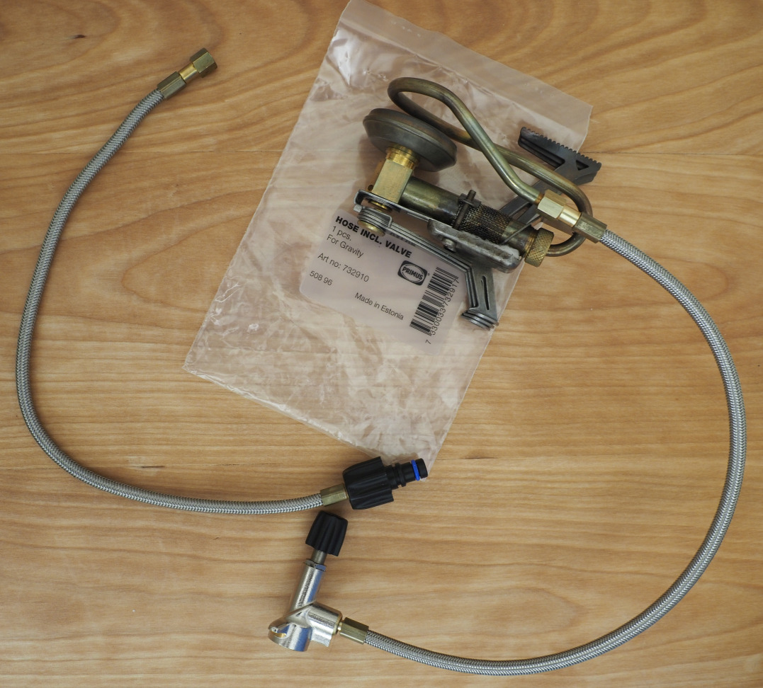

    I recently wrote an email to Primus seeing that the Express Spyder is a variant of the (now discontinued?) ExpressLander VF and found out that the Gravity MF hose is interchangable with it to convert it over into an Express Spyder. The specific hose with a valve is "732910" and it looks like the modern Omnilite Ti hose but the nut diameter is different. The nut can be tightened curiously enough with a MSR tool with the open cutout used to change the jet on Whisperlite Universals due to the flat distance being close enough.
    Procuring the hose and jets I think is easier than getting the multifuel conversion kit for the Express Spyder when it comes to converting the ExpressLander VF over. A neat way of preventing this specific model from being "obsolete" given that Primus recycled the design for the Express Spyder just minus the multifuel capability.
    The jets will have to be separately procured for running gases or other fuels which I'm still waiting on given I drilled mine out to run on isopropyl alcohol and of course the pump needs to be the modern Primus type that has the threaded lindal connector but I believe it might be possible to convert the ExpressLander VF's older style of pump by procuring what looks to be a called a "connection valve" which is listed as "734960" on the Primus site given how it looks like the ExpressLander VF's hose end on the pump side but with a lindal thread. I'm going to have to ask Primus when they'll have that in stock to experiment with that later.
