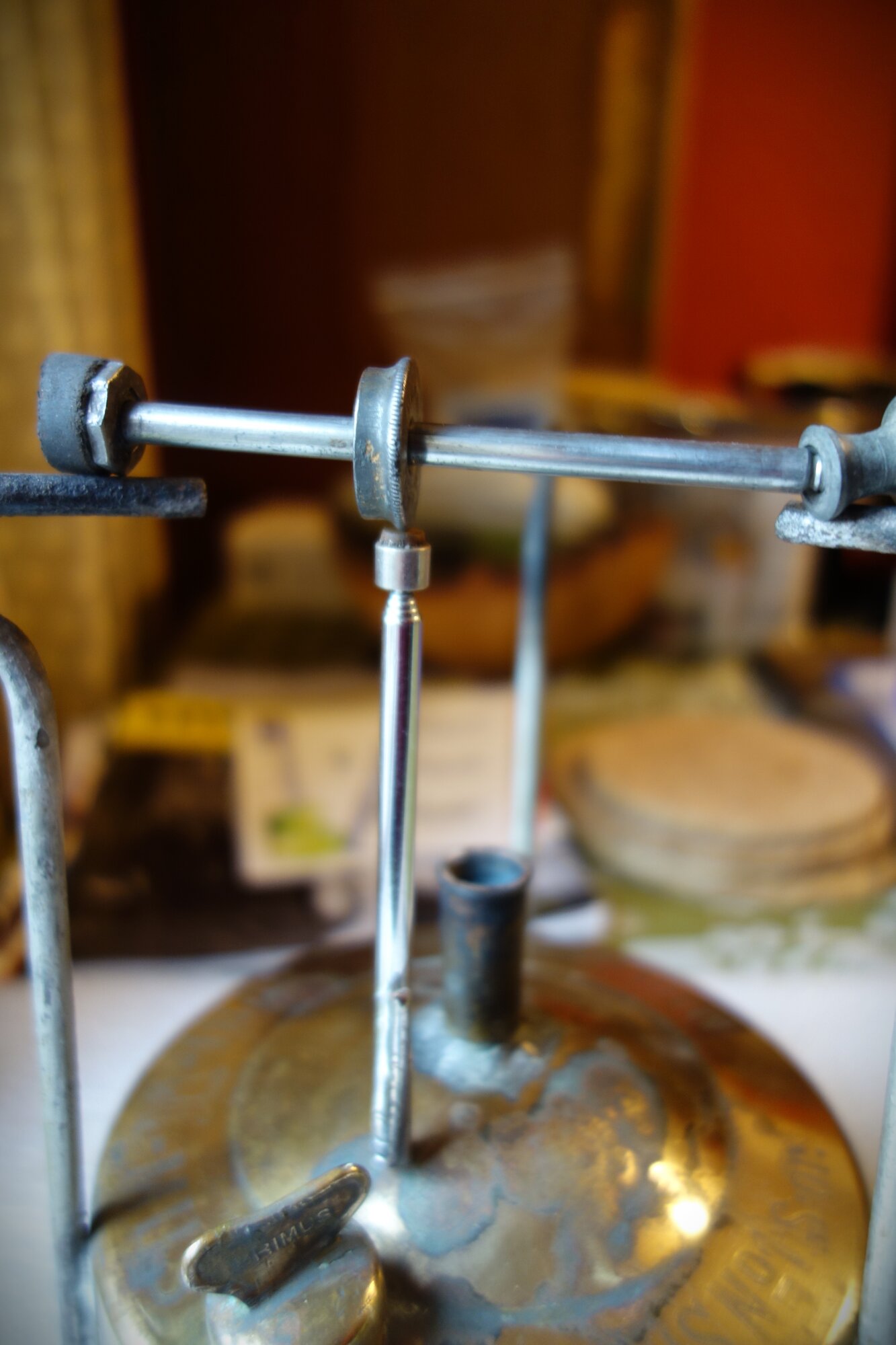

    A new model example piece from 1917, one of the 2 bleakest years for Primus stove production during WW1. This is the first 1917, 'G' marked, No.1 to appear in the gallery. Obtained from Sweden with help from an esteemed CCS colleague in dealing with a most eccentric and unpredictable seller. As sourced it had been fitted with a silent burner and was suffering from a lot of disfiguring Verdigris seemingly from boiled over cooking spatter. As above it has now been cleaned up to a basically presentable level and brought back to original spec with the fitting of a near-contemporary roarer burner.
    There are a couple of special features on the basic domestic Primus stoves made in 1917. These relate to the pump assembly. Most significantly the pump tube is made of steel, as also in this case is the pump tube cap too. Here we see the steel confirmed by a magnetic pick-up tool hung from each in turn:
    The steel pump tube cap seems to have been chemically treated to give a brass look finish to the surface:
    In addition the rather loose pump rod end is also made from an unusual substitute material - aluminium:
    The steel tube substitution is also found on the 1917 'G' No.5S:or too (see here).

    Amazing stove man! I have a stupid question...is the pump knob threaded or that kind of crimped on type?
  6. igh371
    2,832
    Durham
    Not a stupid question at all given the way it is now. Actually it was made threaded when new, but seems to have had the threads comprehensively trashed through ham-fisted overtightening at some stage over the years.
