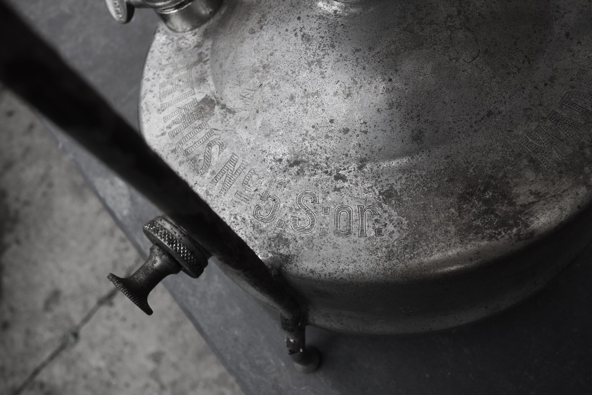

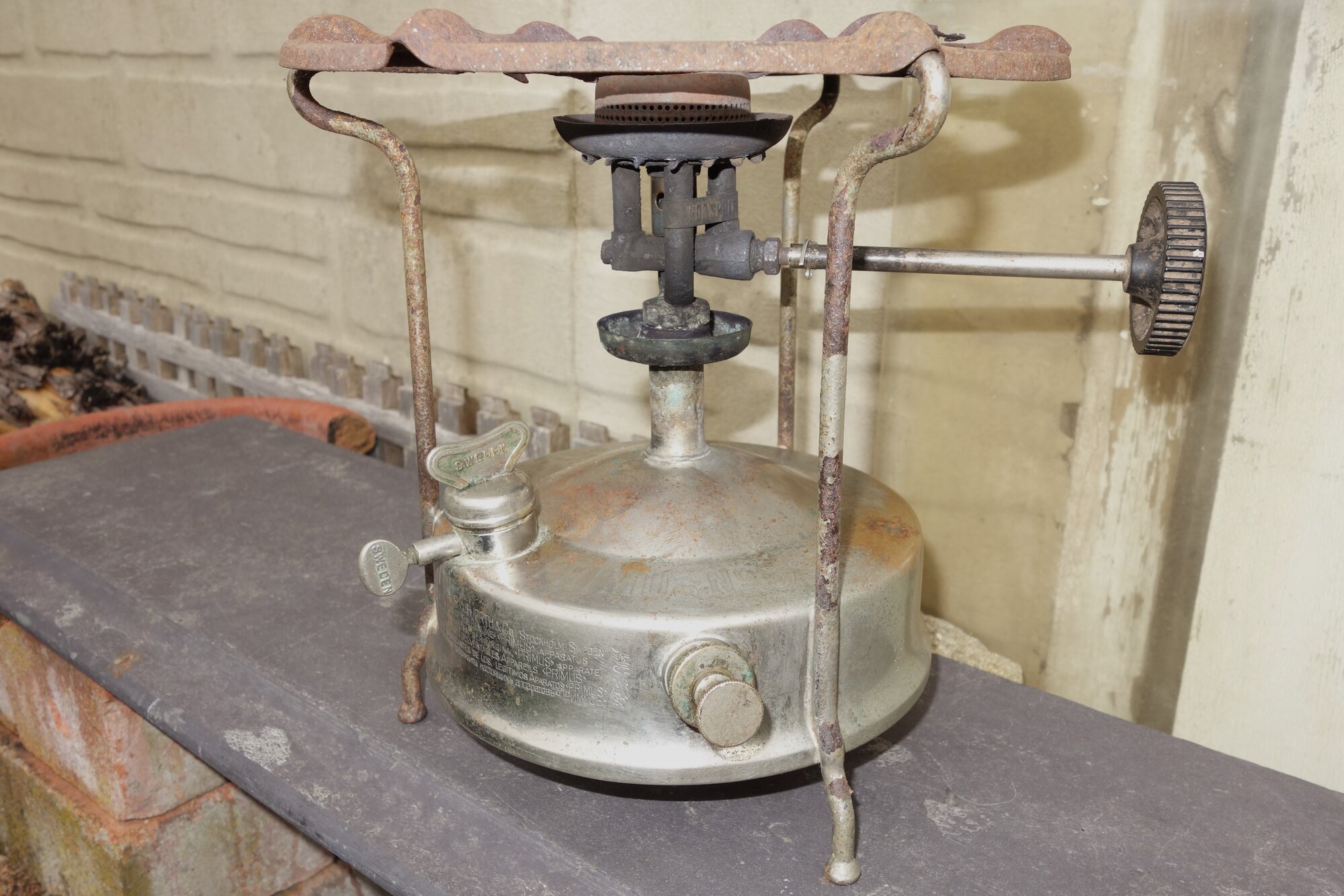

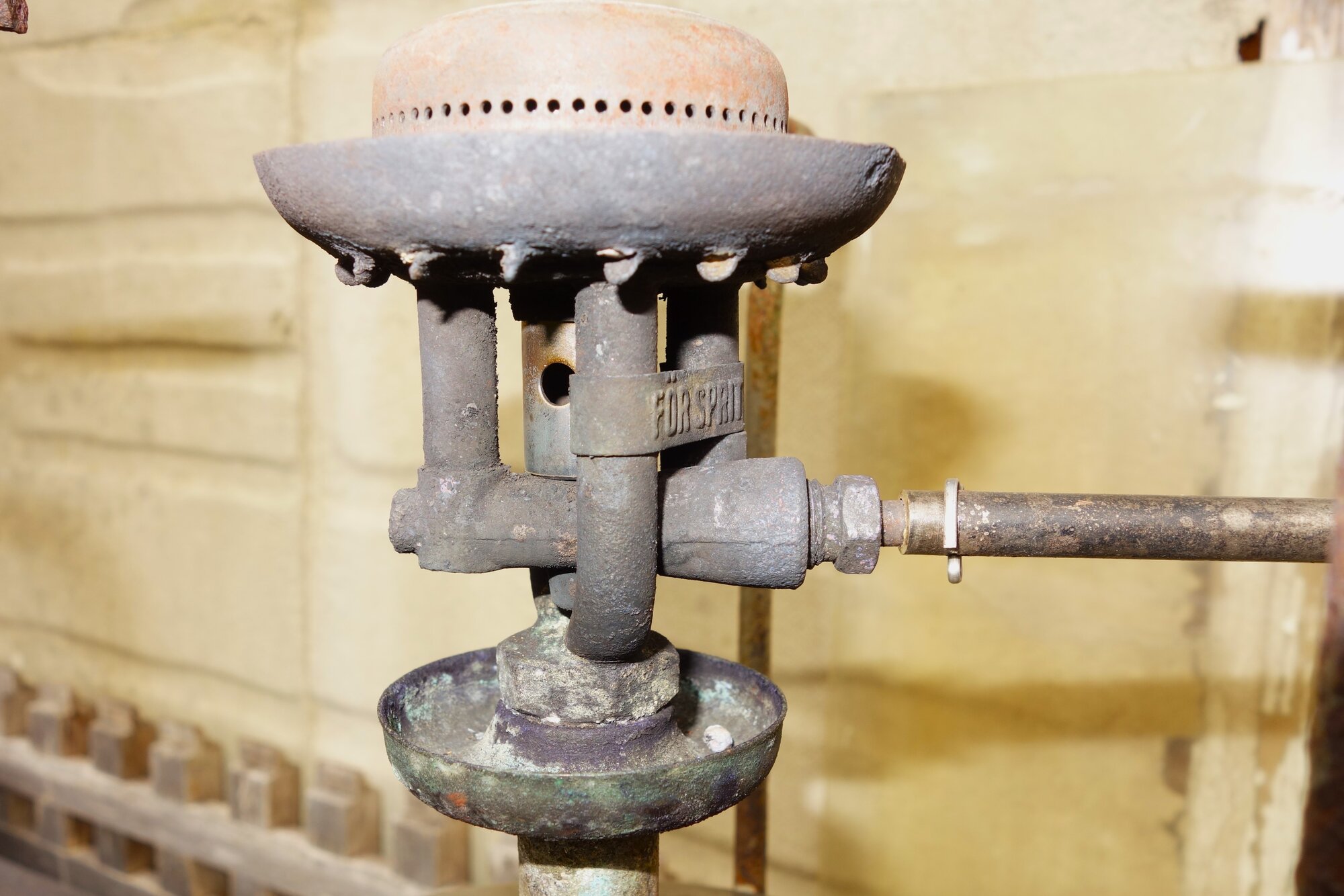

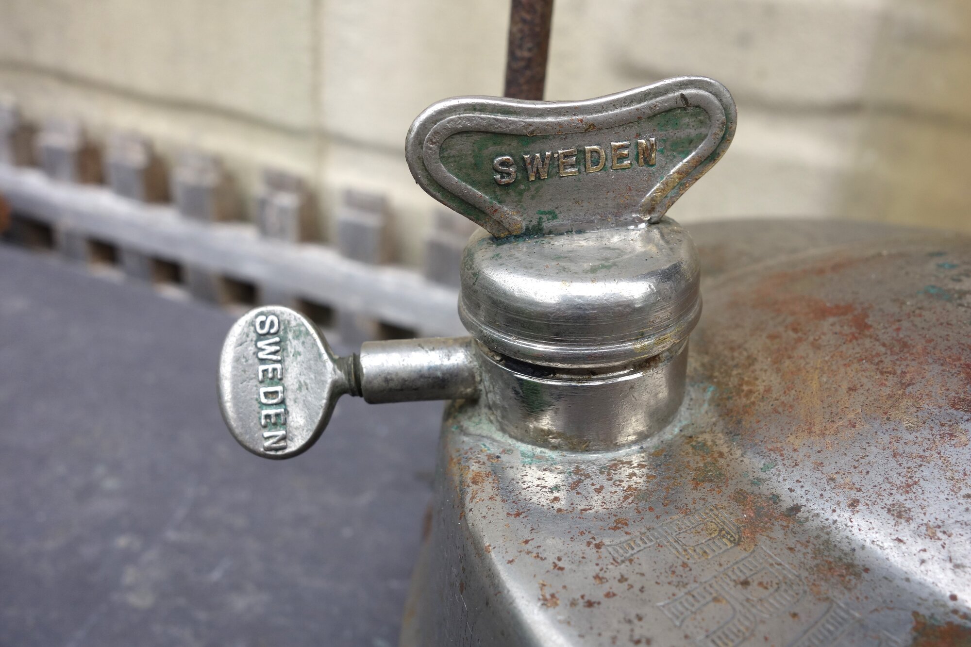

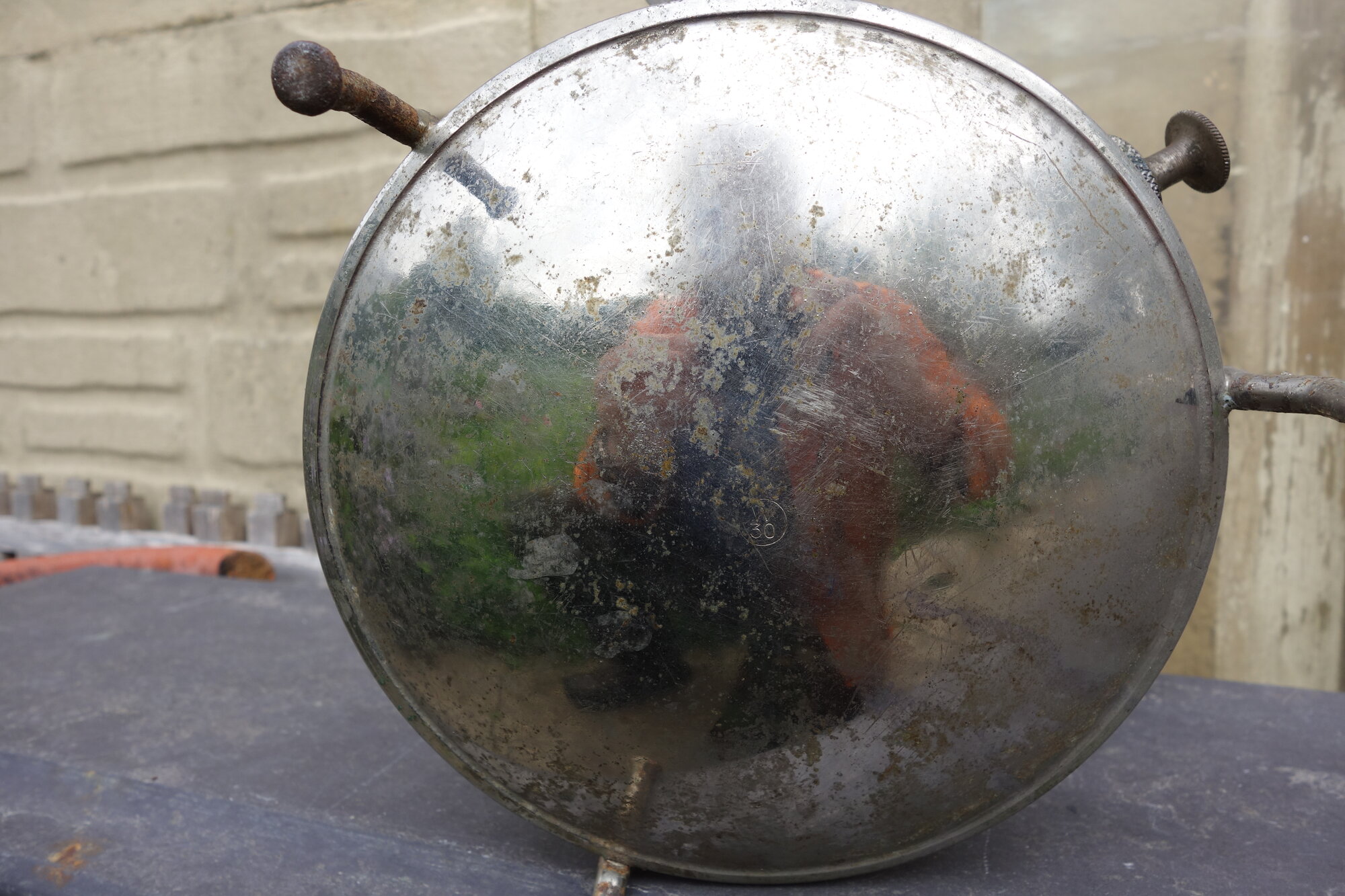

    This is a standard nickel plated Primus No.5Sor, date code 'W' for 1932, which would originally have been fitted with a basic No.5 silent burner.
    At some point during the 1940s, however, it was converted to alcohol fueling to offset the unreliability of paraffin supplies in Scandinavia during WW2. The conversion was achieved by changing the original basic silent burner for a specially configured regulated unit:

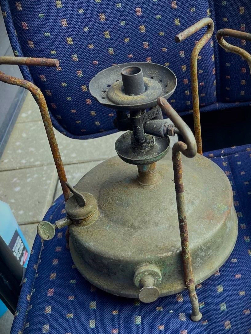

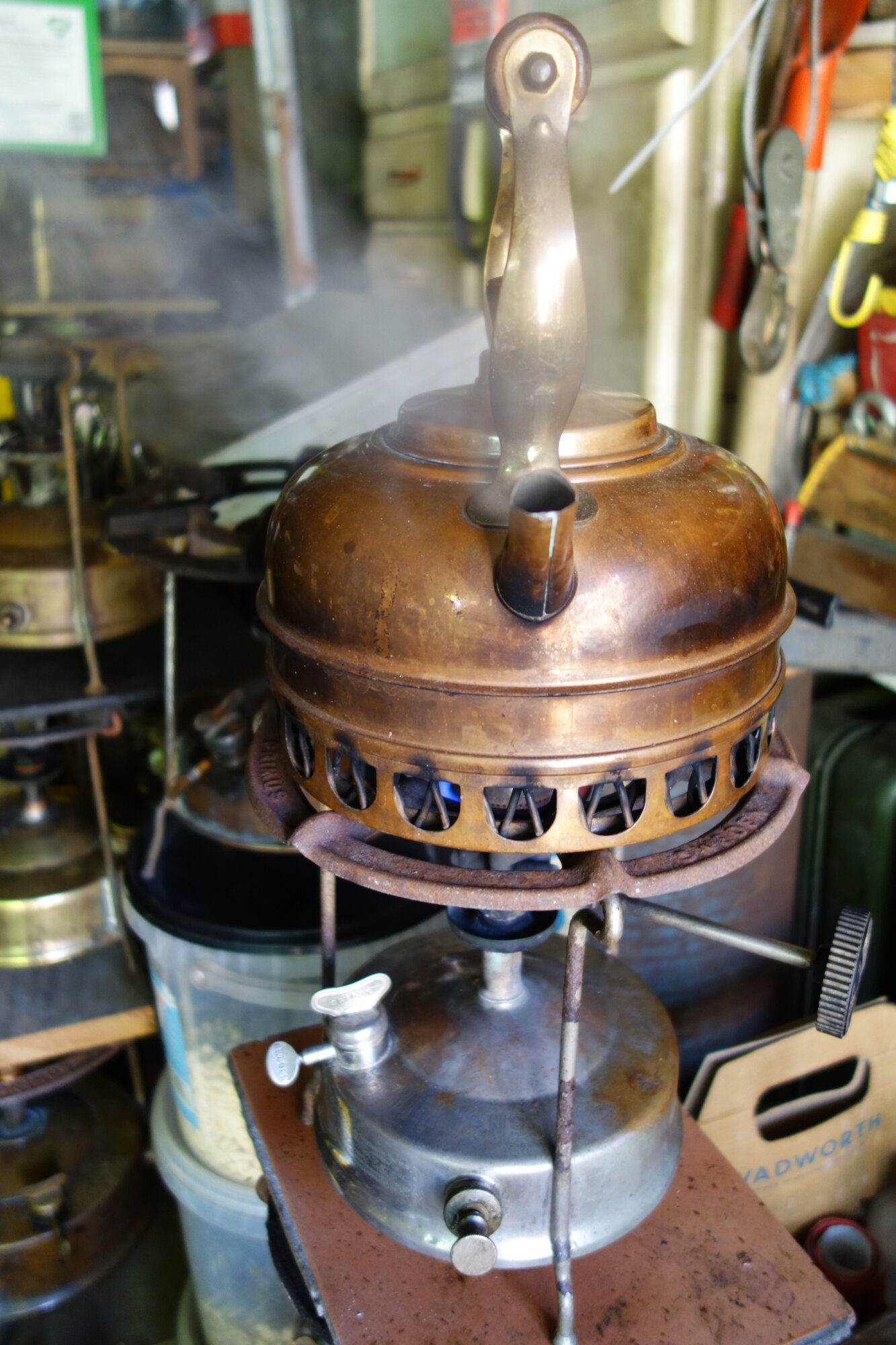

    But then getting it running was a different matter. At first it was impossible to achieve any sustained burn at all. The problem was soon identified from checking other CCS posts: there should have been a damping insert tube; it was missing (part 4418 in the diagram above). Thankfully that part was still available from Sweden. Even that wasn't the end of the saga, however, getting the right outer cap ended up being a process of trial and error.

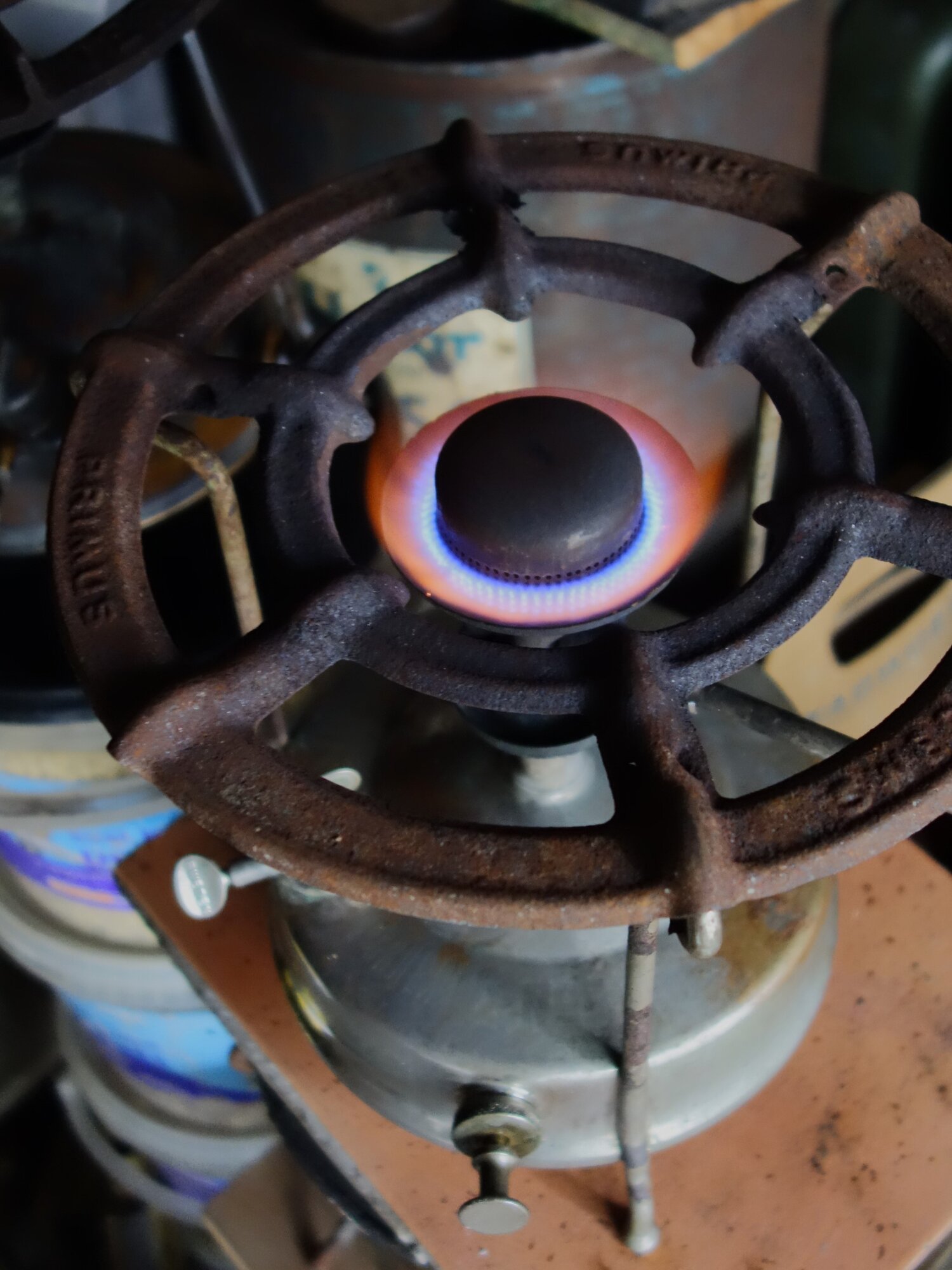

    A standard No.5 outer cap ought to have been an original fitting. But the results still weren't at all right, even after the damper was fitted:

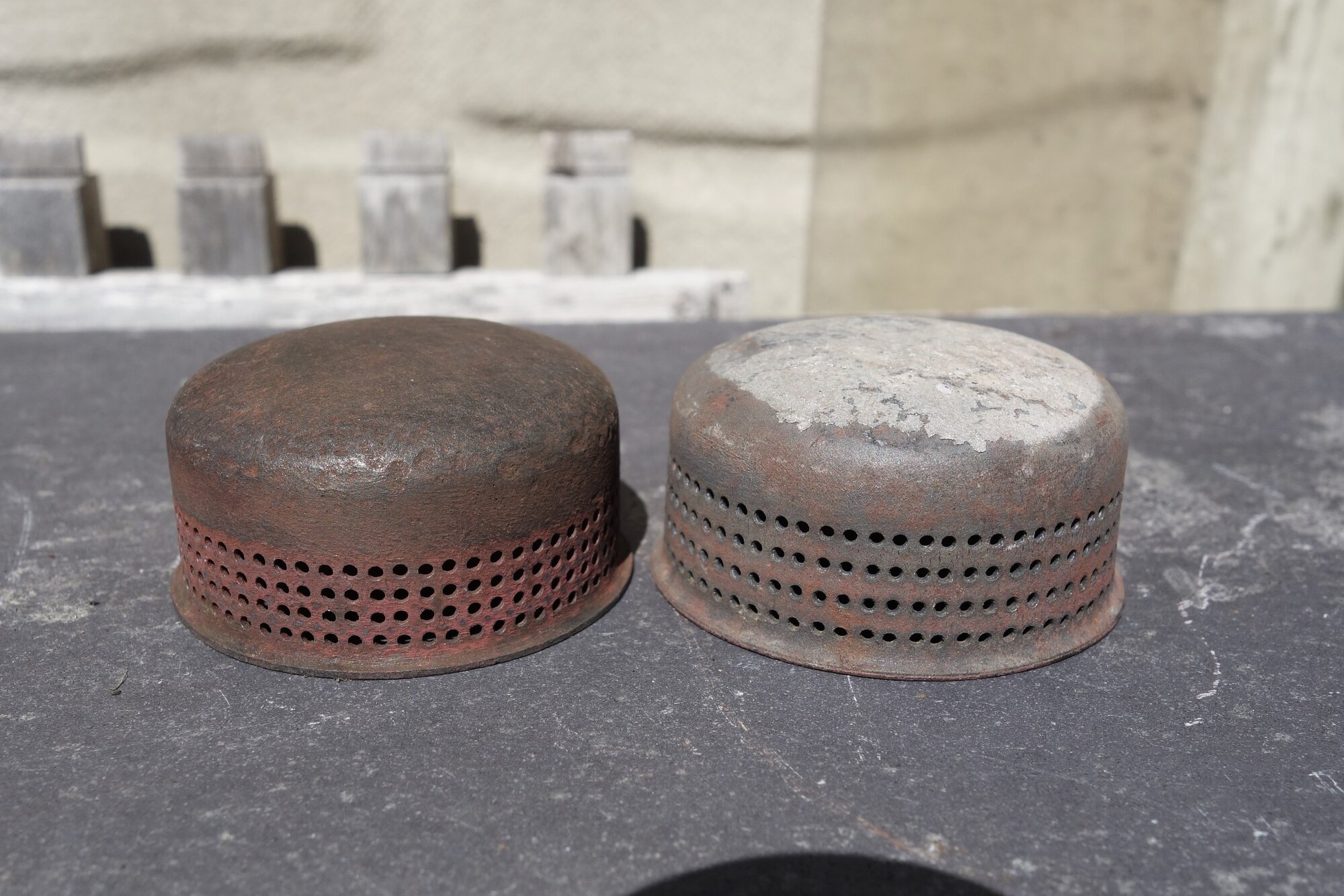

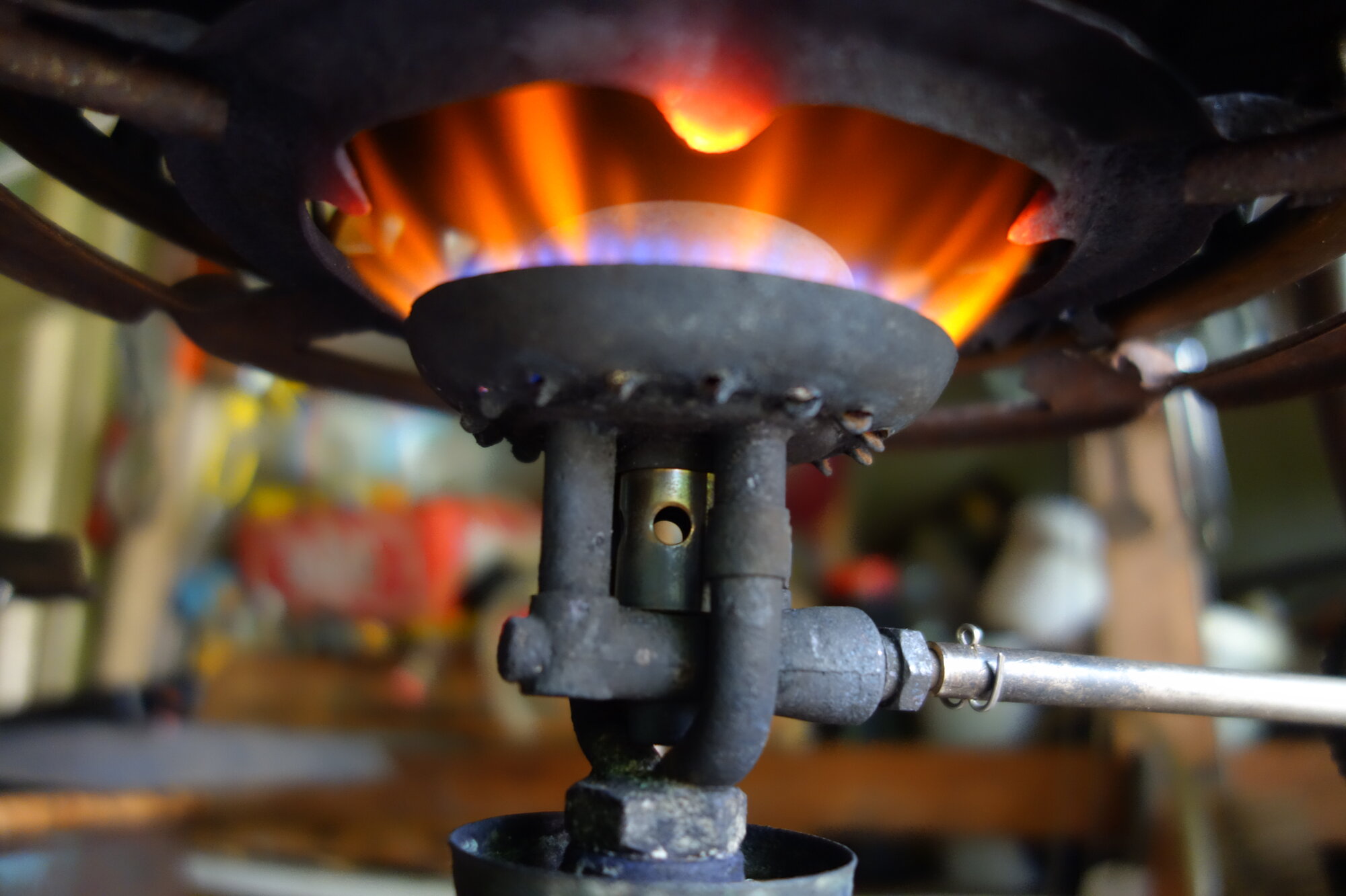

    I had 2 different No.5 hole patterns, both in 'Primus Metal', the more common version on the right, as shown used above, the other with a lower set of tighter smaller outlet holes:

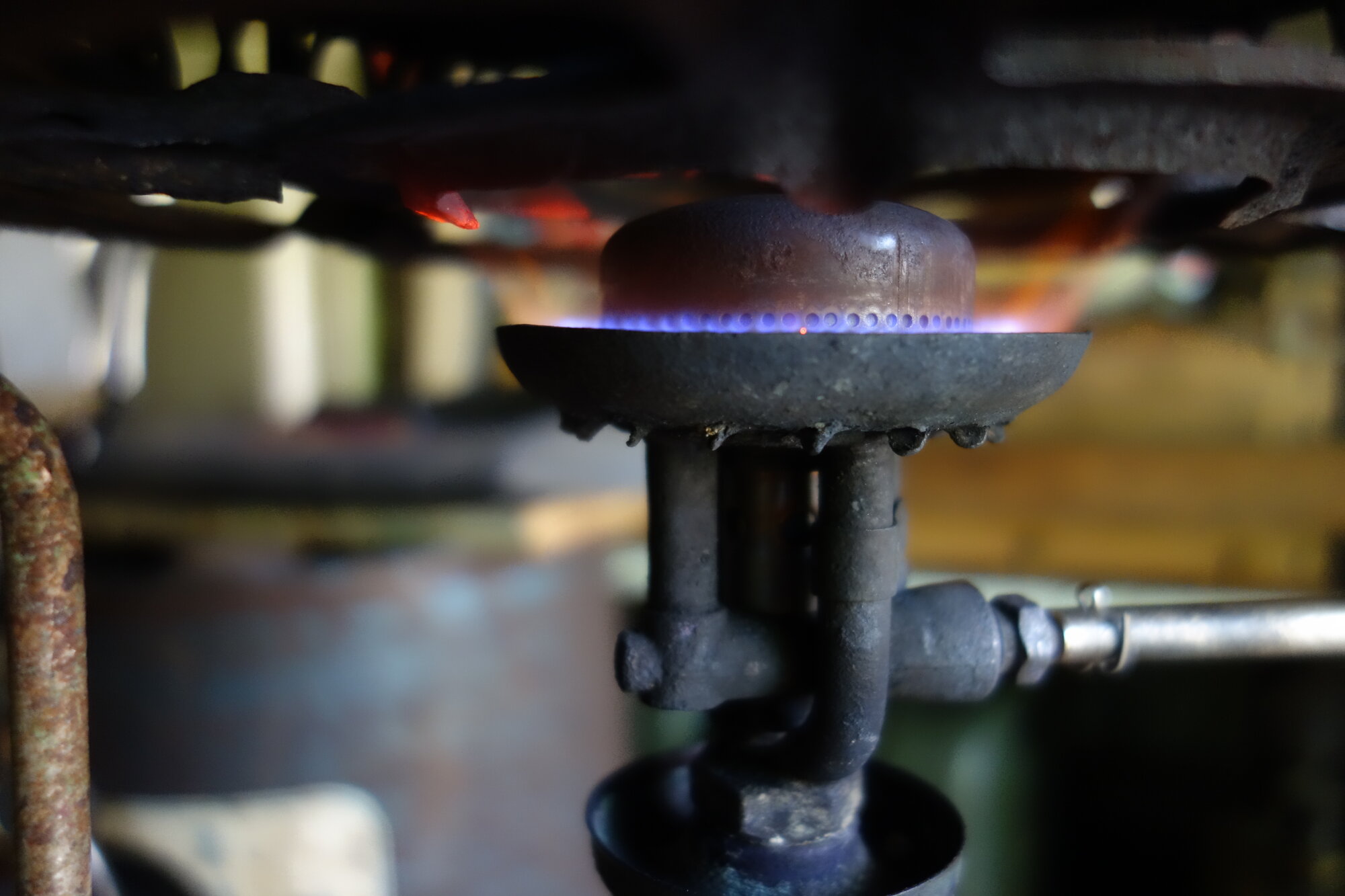

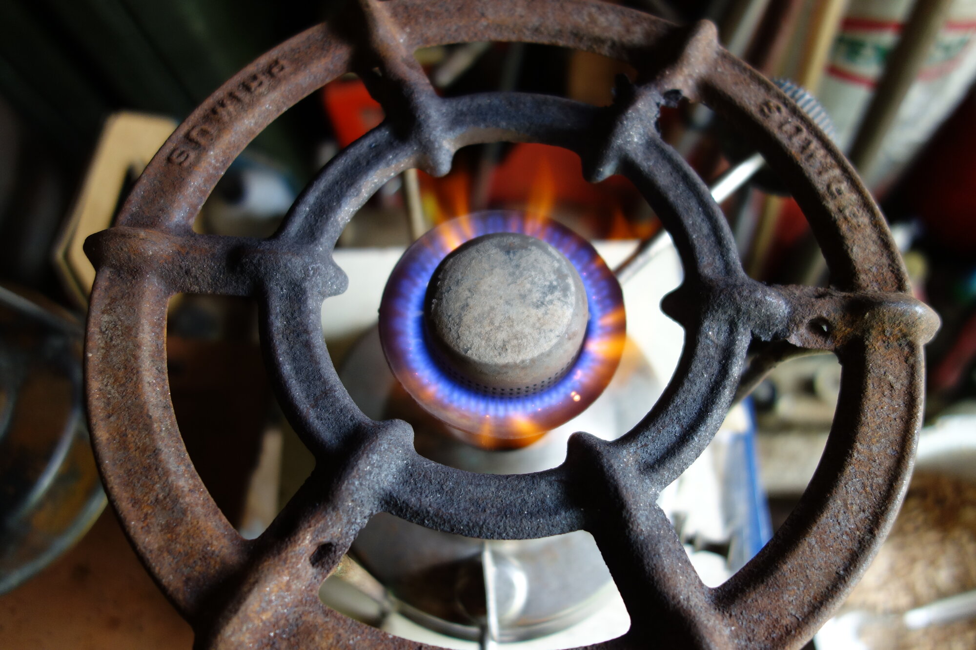

    Switching to the tighter hole configuration made a spectacular difference:
    So happy now, well chuffed at having finally got a genuine WW2 alcohol burner running nicely:content:
