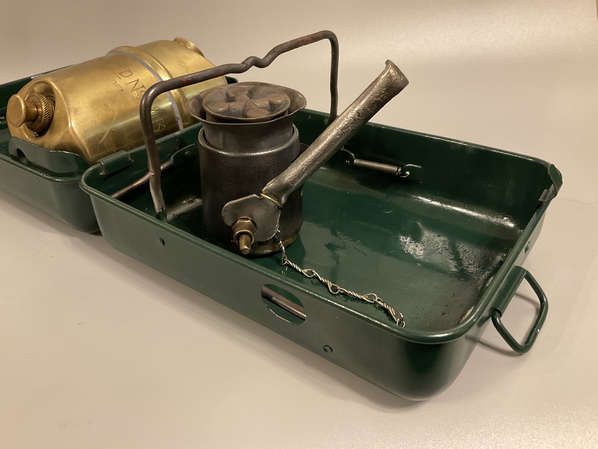

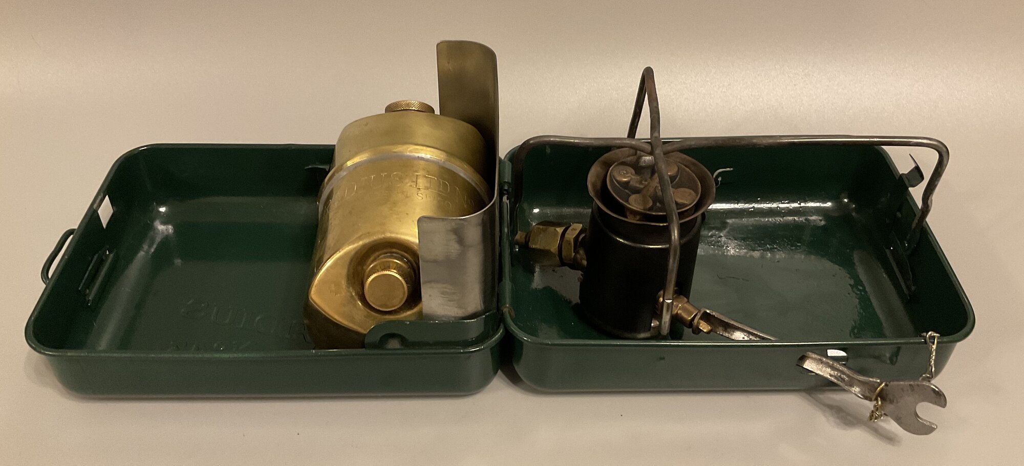

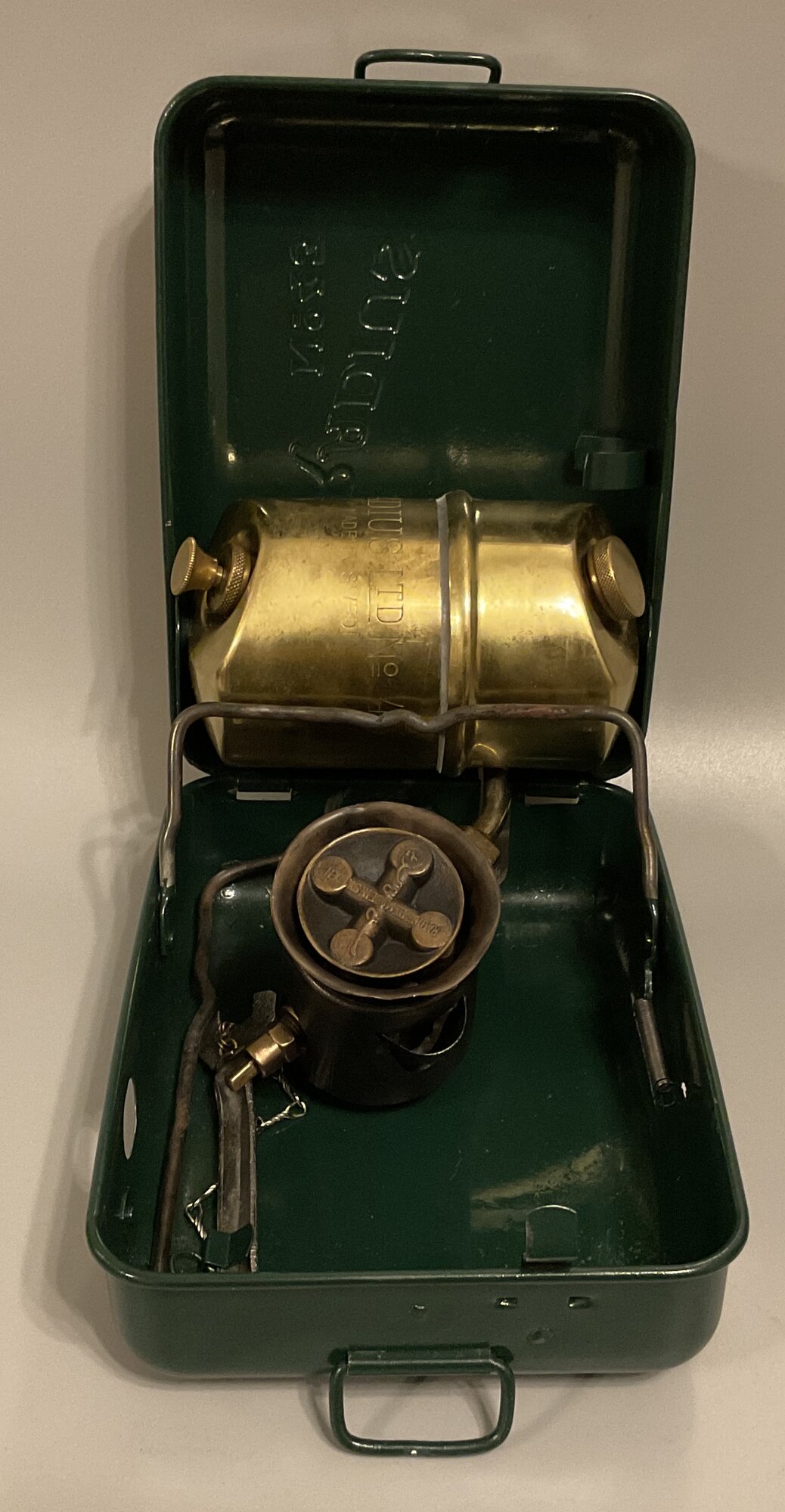

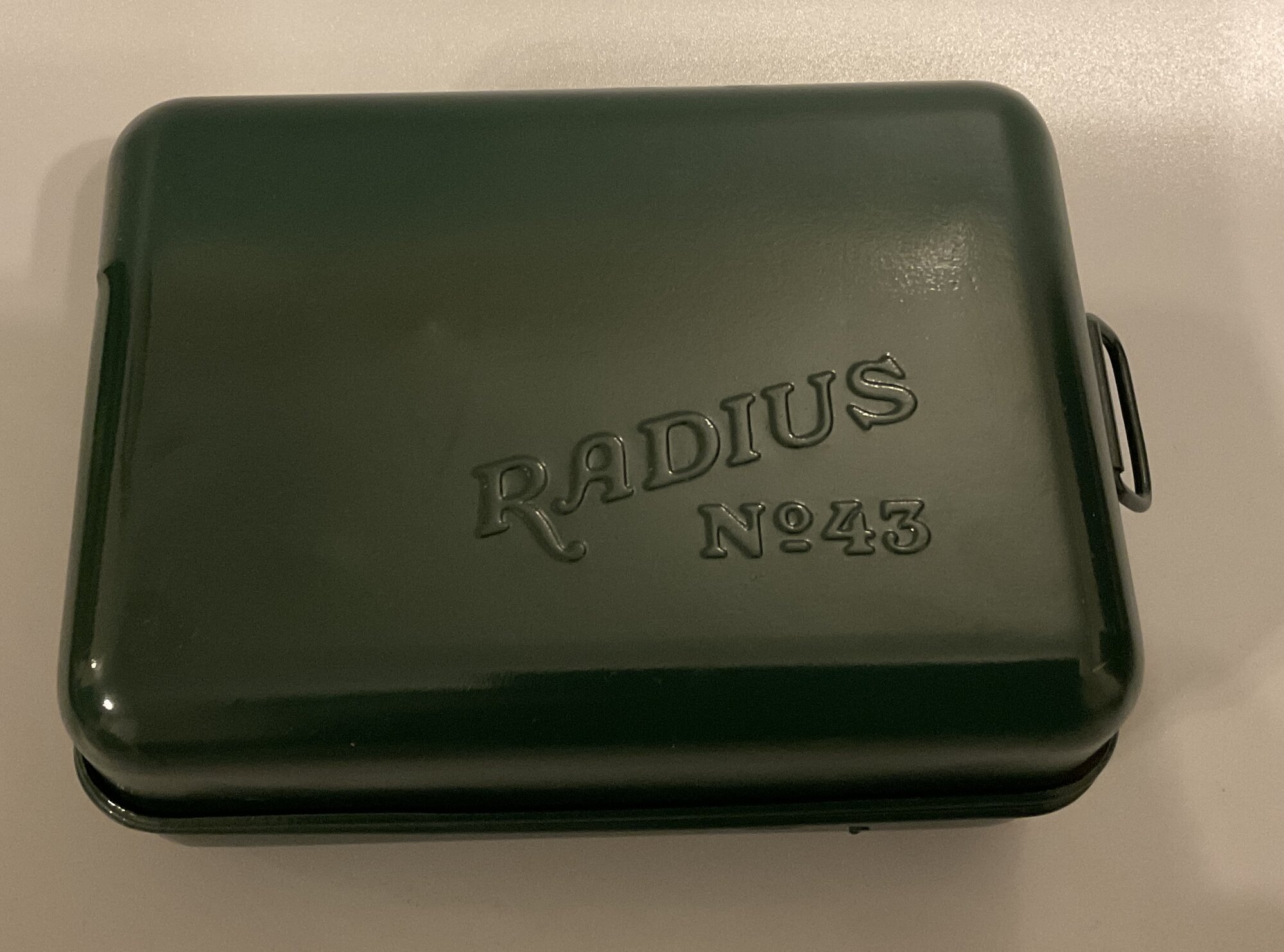

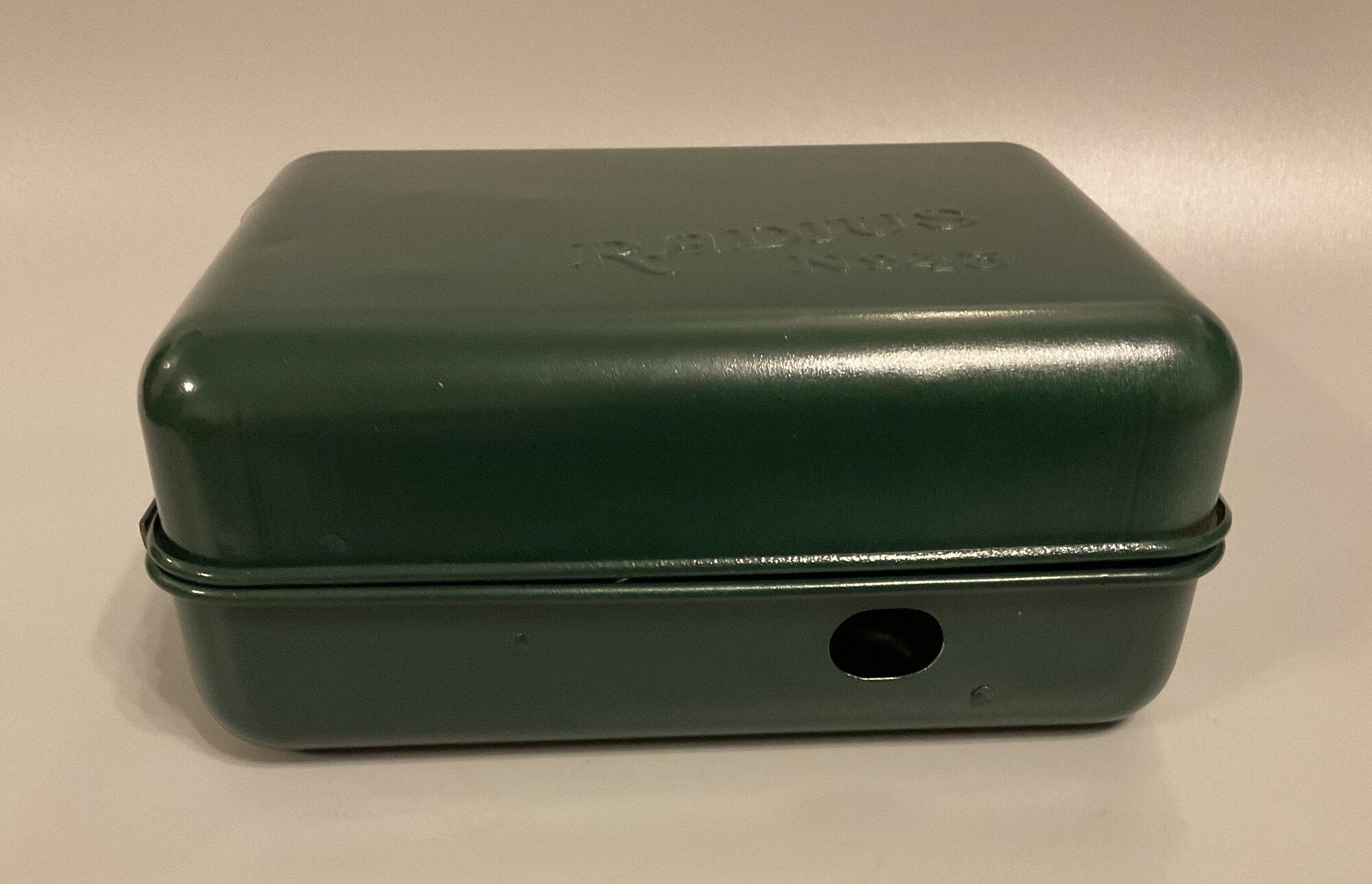

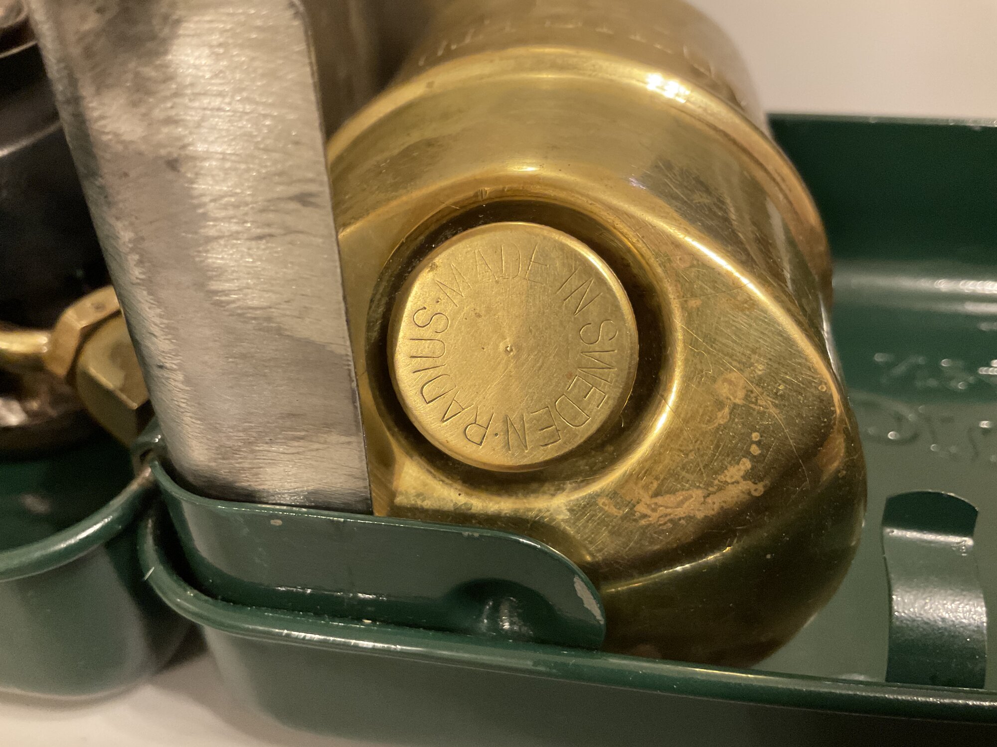

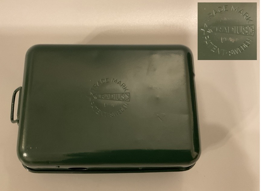

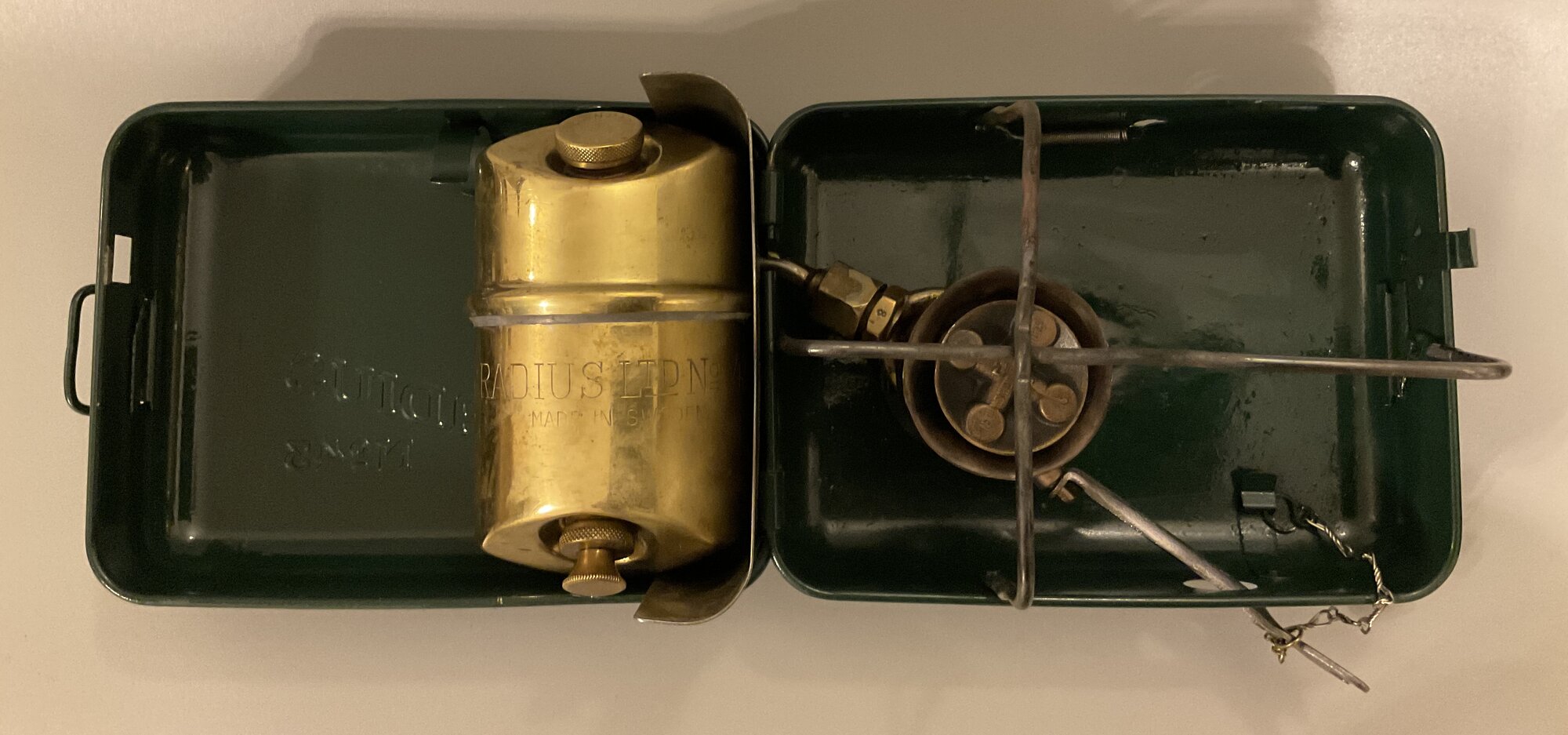

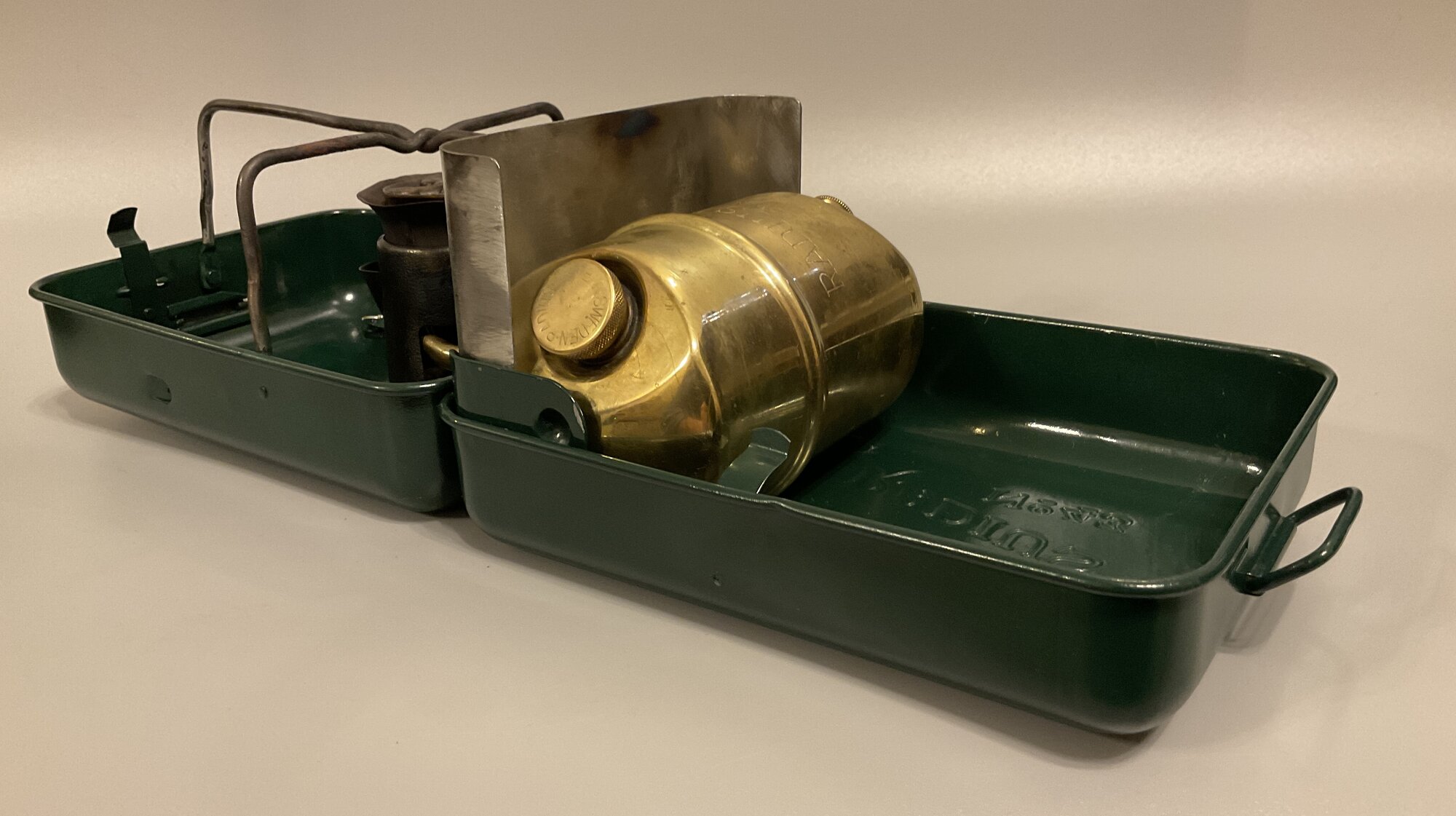

    On acquiring this Radius No.43 kerosene/paraffin roarer, areas of the case were in such a corroded state, both inside and out, that in order to save it, there was no option other than to strip the case back to bare metal (which had fortunately not perforated). Following corrosion removal, heat resistant filler was then applied and sanded down to bring the case back to a condition whereby it could then be resprayed. Unfortunately, no photos of this process are to hand.

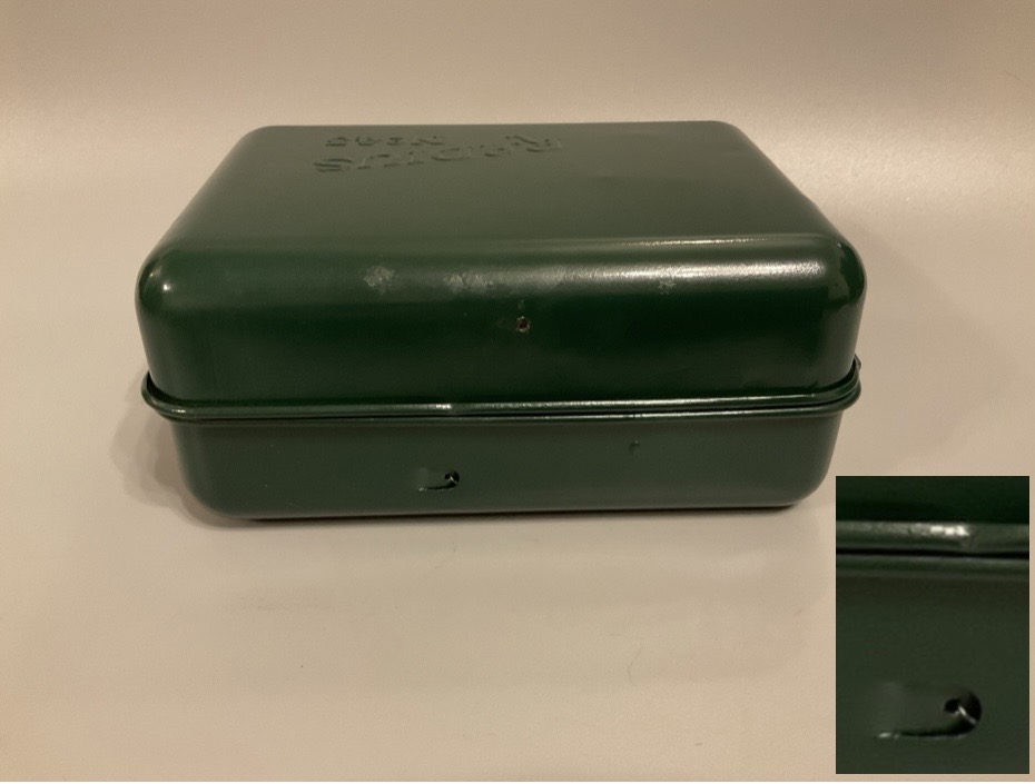

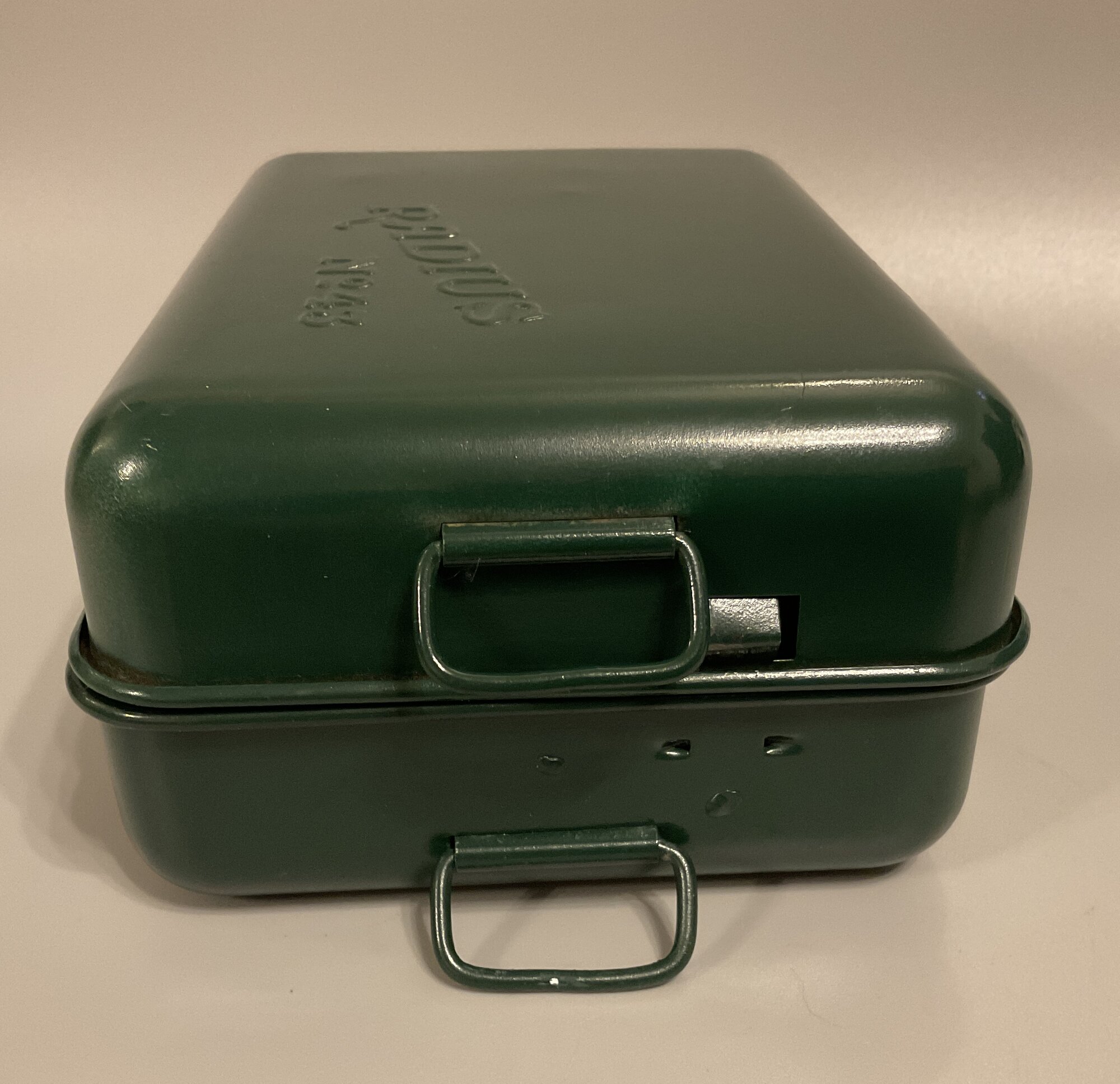

    Twin carry handles and the ‘push-in to open’ catch on the front of the case.
    Hole for the control key.

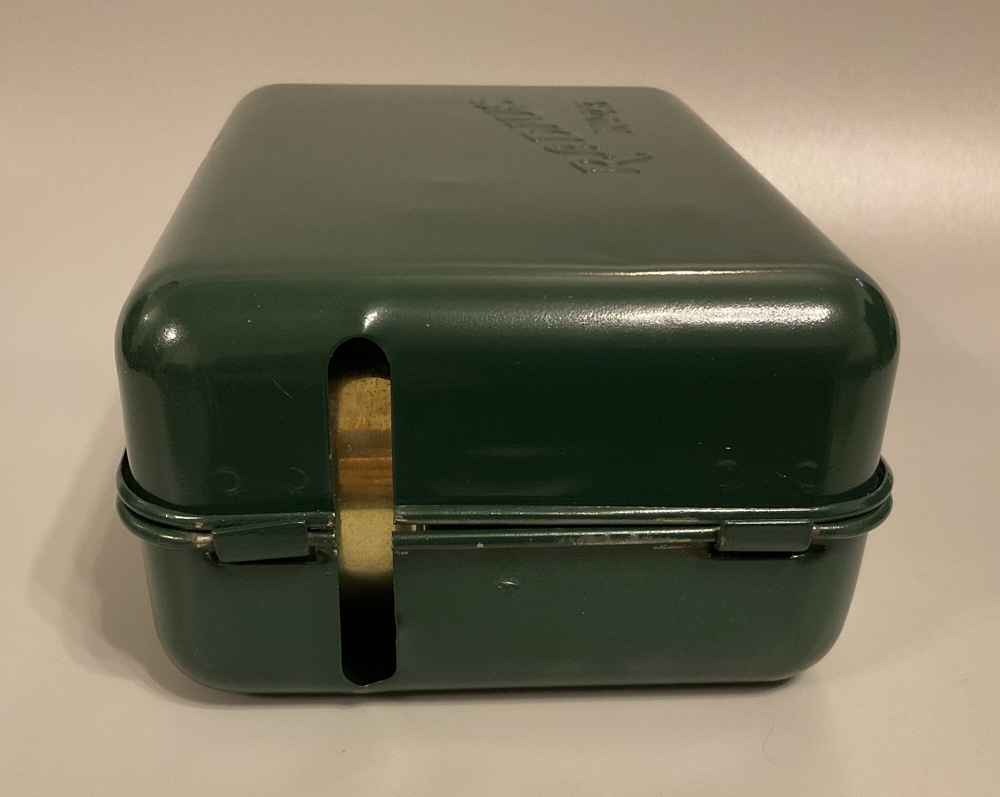

    The opening in the upper and lower parts of the rear of the case is to allow the fuel supply pipe to slot into, when the case is opened.

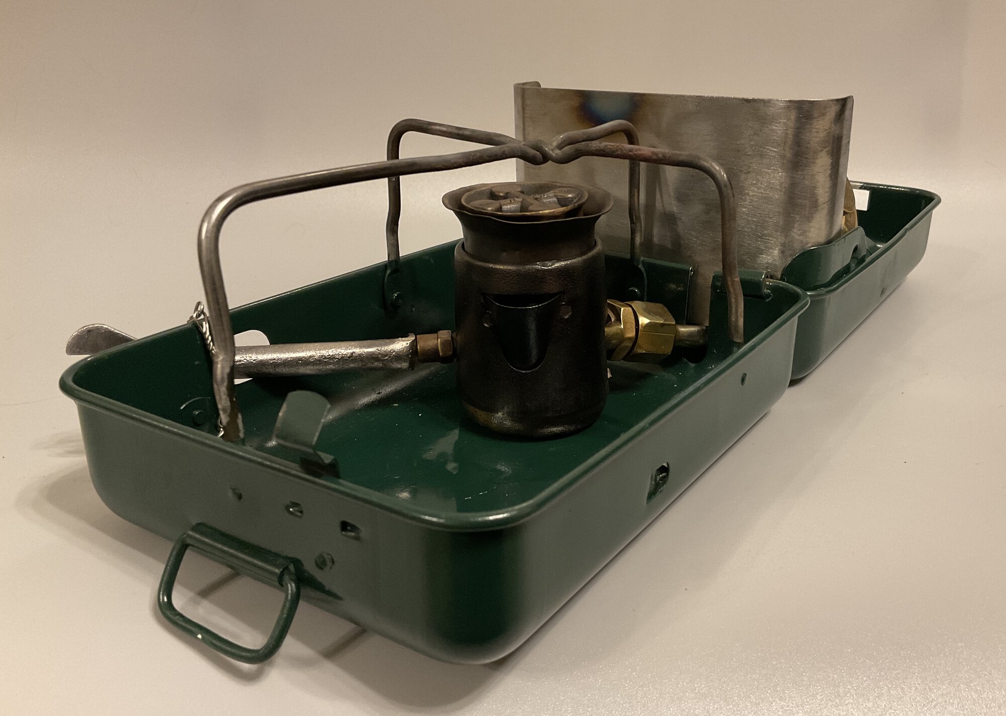

    Radius, mounted one end of the pot support spring (the other end attaching to the right-hand lateral pot support arm) on this partially stamped out ‘tab’ in this lower section of the case.

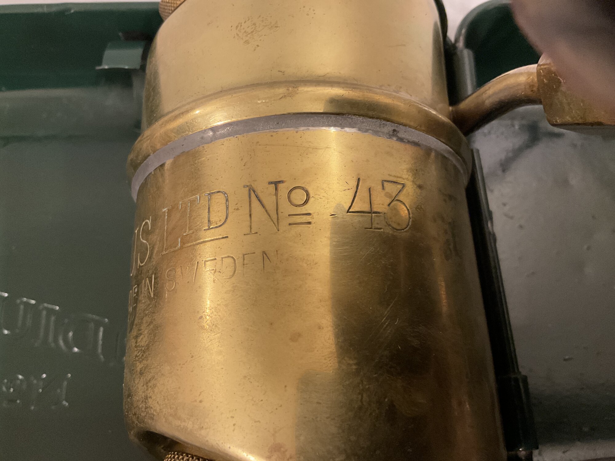

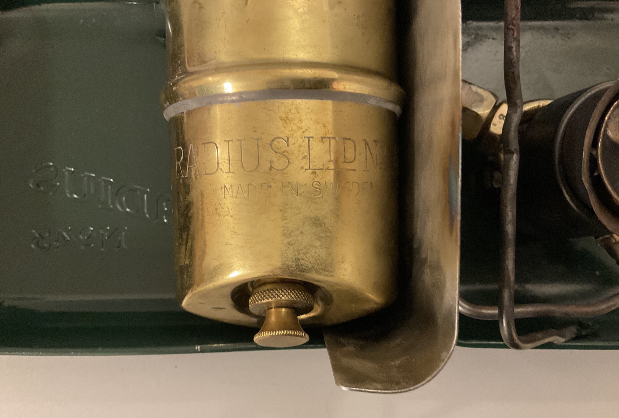

    The (pre-1938) Radius ‘Shooting Star’ is stamped on the underside of the case. However, the tank is stamped with the (post-1938) ‘Radius Ltd’. Therefore, this No.43 was manufactured after 1938.

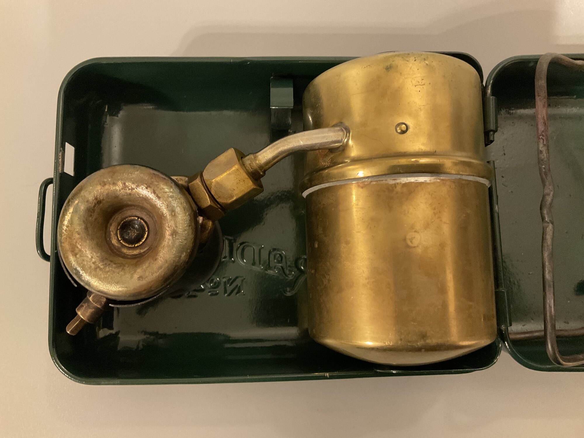

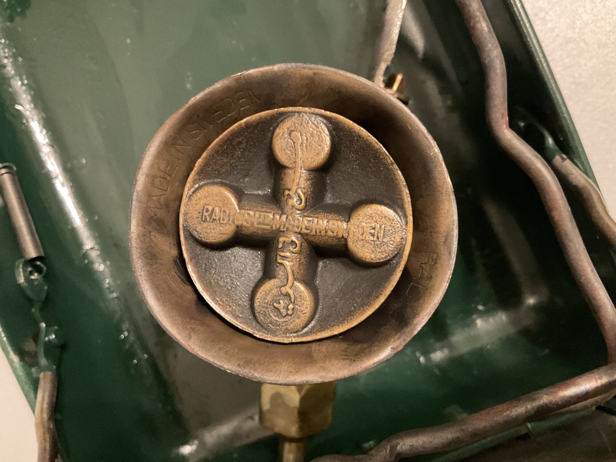

    Overhead view shows the burner and corresponding pot support offset.
    Tank stamping.
    Underside view of the tank and fuel supply pipe to the burner.
    Burner and flame spreader stampings.
    Flame spreader locking tabs.
    Filler cap stamping.

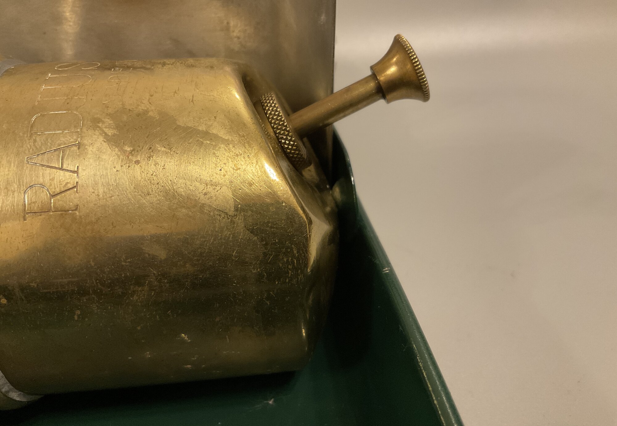

    Pump knob and cap knurling pattern.
    The control key can be used to tighten the stuffing box nut.
    More photo’s to follow…

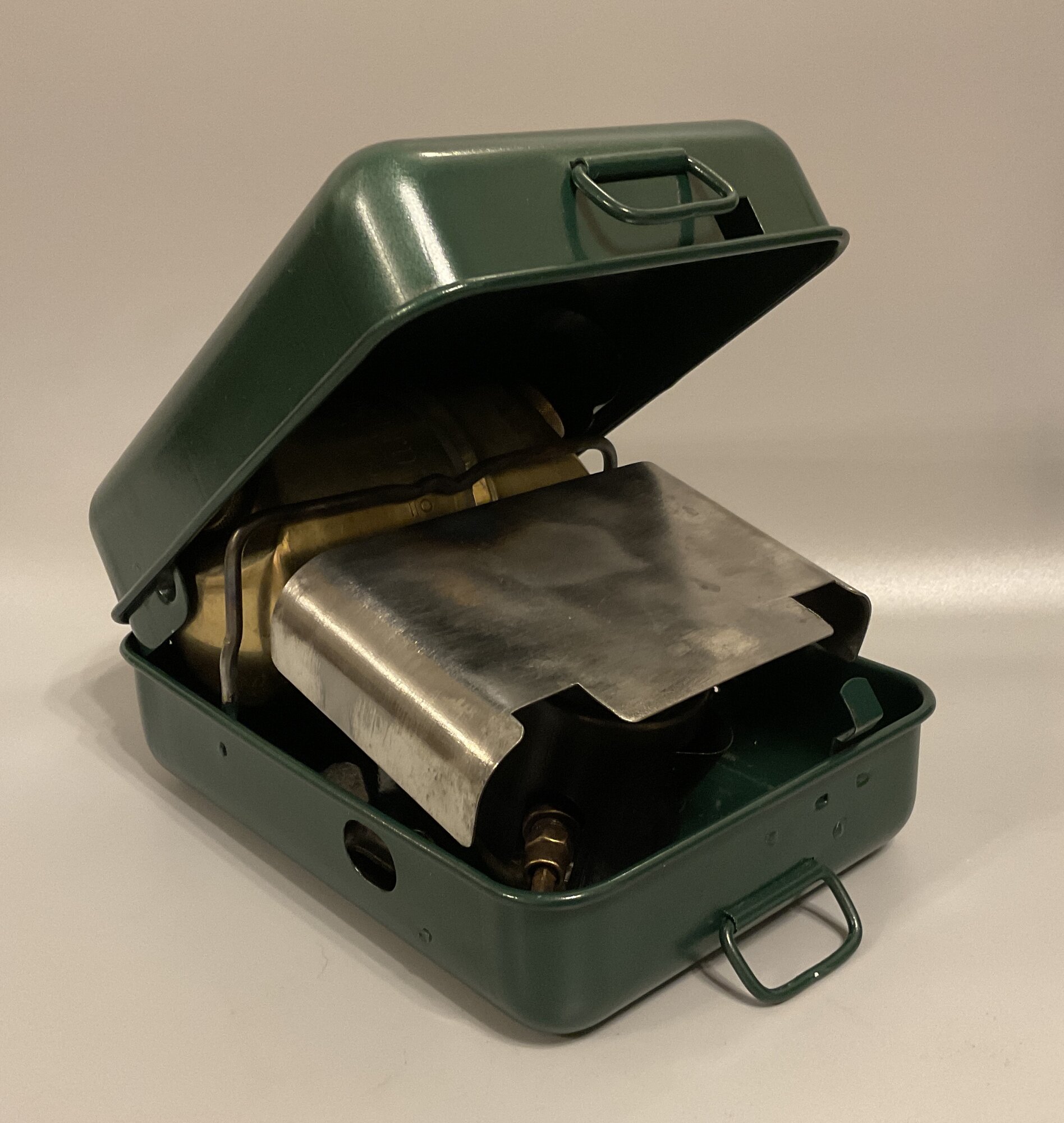

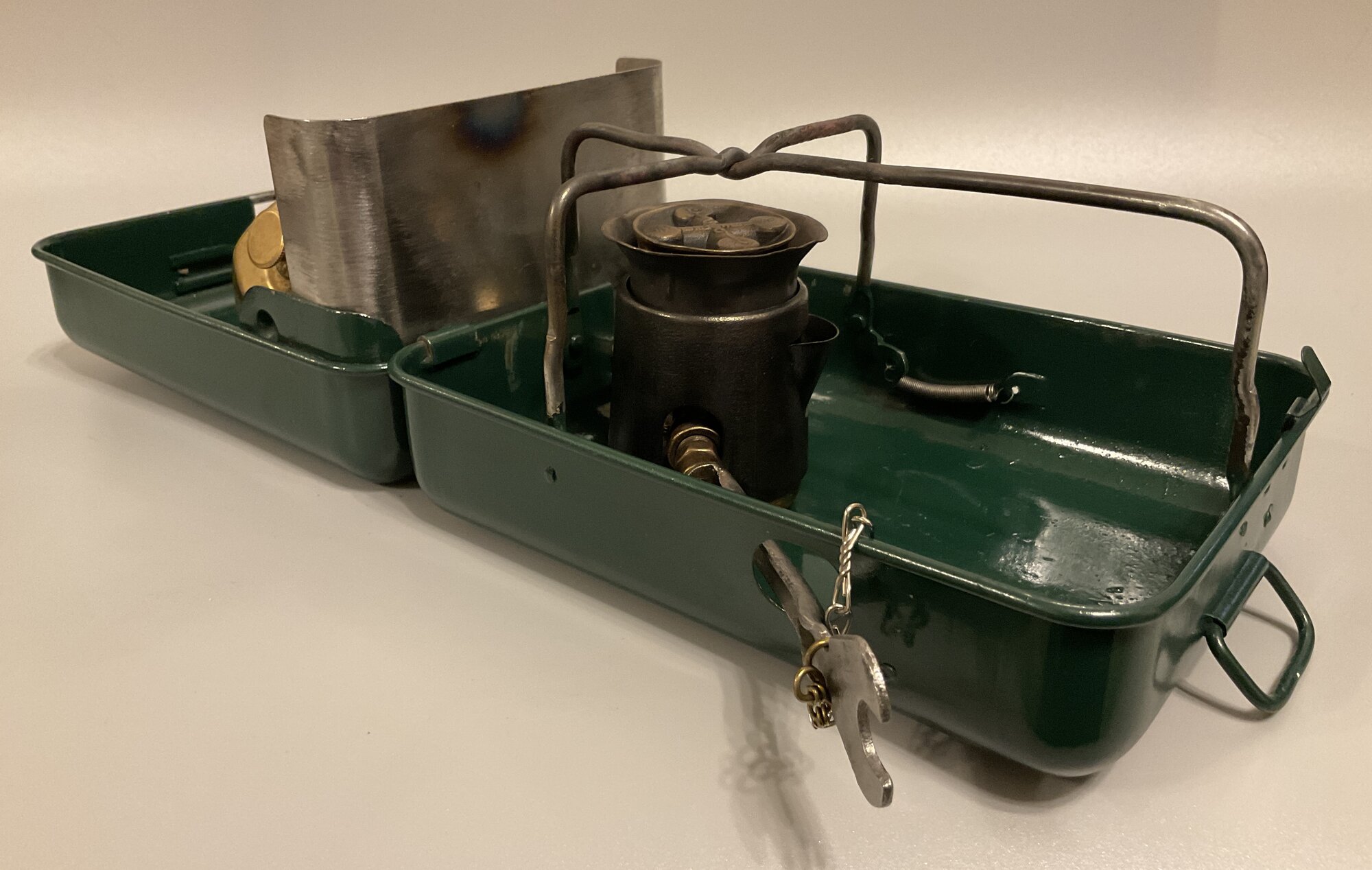

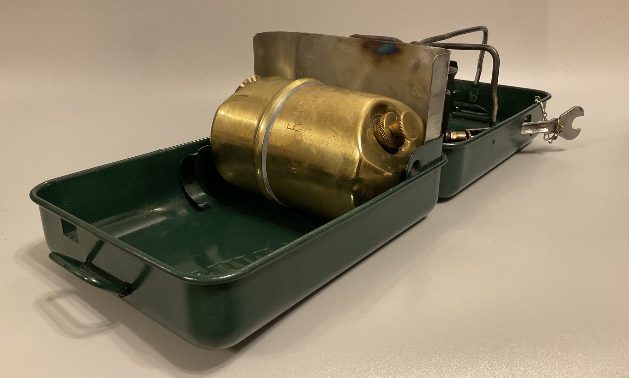

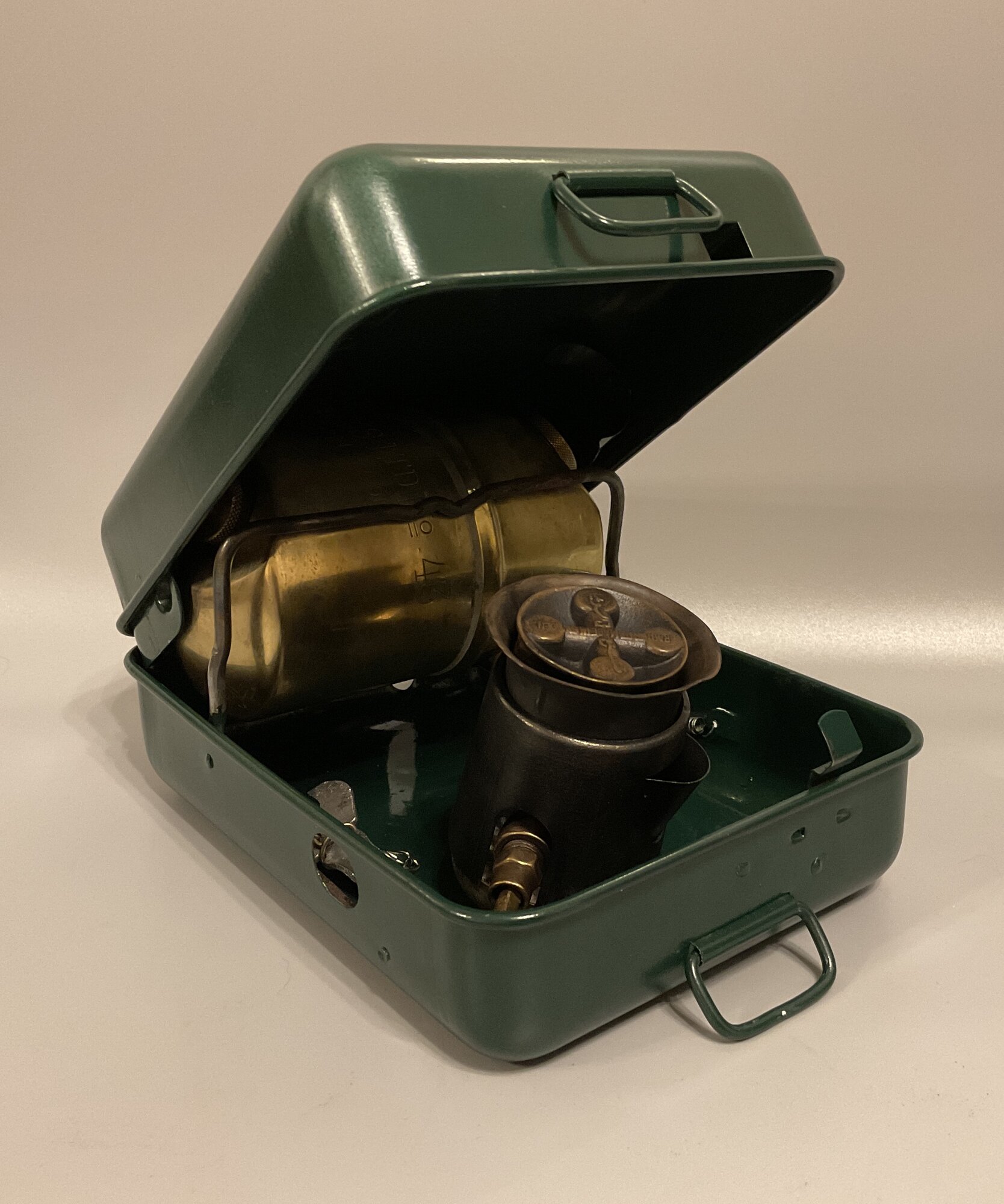

    Case closure…

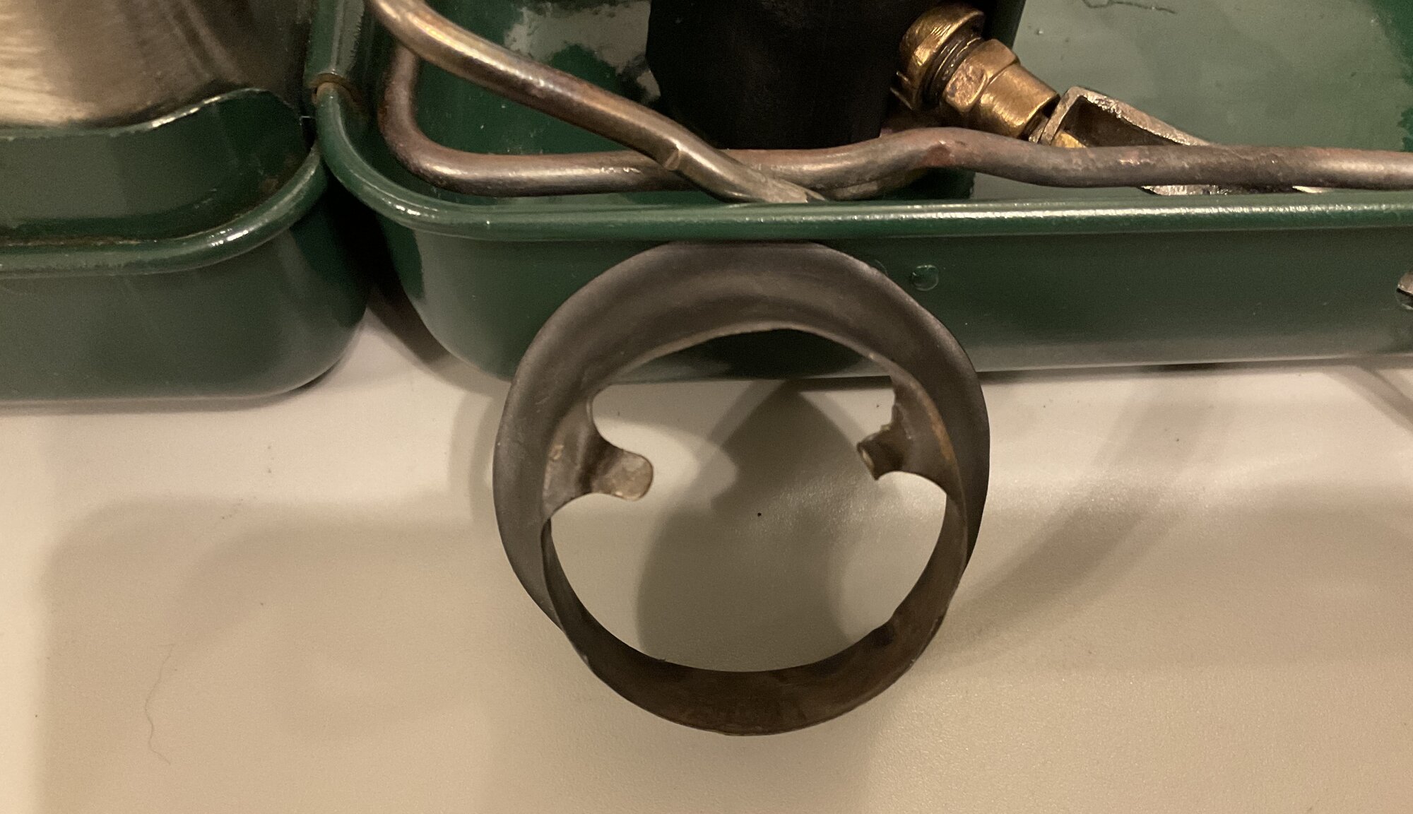

    The heat-shield is placed in this position just prior to closing the lid.
    As viewed - the heat-shield’s right-hand cut-out straddles the fuel supply pipe when the heat-shield slotted into place.

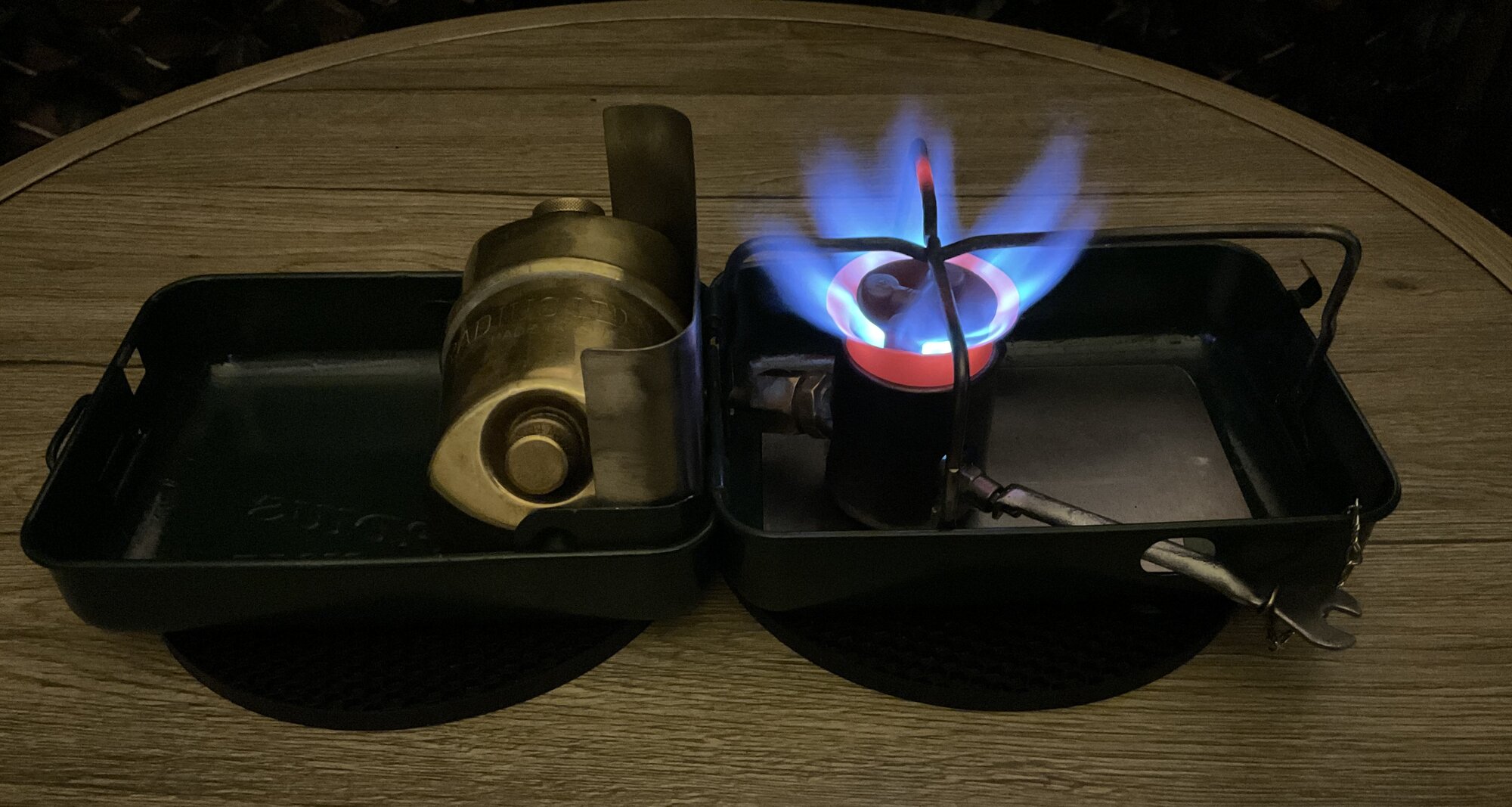

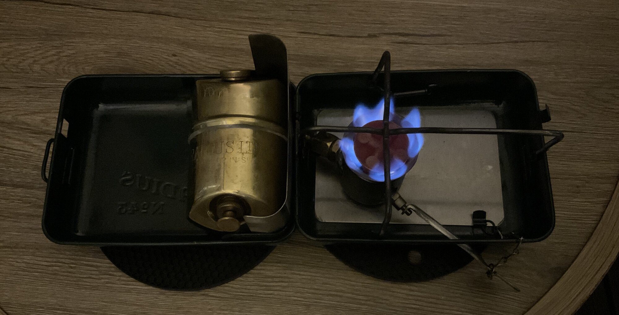

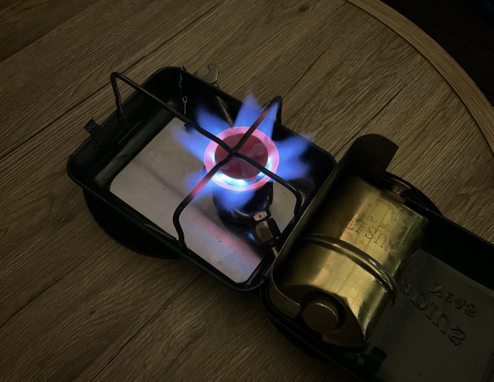

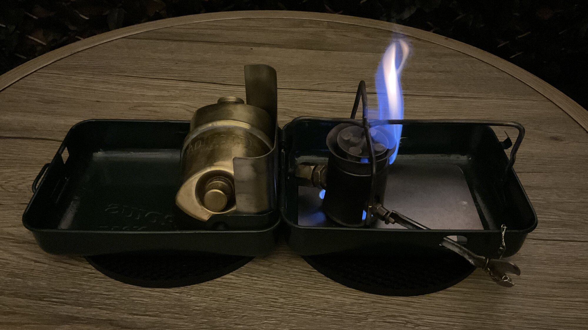

    Pre-heat.
    A sheet of 430 grade (0.9mm) stainless steel is fitted below the burner to act as a heat deflector.
    Simmer.
