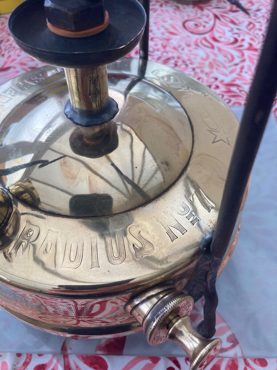

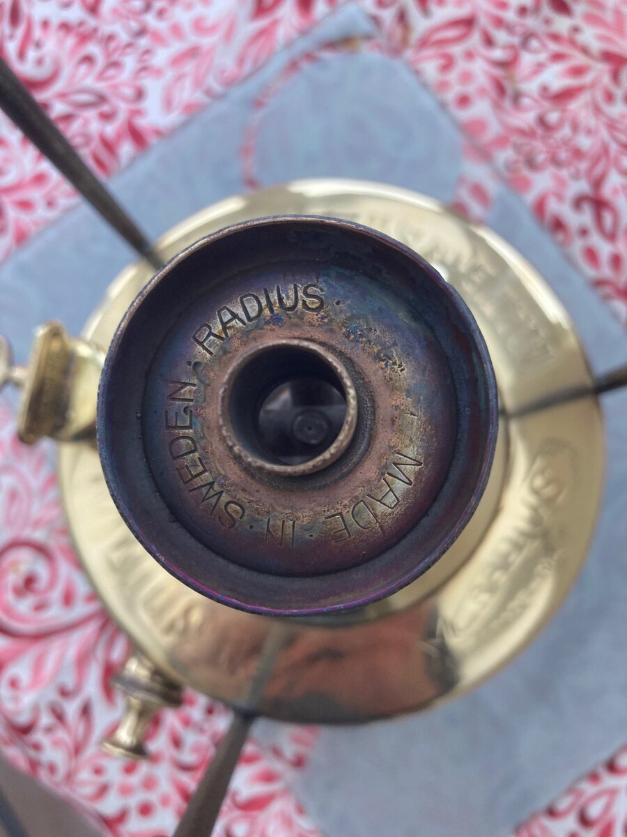

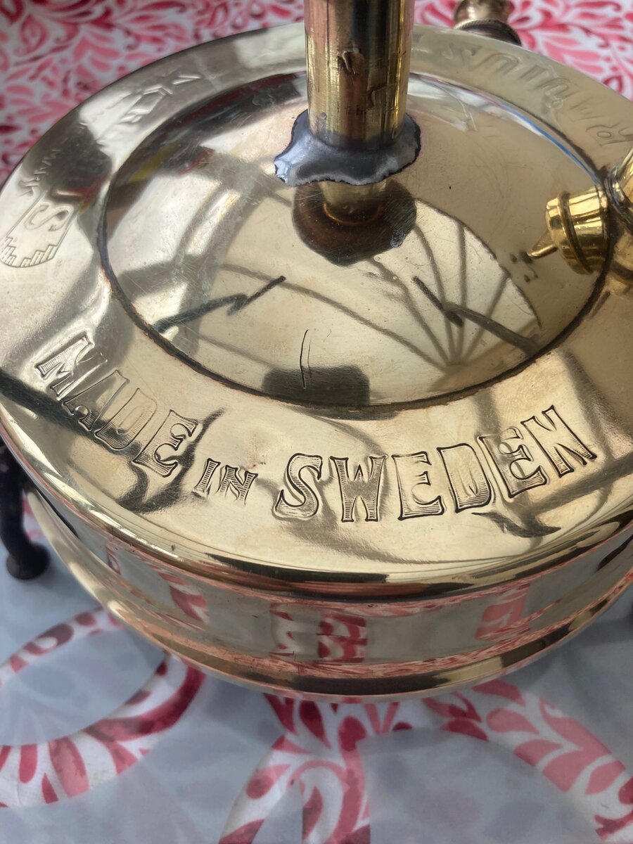

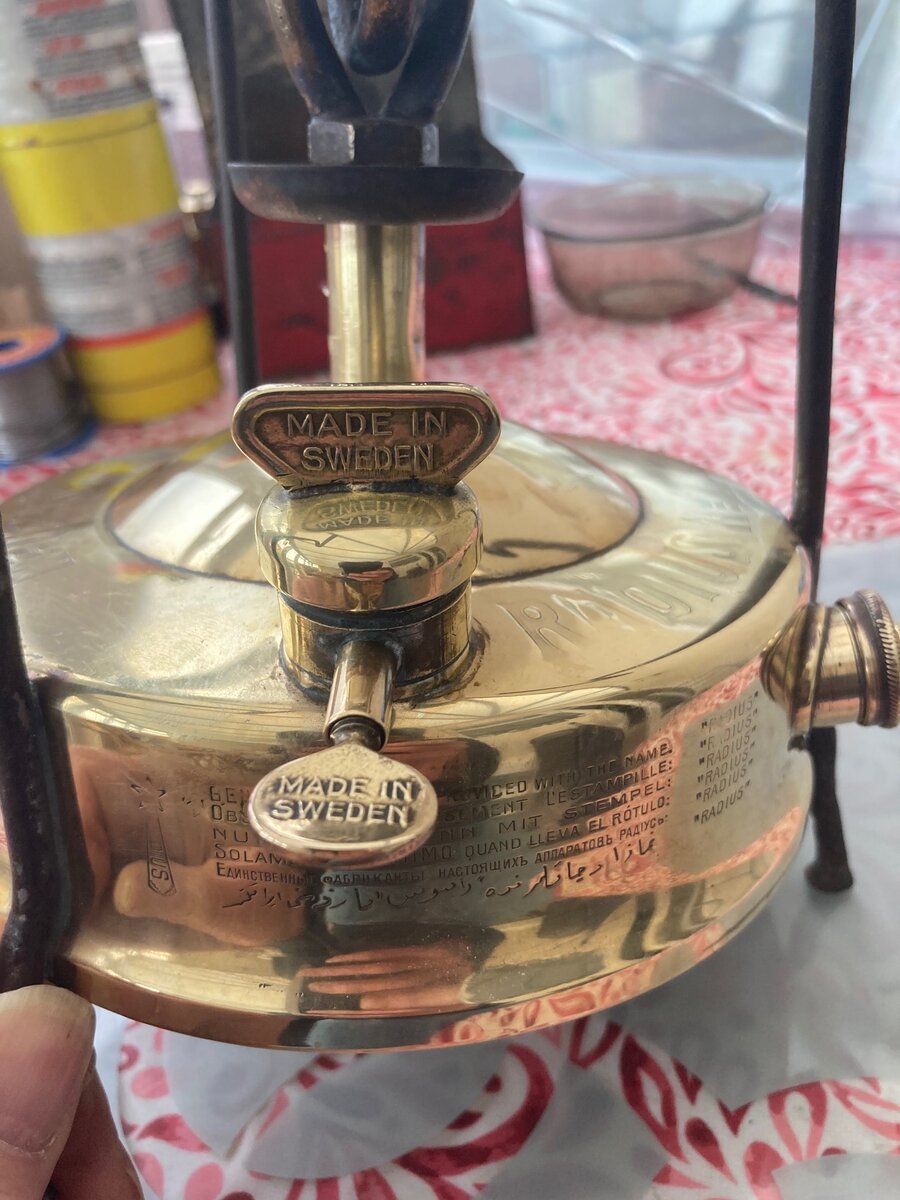

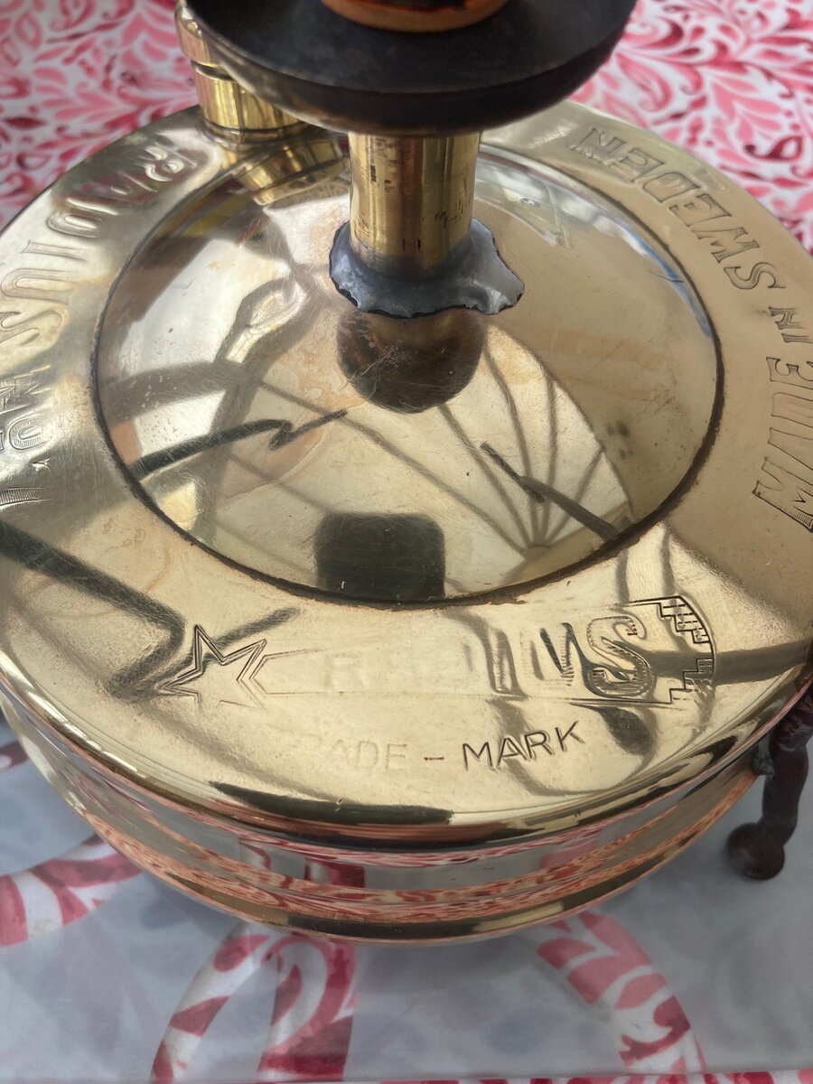

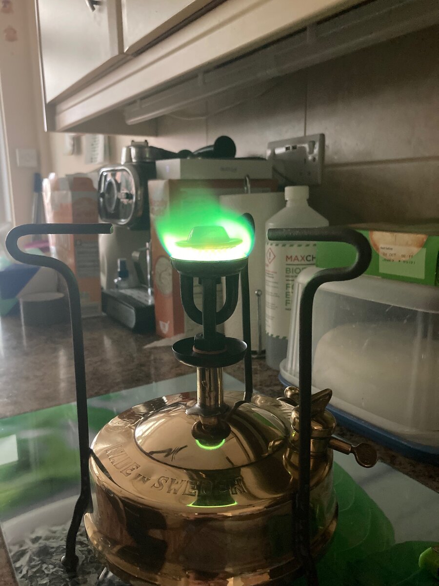

    After a clean, new seals, had to removed saw dust from in the tank and down the pump tube ](*,)

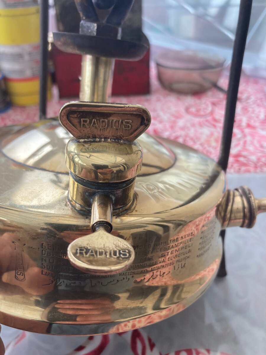

    The font is a bit banged up and the leg has been resoldered at some time along with the burner riser.
    IMG_2755.jpg IMG_2756.jpg IMG_2757.jpg IMG_2758.jpg IMG_2759.jpg IMG_2760.jpg

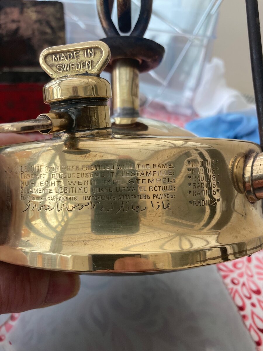

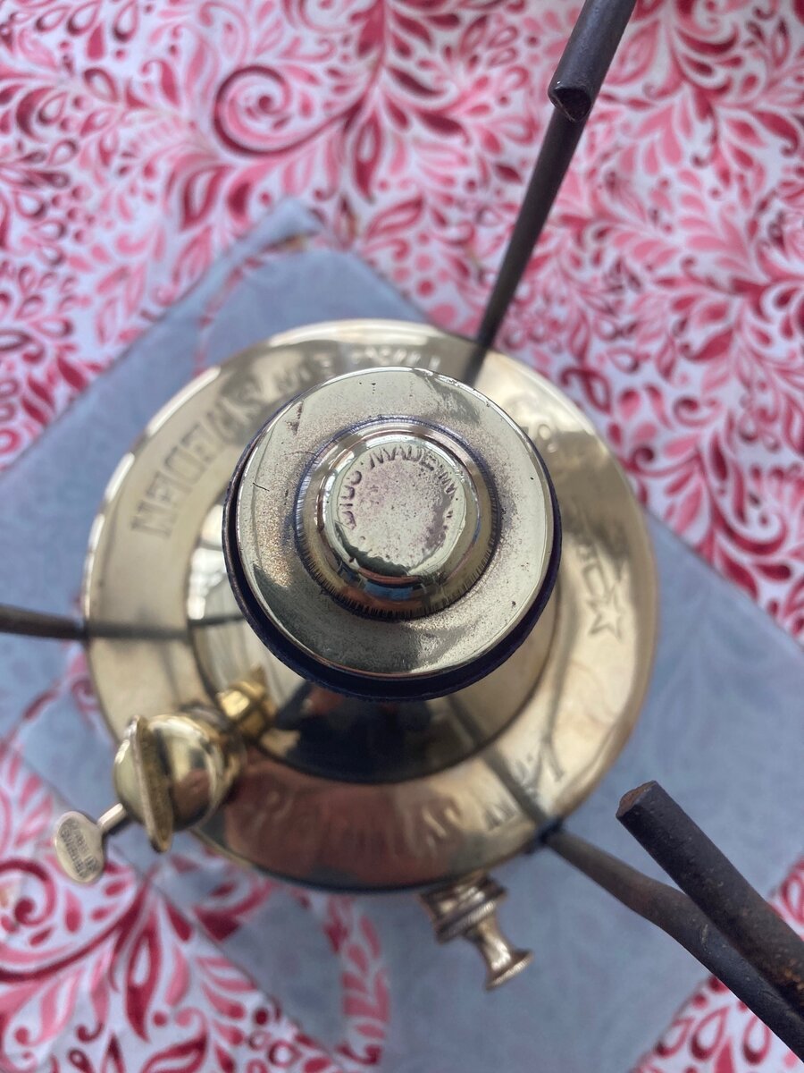

    Stamping on top of the burner, no markings on bottom of tank

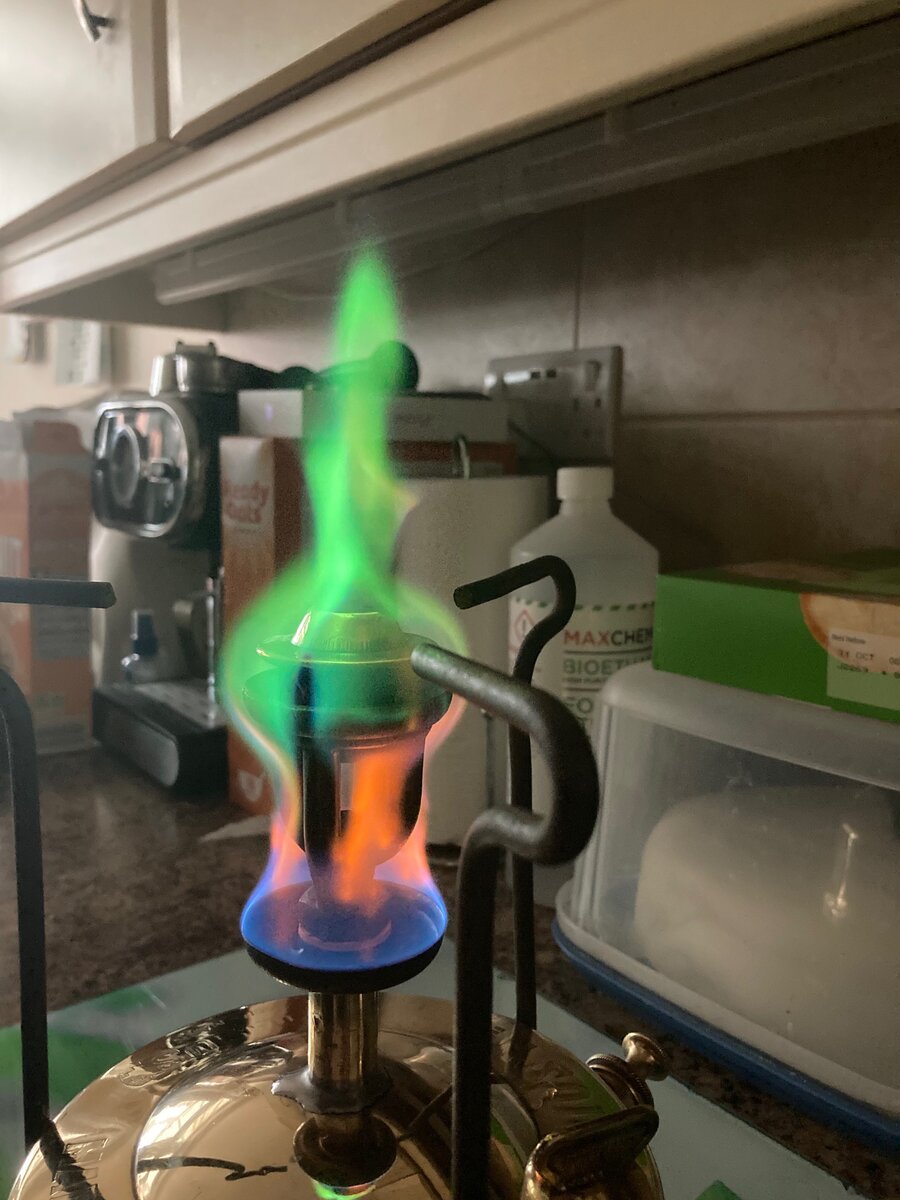

    Green Flames
    Went into underburn shortly after this.

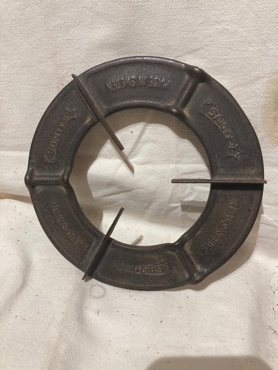

    Pressed steel trivet

    It's cleaned up nicely and I do like the flame pattern from the UFO burner cap. :thumbup:

    Another one saved - Well done Richard.
    (Did you get rid of that underburn?)

  5. Harder D. Soerensen
    Oct 24, 2017
    2,156
    Denmark
    Did you try a double preheat?

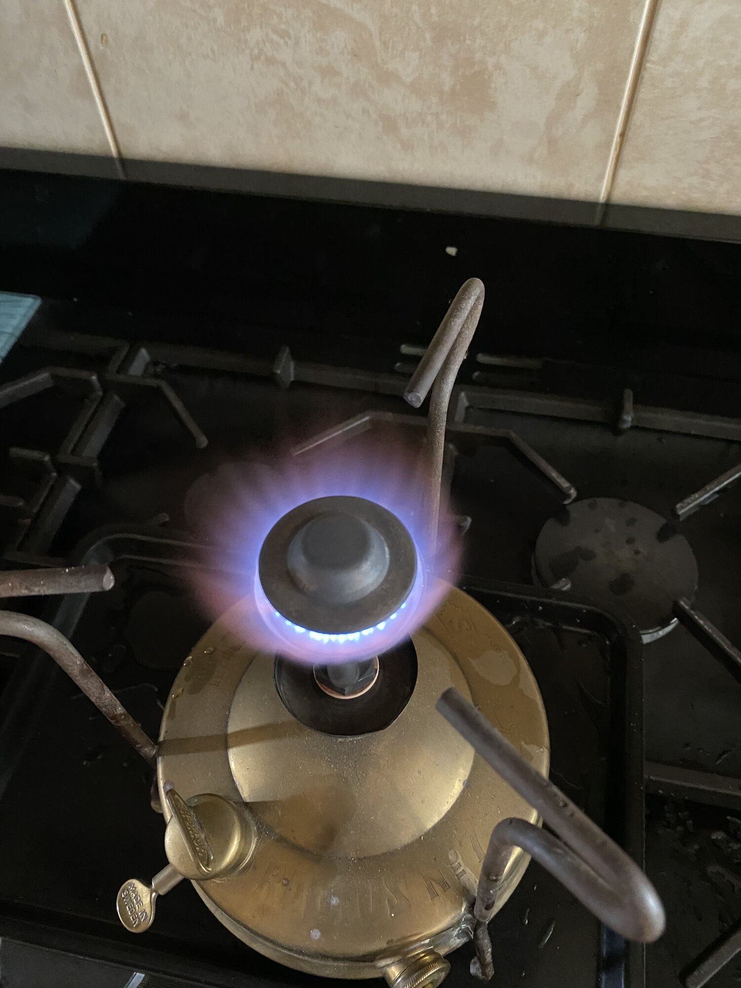

  8. richmay
    Jul 6, 2013
    399

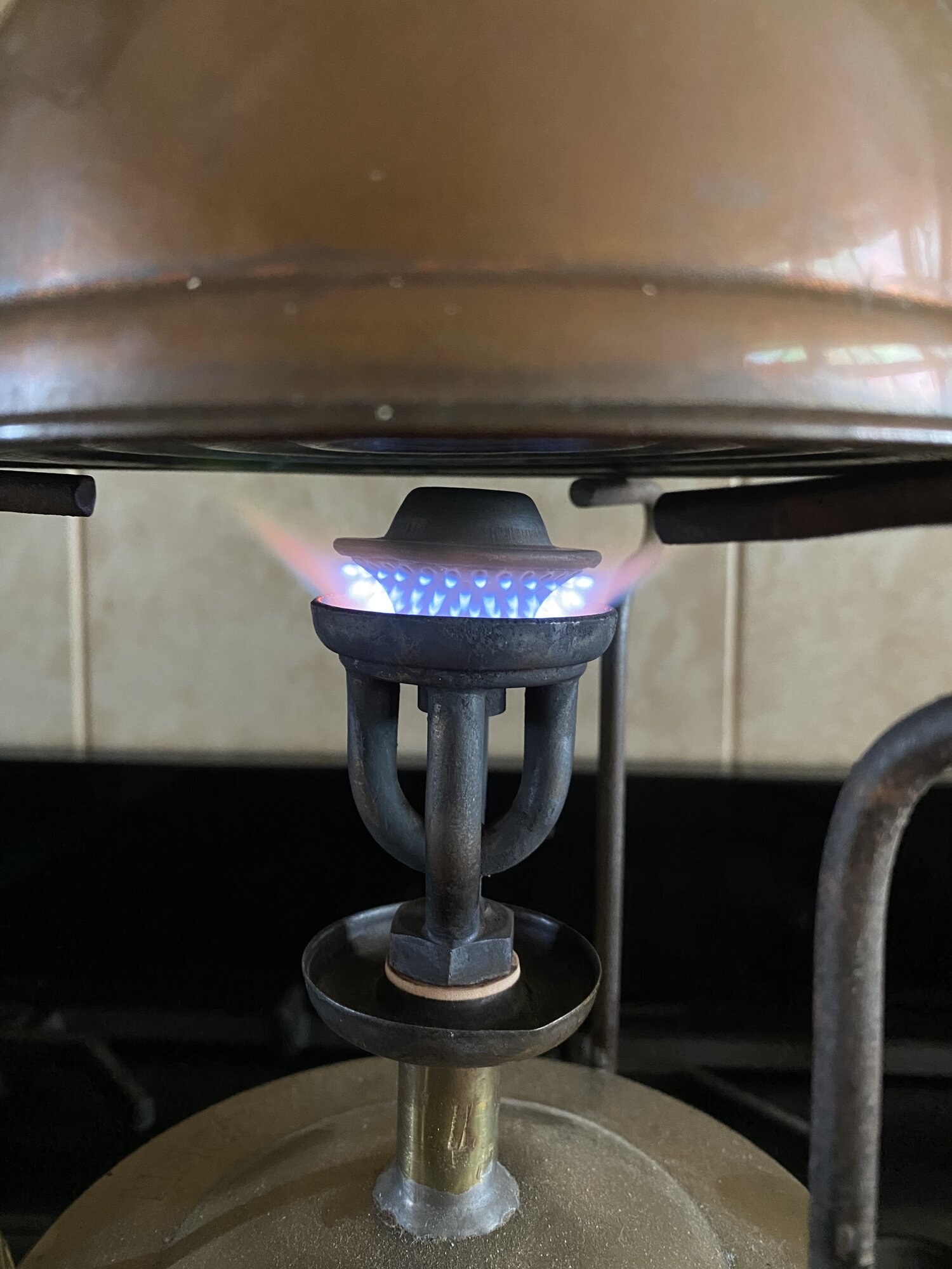

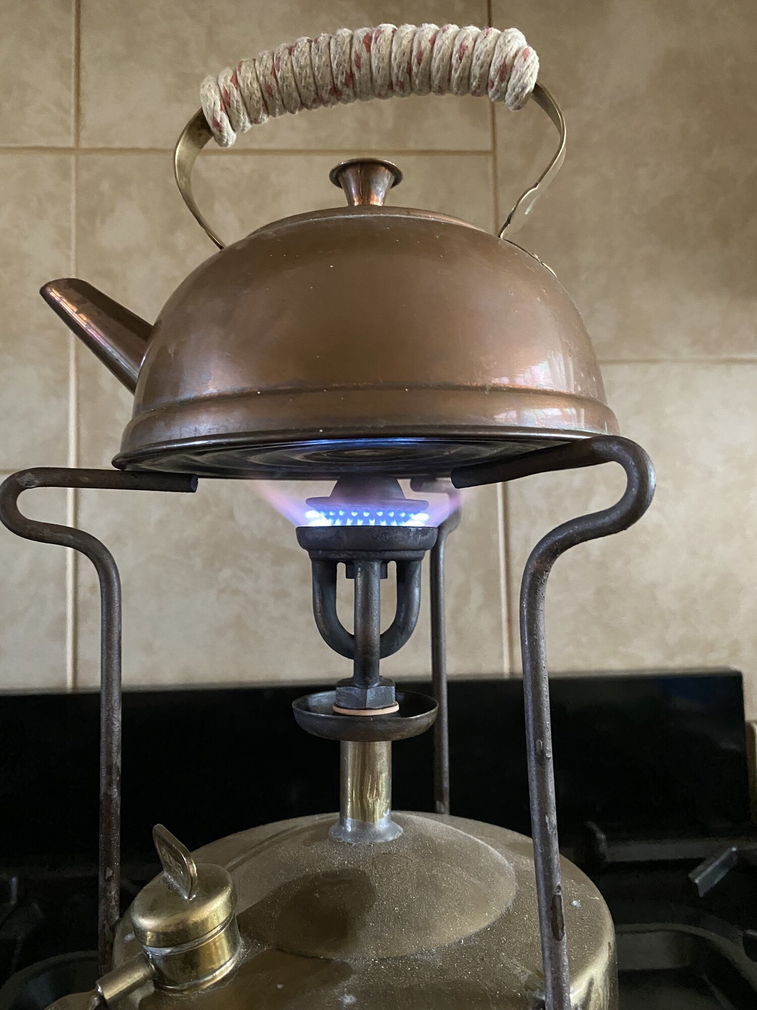

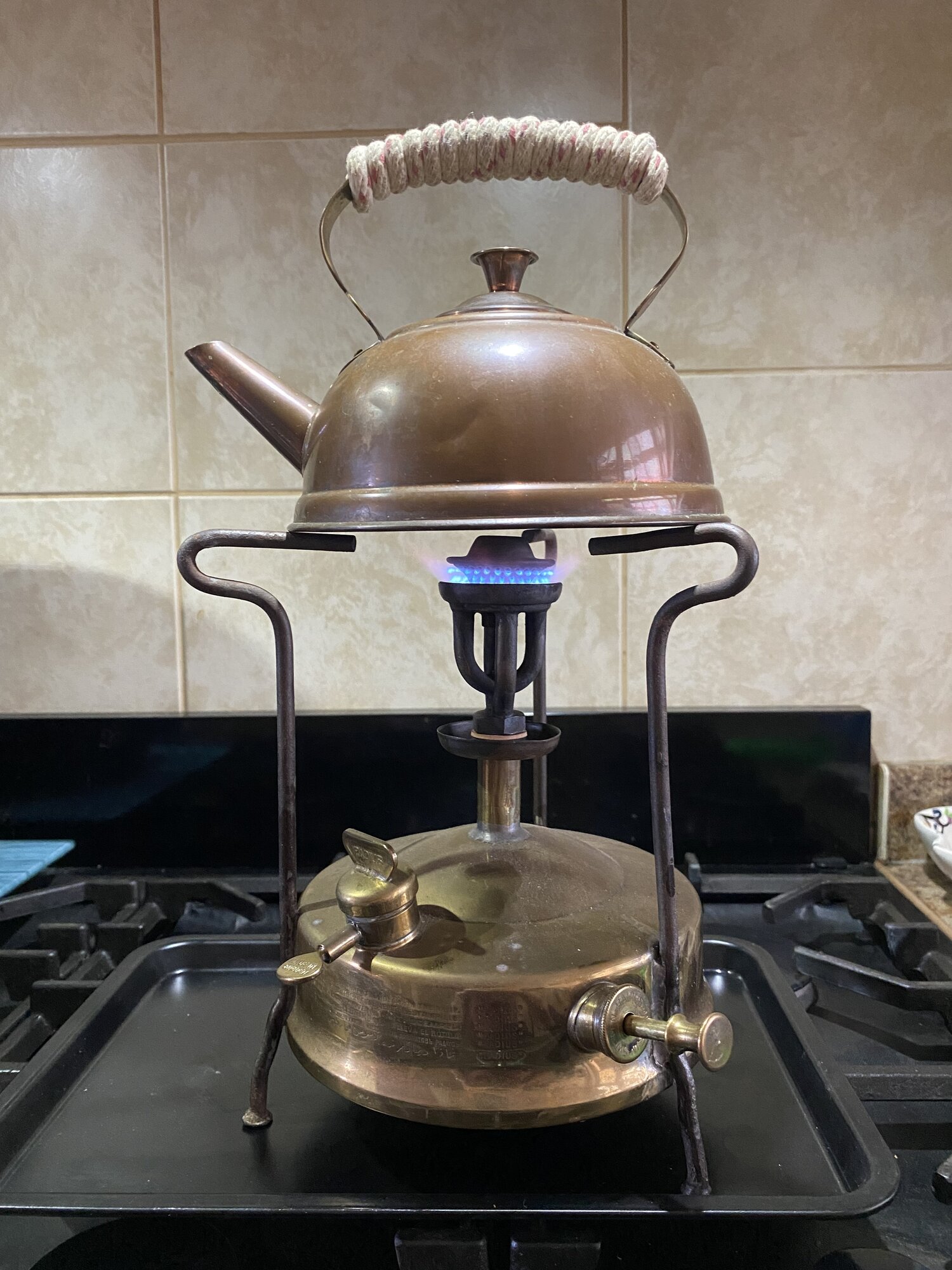

    Finally got round to trying the stove again after reading some advice from another post, works great if you put a pot or kettle on the burner, no under burn.
  9. Blackdog
    Jan 7, 2009
    3,539
    Dreaming of snow
    Thanks for that @richmay, there seems to be increasing opinion and evidence that these are excellent burners when at work, and often problematic if just lit for the prettiness aspect.
