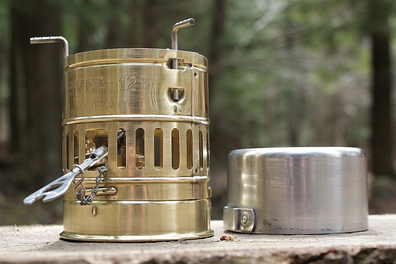

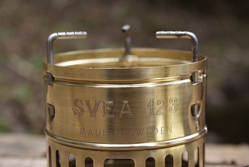

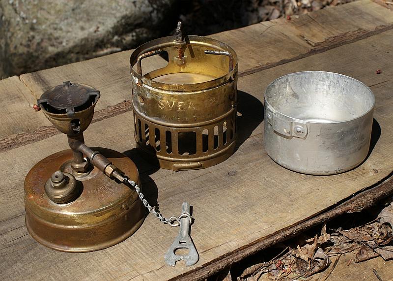

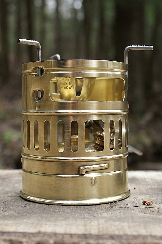

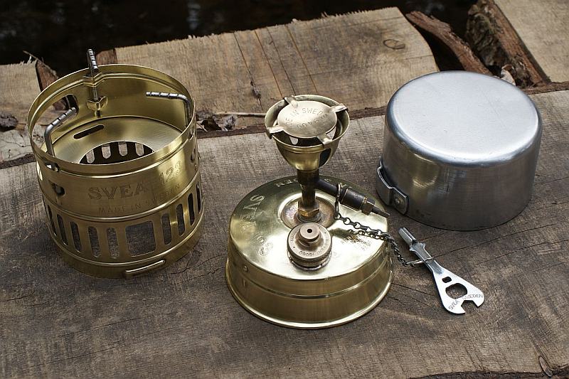

I've been trying to buy one of these old Sievert models for a while now and the other day I actually bought 2 for about half of what I'd seen them sell for in the same condition. I spent 5 hrs. on this one and am waiting for the second to arrive. It could probably use a few more minutes with the cotton polishing wheel but for now it's good enough for me. Cleaned up I would bet the value is near triple what I paid. Had to slightly tweak the stem to straighten it up a bit and make a slight clockwise turn to line it up properly to the key hole. Fired it up and it ran just fine. I'm hooked on these things. I'll get some better and bigger pics up in the gallery in the next day or so. Scott

Outstanding work Scott!!! I love what you have done to the cup too! Gotta love the "Svea 123" stamping on the windscreen. Cheers, Jeff
A tooth brush and some Brasso gets the hard to reach areas, I have a 6" unwoven nylon aluminum oxide flap wheel that works great on everything else, then I follow up with a 6" cotton polishing wheel and several times with 'NuFinish' Scratch Doctor. The only problem is that the clean bell and flame spreader gets dirty/discolored again the first time you fire it up. That's why I take pictures first.
