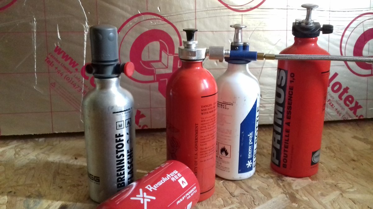

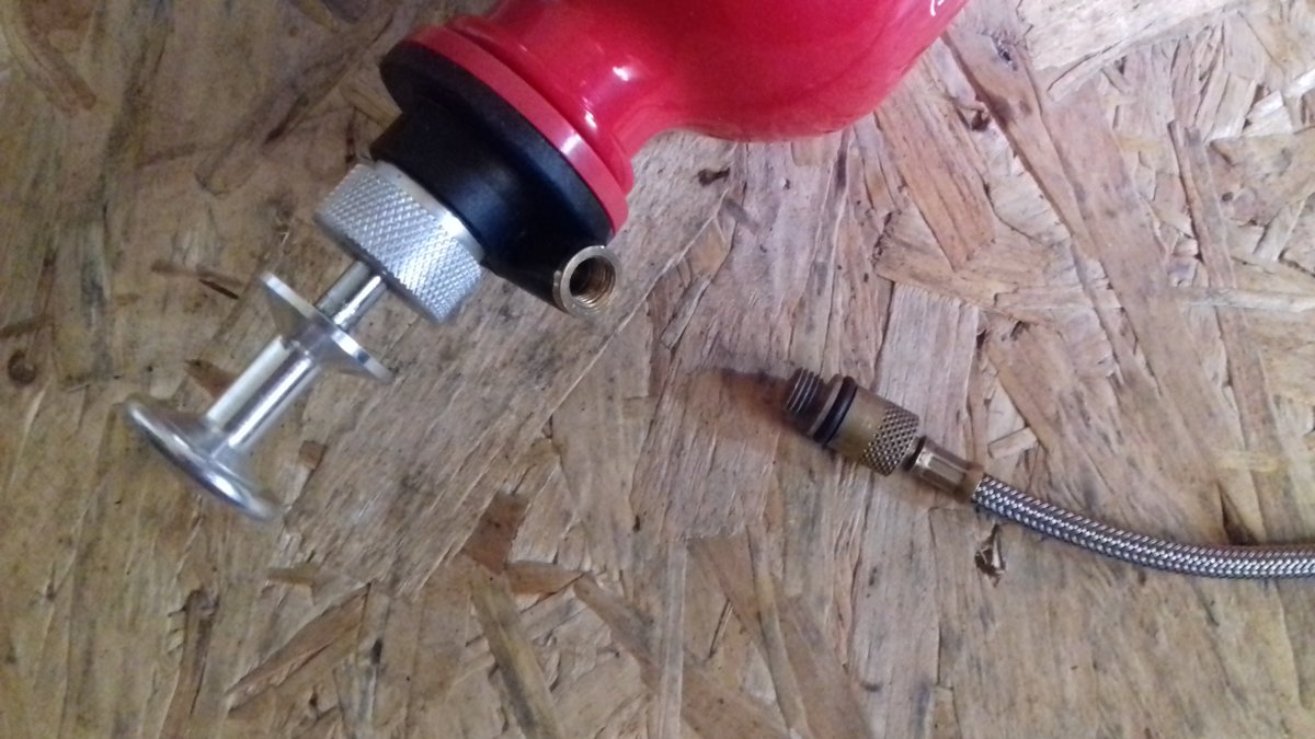

  4. Rickybob United Kingdom Banned
    Mar 25, 2015
    860
    this is an issue I have considered myself - the sigg pump is a bit of an oddity
    with the limited assortment of pumps I have the closest to fitting is the bulin multi fuel pump
    the threads are different and the thread in the pump would need to be changed to fit the sigg fuel line
    I have concluded that the only satisfactory way to change the pump is to fit a different pump connector onto the sigg fuel line
    I did try an msr siggerfirefly.jpg firefly fuel line on the sigg - it sort of fits
    I don't recommend this arrangement - the cleaning wire needs to be removed to fit this fuel line so not really practical

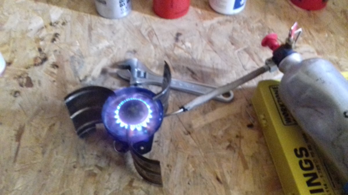

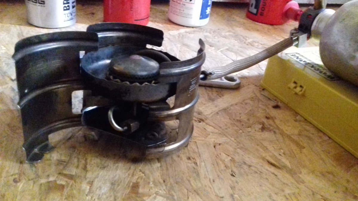

  6. HunterStovie United States
    Mar 11, 2015
    1,101
    Town of Parker, Colorado, USA
  7. Harder D. Soerensen
    Oct 24, 2017
    2,156
    Denmark
    @HunterStovie
    Thanks a lot. Interesting how you fixed your problem. Especially the fuel line. Looks like it is running quite hot on propane/butane. I would like to run it on Kero/Coleman though.

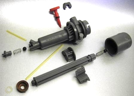

  18. mstewart14 Canada
    Apr 7, 2026
    8
    Vancouver, BC
    @presscall I've just found a pair of these stoves and I'm trying to figure out how to get the handle apart to I can free the ball in the top so it can breath on the up stroke (as one of them is not breathing right now). Are there pictures somewhere or instructions... I'd really rather not break it trying to get this apart. If I had to guess the pair of notches in the bit holding onto the shaft of handle looks like a tool or pair of tools would go in there and turn? squeeze? I can't tell from your images (thank you so much for posting them). I'm off to get some seals for these to get them running again. They both leak...
  19. presscall
    13,944
    Mine’s not to hand right now to confirm but I recall that it’s a click-fit on the shaft. I’ve brightened-up one of my under-exposed original photos to illustrate the arrangement.
    The check valve in the handle doesn’t do that, it simply releases excess pressure on the pump stroke when the fuel bottle is sufficiently pressurised.
  20. mstewart14 Canada
    Apr 7, 2026
    8
    Vancouver, BC
    Thank you for that, I have to admit I zoomed in on that picture several times trying to figure this out. Do you know where it gets air in on the up stroke? cause wherever that is, is stuck or sticky and I need to get it unstuck...
