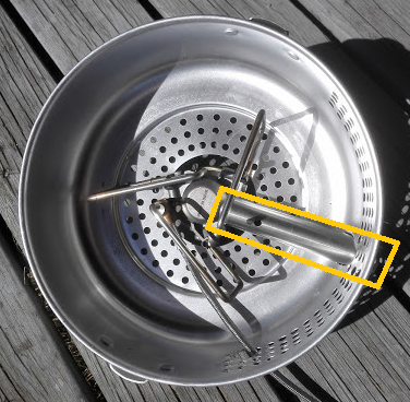

    More than 5 years after Doc Mark, I got my stove, and yes it is great, but as always, when I fire up stove the wind starts blowing, a lot! So did try out to put up a windskreen of better quality, I have this Trangia clone, and the stove fits well with the legs turned only 90 degrees. My next mod, will be to drill a hole for the air tube. At this setup as pictured, I got 1/2 liter to rolling boil in less than 2 minutes. Im impressed!

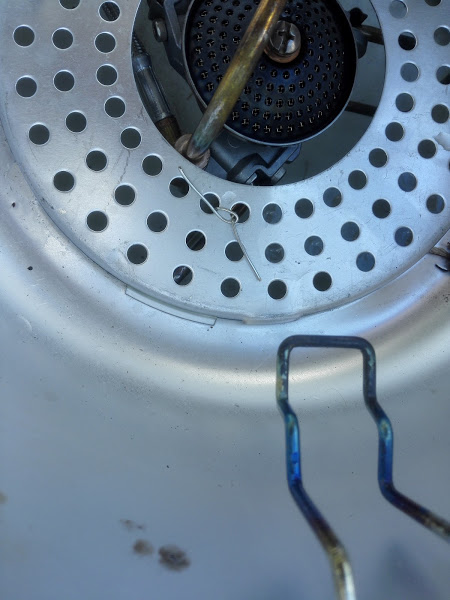

    Went on with the mod. drilled 2 holes, 1 for the air tube, and 1 for the hose.
    New testing, in the garden today, slightly windy, and not considerably faster than without the air tube. The sound is more stable, and the matal was cooler after coocing . No scientific work, but I go for this!
    If you look close, you will see a little cord of telephone wire used to fix the burner to the aluminum screen.

  14. snwcmpr
    22,082
    @dsk
    What is the air tube you refer too?
    I only see the fuel hose.
  15. Jeopardy
    Jeopardy Subscriber
    May 26, 2012
    2,001
    @snwcmpr I think he means this one on July 4, not present in similar picture of July 3 but I'm prepared to be corrected.

  16. snwcmpr
    22,082
    @Jeopardy
    So, not a part of the stove, but something that he added?
    @dsk
  17. hikin_jim
    Yes, it's essentially an air intake so that the stove draws in fresh air despite being nestled down in under the Trangia.
    HJ

    Hi,
    Soto refers to tube pictured as the O2 maximizer.
