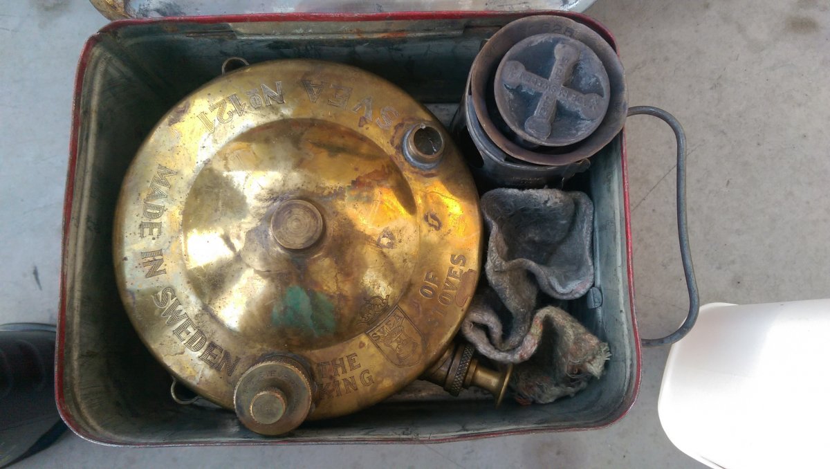

Hello.... I recently rediscovered my Svea 121L stove and tried it out. I had no problems getting the stove to work. I had filled it up quite full, burned it for about 10 minutes, then put out the flame. Once the stove cooled down I packed it up, closed all the caps, put it in the tin box, and stored it in my garage for about 2 weeks. Yesterday I pulled it out because I decided to try oiling the pump. When I opened it I was surprised to see there was about one centimetre of kerosene in the bottom of the tin box. I took the stove out and wiped it down. Then held it upside down to see where the leak was? I did not see any fuel leaking out? Does anyone know what may have happened? The only guess I have is that the tank somehow got pressurized and the fuel escaped? The last two weeks here have been very hot, 30 degrees Celsius. Could that have caused the fuel to expand and leak? Please let me know your thoughts.... Once I cleaned up the mess I oiled the pump and the stove worked just fine.....

Excellent! Some good information and ideas.... Here is a link to my stove. https://classiccampstoves.com/threads/svea-121l-in-canada.30273/ Here is how it looked when I put it away. https://classiccampstoves.com/attachments/3-jpg.135502/ The stove was about 3/4 full of kerosene and all the caps were tight. I'm going to order and replace all the seals. In the meantime I will try out the suggestions for finding the leak. Thank you all...
I checked for leaks. I first placed the stove in the fridge for a while, tightened all the caps, and then placed it in warm water. The top center cap had a good leak and since there was no washer on the cap I guess that's a good reason! The pump was also leaking. Not as much as the top but it was definitely leaking. The filler cap and release valve were good. My stove needs a bit of servicing!
