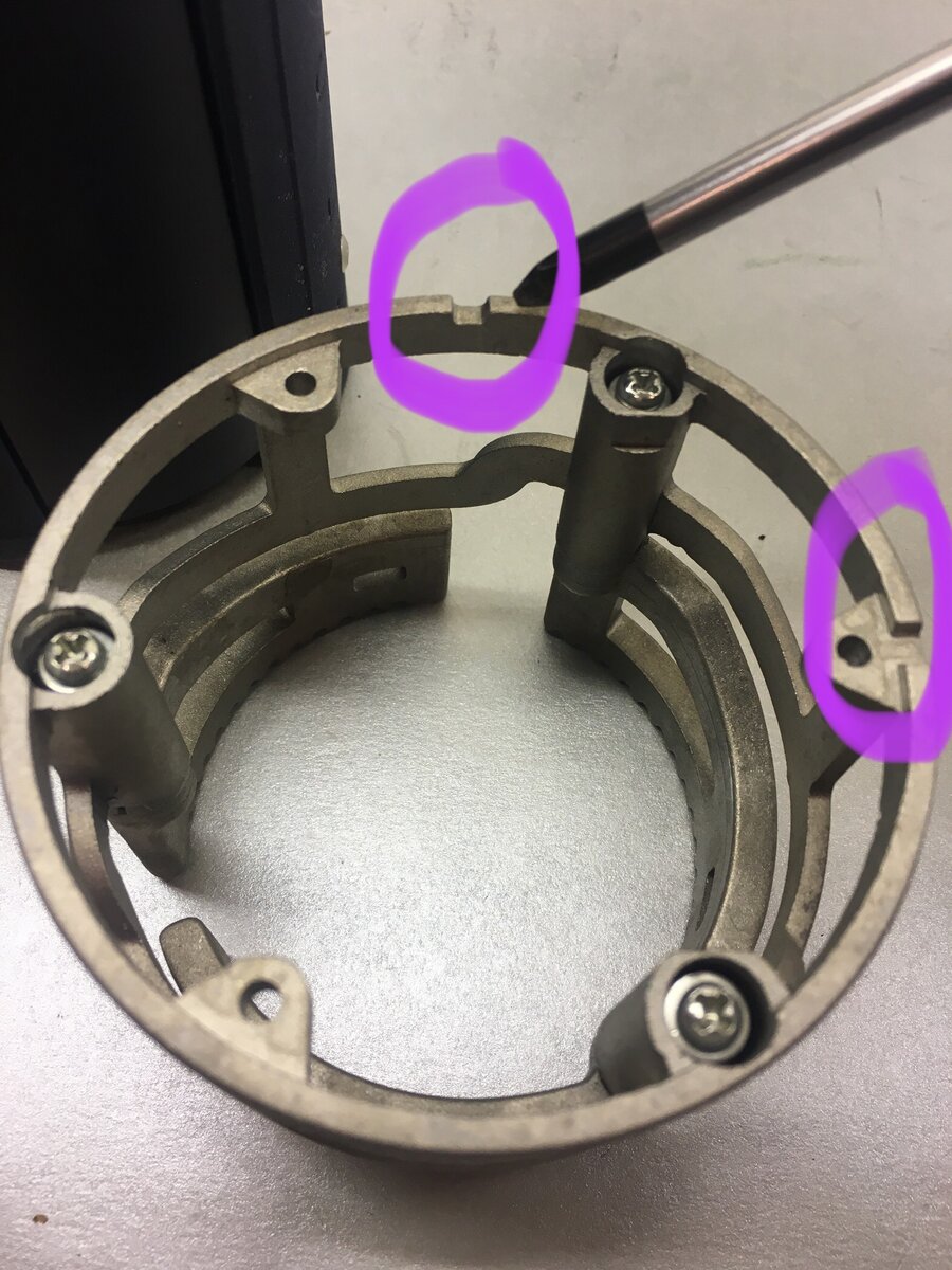

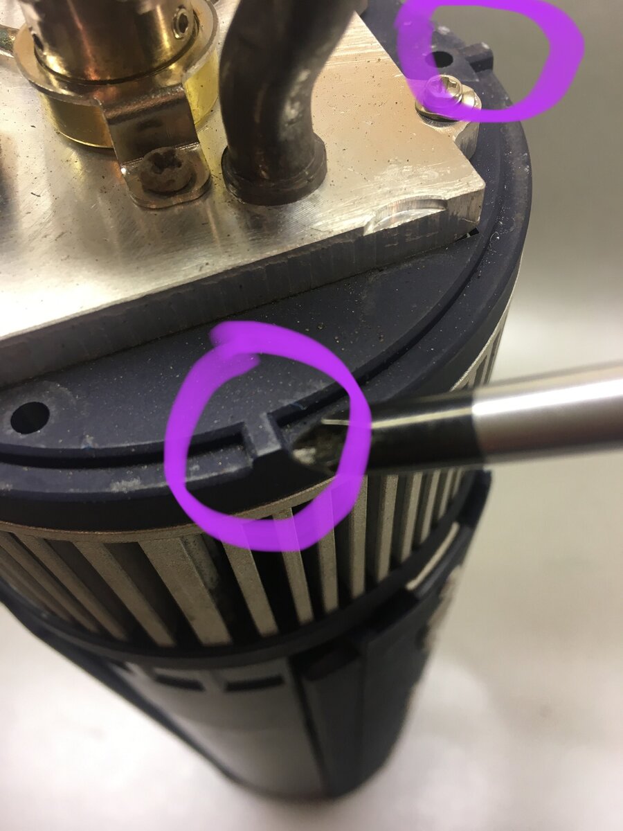

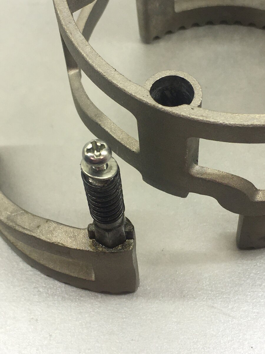

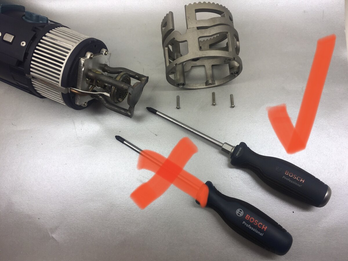

    @Denize Ok, three Phillips-pattern crosshead screws to undo. Note they’re Phillips pattern and not the more common Posidriv type, superficially similar but not a fit.
    Phillips screwdriver top, Posidriv bottom.

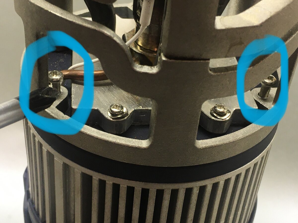

    The location of the three fixing screws.
    Two of the screws visible here, partially undone.

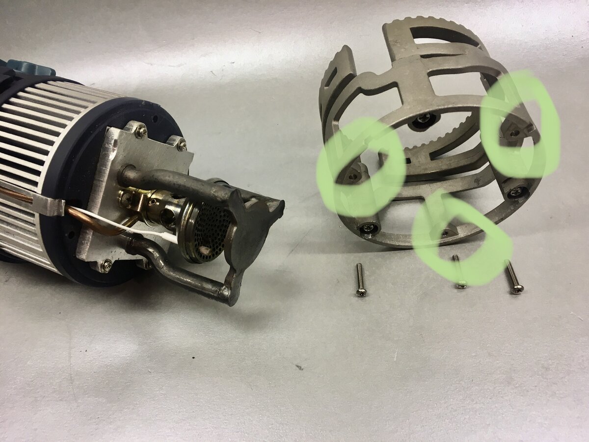

    With the pot rest frame removed, you’ll have access to the individual pot rest pivots and securing screws. What you’ve said suggests seizing of the pivot posts in the frame. Don’t force them, the sintered metal could easily fracture. Oil them and allow the oil to do its work over a couple of days. If that doesn’t work (it should) you might try dunking the pot rest assembly in a pan of boiling water for a few minutes.
    On reassembly, be aware that there’s only one orientation of the pot rest and thats with a couple of lugs matching up with corresponding sockets in the stove body.
    Good luck!
