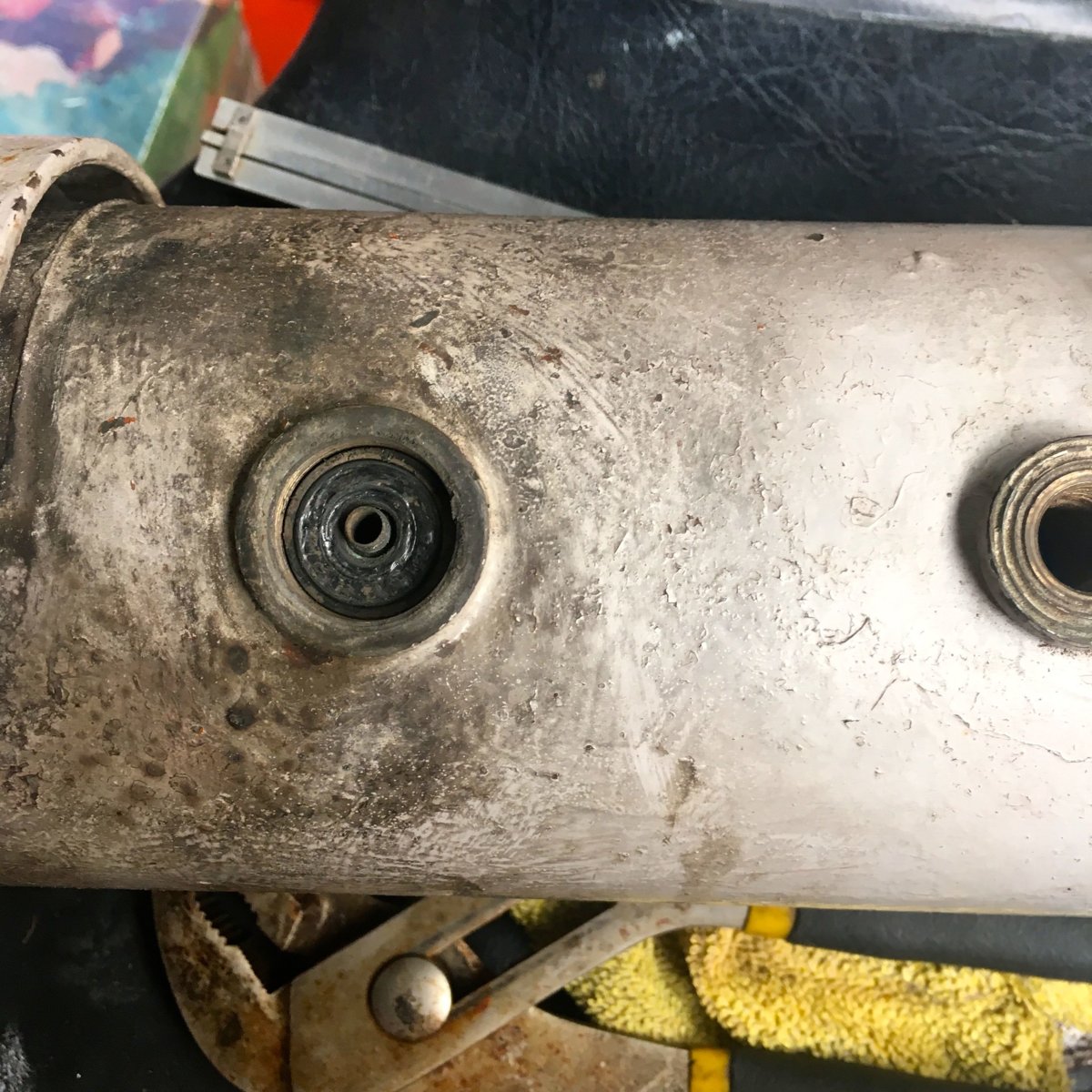

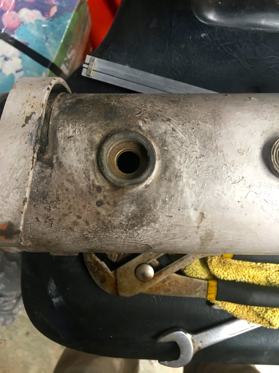

    1. I note that in this thread you said that the "...seal between the vapouriser/fuel valve assembly and the tank that the assembly screws into is lead".
    I've just pulled down my Turley and Williams No. 3 and found these very brittle "rubber" washers:
    Do you remember what thickness lead washer you used?

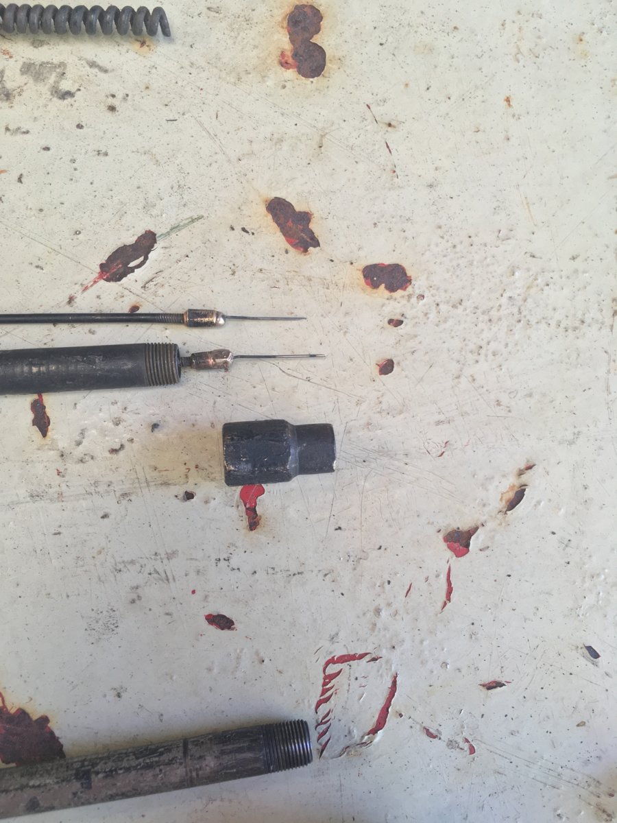

    2. The pricker on mine is a bit different to yours.
    I was thinking about running the stove without the internal pricker anyway, but do you know the size of the jet in case I decide to put a needle in the pricker?

    I’ll need to get back to you on the jet size, but it surely won’t be anything less than 0.32mm.
    The seal of valve to tank needs to allow for lining-up of the vapouriser in the correct 90-degrees to the tank axis position and I found a lead washer did that best by not being critical if it took nearly a full turn to get from ‘not sealing’ to the 90-degree position. I used 2mm lead sheet to cut the seal from, but 3mm would be fine too. 1mm’s probably a bit too thin but could maybe work.
    With viton or fibre there’s less facility to accommodate that range of movement and the thickness of the seal becomes critical. Too thin, too thick and the vapouriser may come to ‘rest’ way out of position, so it’s back to trying a different thickness if you have it, or perhaps doubling up with one on top of another.
    Quite likely the original seal on your was the optimum thickness selected by the manufacturer.
    Fibre too is inclined to shrink in use (the way a roarer/silent burner often has to be tightened up a touch after first use of new washers) though probably less so in a less high heat application as on the T&W.

    Thanks. I was thinking of 2mm lead.
    I suspect that the “rubber” washers that were on the stove assumed their unusual shape over the years. I think that originally they were 2mm thick.

    You are correct about the jet being more then .32 mm. I may run mine without the prickers because it wouldn't be hard to come up with an external pricker to clean any debris from the jet.

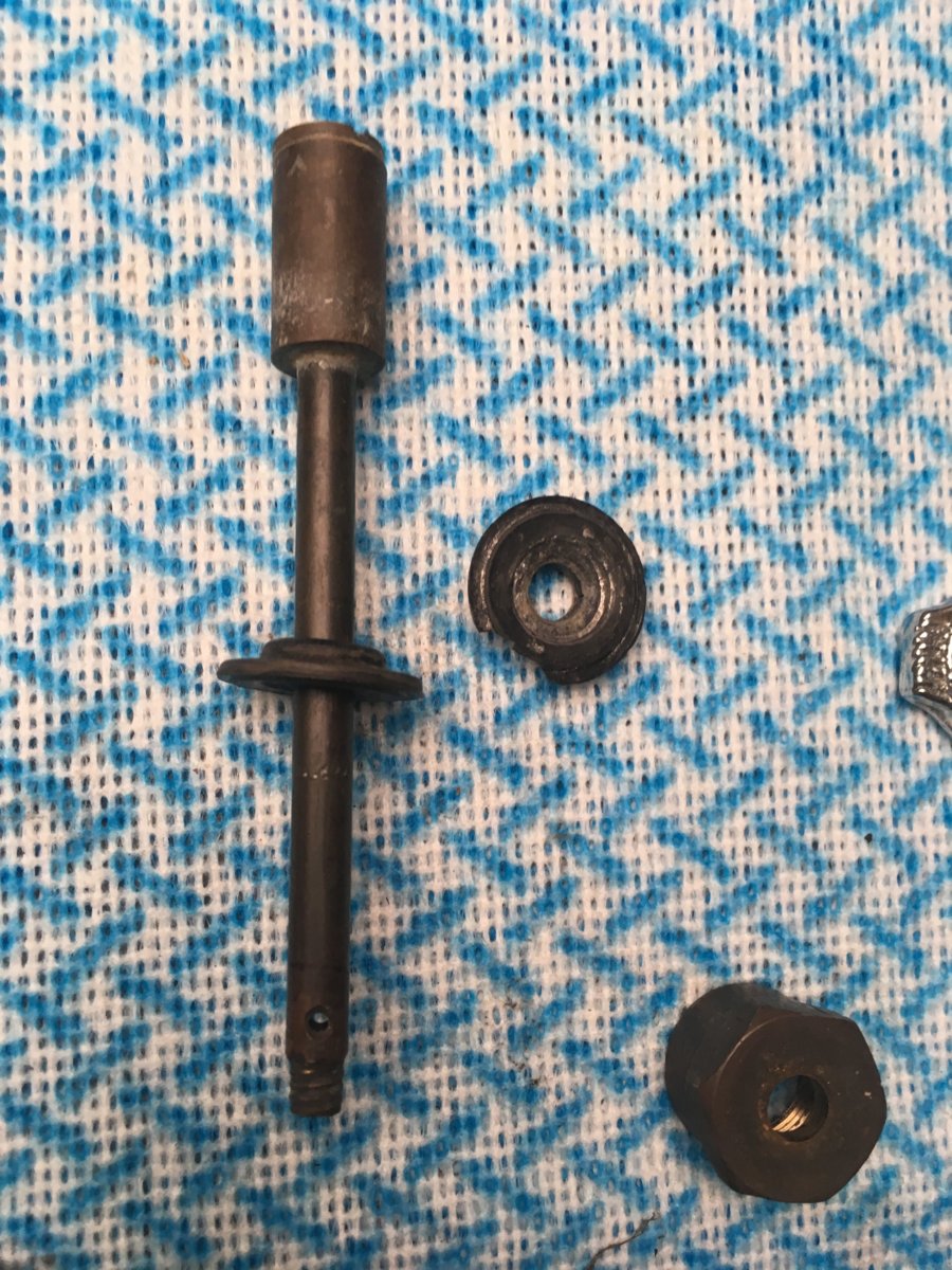

    A 27 gauge hypodermic syringe works well as a pricker for the Turley and Williams No. 3 Jet, I just found out.

    ... only for the fact that the jet is ‘buried’ in the manifold in use, so unlike a Primus 210 or something of that sort, pricking the jet with an external pricker with the T&W fired up and in use with isn’t possible. Personally, I’d retain a jet pricker if I could. Pricking a jet with the stove shut down doesn’t make a lot of sense. It’d be of more benefit then to unscrew the jet and remove the debris blocking it. Fired up, the pressure in the tank might just blow the debris out through the tank rather than being pushed back in, but best of all is an auto-pricker to push the debris out, with the tank pressure assisting.
    @Tony Press
    Right-ho, one for the ‘useful stuff’ file. It amuses me that thanks to @Doug L and the Anglo-American co-operation the use of hypodermic needles in CCS fettling is now a stock technique!

    Using a hypodermic needles as a new pricker is a very good idea.
    All of the hypodermic needles I've seen here in the US are glued into a plastic housing. I'm assuming once the needle is removed from the plastic housing it wouldn't be difficult to sibraze a base so it can be held in place.
